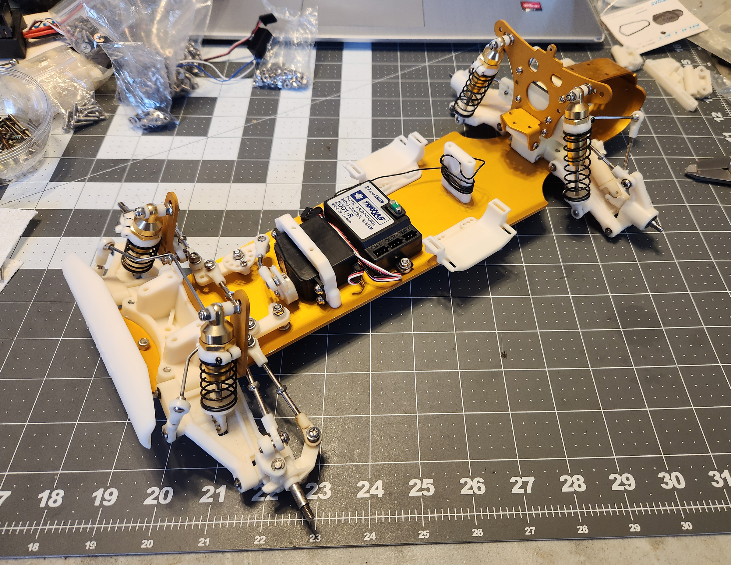

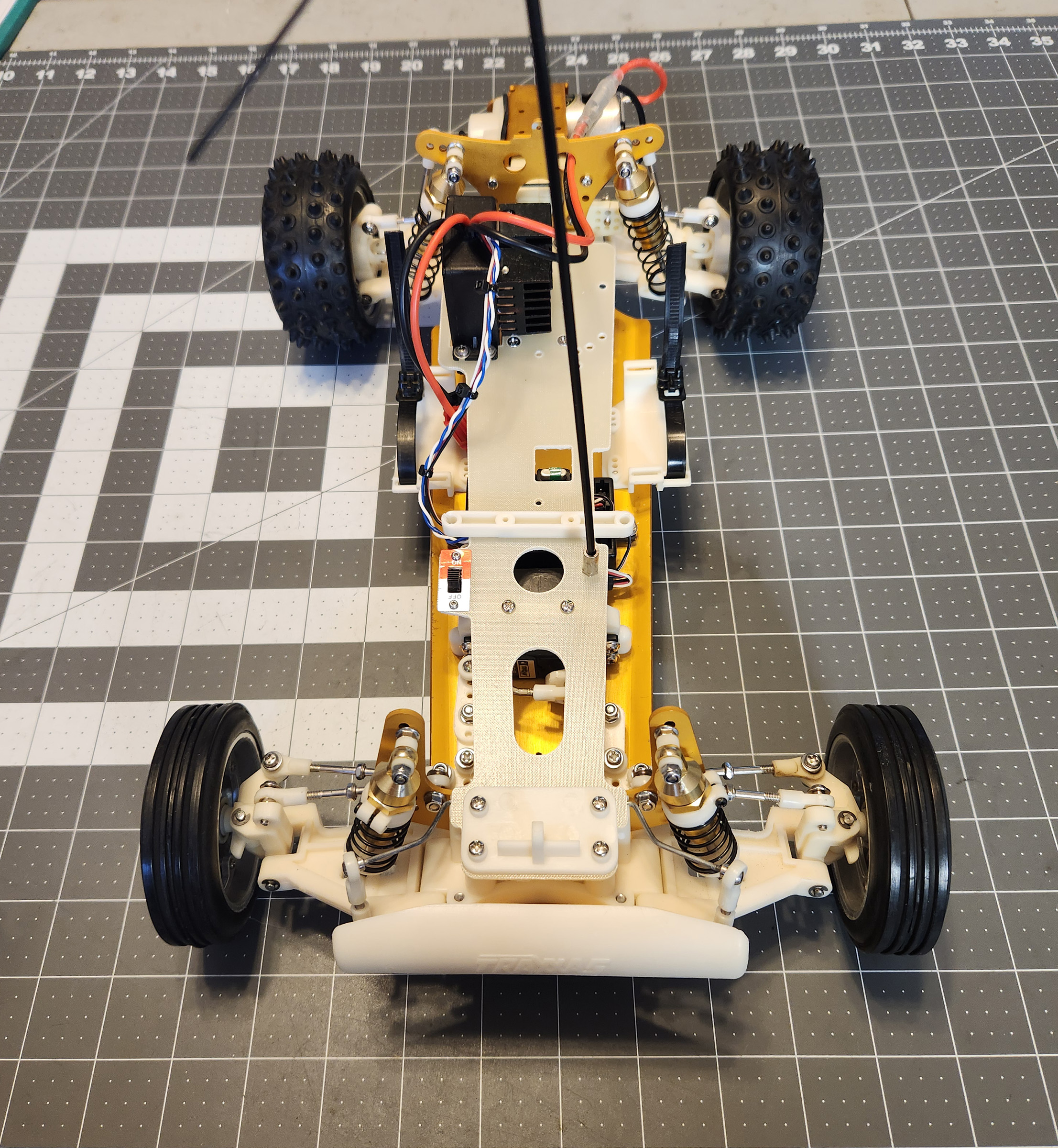

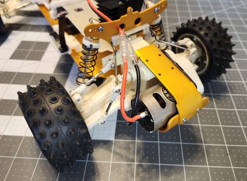

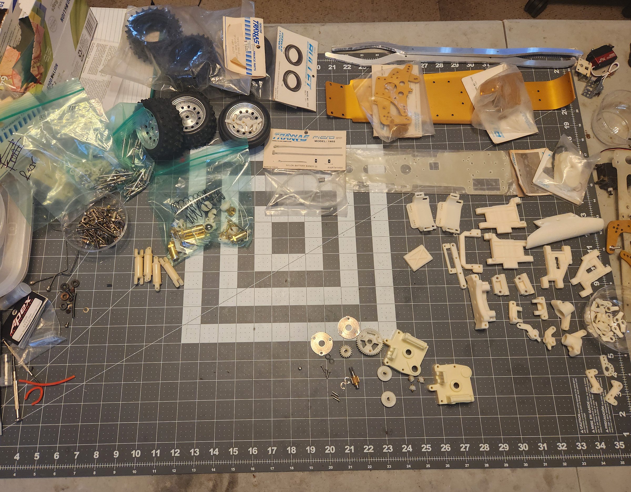

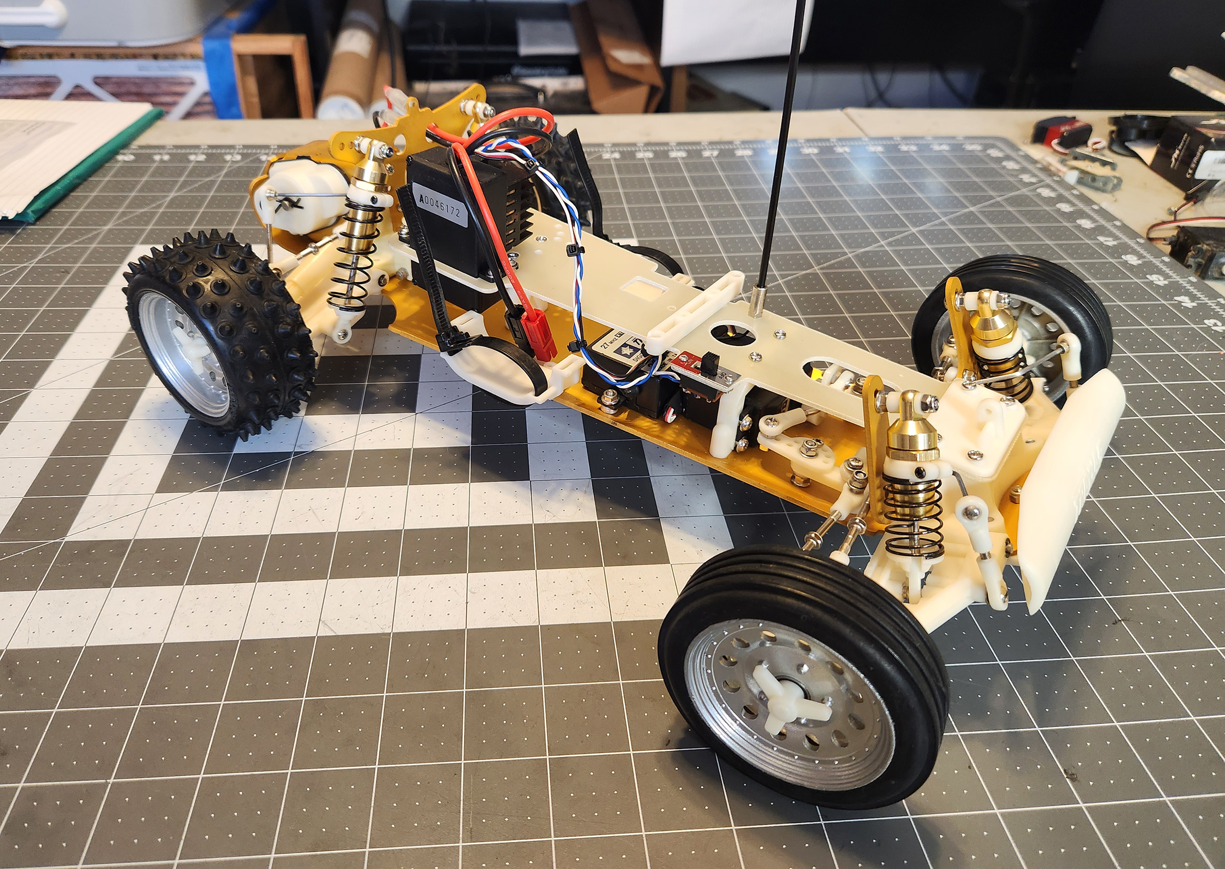

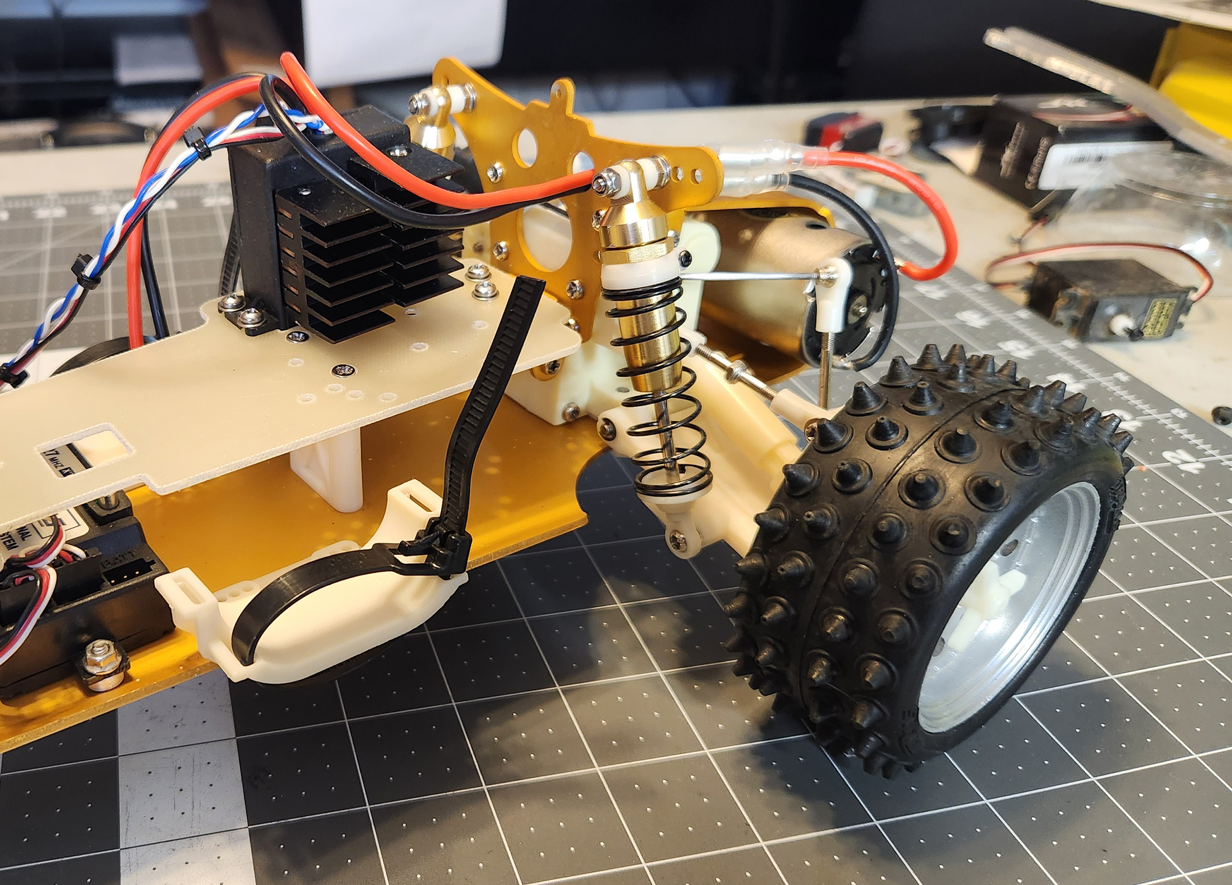

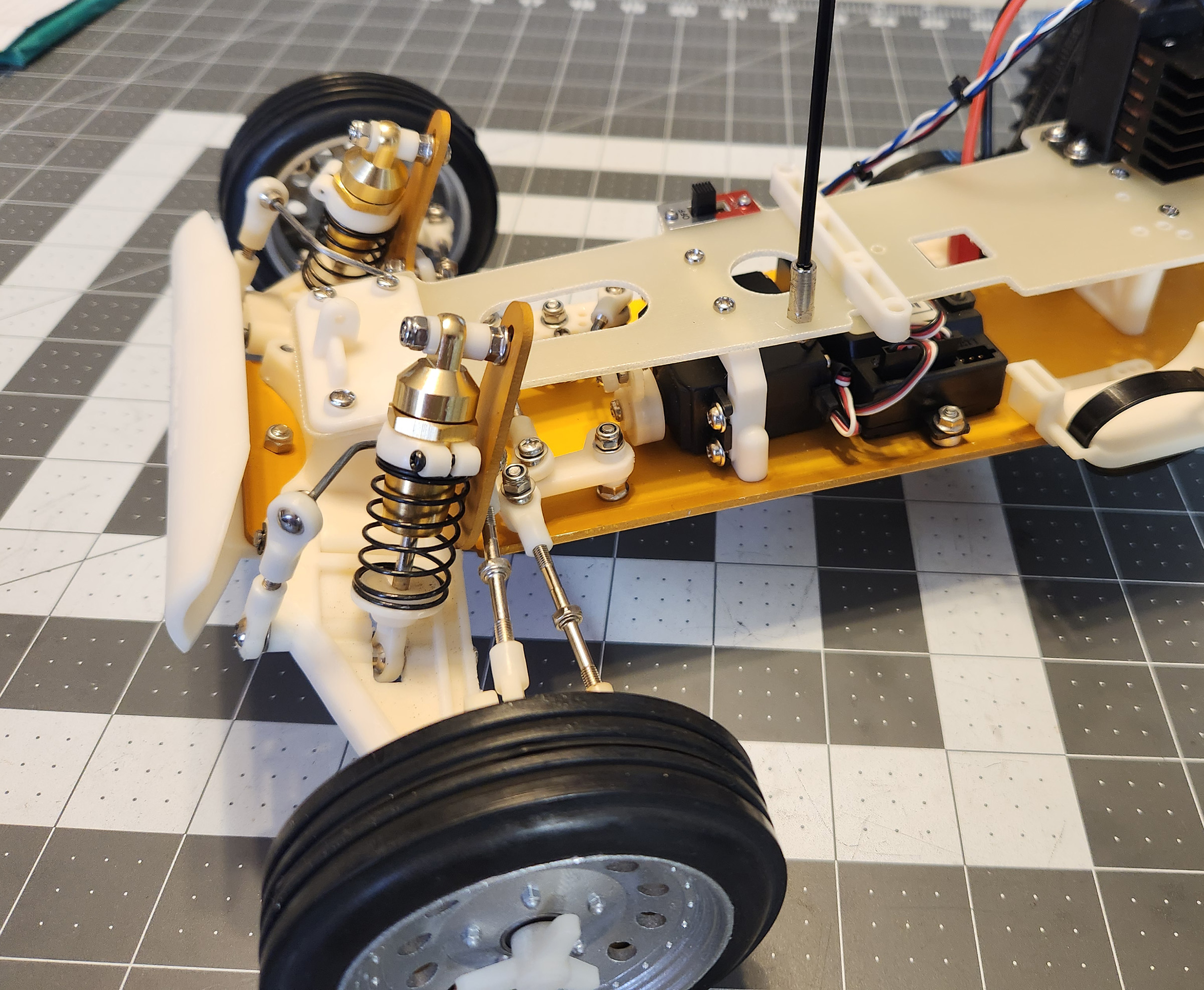

Started into a Bullet refresh this weekend. Original plan was to go all out, and get the best of everything, but found out most of the parts I had (from two parts cars) cleaned up pretty well, so just decided to refresh it, and only replace what was really needed. As I found on my Slegehammer, Traxxas nylon responds very well to whitening; better than AE. Don't know if Traxxas maybe started off a little whiter originally, or it just takes to the process better. Just remember if you get into this, and I forgot this time, the gearbox case is not nylon! Don't know what plastic they are made of, but it is different than the nylon parts. The case halves on my Hammer started chalking a little bit; no damage to the Bullet though.
I also have to give props to the anodizing on the Traxxas shocks. Both my donor cars were driven rough, but the shocks are near pristine after a little cleaning up, with little to no discoloration.
I would have liked to have gone MSC on this, but they are hard to come by, and with the plan changing to do as much as I could with what I had, I just grabbed an XL-1 set up I had sitting around in another car. It would have been optional originally, so not breaking any major rules there. Had to replace some wires on the ESC, but not a big deal and it cleaned up well. Since the top plate has a servo mount for the MSC servo, the XL-1 will slide right in its place and look fairly stock.
My major problem is that I don't have a roll cage for the body, and yea, those really don't exist on their own. This ended up being the final straw to push me into resin printing, so hopefully I can make something happen with that in the future.
The build so far has gone as they usually go. I didn't get a fastener kit for this, because I don't like them in general, and I figured it would be all mostly M3 at standard lengths throughout, but nope! M2.6, M3x29, M3x33, etc. Just a hodge podge of screws needed. Most of the smaller nylon bits on the tub are secured by countersunk M3, but not the Rx mount, that is countersunk M2.6. :roll: Well, it used to be M2.6. :D I should have looked and seen if I could get a decent kit in Phillips head, but oh well, I made do and made changes as needed.
Didn't go crazy on the camera pics, so it just kinda jumps to be half done real quick. In the pics below, please forgive the one brown link end. I somehow ended up being one short in my hydrate / whiten pile, so a couple are whitening now.

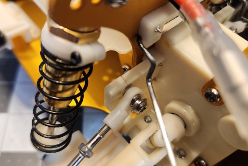

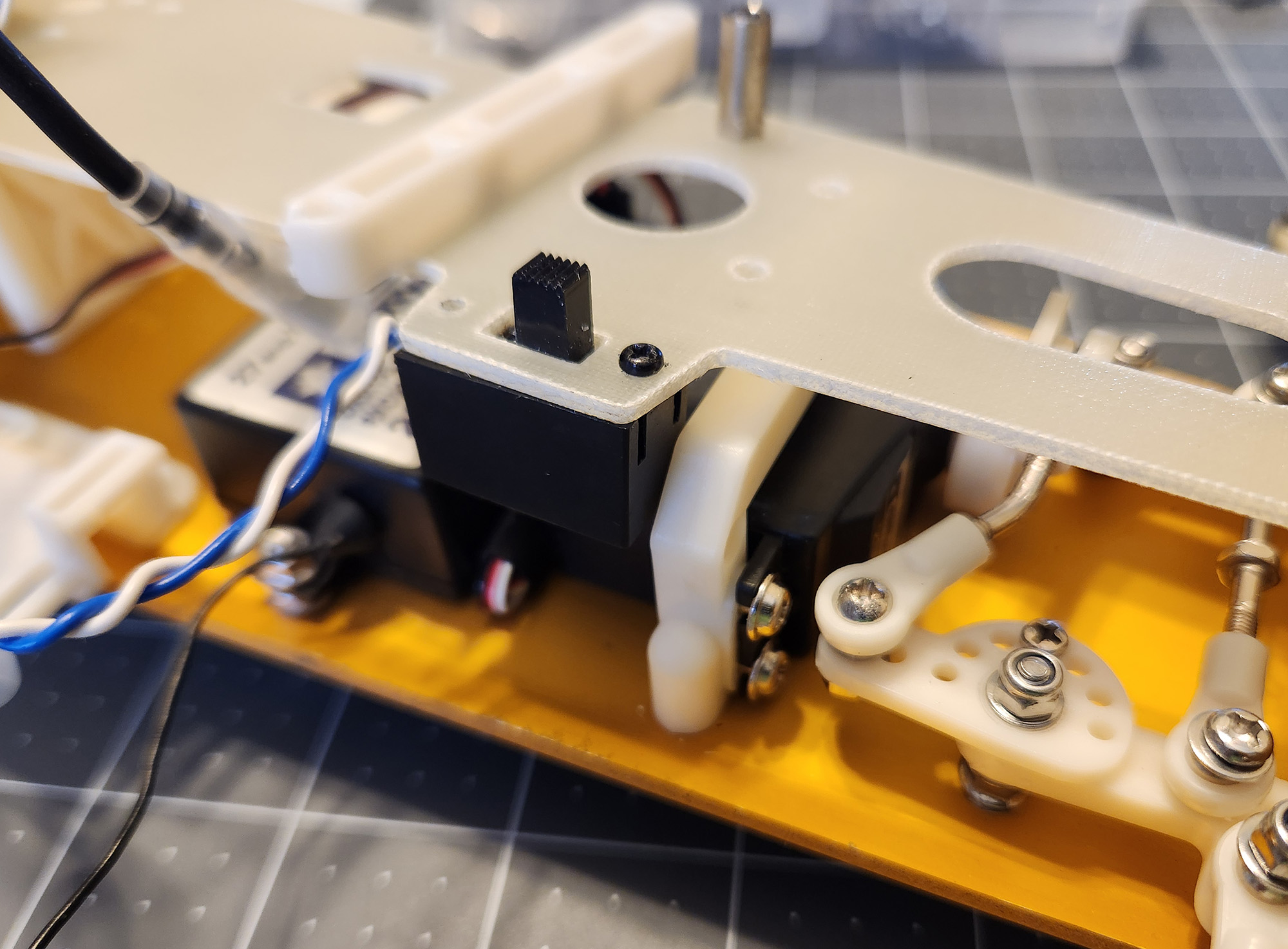

Design flaw. The Traxxas ESC switch does not fit in the Traxxas car. :?

Re: Traxxas Bullet Refresh
Which ESC are you using?

Frankentruck wrote: Mon Mar 11, 2024 8:52 am Which ESC are you using?
It's an XL-1. Per the parts manual, this would have been an available option.

Just popped the switch out of its case, and just going to run it exposed. I think its water and dirt days are over, so I don't think it will be an issue. The servo mount could have been trimmed enough, and still be plenty strong, so there is also a different route. The XL-1 may end up being too tall for the body mounted as is, but the body hasn't gotten here, so I can't test yet.

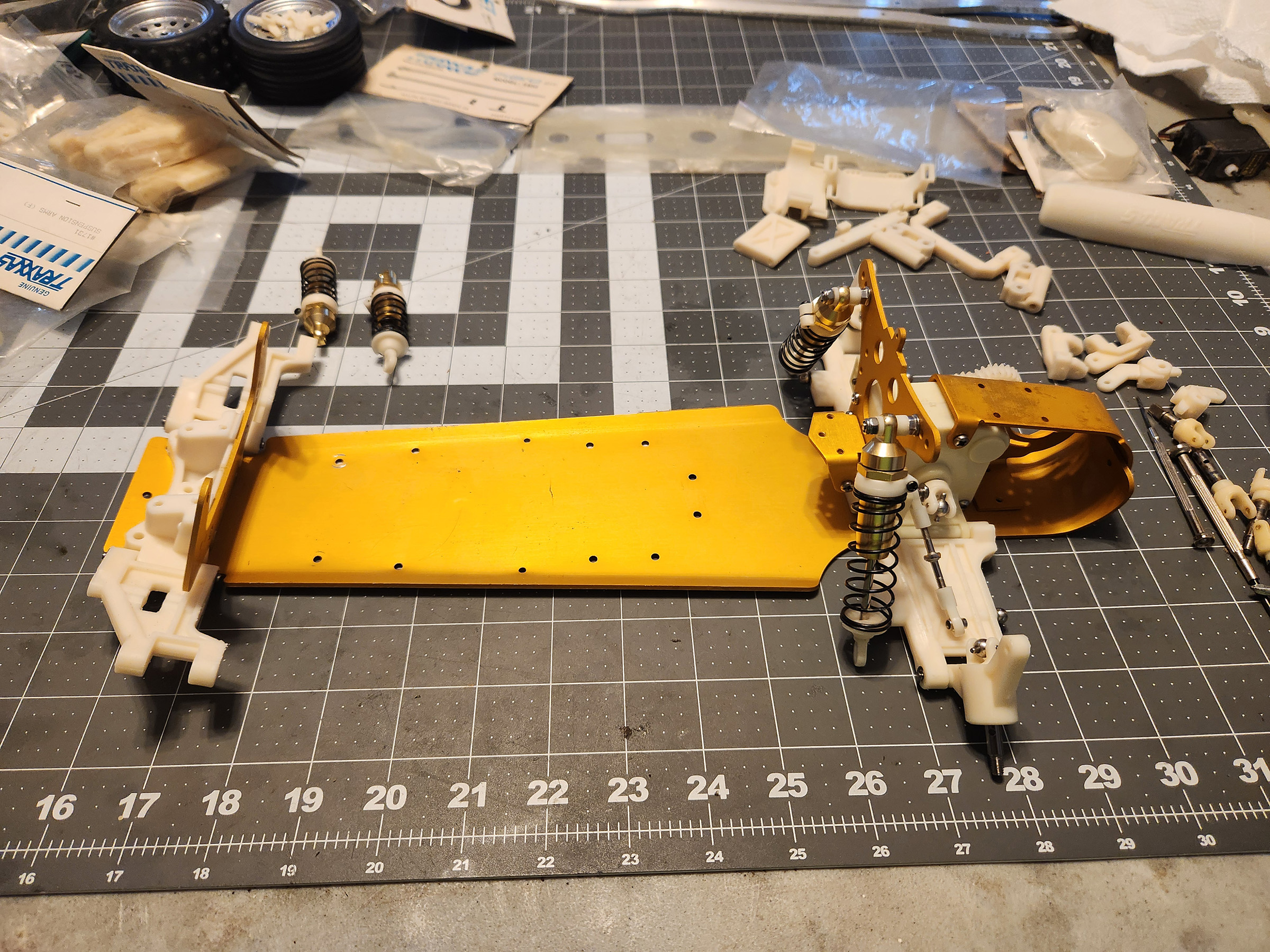

TRX-1-3 wrote: Mon Mar 11, 2024 3:34 am Those gearbox 1/2's are really hard to find.
Yea, mine are cracked at the link mounts, and this seems to be fairly typical of many of the pics I have seen of other vehicles. These are the only broken parts on my rig.

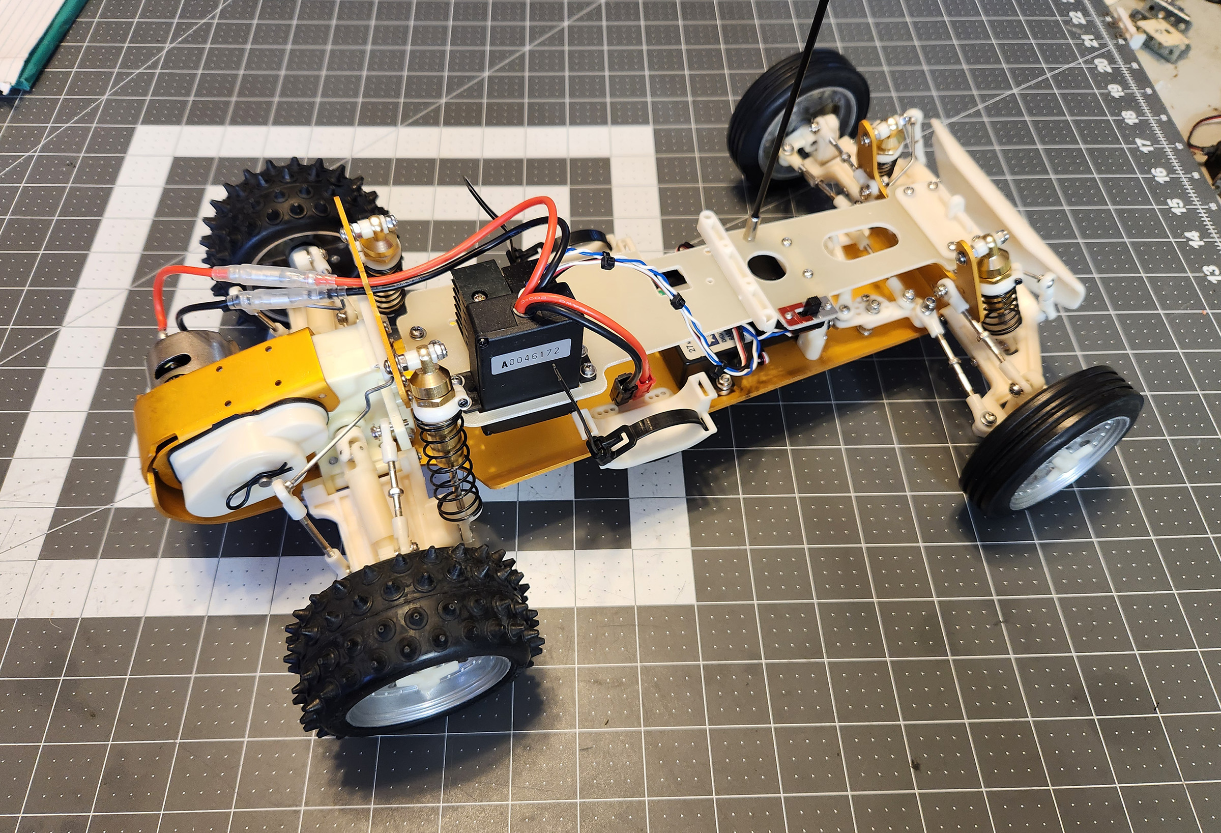

She is mechanically complete. The body is a few days out, and then I need to figure out the plan with the roll cage. I almost don't want to do anything with the body and leave it as-is, because let's be honest, its not the best looking body out there.
The only new parts used on this car are: shock towers, motor mount, links, electronics plate / upper chassis, dust cover, and tires. Some new wire / screws / e-clips / bearings / etc of course. The electronics and motor were pulled from other cars. She isn't perfect, but came out pretty well for just a clean up and reassemble.
And I guess after looking at the bottom of the tub again, I may have been incorrect in saying that both donors were driven hard, because the pan is in great condition. The weird part about the car that the pan came from was that it was left somewhere wet for some time, because everything was really rusty on that one, even breaking the screws that held the bellcranks. Both donors had pretty worn tires, so not sure how this pan is so clean. You can tell from the pan pic also that I had to swap between phillips and hex screws a little bit, which isn't ideal, but I am okay with it. This is the only part of the car where it is obvious, and most of the other hex screws are hidden for the most part.
