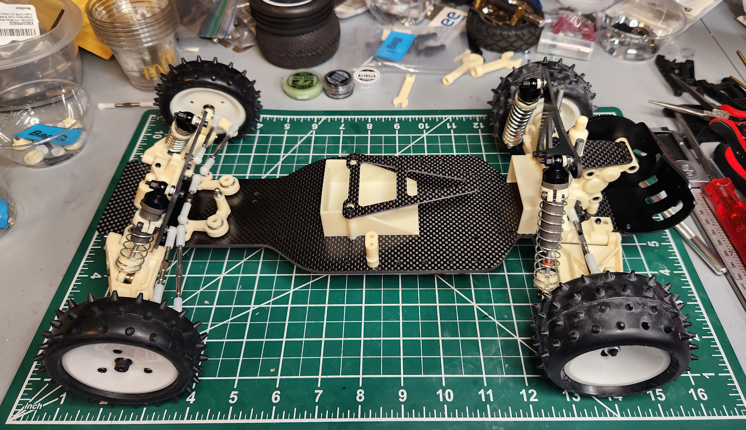

Re: Fan RC FR-01
Post by morrisey0 »
Well, my collection of "extra" parts is getting bigger and bigger, but I am not going to worry about that for now. :D

Post by RogueIV »
GoMachV wrote: Tue Aug 06, 2024 7:24 pm *Rere world's hole. Same as CE and Team. The real world's car as well as the DS used a hole not on that bulkhead, halfway between the hole your in and the inner hole. Weird AE forgot, and since fan just copies the AE stuff he also left it out. The rere DS doesn't use it either.
At least it's pretty easy to add them in. Still need to clean up the cut areas though.

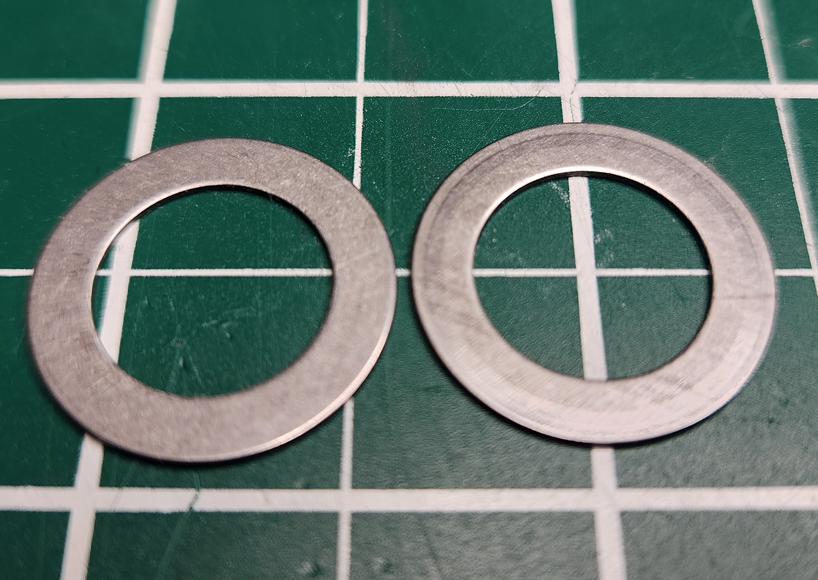

RC10th wrote: Wed Aug 07, 2024 12:53 am Would be good to see if someone with a "gritty" diff tried new diff/thrust balls
Swapped over to traditional thrust plates / balls, and it made no difference. Going to swap back in the new style, and just start swapping parts individually until some improvement is witnessed. All parts appear fine, and run smooth when rotated up against individual parts, but once you put it together and torque it down, it really does get pretty bad.
EDIT: That didn't take long. Swapped the diff rings and it is night and day. Now the diff has a nice steady drag. Never really looked at the rings earlier, but they are nowhere near as smooth as the polished rings that I normally see.

ahh dang, well thats good to know! I dont typically order his rings because I have some old stealth gears left over and his rings dont fit (the old gears have three nubs in the way of his larger diameter)

Re: Fan RC FR-01
Post by Rc10812 »
I suspected that something like the diff balls and diff rings would be a candidate for quick replacement. I have yet to find a set of quality replacement rings. As I said I bought new diff balls but the rings I ordered are clearly the wrong size despite being told they would work. It sounds like there is an aftermarket set available? Would the original rc10 diff rings work or did I pick up on someone saying these rings are slightly different?
Anyway, great problem solving Morrisey0. That's great input; thanks.
Posts: 12214
Has thanked: 1084 times
Been thanked: 3762 times
Re: Fan RC FR-01
I just have old stock AE rings still, they are slightly smaller diameter. His rings won't work on original stealth gears but the other way around is just fine. It's just the difficulty of sourcing original AE parts until they decide to start selling again
