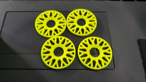

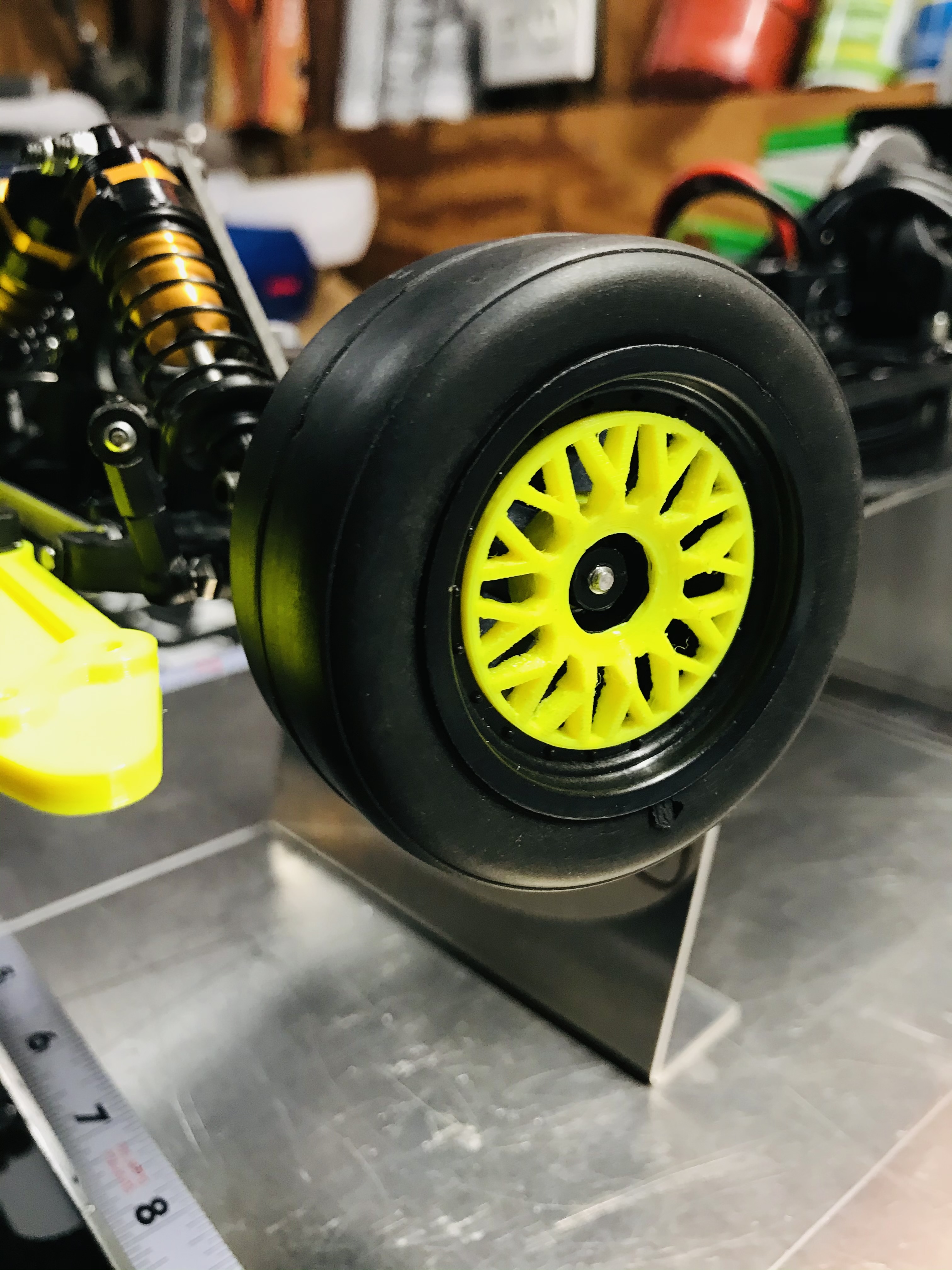

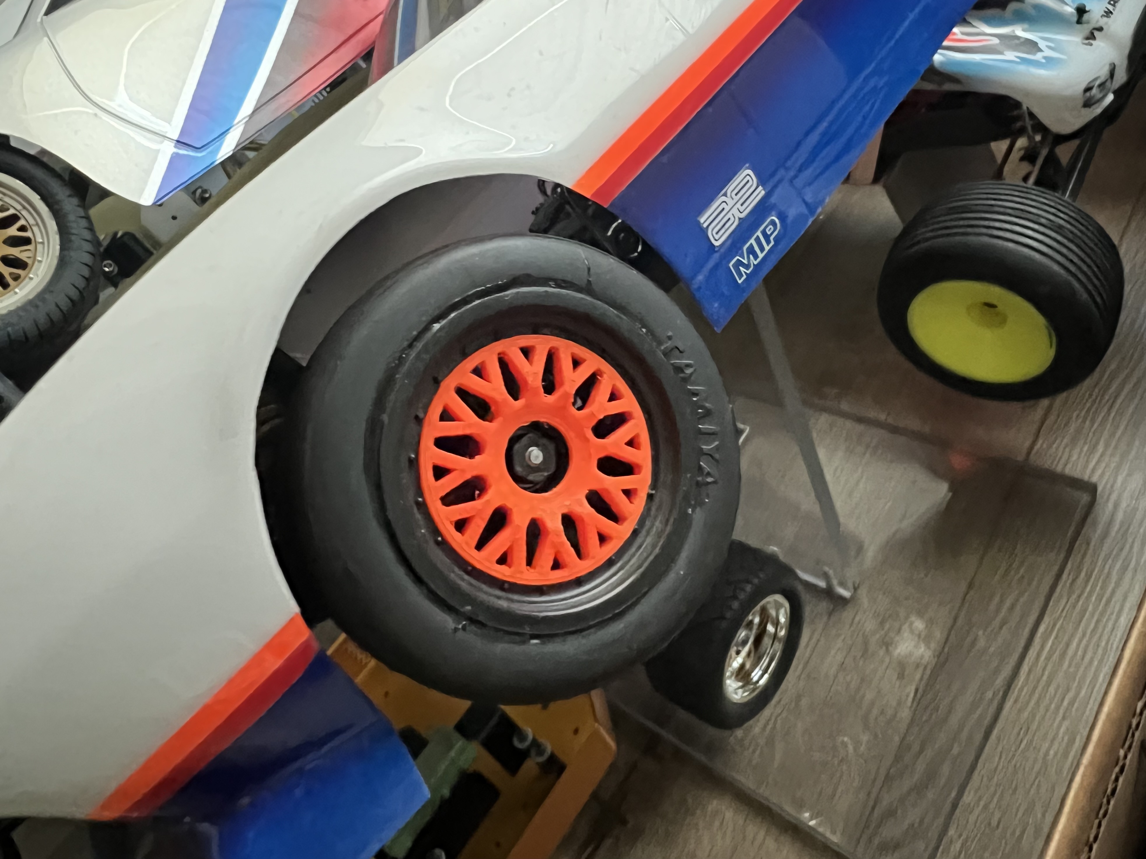

RogueIV wrote: Tue Aug 13, 2024 12:47 pm Thought occurred to me. Since the mesh part of the wheel is a separate disk that's non-structural we can easily change up these disks with custom 3d printed ones to get different looks.
:lol: :lol: :lol:

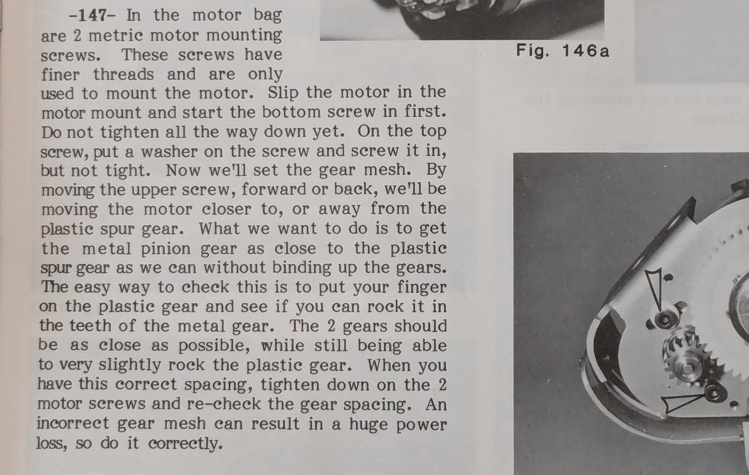

TRX-1-3 wrote: Tue Aug 13, 2024 8:17 am You gonna run (a) washer(s) on the motor screws?
The manual doesn't mention anything about washers, but it would probably be a good idea.
Also, the manual shows the two metric motor screws like they're included, they are also on the cover flap 1:1 size chart, but either I lost just those (2) screws, or my kit didn't come with them.
Posts: 3813
Has thanked: 2607 times
Been thanked: 2984 times
Re: RC10 DS Classic - Build
The gold pan buggy manual calls out a washer on the upper screw but it's common to use a washer on both screws.

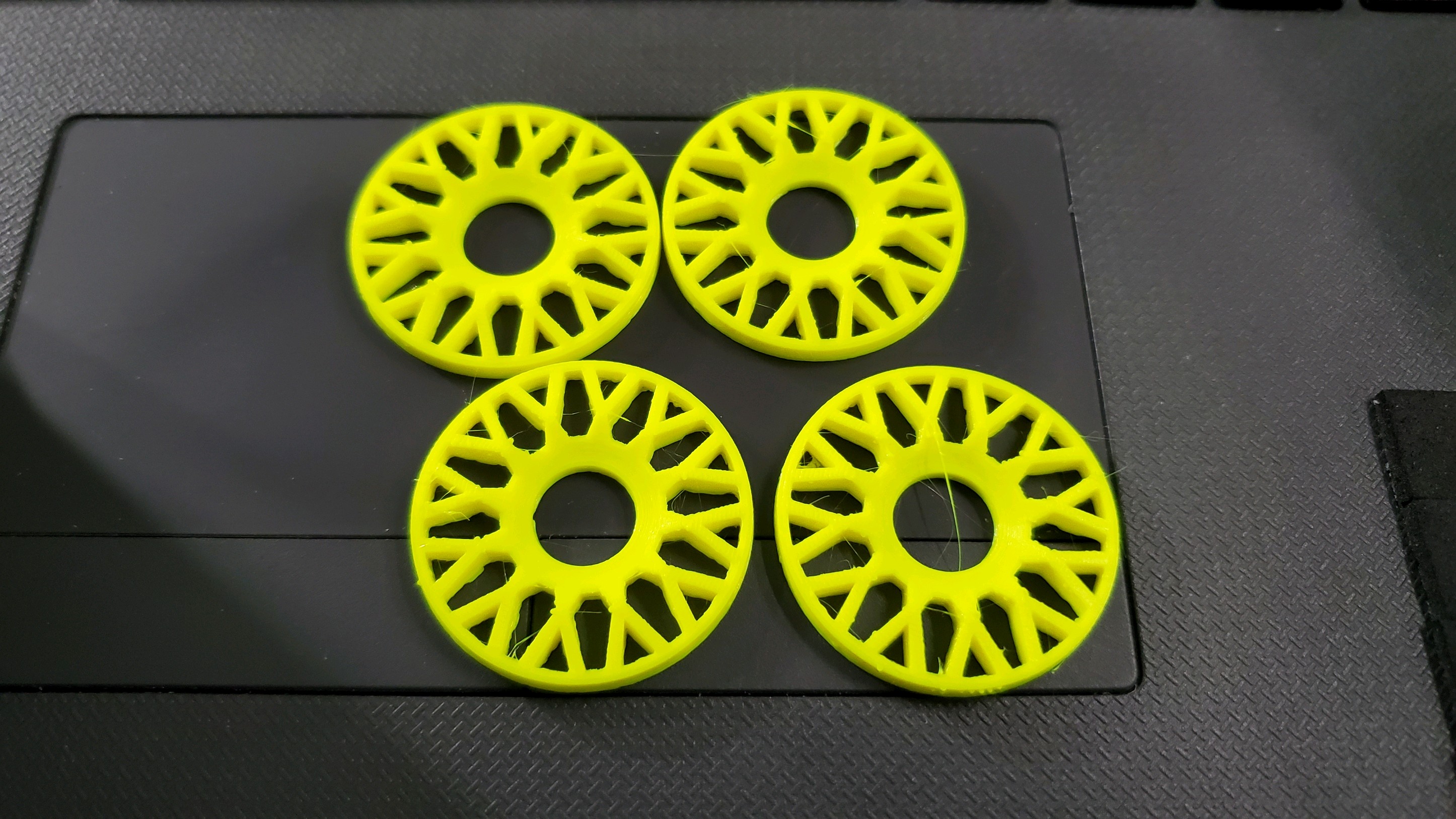

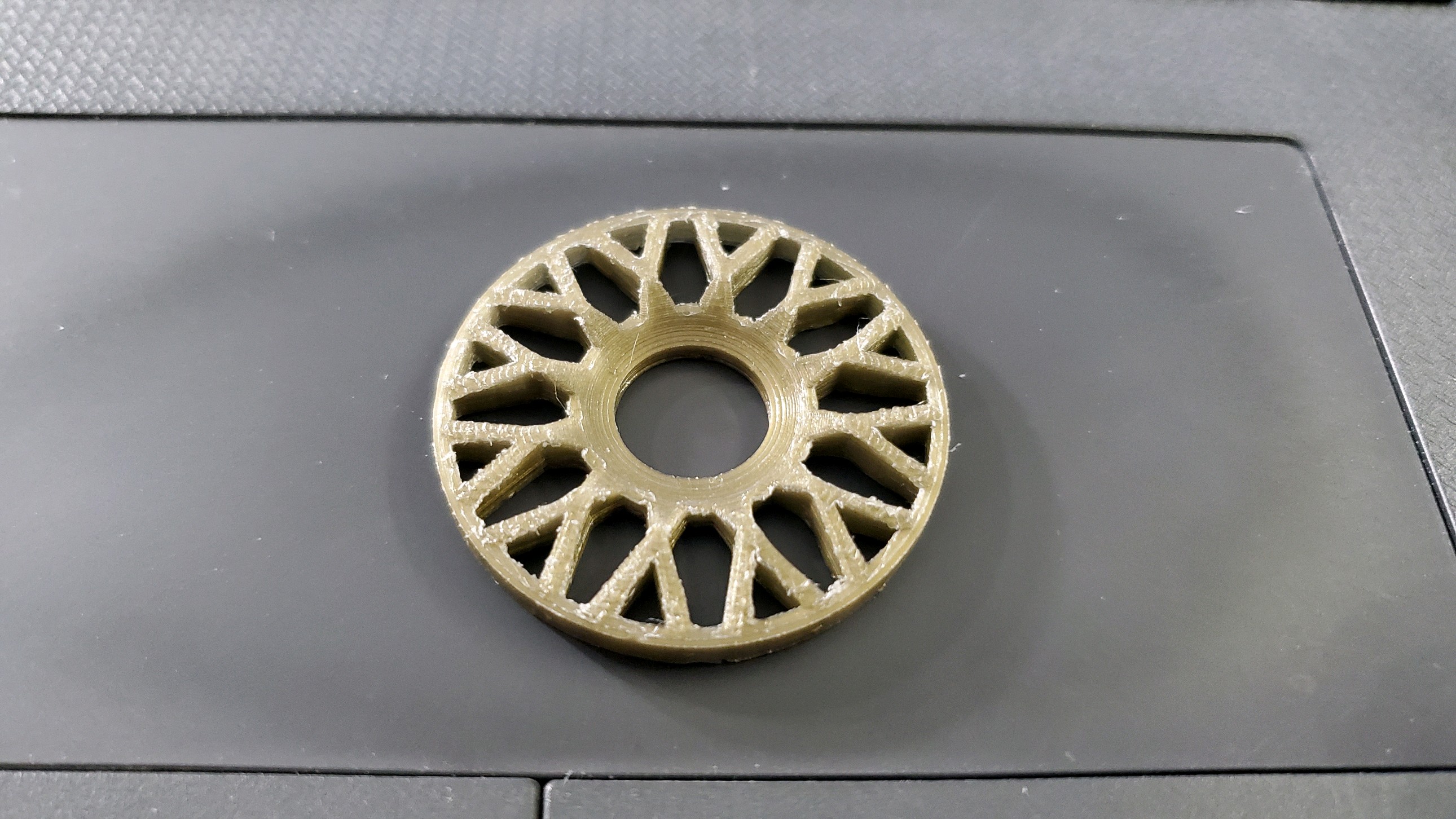

Here you go 😁
