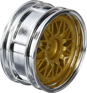

GreenBar0n wrote: Mon Aug 12, 2024 9:25 pm As I get closer to running this DS, I'm not really comfortable gluing and peeling out on these tires that are irreplaceable, that's one of the very things that makes me not run some of my vintage RC's. I'm starting to think about foam instead, won't look as good, but I don't want to ruin the DS wheels and tires, too awesome.
Could get a set of plastic 12mm wheel hex's and some Tamiya TAM50548 or other tasty plastic wheels:
Fronts... super glue the wheel hex into the wheel, once dry drill the axle hole out to 3/8's then put a pair of 3/16x3/8 flanged bearings in and bolt the wheels up.
Rears... hex's slide right onto the axles, everything bolts up like normal.

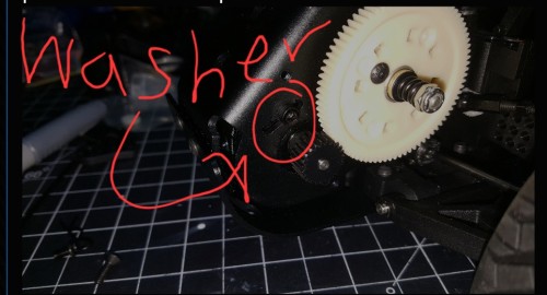

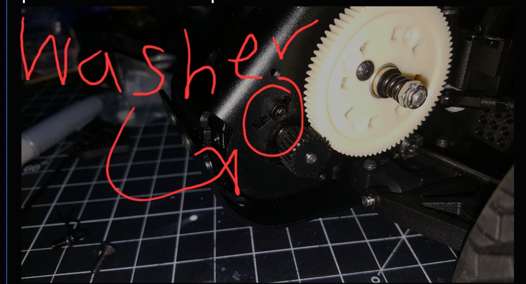

GreenBar0n wrote: Tue Aug 13, 2024 5:05 am If you intend to use a brushed motor, it will fit the DS without issue. If you intend to use a brushless motor, you may need to mod the motor mount.
Brushelss on the left, brushed on the right.
I had to file the motor mount a bit to get the 3650 brushless motor to fit, the silver dot over the top screw hole had to be filed. Would not have gone in correctly.
DS kit did not include the motor mounting screws, which are metric M3, or 3mm x 6mm. Went with 23T pinion with the 81T spur.
$32 Reedy servo does not comes with horns, or screw. Had these laying around luckily.
Chassis entirely completed.
Will finish spraying the bodies tomorrow.
You gonna run (a) washer(s) on the motor screws?
