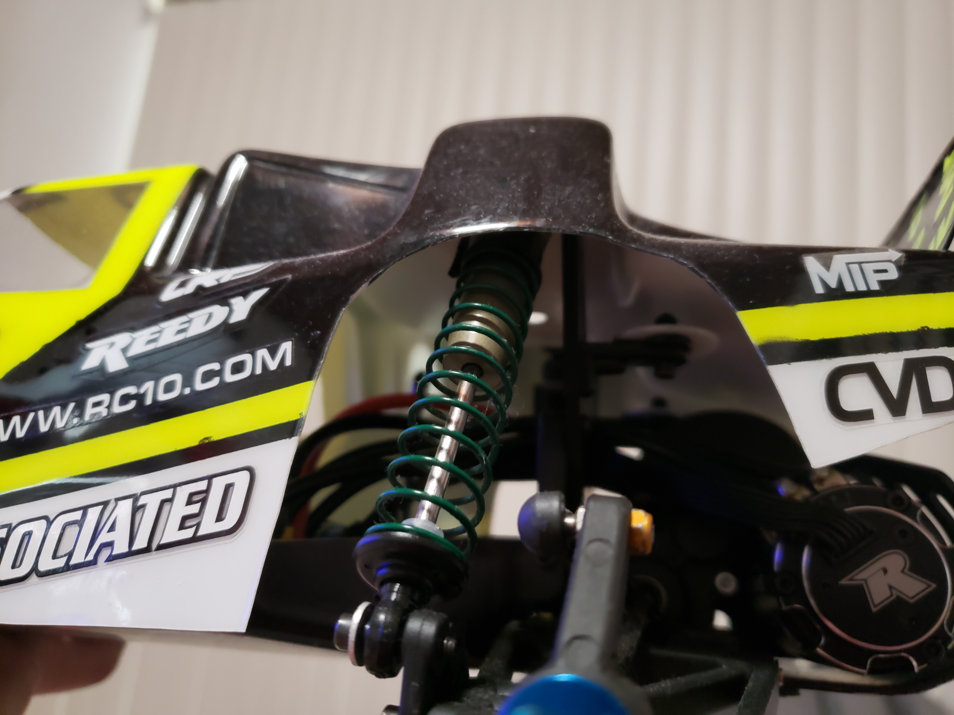

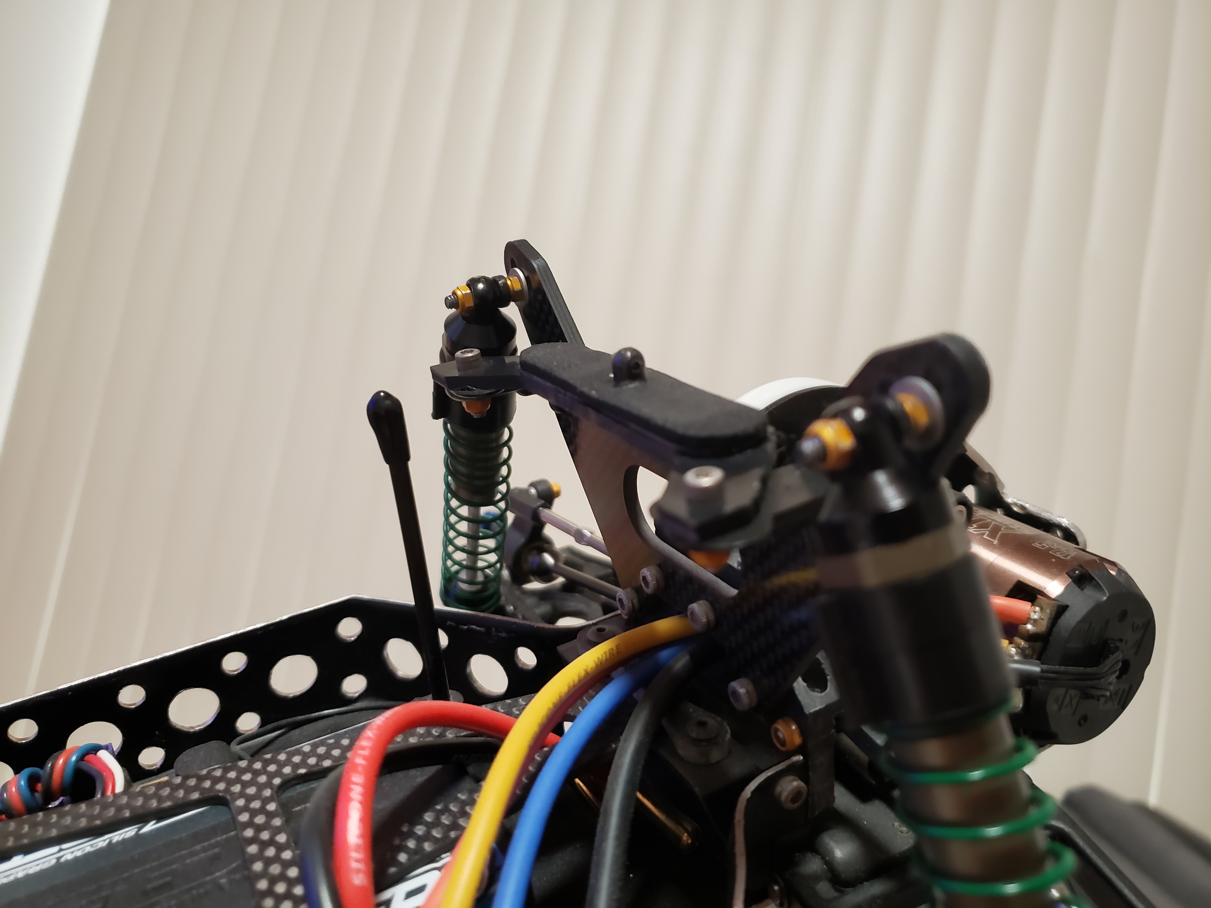

So, it looks like the T3 body fits okay after all. I had one fitted to a 10t with a custom kydex mount and stock pieces to mimick a T3 shock tower rest and mount and I believe it would probably work just as well on a T2. I have my T2 shock tower mounted in the stock position and the pic's are a little blurry but you can see the amount of space you have to work with.
