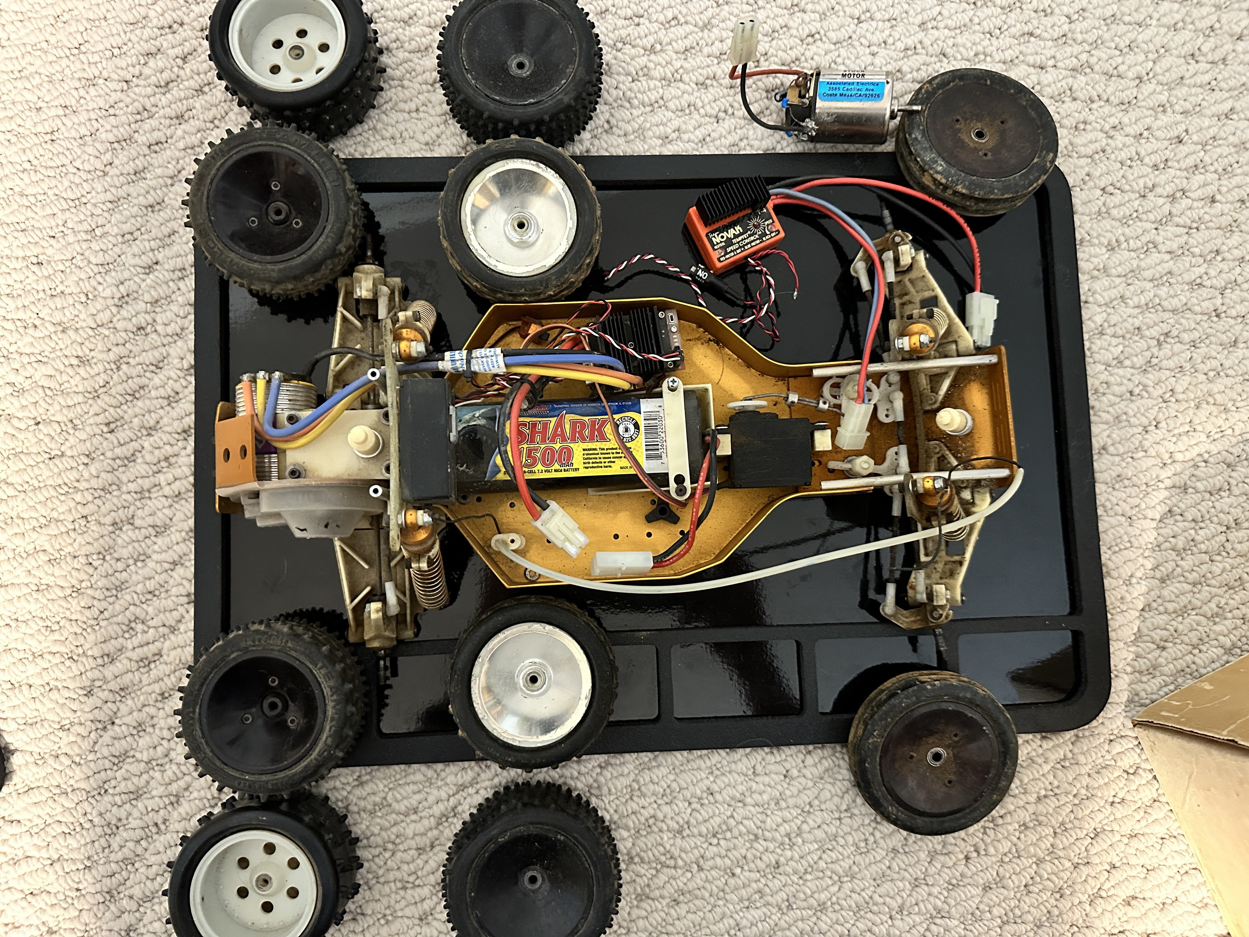

This popped up on FB Marketplace only about 10 minutes from my house for a very reasonable price. Complete with a Novak T4 and original stock motor, plus a Novak brushless system that I know absolutely nothing about. Not sure if that's worth anything, but still pretty cool. Chassis is very straight and clean. Not sure what I'm going to do with it yet. Disassembly and cleaning process beginning now....

Box and manuals along with 2 vintage Novak systems. That has some nice looking extras. All you need is a transmitter.fotomatt1 wrote: ↑Sun Nov 10, 2024 2:04 pm This popped up on FB Marketplace only about 10 minutes from my house for a very reasonable price. Complete with a Novak T4 and original stock motor, plus a Novak brushless system that I know absolutely nothing about. Not sure if that's worth anything, but still pretty cool. Chassis is very straight and clean. Not sure what I'm going to do with it yet. Disassembly and cleaning process beginning now....

Already have a transmitter and receiver. Just need to replace the turnbuckles, ball ends and cups and wheels and tires. I have two clear Protech bodies, and two painted by Andy Jacobsen so I'm mostly good to go. Just wish the chassis was drilled for a Stealth transmission, but I'll live with the six gear. Part of me wants to pick up a graphite chassis and move everything over to that.JosephS wrote: ↑Sun Nov 10, 2024 11:31 pmBox and manuals along with 2 vintage Novak systems. That has some nice looking extras. All you need is a transmitter.fotomatt1 wrote: ↑Sun Nov 10, 2024 2:04 pm This popped up on FB Marketplace only about 10 minutes from my house for a very reasonable price. Complete with a Novak T4 and original stock motor, plus a Novak brushless system that I know absolutely nothing about. Not sure if that's worth anything, but still pretty cool. Chassis is very straight and clean. Not sure what I'm going to do with it yet. Disassembly and cleaning process beginning now....

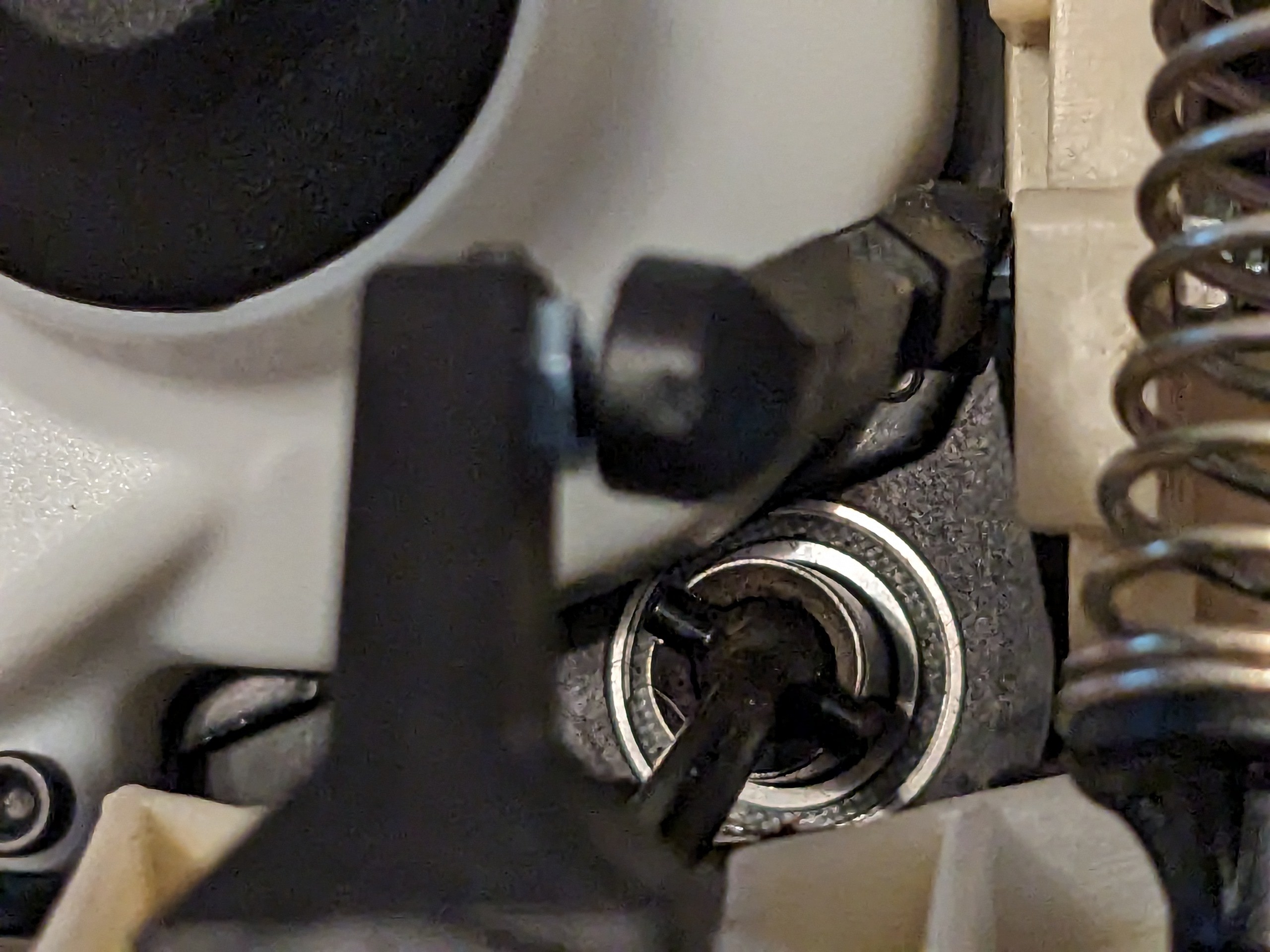

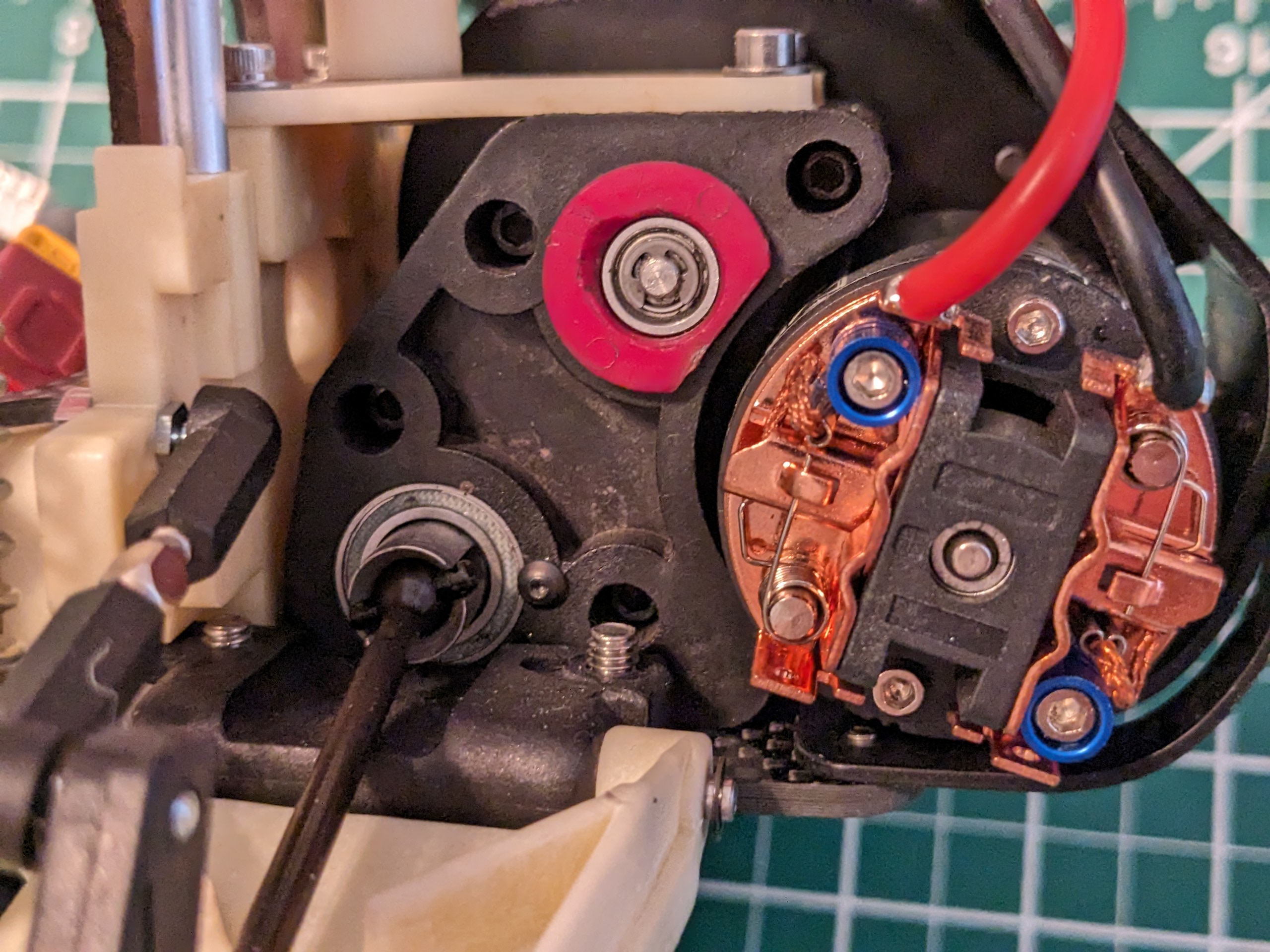

For the 6 gear trans, have you looked into the outdrive bearing mod? For an RC10 runner with a 6 gear trans, it seems like a must do to me. The original bearing setup with the outdrives seems like it gets sloppy/floppy and I worry about the outdrives then chewing up the idler gears. It is nice that AE now sells idler gears again if they end up being needed.
I do the mod just by adding the bearings and then one 2-56 screw and washer to keep the left side bearing in place. On the right side the motor plate will keep the bearing from walking out.

How I do it, I put a sleeve over the outdrive that keeps the big 5/8" x 3/8" bearing from moving further in. It could also be something in the gearbox case as long as it doesn't touch both the inner and outer bearing races. The screw on the outside prevents the big left side bearing from coming out of the gearbox case.

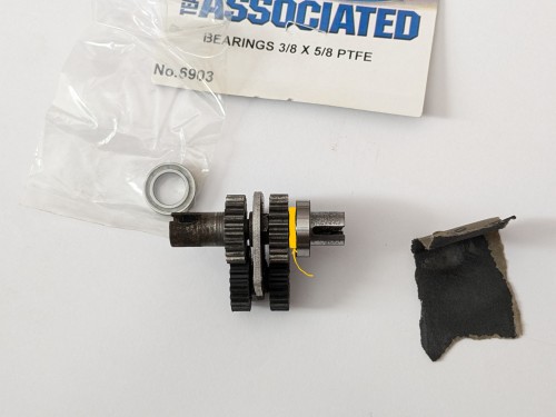

A sleeve/tube can be added on the outdrive to keep the bearing spaced away from the gear (closer to dogbone end) as shown in this marked pic.

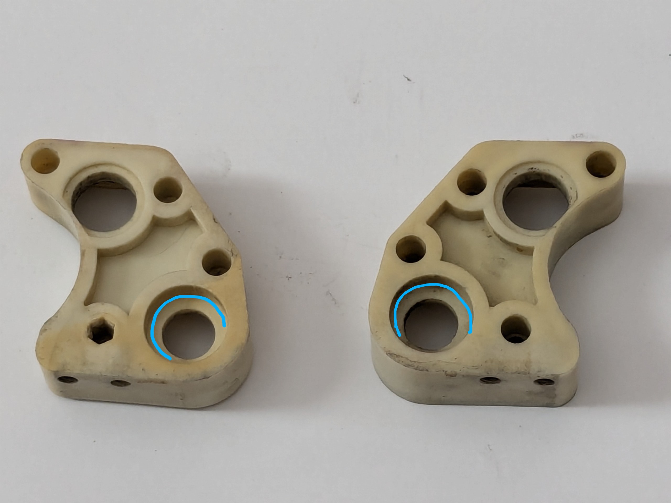

I think that a thin 5/8" o-ring in these 2 spots would keep the outdrive bearing spaced outward instead of the brass sleeve. The left side would still need a screw to keep the bearing from walking out, and right side has the motor plate to hold it in.

I just use the inner race from a worn bearing instead of the inner bearing for the outdrives.
One bearing in the outdrive and the new outer bearing.

Same, I don't like to overconstrain it since the bore in the case and idler spine are not always exactly aligned. Some work great with three bearings, others will bind up a littlejuicedcoupe wrote: ↑Mon Nov 11, 2024 4:27 pm I just use the inner race from a worn bearing instead of the inner bearing for the outdrives.
