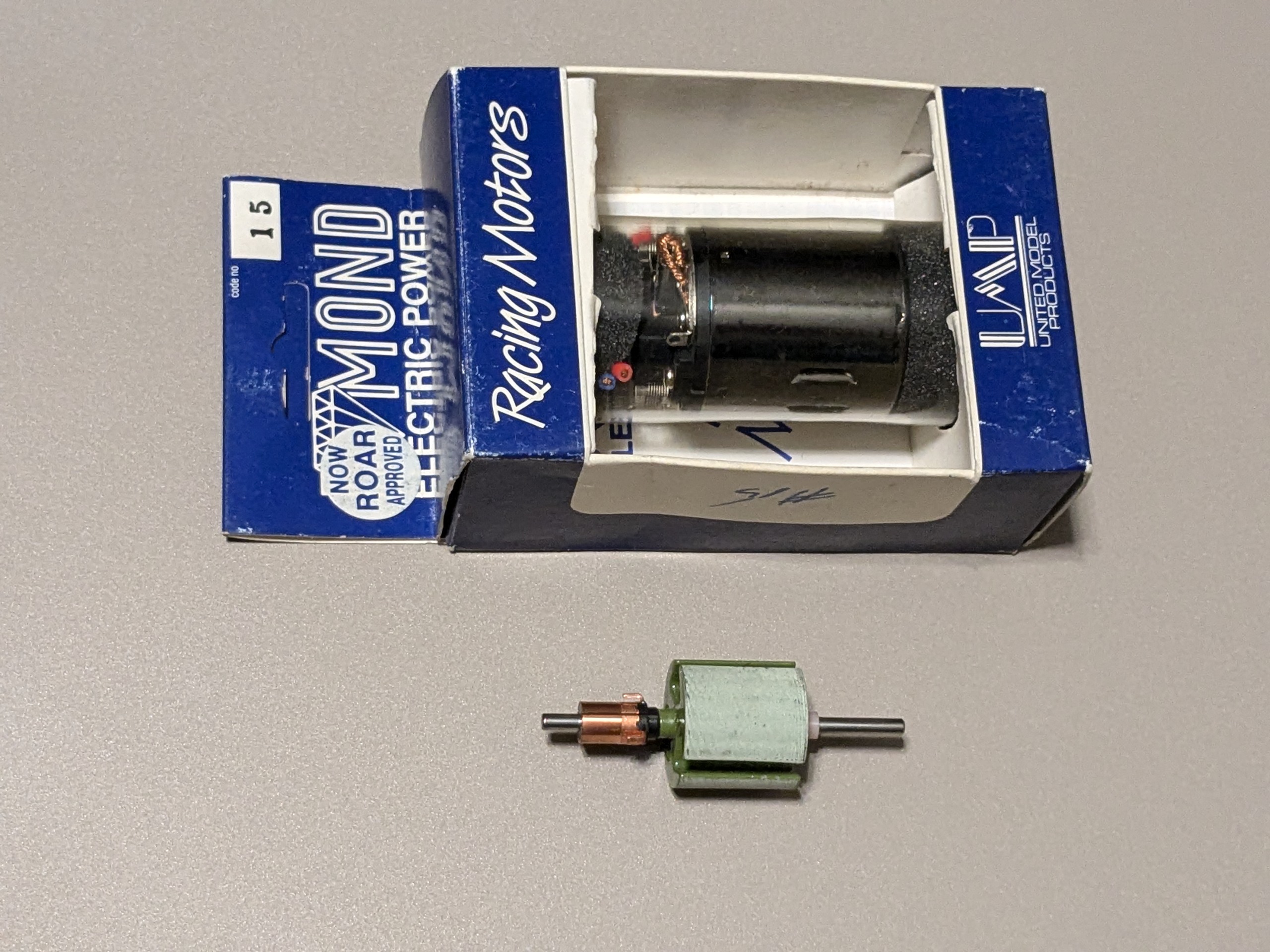

The ol' lady is watching something stupid, so it got me thinking about hand-wound motors. Has anyone ever made one? Is it possible these days? I have not googled this for the sake of conversation. I'd love to make one with a custom label.

Dymond used to make a blank armature motor kit.

I feel like I want to wind a 17x2 for my Thunder Shot with a custom label called Thunder Down Under. Design to be presented at a later date.
