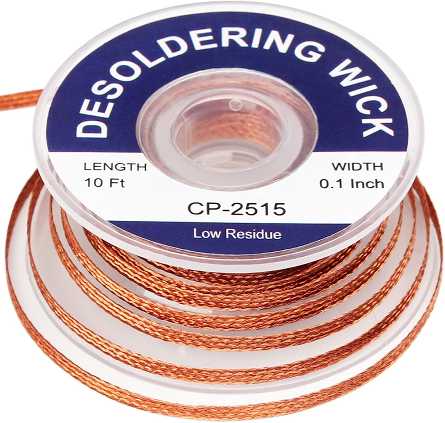

But I recently acquired a Kyosho Le Mans 240S where the previous owner soldered several caps directly to the can, in multiple places. The caps were in rough shape and I removed them. Now I'd like to remove the remaining solder as cleanly as possible. I'm considering again trying to wick it into some copper braid with flux and my hand-held iron on max heat, but this didn't work so well for me last time... maybe I just wasn't patient enough -- it's hard to get enough heat into the can. I also have a larger, gun-type iron, and may try that instead. 2 of the 3 solder spots are near the label, which I'd like to save, so wondering if I may need a different technique...?

Pick yourself up a solder wick, works wonders.
Also make sure your iron is up to the task, a 25w pencil tip iron won't cut it. Use an 80w flat tip, basically the same as what you'd use to solder batteries and 12g connectors would be fine.

I'll see what happens with my stronger iron. I'm wondering if my existing wick has oxidized too much for the flux to help. It seemed to work when new, but either it (or me) is not the same now. Will give another try regardless.

I find the wick works best when it's slightly tinned, don't cut the copper braid off at clean copper but where it starts to discolor from previous wicking. Melt the solder on the can as you would when you tin the joint to make a connection, then press the braid into the solder with the iron. Keep in mind that a little solder goes a long way in the wick so removing as much solder as you can beforehand is helpful.
I wouldn't worry too much about damaging the label as the whole process only takes about as much time as it did to make the initial joint, so if the label didn't melt in the first place why would it now? If you think things are getting too hot take a break and let things cool.
