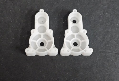

Machined delrin cases for SRB are finally here, and I had some bearing holders machined as well so I can offer the Tamiya version of the trailing arm kits. I'll have both on the website in a few days. To test the gearbox I made up some trailing arms for lay down shocks (as I lack any vintage roll bars to mount the shocks upright). The system works really well, I may end up just offering this as an option. This chassis is drilled for both the lipo tray as shown and Velcro straps.
The next parts made will be the spur adapters and rear cage mounts, followed by wide front end parts. Our existing power clutch fits with just changing to a 3mm adjustment screw. If these parts end up being worthwhile I hope to explore the cable drive as well.

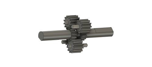

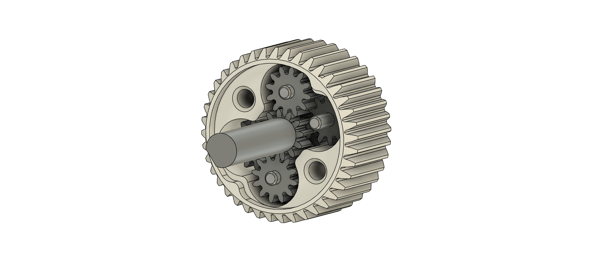

Re: Factory Works SRB X2 project
Been working on a diff as well. Tamiya has a ball diff and im not a fan of their design TBH. There isnt a lot of room and another ball diff on the market seems silly, so I am working on a planetary diff instead. Considered a bevel diff but the gears would be much harder to have machined. Tried working with off the shelf parts but they are just too big for the 40T gear. I think I can make this happen with 4 discrete CNC parts.
Ive got the Tamiya ball diff , much the same opinion , I like the diff idea you have there , always makes me think really hard to understand those ones .GoMachV wrote: ↑Sun Dec 15, 2024 1:51 pm Been working on a diff as well. Tamiya has a ball diff and im not a fan of their design TBH. There isnt a lot of room and another ball diff on the market seems silly, so I am working on a planetary diff instead. Considered a bevel diff but the gears would be much harder to have machined. Tried working with off the shelf parts but they are just too big for the 40T gear. I think I can make this happen with 4 discrete CNC parts.
