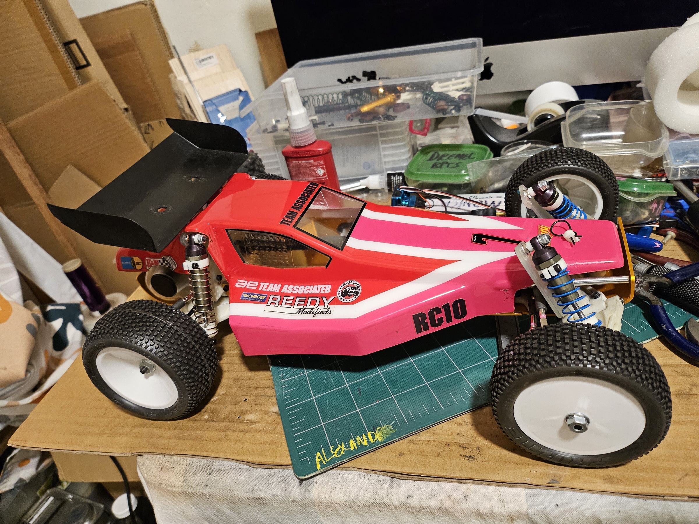

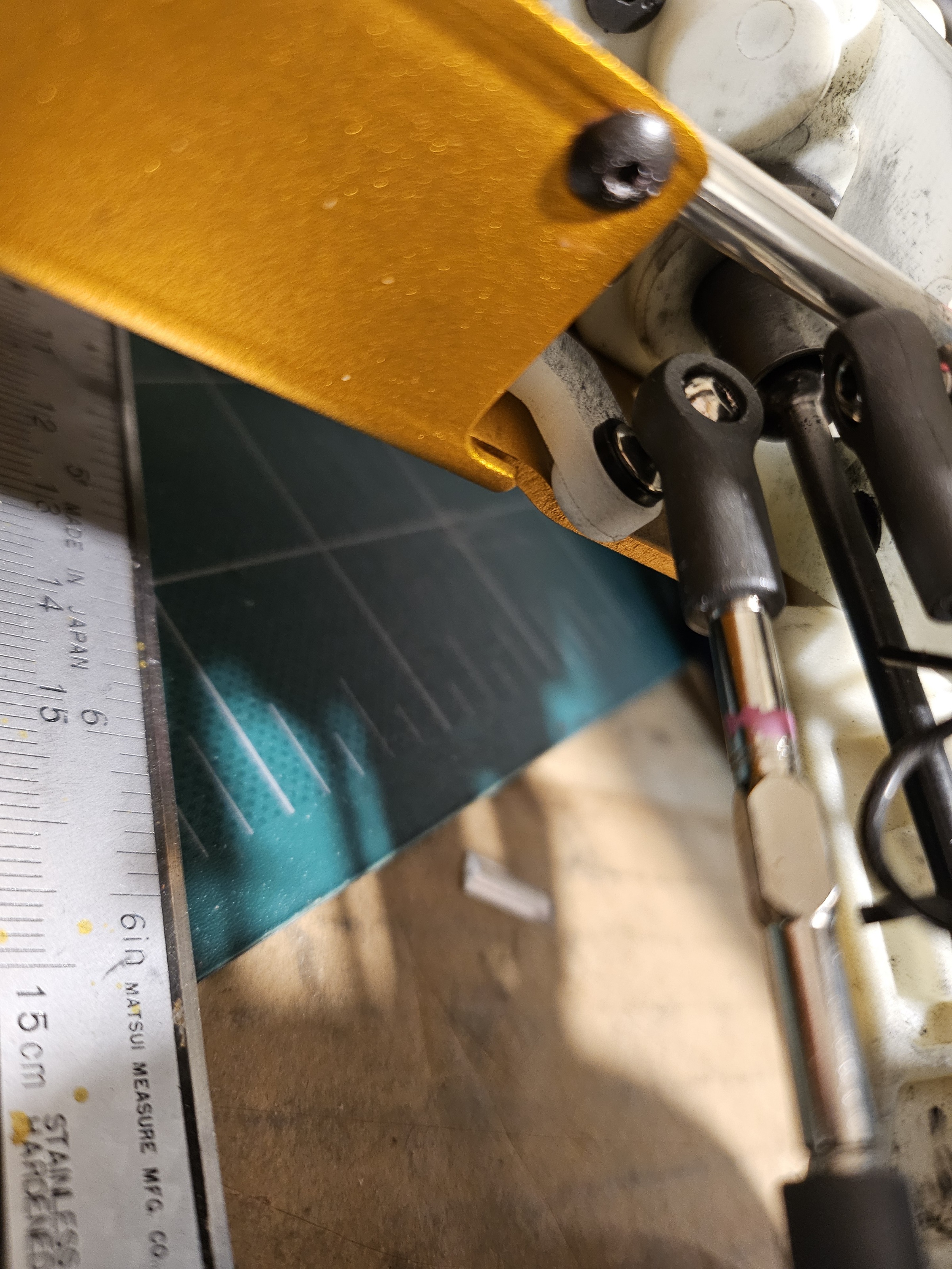

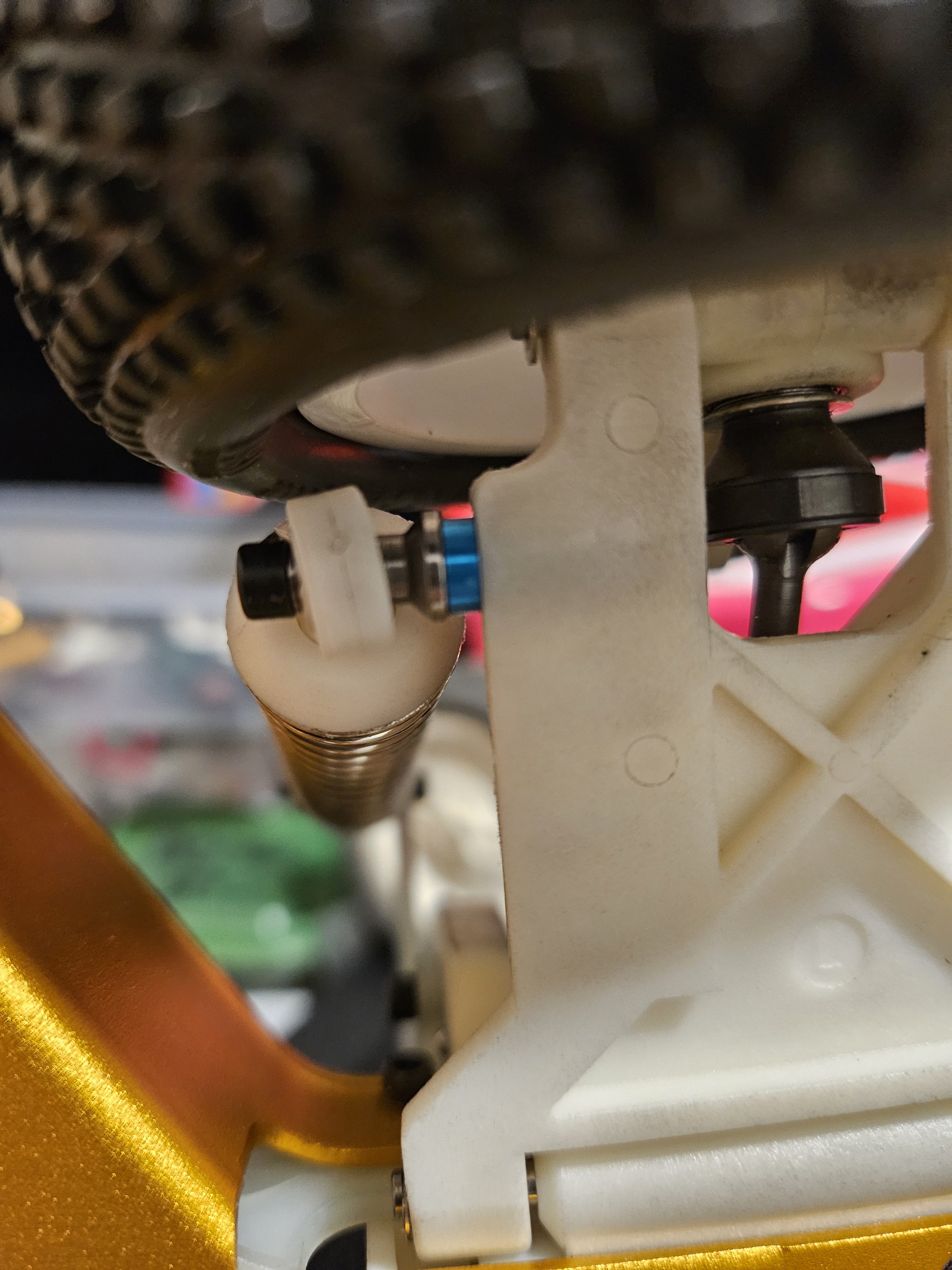

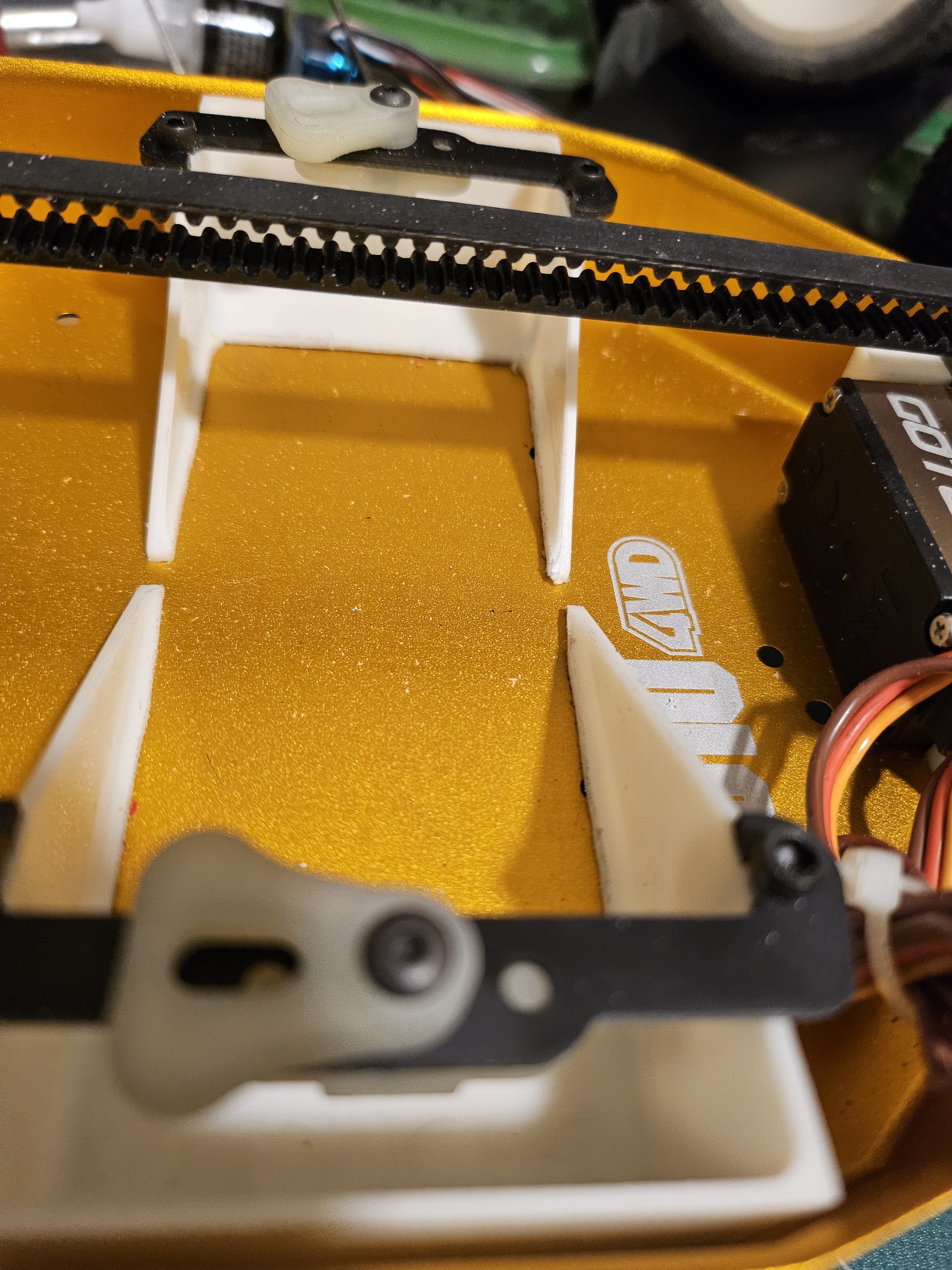

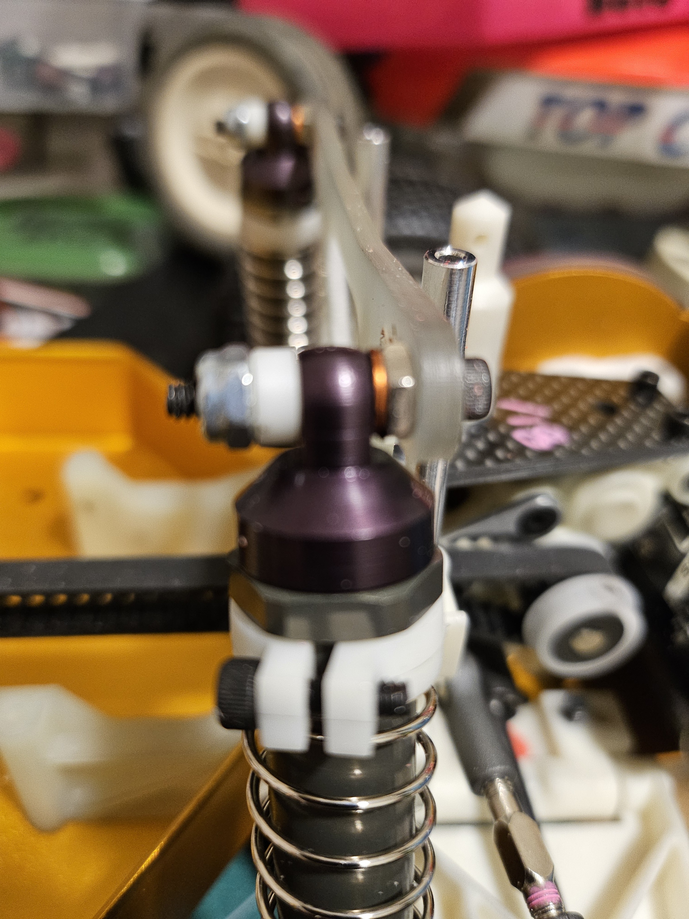

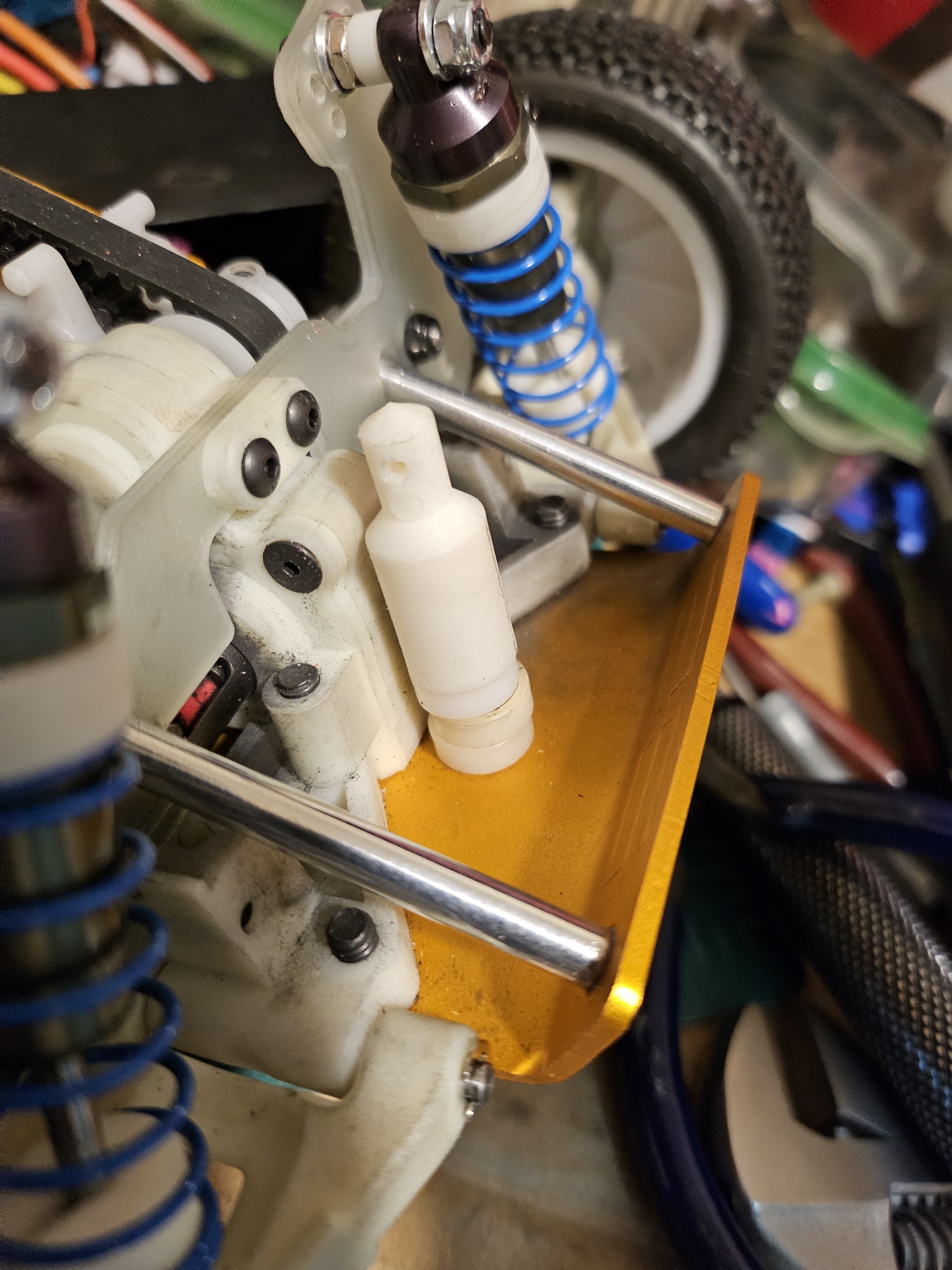

Finally finished the stock build.
Had to put 7 spacers in each of the rear shocks and use the short shock ball ends.
3 tamiya1050 plastic bushings under front body mount with a long screw i found in my rc10 box of bits (it's an aluminium Phillip head, so I don't know which car it came from)
Trimmed off bottom of battery trays so that lipo packs can sit 1.5mm lower
I'm at a lost how to deal with the chassis flex.
Should I run it as is?

We will have Factory Works chassis braces and aluminum pulleys in a couple weeks, I think you will find them worth the wait. Don't need to be used together, but the larger pulley has more belt wrap so it slips less, and the stiffener lets you run the belt slightly looser since you don't have to account from flex
Note that chassis flex and bending is pretty bad with the rerelease chassis in general, it's just more apparent as you can hear the belt skipping on the 4wd. With the new chassis brace if you are taking monster jumps you could well bend or break something else. These old pans just were never meant for the jumps on modern tracks. We would bend our stock chassis back after races back in the day and those were way smaller jumps.

Any thoughts on making a bolt on/through undercarriage protector/stiffener? I know an upper deck/brace would be a better solution, but enough fiberglass or carbon fiber still add some stiffness and could be a universal fit for all the tub chassis.GoMachV wrote: ↑Mon Mar 31, 2025 12:54 pm We will have Factory Works chassis braces and aluminum pulleys in a couple weeks, I think you will find them worth the wait. Don't need to be used together, but the larger pulley has more belt wrap so it slips less, and the stiffener lets you run the belt slightly looser since you don't have to account from flex

Would be a good use for a graphite chassis with a broken noseplate. The upper deck stuff is a better option and you can use less material to get the same stiffness.JosephS wrote: ↑Mon Mar 31, 2025 2:03 pmAny thoughts on making a bolt on/through undercarriage protector/stiffener? I know an upper deck/brace would be a better solution, but enough fiberglass or carbon fiber still add some stiffness and could be a universal fit for all the tub chassis.GoMachV wrote: ↑Mon Mar 31, 2025 12:54 pm We will have Factory Works chassis braces and aluminum pulleys in a couple weeks, I think you will find them worth the wait. Don't need to be used together, but the larger pulley has more belt wrap so it slips less, and the stiffener lets you run the belt slightly looser since you don't have to account from flex

Will the chassis brace mount to the rear "stiffeners" and the front gear housing? Similar to the YZ10?

I didn't find the added braces that AE made useful at all, so I didn't tie into them with our new brace. The brace will be out soon, but I will say for now at least that you can use any battery mounting and position without any clearance issue

I'll definitely be keen to get the pulleys and braces... although I wonder how the braces might fit... after all, the front tensioner is kinda in thr way.

Some pics of the minor "mods" i made to hopefully make it better.
I'll definitely pay for longer axles, both front and back... front +1.5, rear +2. Then i can run full droop.
We run on a rutted (often times) outdoor loose dirt track, so more droop is better...
Oh well... until the parts become available then!

The braces like we run on the Ten4 won't work well on the AE due to the tensioner as you mentioned. Our system for the AE car is vastly different than the one for our ten4
