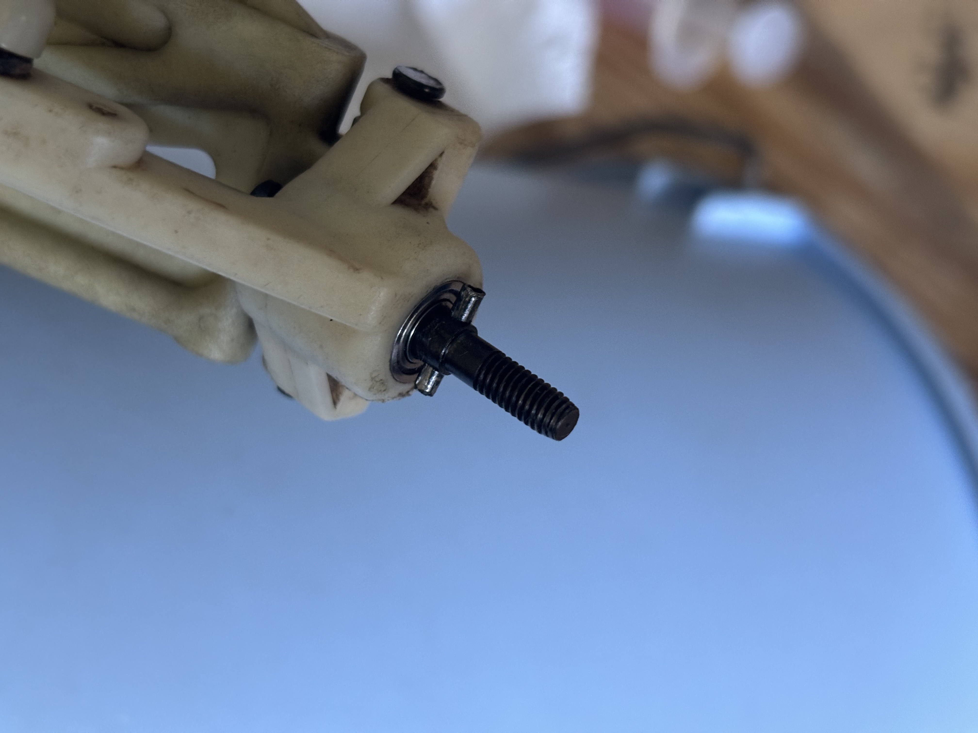

Any advice on how to remove this small axle pin? The other side was tight but came right out. This side is stuck. I have tried oiling it, but still not budging. This is a 2x10 split roll pin in the rear of an Outlaw Rampage Pro.

Thanks everyone, I was able to wiggle it out with needle nose. Definitely need a new pin now.

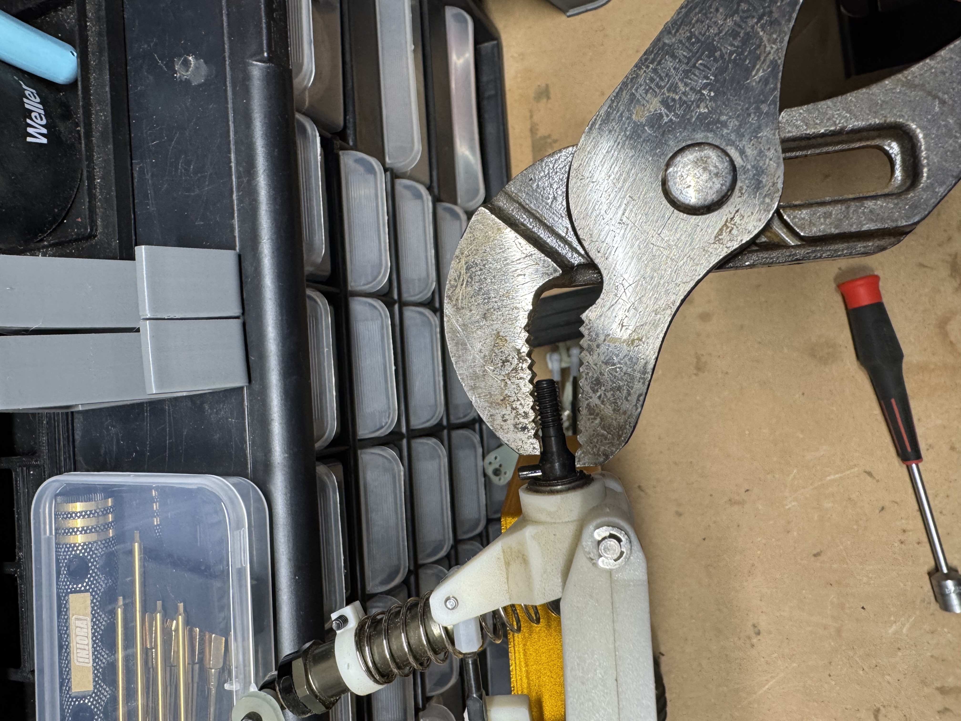

Any suggestions on safely removing the 4.5 ball ends on this thing? I already broke one trying to use a screwdriver to pry it off.

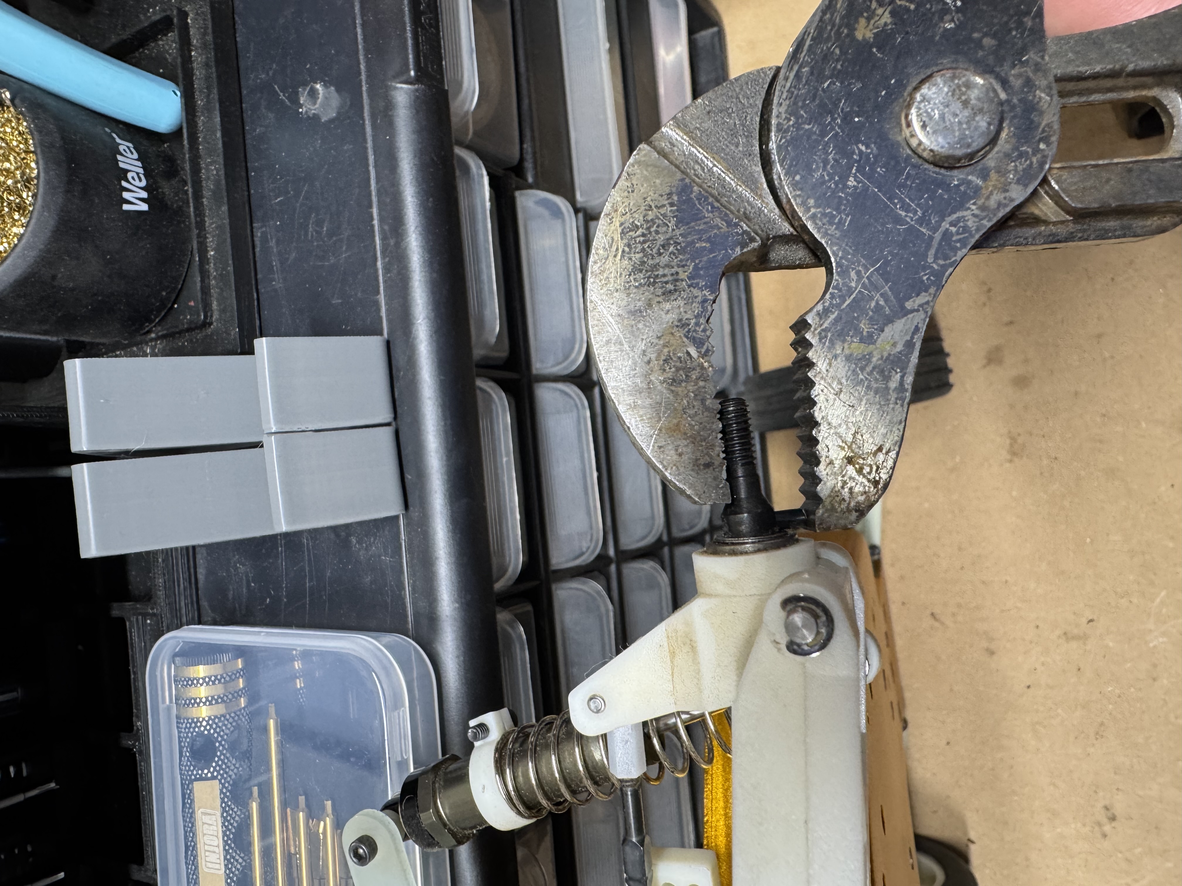

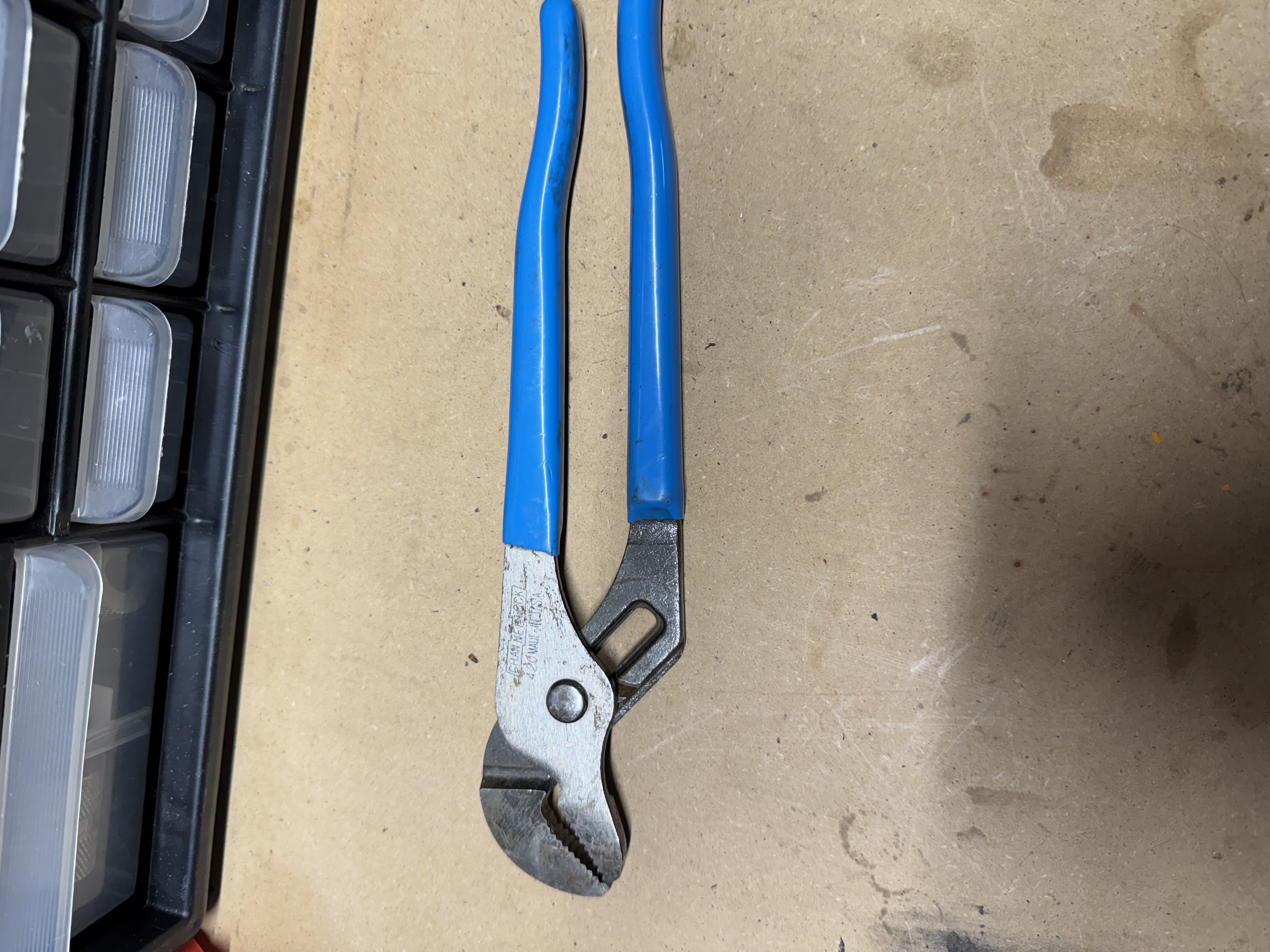

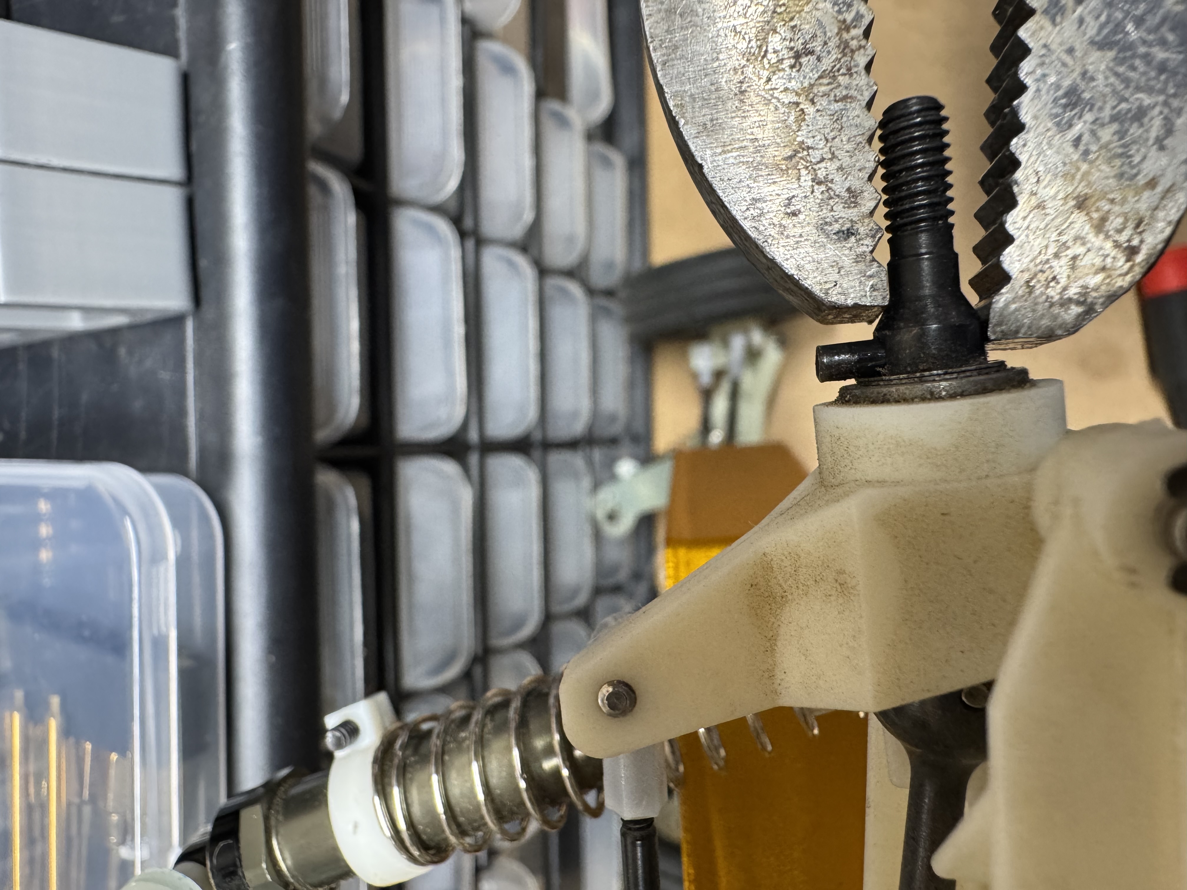

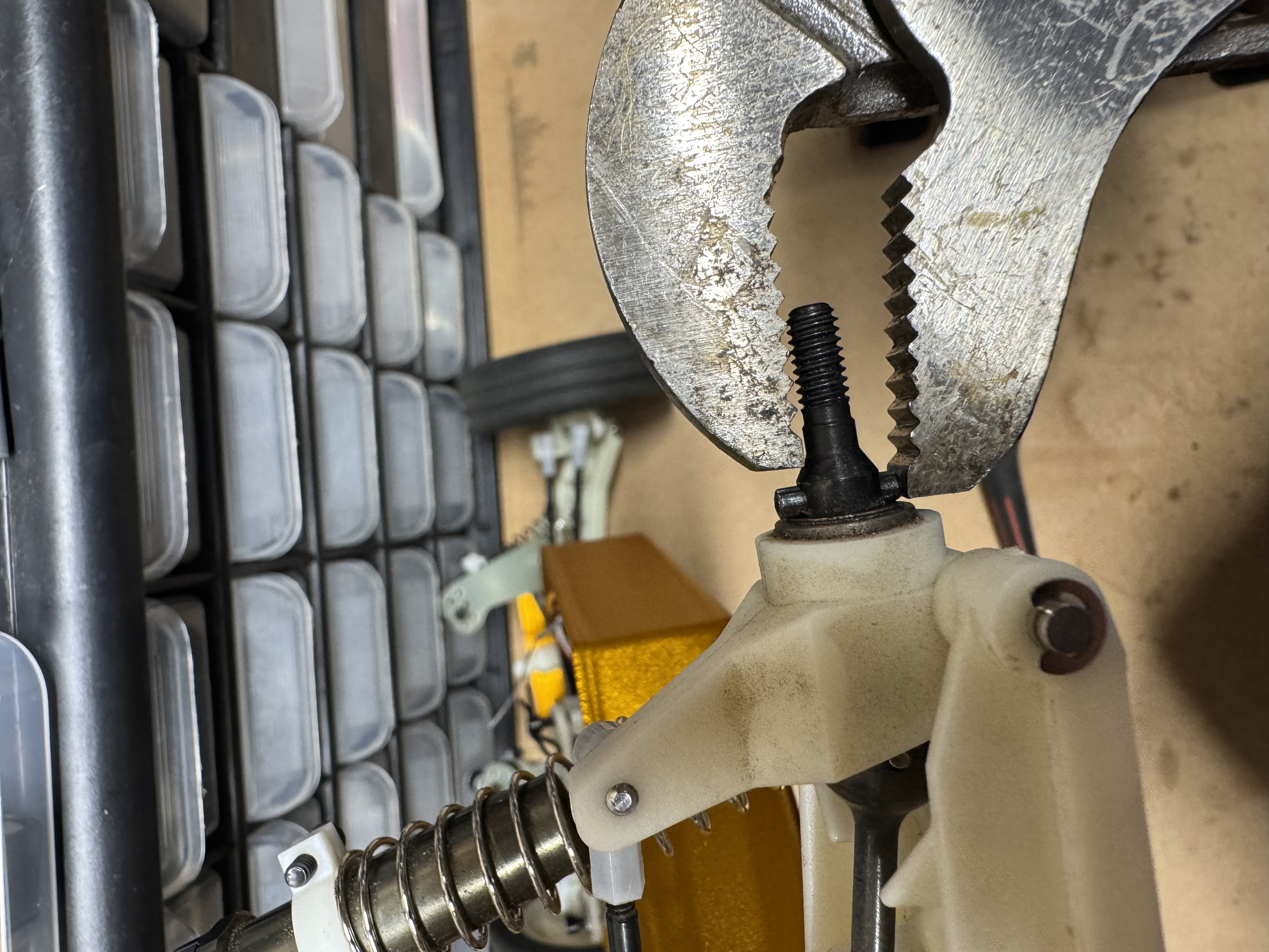

Brendan2904
Posts: 563
Location: New York
Has thanked: 268 times
Been thanked: 258 times
Re: Small axle pin removal
Post by Brendan2904 »
The jaws of channel locks are offset perfectly so that you can push with one side of the jaws and stabilize it with the other until it is flush with the axle on one side and then you can pull it out with the channel locks like a pliers after that.

Brendan2904
Posts: 563
Location: New York
Channel Locks like I said……
