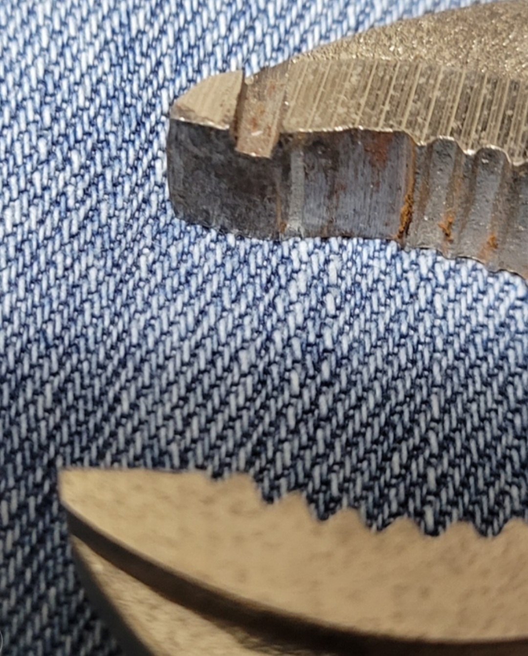

Posts: 3535
Has thanked: 268 times
Been thanked: 2094 times
Re: How to get roll pin into rear axle
I modified some cheap pliers to install roll pins.

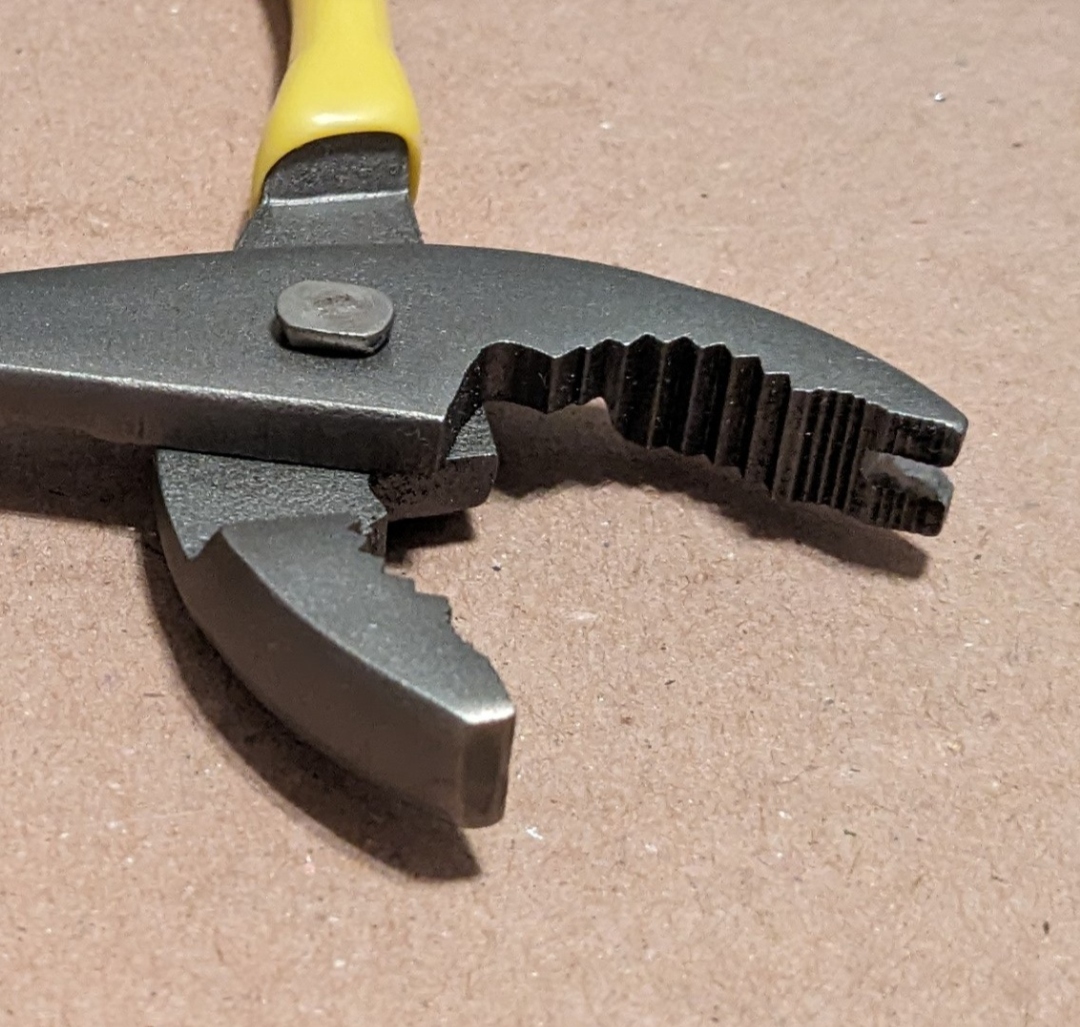

Posts: 3808
Has thanked: 2604 times
Been thanked: 2977 times
I also modified a pliers. They are very easy to install now.

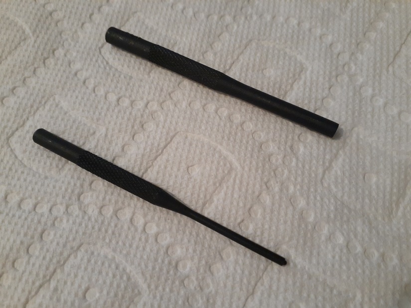

rctenracer
Posts: 1280
Been thanked: 81 times
Post by rctenracer »
I use a Roll Pin starter punch and finish with a Roll Pin punch. The Roll Pin starter punch is hollow and holds the Roll Pin to just get it started into the axle.

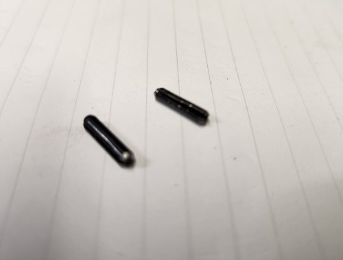

R6cowboy
Posts: 1483
Location: Mendota, IL
Has thanked: 871 times
Been thanked: 903 times
Post by R6cowboy »
Miraculously, one 1 inch pin became two 7/16" pins on the first attempt.
