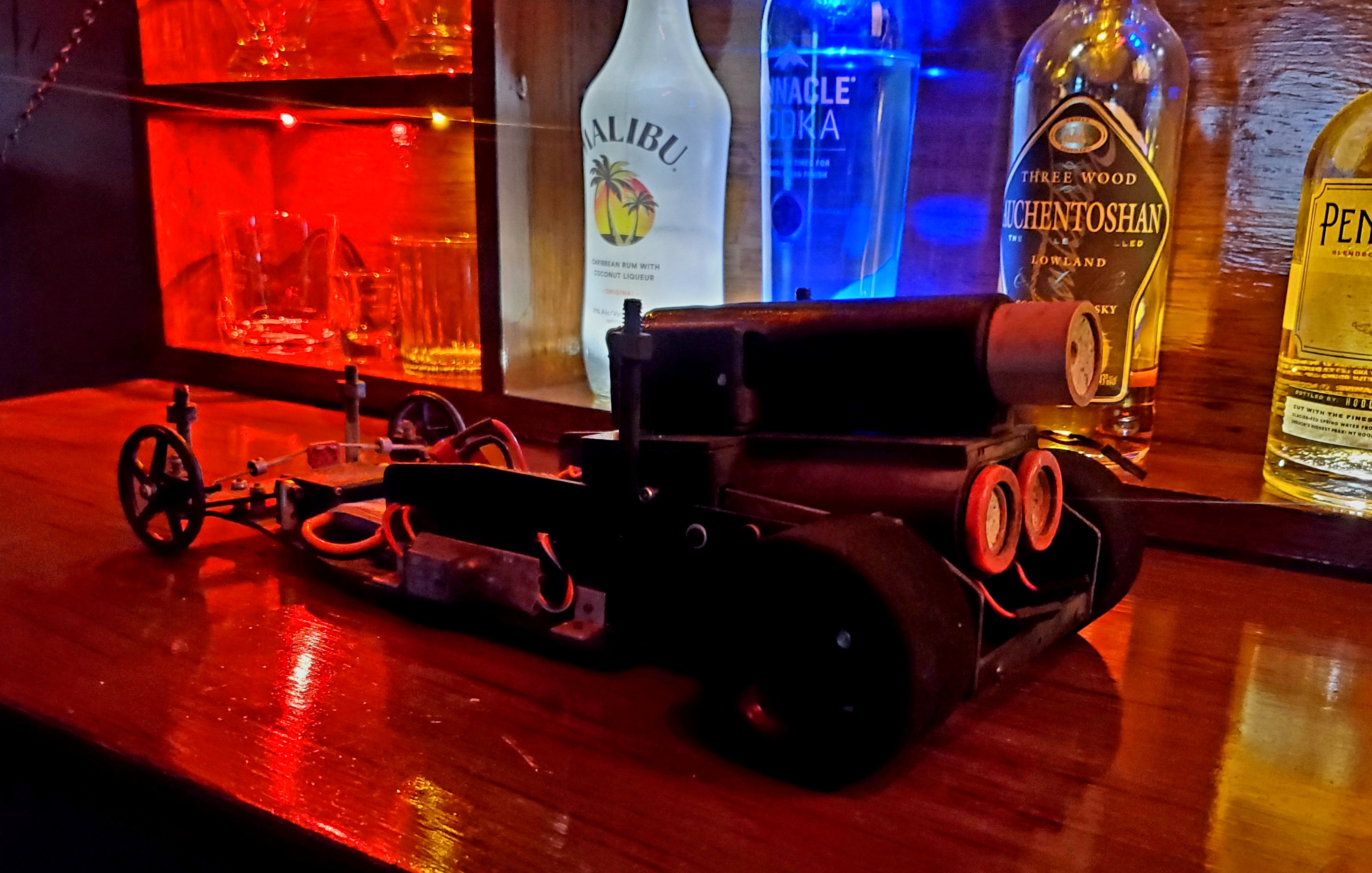

Car looks like a hand-full. 8)

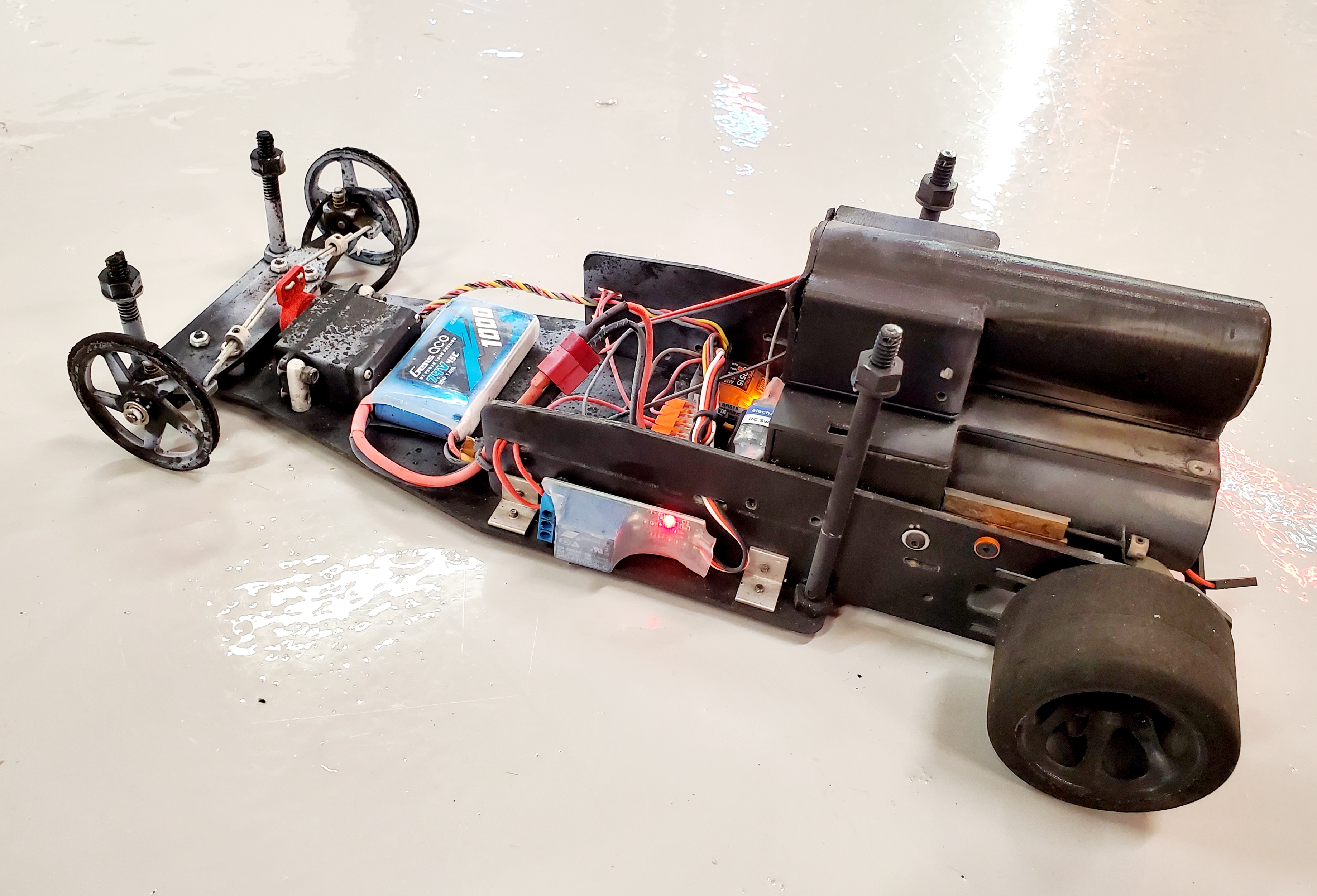

That engine have a delay charge?
6mph short of some serious crap :lol: can't wait.....
coxbros1
Posts: 2463
Location: Energy, Illinois
Has thanked: 2680 times
Been thanked: 2338 times
Re: Old School Rocket Car Build
Post by coxbros1 »
RC10th wrote: Wed May 03, 2023 8:34 pm That engine have a delay charge?
Yes...all 3 engines in it did...two "e"engines have blown up twice at ignition now!....they came from hobbylobby...my "Fs don't have the delay charge tho...gonna set that place on its ass next time i run...going with new engine mounts...two single mounts, one on top of the other...one "D" and "F" all in at once...should run 96ish according to my calculations(66.9Ns)...I need 69 Neuton Seconds of Total Impulse to hit 100mph

It would be interesting if you changed nothing but put a cinder block a foot or so behind the car and see if your MPH improves.
My engine stuck out behind the car so I could place it right up against a solid object, yours is just inside the body so I worry about the blast ricocheting back inside your car.
