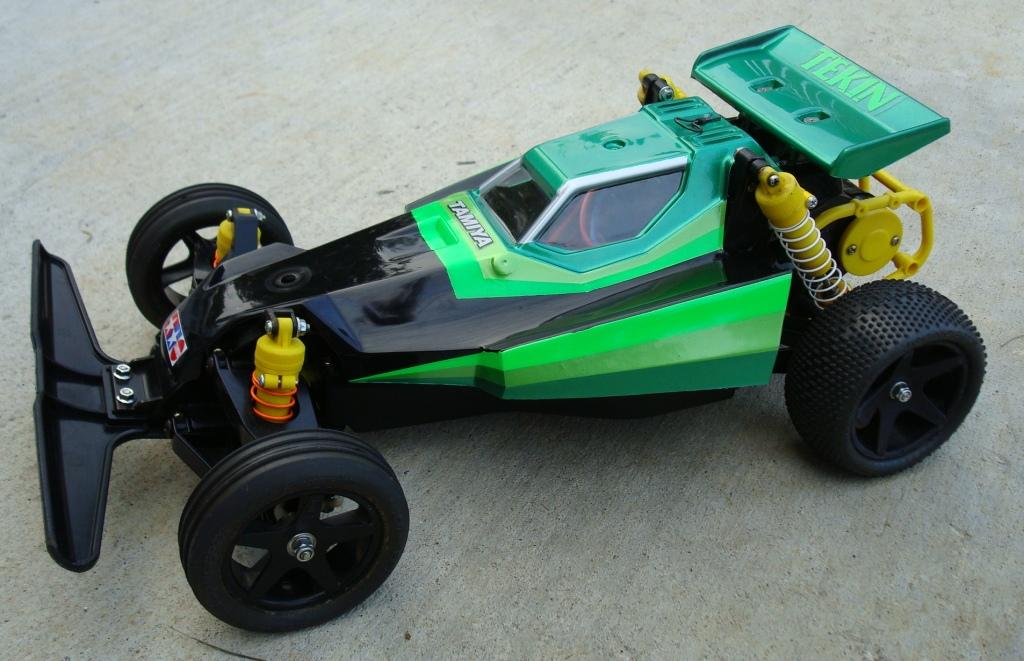

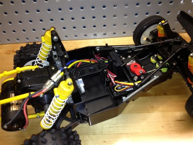

Brandon G
Posts: 2106
Location: Nashville, TN
Re: 2011 Vonats Falcon
Post by Brandon G »

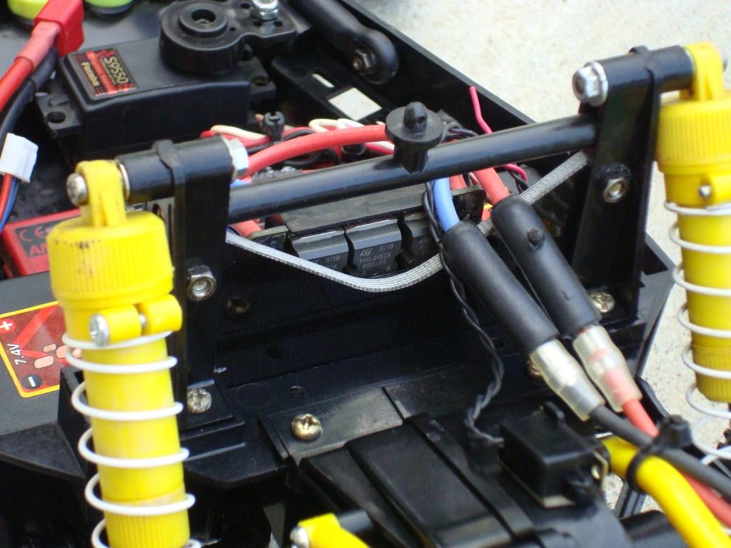

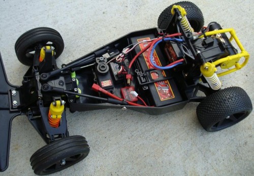

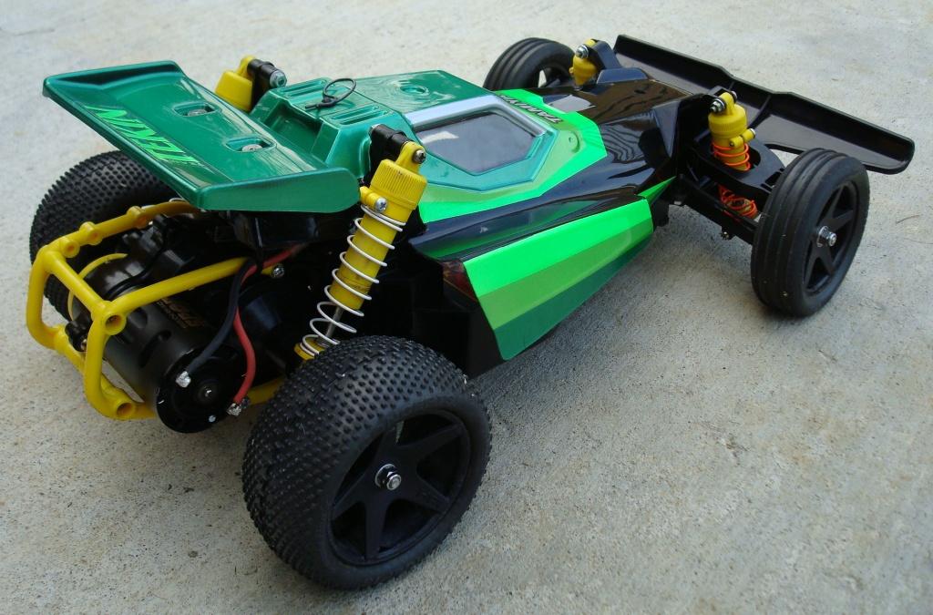

Some pics of the car in full race trim.
The only part I broke all weekend was the front body mount post. Snapped off flush with the chassis. I had 1 occurance where a dogbone popped out, but it was due to the rear pivot pin backing out. It was questionable from the get go as it would never tighten completely due to the previous owner stripping the plastic in the arm. The righr rear shock bladder let go and blew 1/2 of the shock contents all over the rear of the car, luckily Erich had a rear arm and a bladder I could borrow.
The braces I made for the front kept everything attached. After the main I noticed one of the 2 bottom screws holding the front end to the chassis was completely gone! They did their job. BUT there are cracks stemming from the holes I drilled at the midpoint of the chassis for the braces. I will probably pick up a fresh chassis from the ebayer staduim blitzer part out guys.
Anyway, it was what it was. My best attempt at making a non race buggy do better on the track. Newer rubber is the single best improvement. Steering the second best. I dialed my dual rate down to about 85%. It didn't look like it had much throw after that, but steered maybe too much still. I ran 20wt Losi oil all around in the shocks, orange Losi short springs in front, white Losi springs in the rear. I opted for the larger 19 tooth pinion with the handout Sport tuned motor. This thing was too fast for the track! Rarely did I get to stretch its legs out on the back straight. It was simply not stable enough to keep on all four carrying too much speed into the sweeper at the end of the straight. I was running HPI superstar 2.2" wheels with J concepts rounders in front, Double D's in the rear.
And the wing made it unscathed! I did have my share of crashes too.

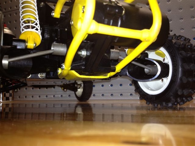

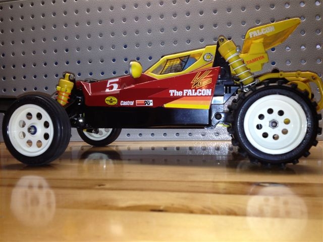

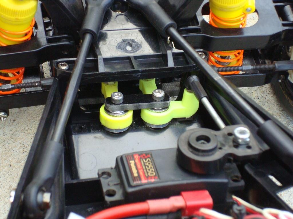

Update for this model:
I sent Brandon a new chassis, for which he fabricated a new servo mounting plate, and a pair of reinforcement plates for the sides of the chassis where the custom front braces mount - all made from FRP, and all turned out awesome!
Brandon has mad skills!
I'm using Tamiya wheels (Fox / Wild One)
Thorp 'Dirt Burners' steel axle and dogbone setup
Tamiya TEU-104BK ESC
Tamiya Sport Tuned motor
Hitec HS-77BB servo
Futaba 2.4 GHz Tx/Rx
Tamiya Falcon (braced chassis, bell-crank steering, Fox wheels) 002_small.JPG
Tamiya Falcon (braced chassis, bell-crank steering, Fox wheels) 009_small.JPG
Tamiya Falcon (braced chassis, bell-crank steering, Fox wheels) 012_small.JPG
-dldiaz
Brandon G
Posts: 2106
Post by Brandon G »
Looks nice man.
I was wanting to do a different rear drive setup on the buggy, but everytime I looked, the Thorp dogbone conversions were ex-pen-sive. Settled for CRP dogbones. Never had any trouble out of em for the race. Definitely a nice addition to the buggy!

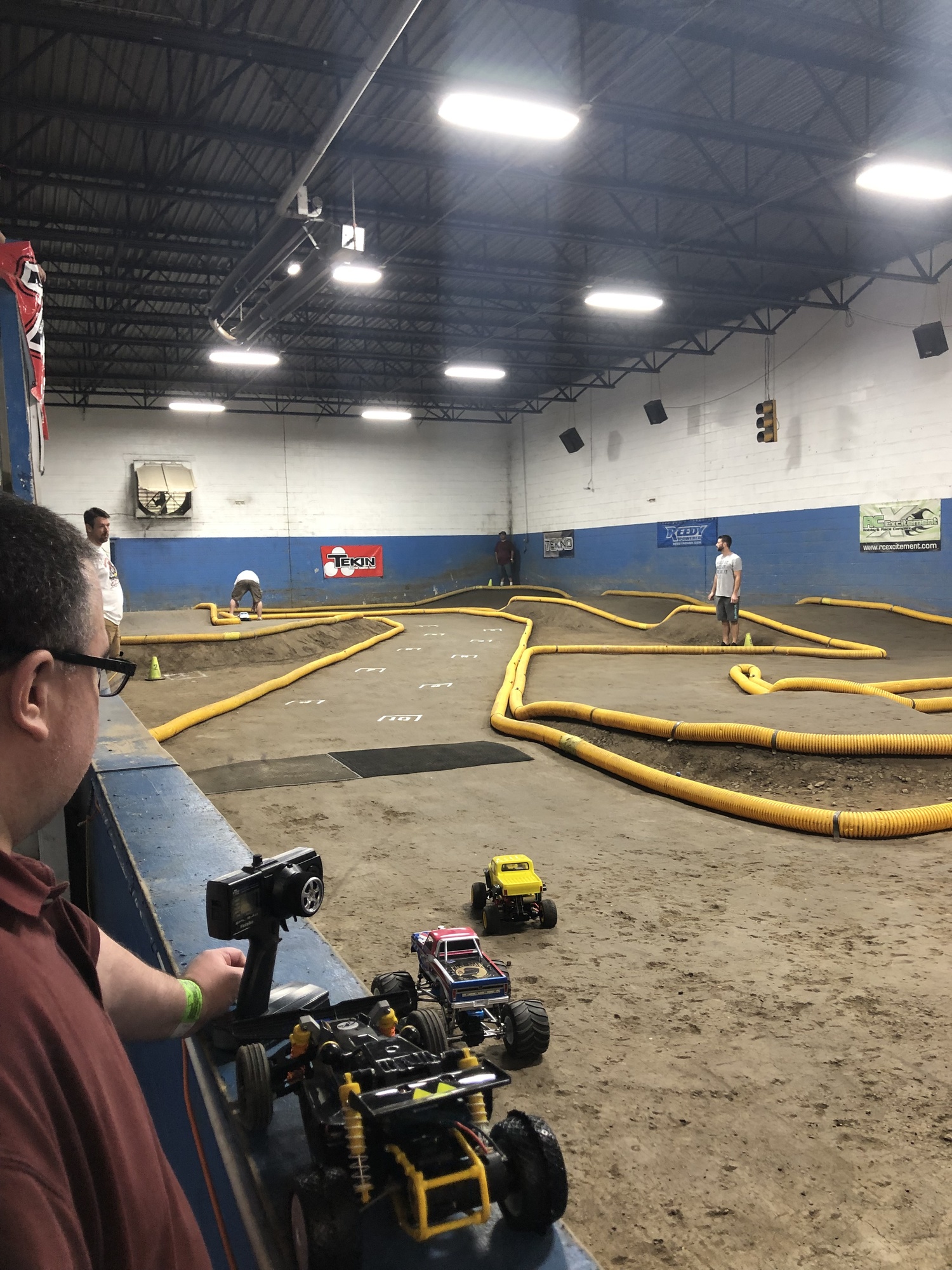

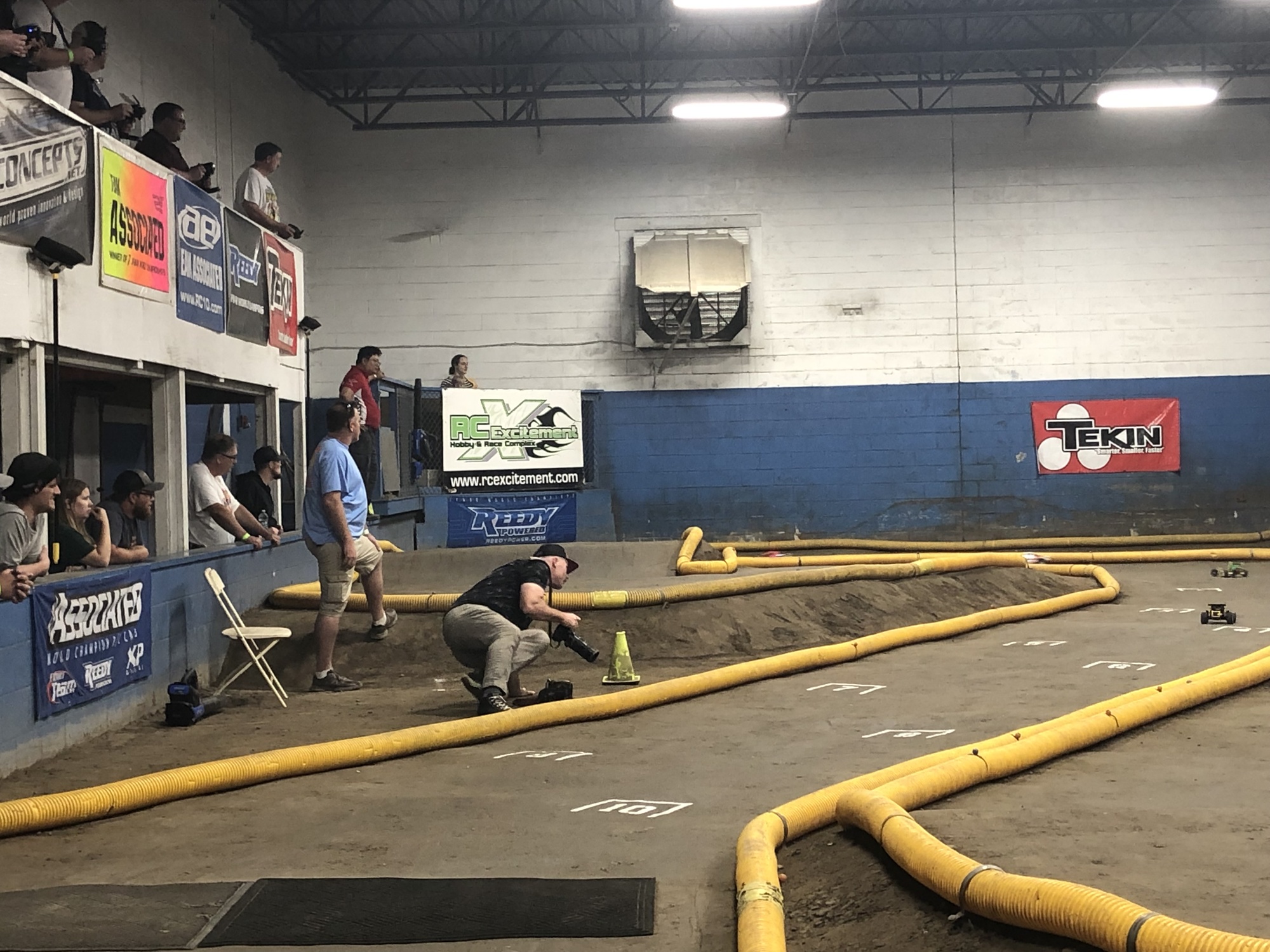

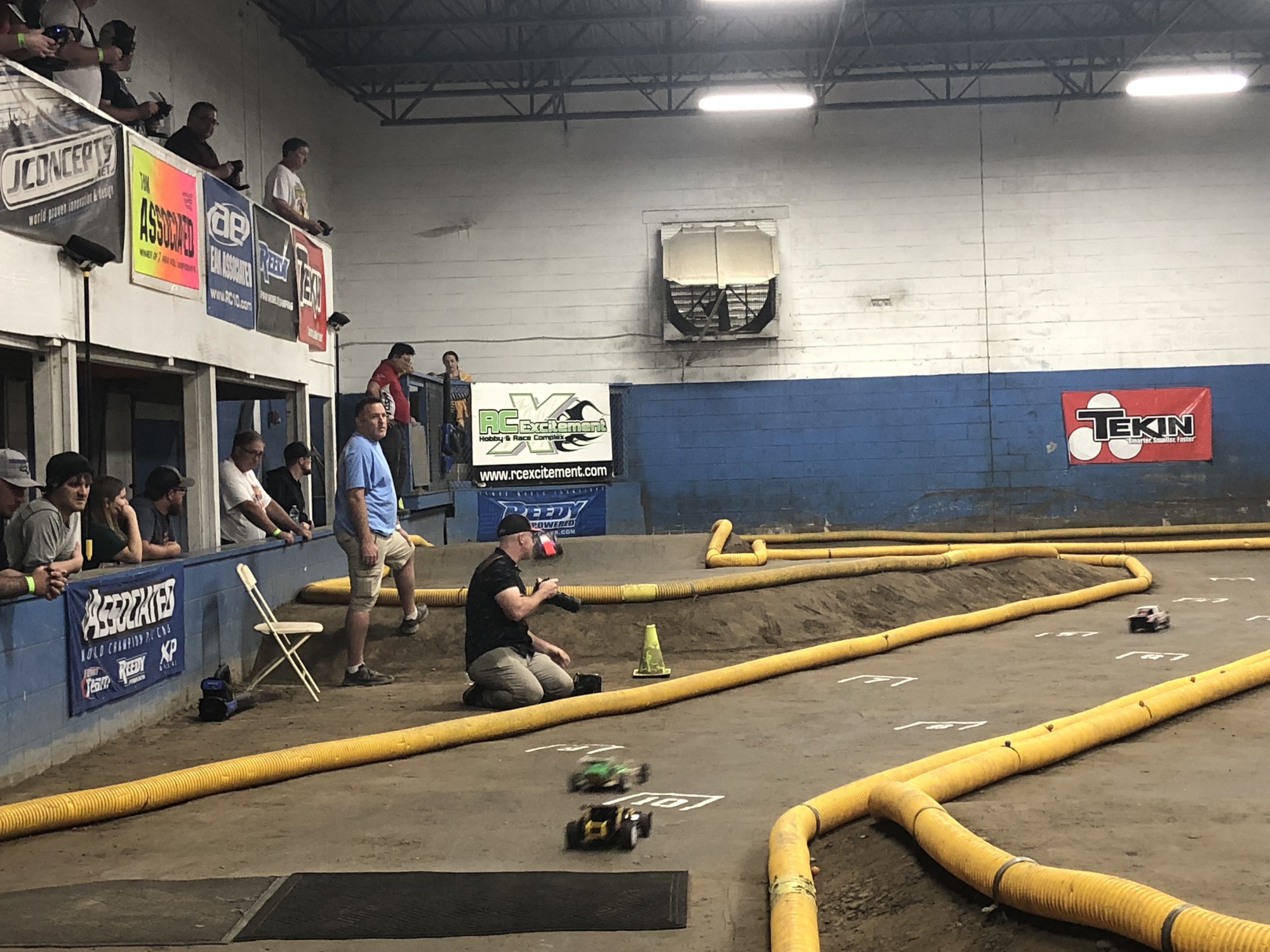

I did not get a chance to update this thread before the 2019 Vintage Off-road Nationals, but as a follow up to my comment above from 2011 -
I did finally make it to the race [in 2019], and I did run 'this' Falcon in Classics:
I had a lot of fun, but my results were kinda lame - I chewed up a spur gear during practice, luckily I had one extra transmission with me, so I swapped in a new spur gear. I had very poor rear traction with the 'Double-D' tires I thought I would run, so I bought some 'Electrons' at the track. I tried to scrub the new tires in out in the parking lot, but the car is so lightweight and only running a Tamiya black-can motor, I couldn't really get much "scrub" - the tires were really slick for the first two qualifiers.
Tire felt somewhat better by Q-3, but I started to hear crunching again from the gearbox, so I finished Q-3 being very ginger with the throttle...
- I used a black 'stealth' body for the race:
- Notice the ribbon of flashing still on my brand-new rear tires...
I qualified 4th (out of seven) in the B-main, I felt like I could make the top three with a bit of luck, but my gearbox went south just a couple laps in - I think I was running in third when the gearbox started sounding really bad, so I just babied the car the rest of the race... To be honest, I never even checked the results, I'm not sure how far back I finished??
- The Falcon chasing an RC10:
- And losing...
-dldiaz
