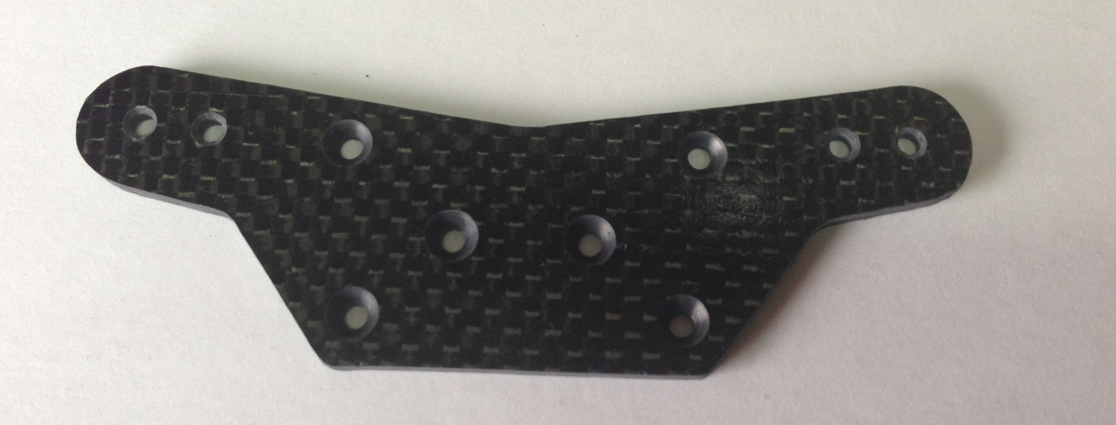

Thanks again! 8) I'm still working on my carbon front wing at the moment. Man that stuff makes a mess when sanded. :shock:
