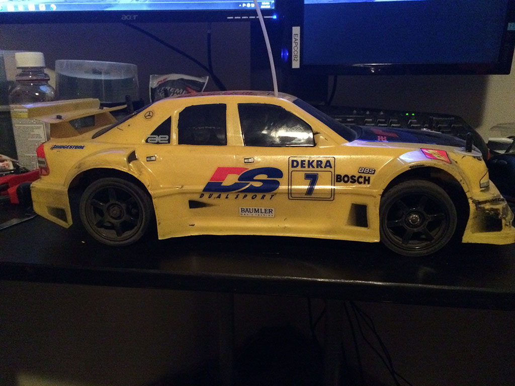

Sorry about that, apparently linking to tower hobbies pic did not work...so here are two pic samples of the HPI rally tires
Here are two samples of the HPI vintage tires
I used to run these on my NTC3 but i havent tried them on the DS yet...only mounted them on the lamborghini

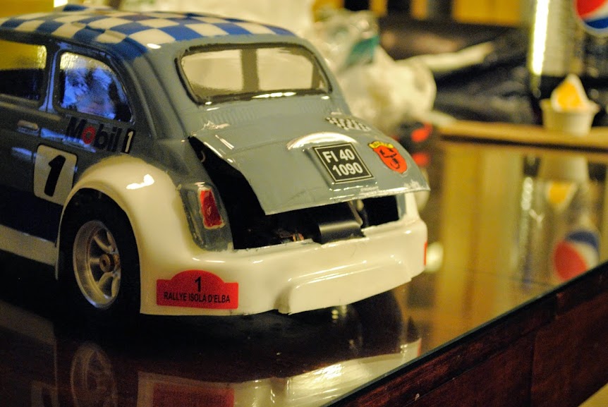

Well...after hours and hours taping and prepping the body - then botching the checkerboard roof very badly almost immediately - I decided to go back to the purpose of this car. I'm building a parking garage toy, not a shelf queen. So, I peeled back the excessive tape, painted it with Rust-Oleum grey and slapped on some stickers to cover up the bigger painting mistakes. I might do another Fiat 500 with more detail sometime later, but this car has work to do. I still have to do something with the rear body mounts, but I haven't decided what I'm going to do yet.
I'm 80% satisfied with the finished product. I realize I need an airbrush kit to do what I really want to do, but I just don't have the motivation to drop $250 on a new kit. I'm watching CL for something to come up, but so far it's pretty empty. Hopefully after the holidays...
Onto the pictures!!! Here it is prepped for paint, body isn't drilled so it sits up very high.
I found these nice brass knurled nuts for the wheels. Probably the BEST $2 I spent on this entire project. Don't worry about the tire bead...I hadn't glued them when I took this picture.
And here's the finished body.
Here's the left-open rear deck.
