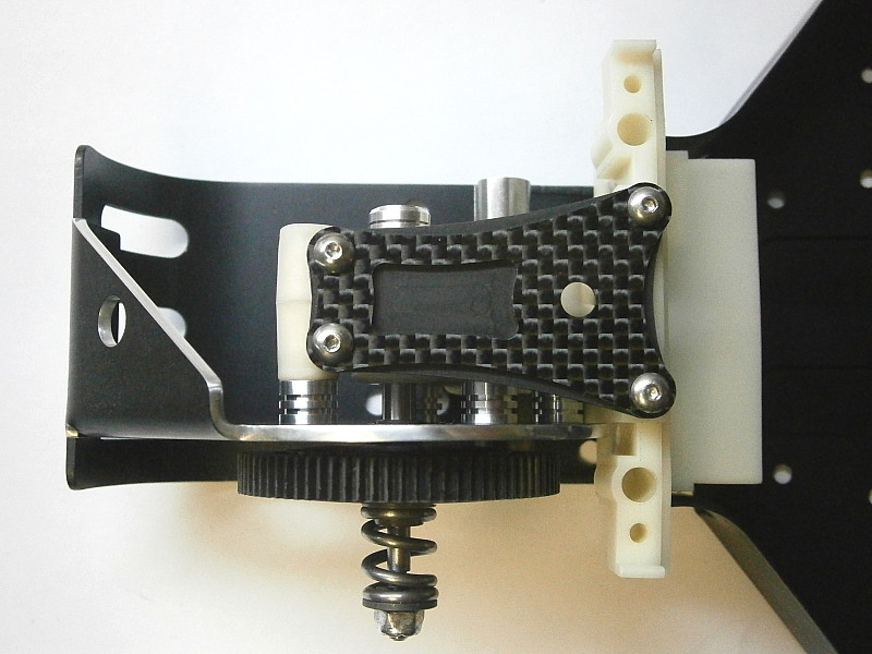

I'm waiting on crucial parts from the west coast so did a little bit on the back end. Stealth tranny with #9601 top shaft, Avid ball bearings,my custom machined aluminum tranny spacers and top shaft plug. For now, might change, a Trinity machined 81T spur gear. I'm all out of brushless motors so will have to buy :shock: one. I'm thinking a 13.5 or maybe a 10.5.
That's a JConcepts Worlds re-re cf tranny brace, only thing I had to use right now. I'll probably get with GoMachV (Factory Works) and have a custom brace made.

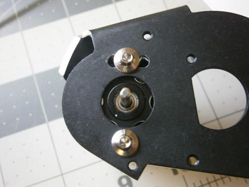

I was looking for something to do at 0530 hrs this morning so I worked on the top slot in the motor plate for brushless power. I took about a half mm from the top, now the motor will pivot smoothly. Once again, using Lunsford titanium motor screws.

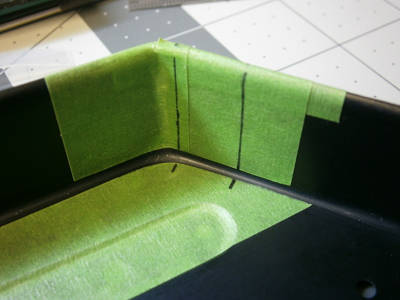

Almost ready to commence with the drilling step, just need to make the tub "clampable"so it doesn't get away from me while doing it!

Gook luck with the drilling. It's a tricky spot.
jwscab
Posts: 6580
Location: Chalfont, PA
Been thanked: 505 times
Re: NomadRacer's RC10 Trailing Arm Truck
Post by jwscab »
yup, it's tricky, no doubt.
Use a small drill, something like 1/16" or so and drill a locating hole at each end. Then you can work from the outside.
