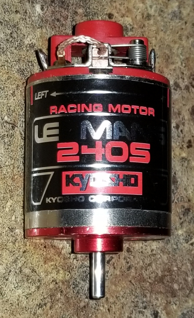

Few more i finished. Decals from UltraHive. Went with bearings on the 360st, 240 didnt need comm cut so i didnt remove endbell
Still waitn on 600E decals....wish i had more motors, ones i want are getn pricey used. (i.e. 480t, 360 & 480 gold, 240s, 240sb, etc.)

Couple more restos:
240s 26,000rpm @ 0 degrees 7.2v
480spa 20,500rpm @ 0 degrees 7.2v
