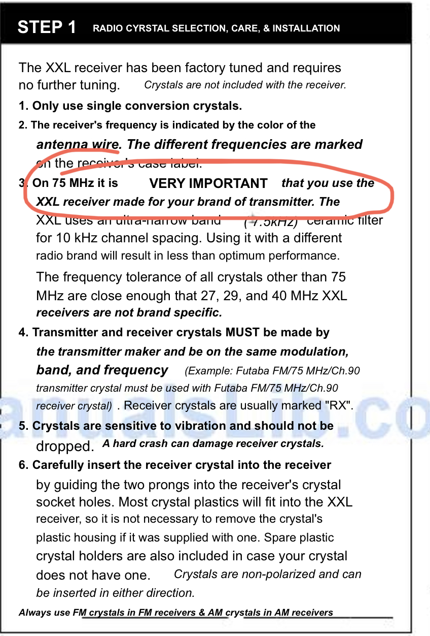

I picked up a nice narrow band AM Novak XXL tuned for JR radios, and at first try it seems to be an improvement over my wide band AM receiver. But still some glitching as the car gets at the farther distances where I normally drive it. I'm going to experiment with distancing it from the ESC more to see if that helps. There's an XXL tuned for Futaba out there, but it comes with a car I don't really want or need. Once I acquire, I'm not good at committing to selling. Are there any thoughts on if the tuned for JR and tuned for Futaba matter much for signal quality?

I could swear Futaba and Hitec were negative shift and JR and Airtronics were positive shift. I would be interested to see how the receiver made for that transmitter works in comparison.
Posts: 12336
Been thanked: 3919 times
Re: Radio opinions
Also this…

I read that on the instructions, but the Novak tech support people aren't taking calls to discuss anymore. They also say don't use AM radios with brushless, but maybe it's actually ok. I'm hoping there might be some experience with trials out there.

GoMachV wrote: Thu Jul 29, 2021 6:34 pm I could swear Futaba and Hitec were negative shift and JR and Airtronics were positive shift. I would be interested to see how the receiver made for that transmitter works in comparison.
As I was told, positive and negative shift doesn't apply to 27 and 75mhz, primarily 72. I asked the same question a few years ago on a different forum, one with a lot of vintage flyers.
But I can tell you that my Futaba, Jr, and Hitec 75mhz transmitters and receivers all work together.
