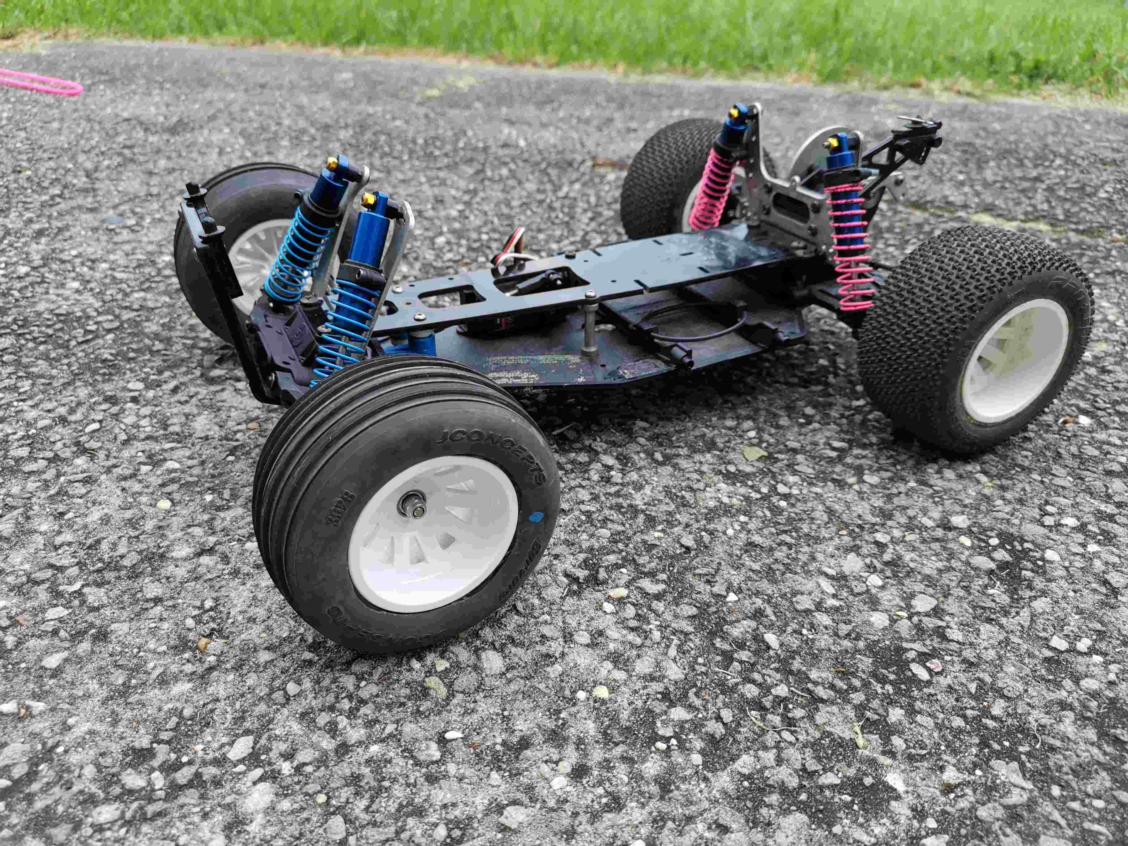

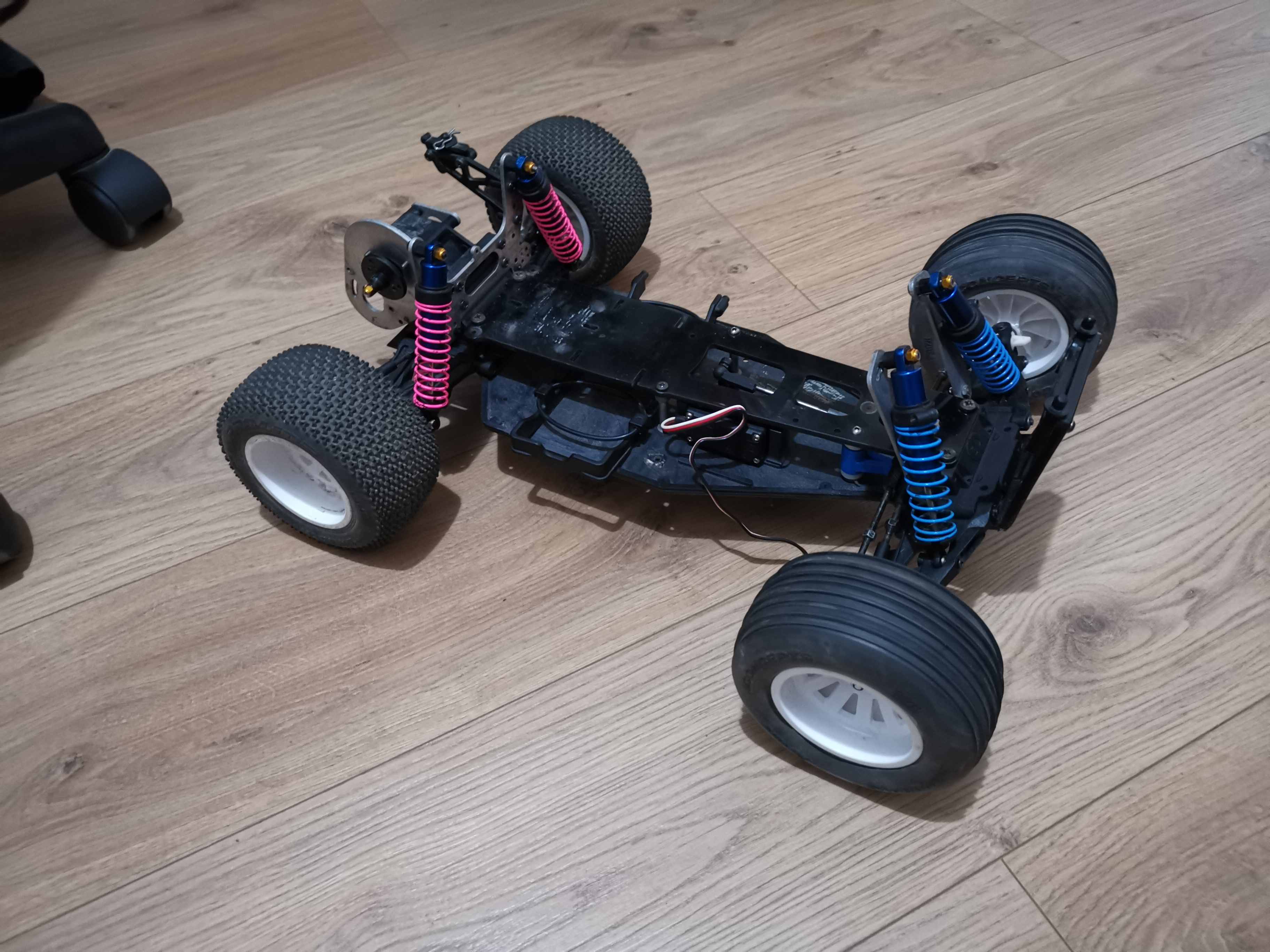

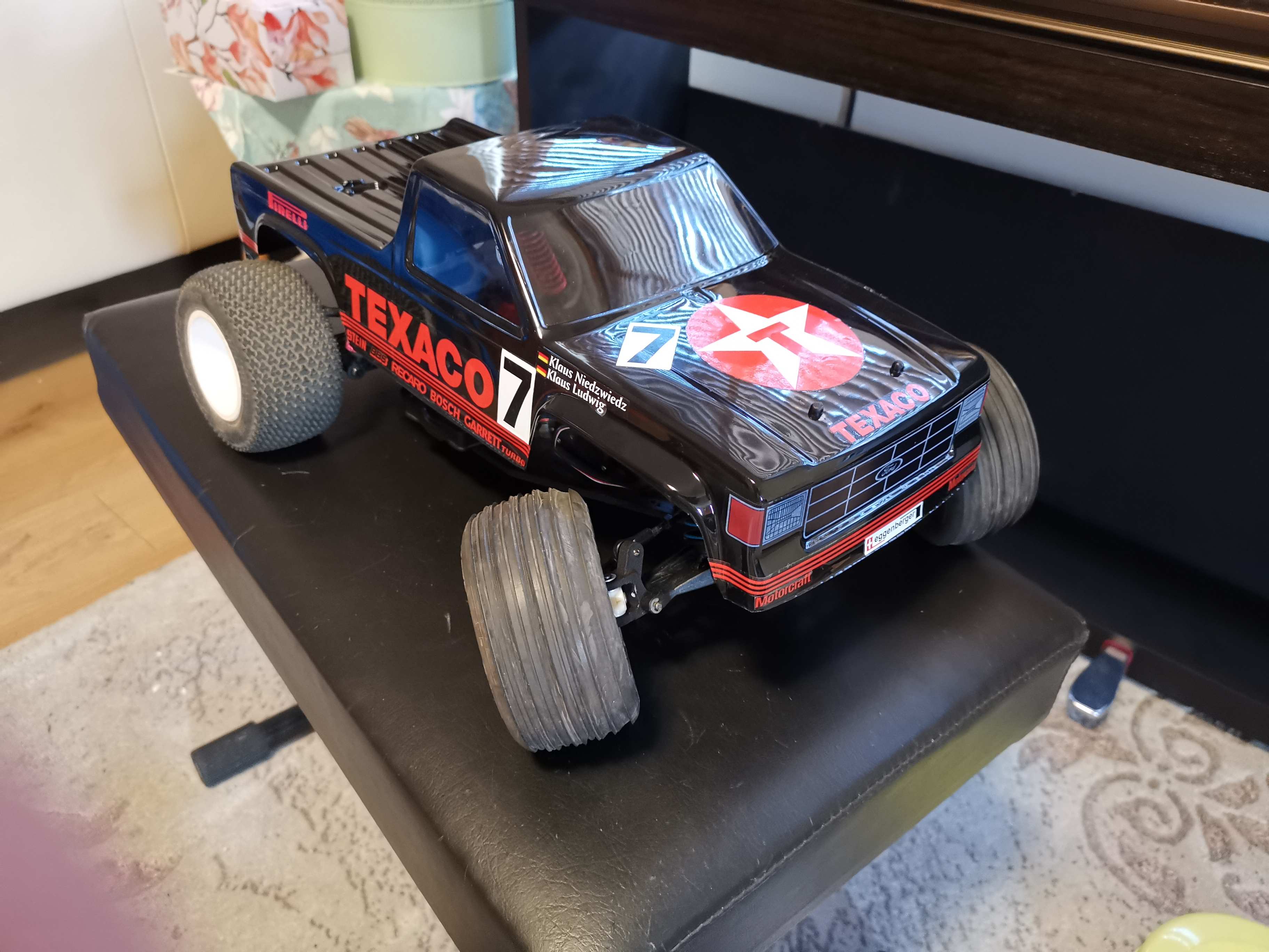

Great to see another Outlaw truck being worked on! I've done some work on mine with a bit more to come
I built it along side my rere Ultima that was fitted to an ultima ii chassis
My outlaw is a bit of a mish mash, i fitted a triumph belt drive gearbox to it, some rtr Losi shocks, tamiya Blitzer front knuckles so i could fit blitzer rims that i already had mounted with tyres. I've always love the Texaco Sierras from the 80's so i did the body up like that
I've got a few more things i'll be working on over the next few months, as you say, the kelron chassis has no strength on its own, I'm going to try to use some 90 degree aluminum stock bolted along the chassis to provide strength and a channel for the battery to fit and hopefully then not need the top deck except for a small one at the front to brace the steering posts etc. The other thing i want to do is hex convert the front end using optima hubs/knuckles

Your truck looks great Delorean, thanks for posting the pics. Seeing the black paint and Texaco livery reminds me of the Robert Yates’ T-Birds that Davey Allison drove bitd.
My Outlaw won’t look that nice unfortunately as I’m trying to work with the original, well used and abused body and just make it a decent looking runner. I’ve found with these resto projects that if I give in and paint-up a new body, I’m reluctant to get it in the dirt and the vehicle just ends up setting on the shelf. I don’t want that to happen with this one so I will trade some appearance for utility.

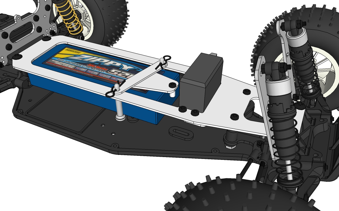

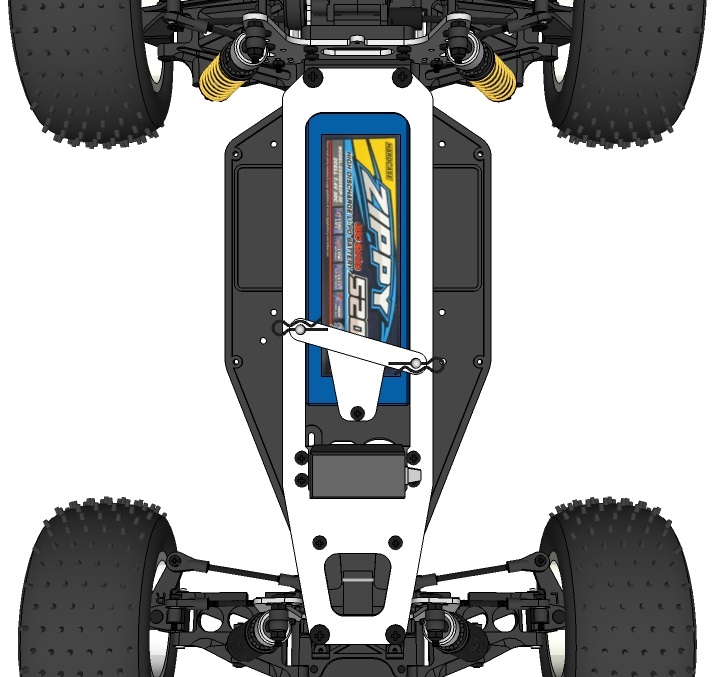

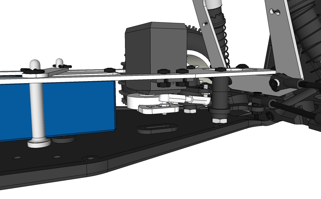

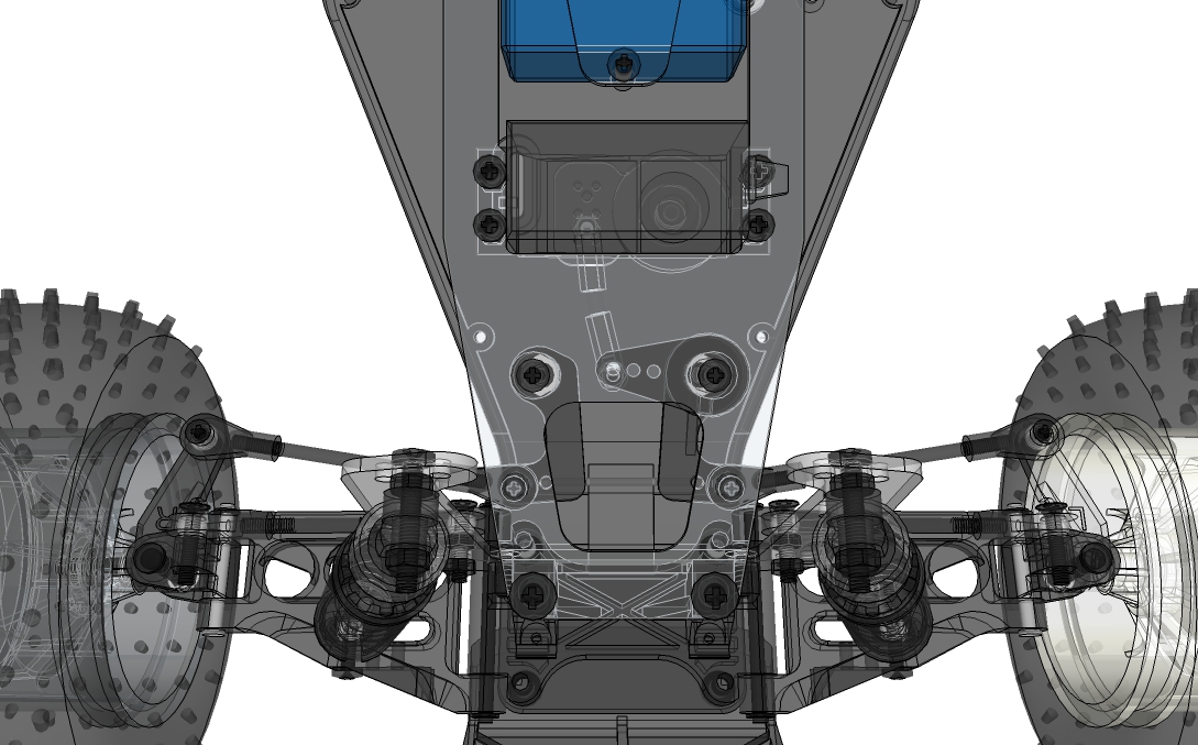

For a chassis top deck, I think I’ve found a design that will work; it will accommodate the battery and won’t require any new holes to be drilled in the chassis. It’s a tight squeeze between the stanchions but the battery will fit if I make them 5mm dia.

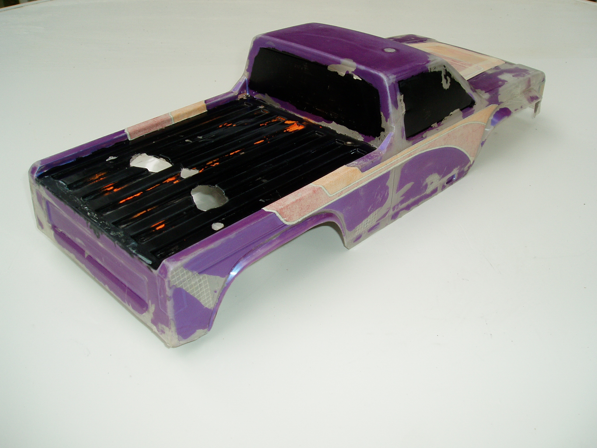

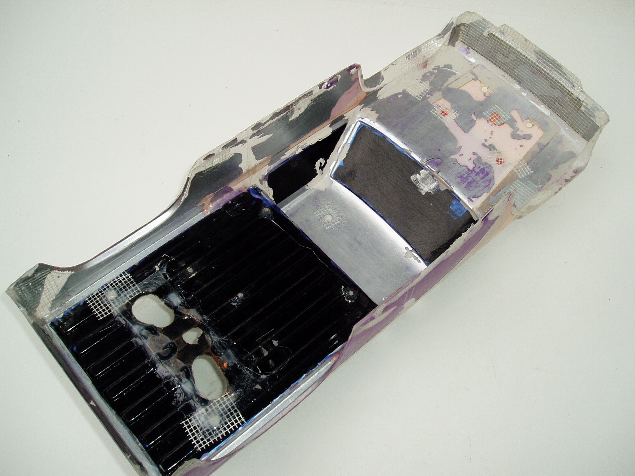

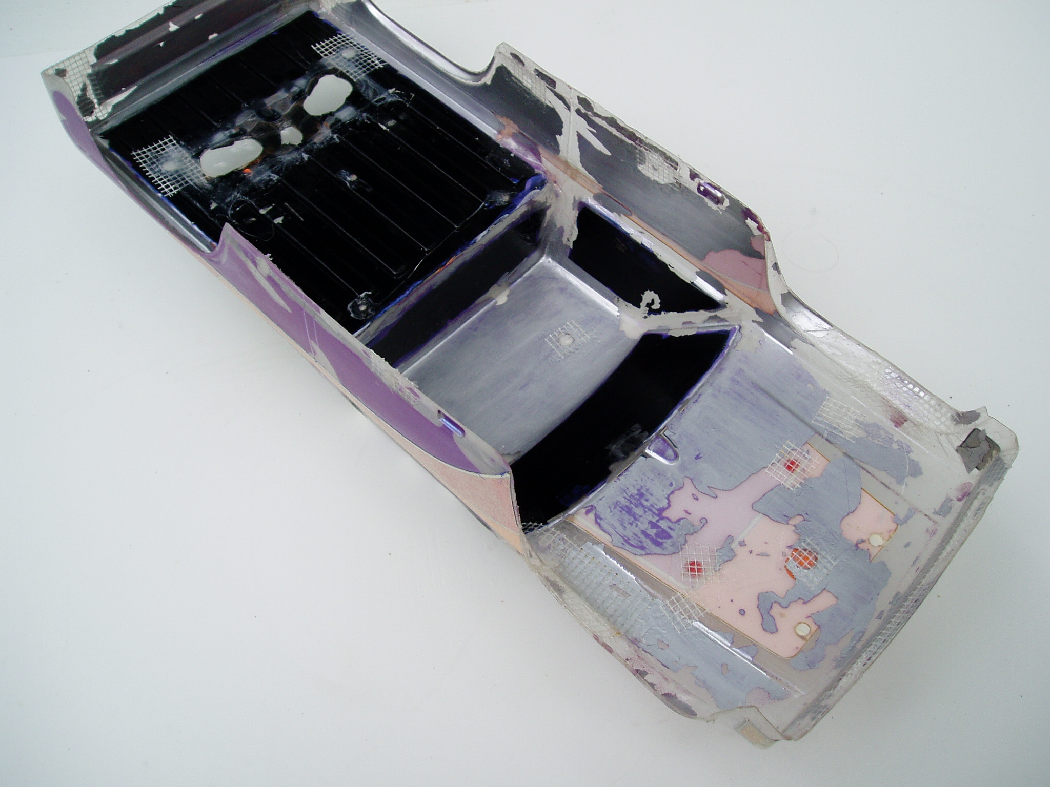

All cleaned-up, patched-up, scuffed-up, taped-up and ready for paint.
Frankenstein's monster truck.
I've wet-sanded the outer surfaces with 600 and the plan is to apply some white polycarbonate paint as a bonding agent, then gray primer and finally, the white and black Krylon (or whatever I have on hand). I'm substituting black for blue on the box-art model.
The original owner trimmed away the two oval shaped mounting recesses for the body posts at the rear of the bed so I've Shoe Goo'd a lexan patch in that area. Looking at the manual, I can see why he thought those areas were to be removed - it could be a little confusing to someone new to the hobby.
It appears to have been painted with pearl purple and I happen to have an ancient bottle of Pactra poly paint in that color.
As it is, with areas of missing paint, it is affecting the colors in stripe decals.
So that the decals look more uniform, I'll apply a few coats of the purple in those areas with missing paint.
Probably not a big deal since this is a beater body but I have the paint so might as well use it.
Anyway, it's raining here again today so the most I can hope for is to apply primer.
I probably should wait for a dryer day before applying the final colors.
