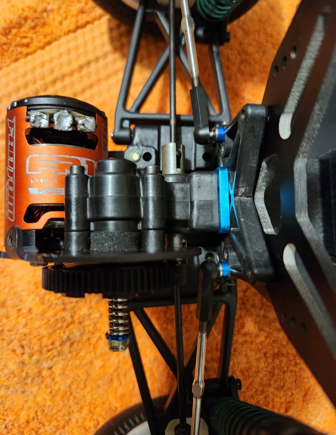

Trinity XX trans brace makes a perfect spacer that's needed when you flip the tower to the front of the bulkhead

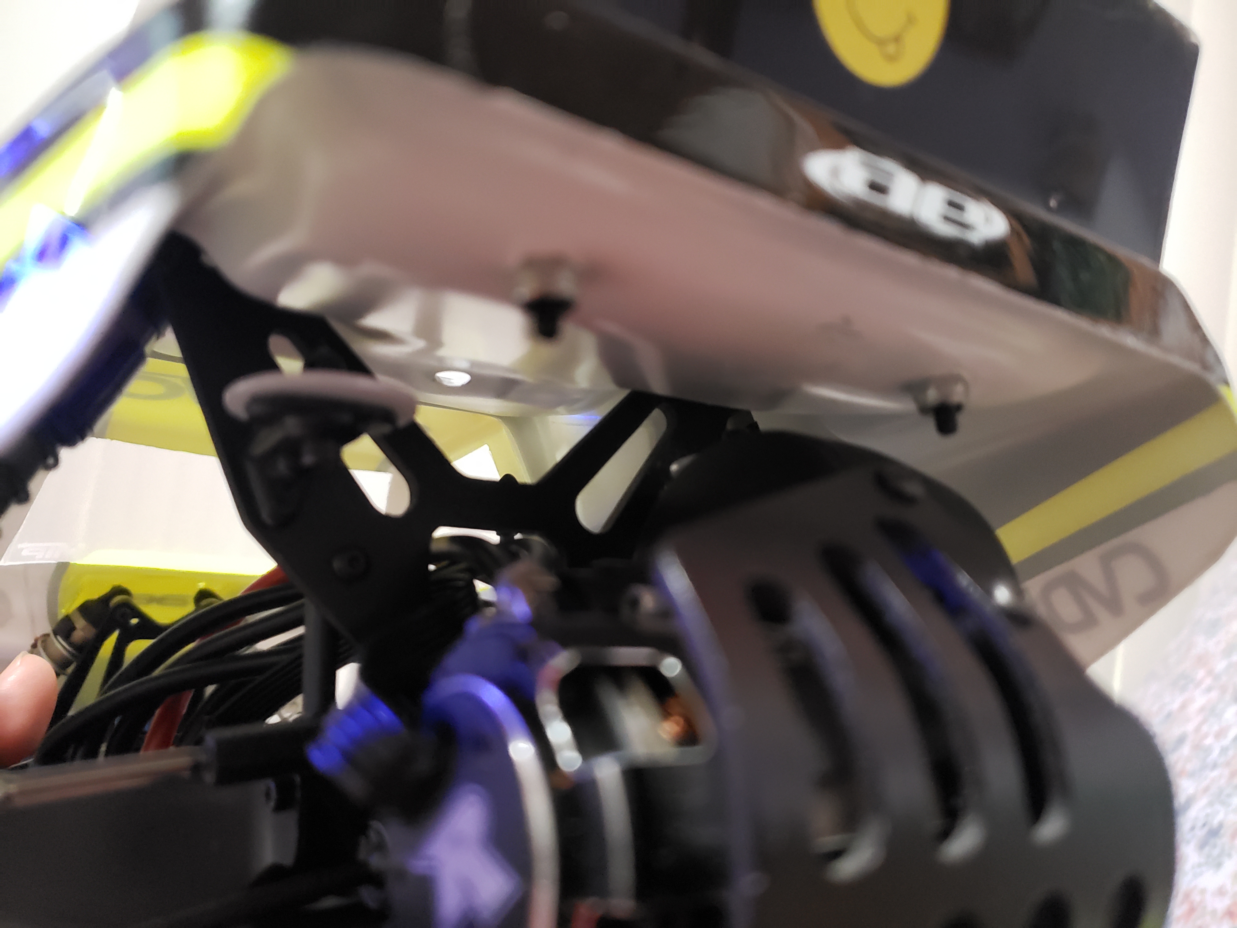

Might just see if Jeff feels like making a new rear tower with lowered body mount positions and *gasp* correct shock angle adjustment holes-
B7 wing mounts as body mounts look promising- still need to see if the T6.4 ones might work better

I may try one of Ruonas T3 shells- the B7 rear wing mount as a body mount caused the T2 shell to be too high, the sloped rear roof line might play perfectly to that anyway

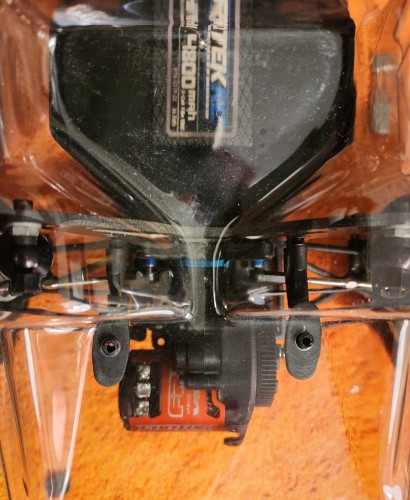

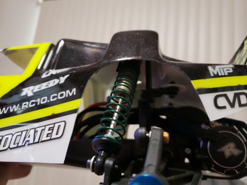

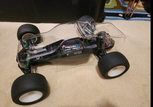

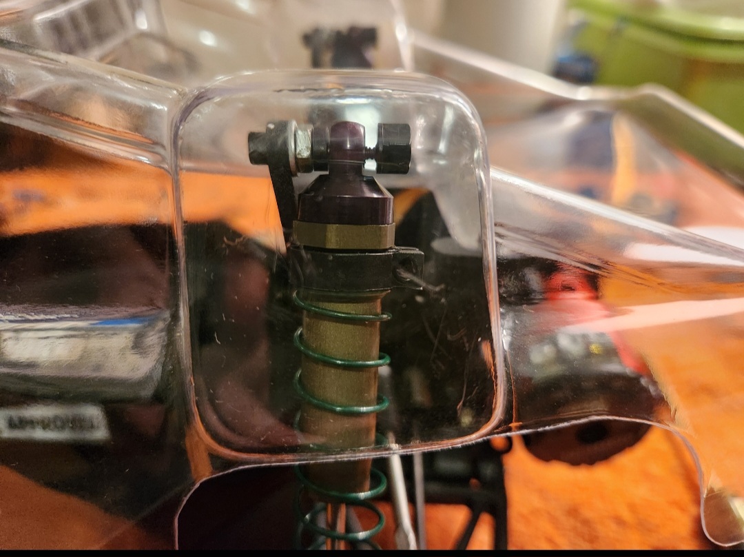

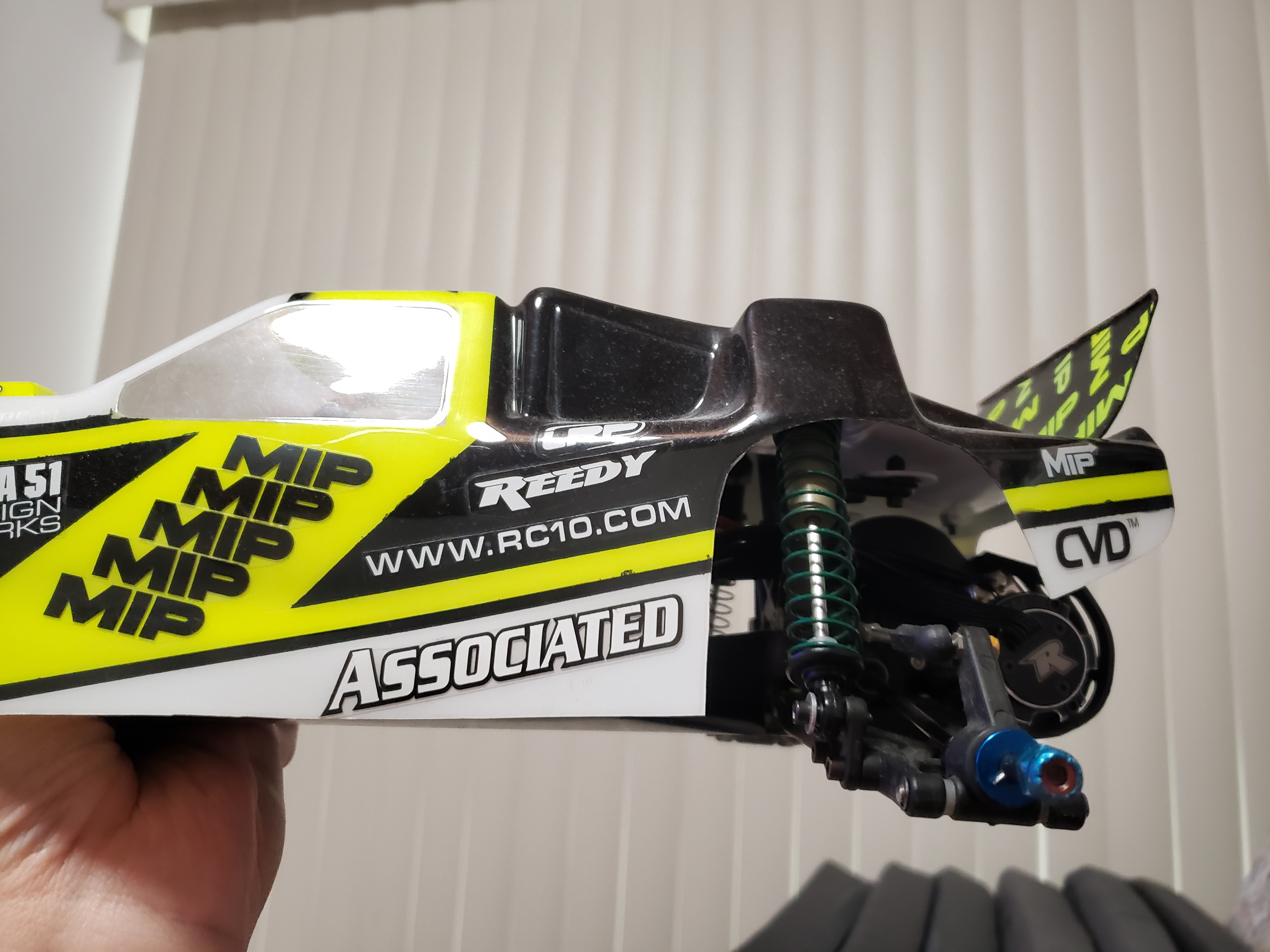

So, it looks like the T3 body fits okay after all. I had one fitted to a 10t with a custom kydex mount and stock pieces to mimick a T3 shock tower rest and mount and I believe it would probably work just as well on a T2. I have my T2 shock tower mounted in the stock position and the pic's are a little blurry but you can see the amount of space you have to work with.

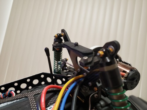

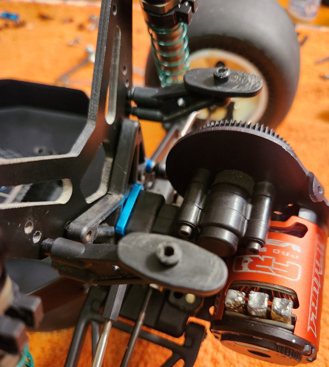

Why wouldn't one make a lower CG tower and remove the lower shock mounts, thus mounting the shocks directly to the arm? You already tweaked the front.

Great question! That was one of my ideas, the only real downside is designing the tower and having it cut etc. Ultimately I'm going to wait until I have the 13mm T6.4 shocks in hand to look at making any real work like a tower design and such.

I'm sure that this would have occurred to AE at the time. Especially on the T2 that had an all new shock tower designed just for it. Why did they go with the mounting bracket that was used on the gt instead of doing what is suggested here is making a shorter shock tower to lower the CG?

If I remember right, supposedly the higher mounted shocks on the T2 improved handling by increasing rear roll stiffness without requiring a sway bar or stiffer springs.

I have found that on the super high traction tracks that I'm on now, the lower the CG the faster the overall corner speed. Companies weren't playing with axle height adjustments BITD either and they play a big part of corner speed on modern surfaces IMO

The lower arm standoff serves to simulate mounting the lower shock position further out. This way they likely didnt have to mold a new rear arm and definitely makes the rear feel stiffer than just mounting directly to the outside hole on the arm. Maybe more like mounting the lower shock on a "fourth" outer arm hole and like Dangeruss said, stiffens the rear, so more stability and faster rear rotation on high traction surfaces.
