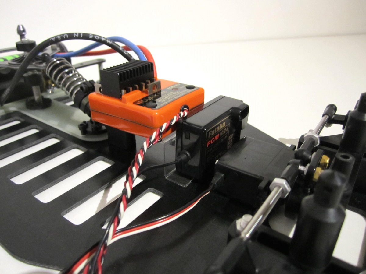

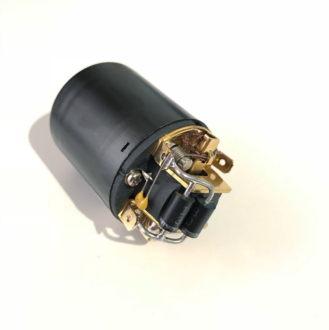

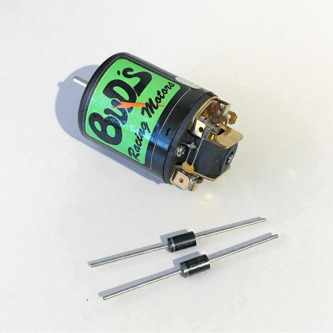

Made some progress this weekend.
Delivery of servo, soldering Schottky Diodes, modified housing and re soldering wires on esc and tried different layouts of the electronics.
- NomadRacer
- Posts: 1467
- Has thanked: 81 times
- Been thanked: 79 times
Re: Insane speed run build
Bum on Direct Deposit
- sandkil
- Posts: 1082
- Joined: Tue Jan 15, 2013 10:00 am
- Location: Stockholm Sweden
- Has thanked: 795 times
- Been thanked: 623 times
Thanks man, quite pleased with that myselfNomadRacer wrote: ↑Sun Nov 19, 2017 12:36 pmEverything looks so clean but the installation of the diodes is stunning!
