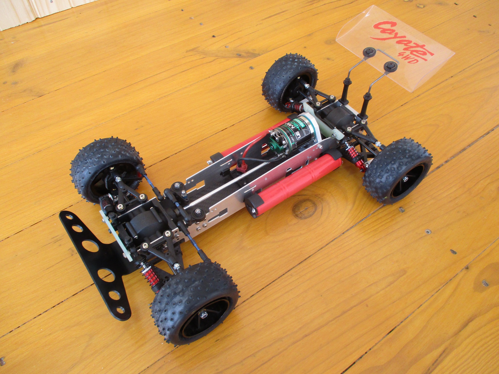

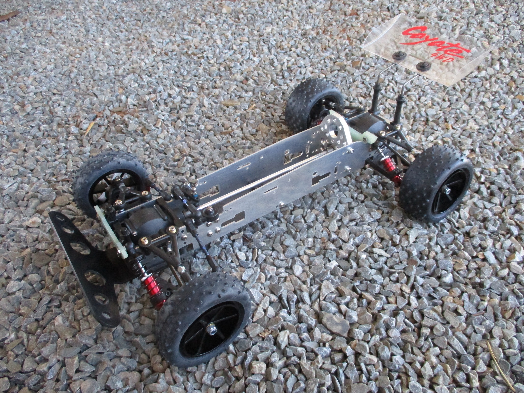

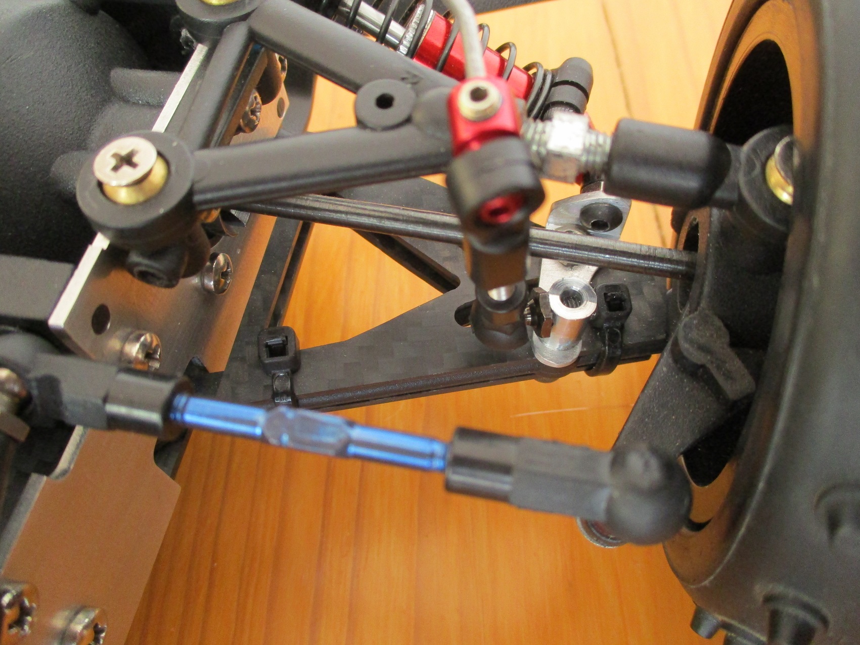

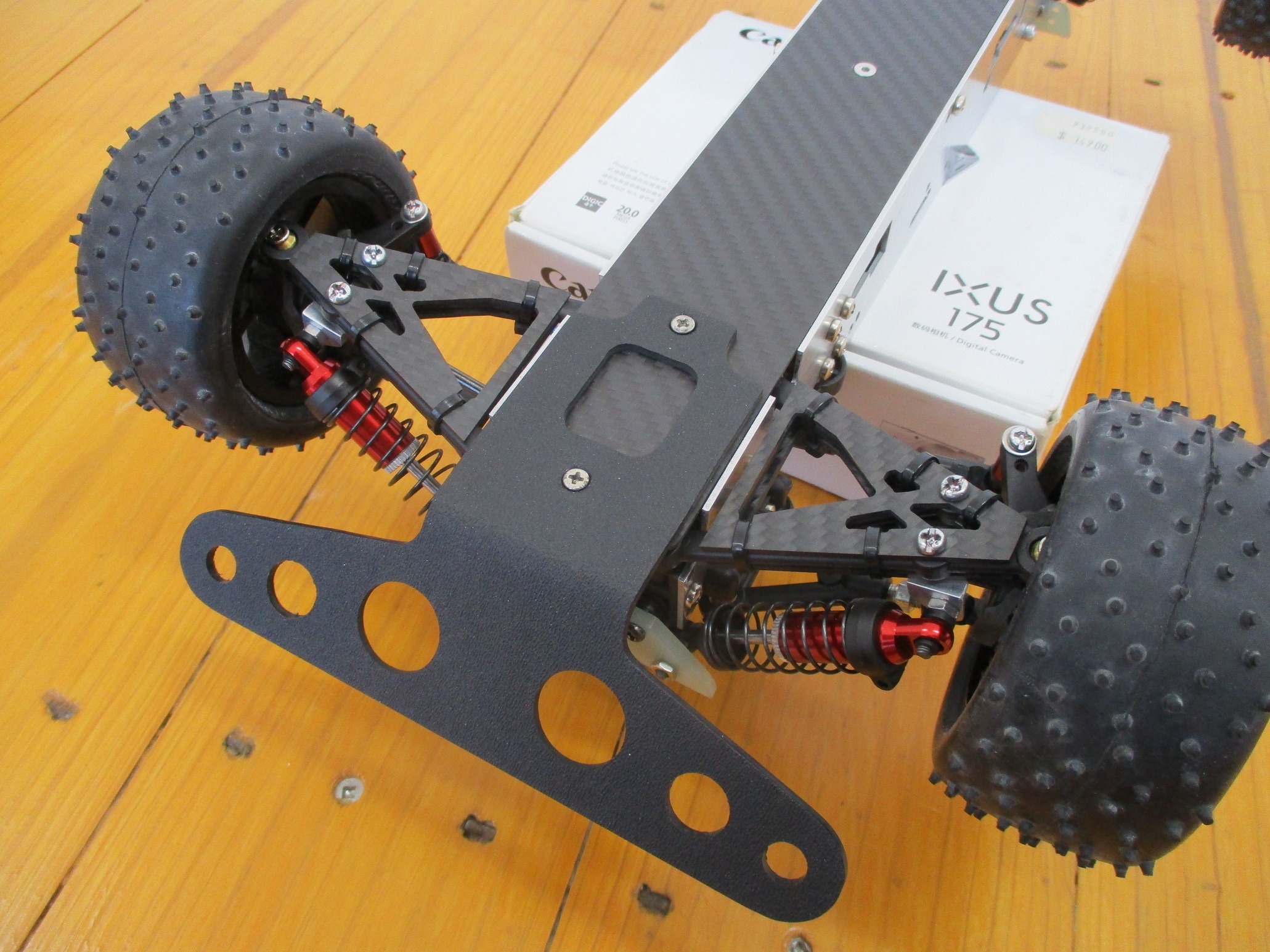

Front carbon arm plates made and installed as well as the aluminium brackets to mount the Kyosho shocks. This will be a massive upgrade over the stock shocks, especially the standard ball end mounting system they use.
I'm using the stock wide wheels with Schumacher Tyres and inserts all round.
I also have narrow Schumacher fronts and inserts as an option.
Also notice the Kyosho 4.8mm ball studs and ball ends attached to Associated FT turnbuckles on the steering. Much better.Chris.

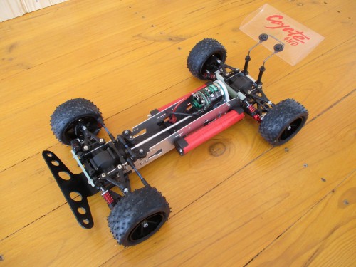

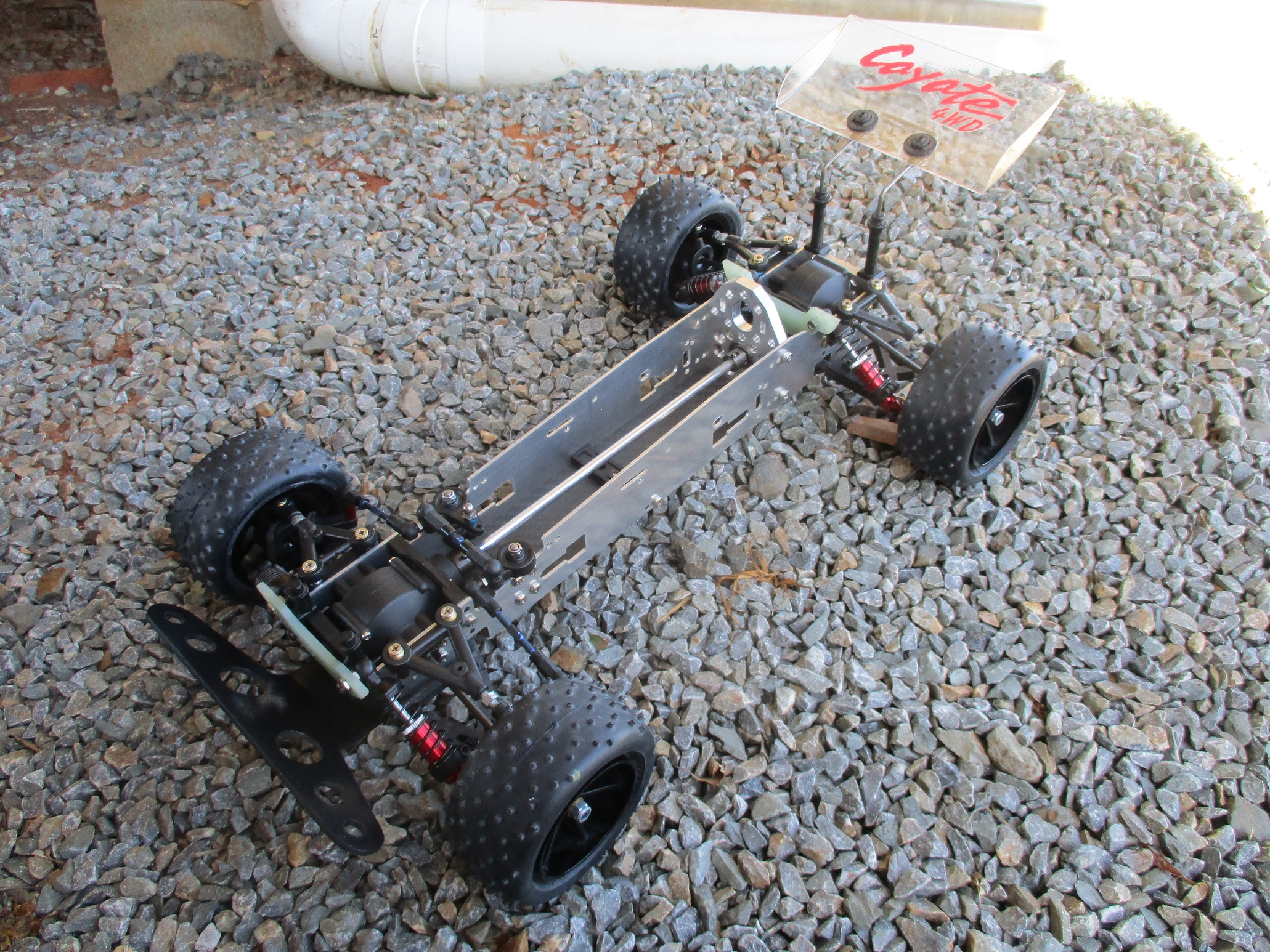

Coyotes come from the factory with the two sticks of batteries mounted towards the front of the car. I wanted to give myself another tuning option so I could shift the cells and change the balance of the chassis.
I'll use modified battery holders in the old battery slots, which are behind the middle of each stick of cells in conjunction with a re-usable zip tie. That'll secure the packs really well.
Believe me, drilling and filing the slots was as fun as it looks.

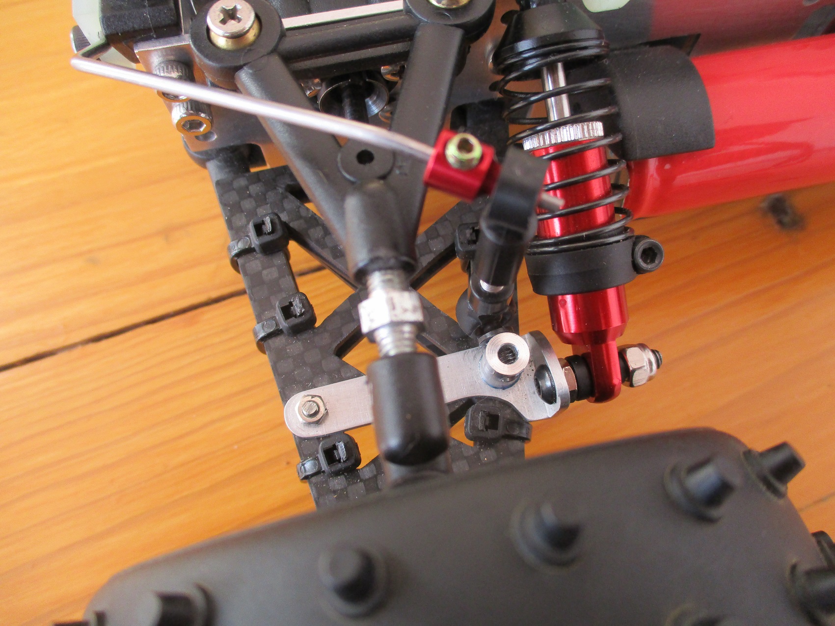

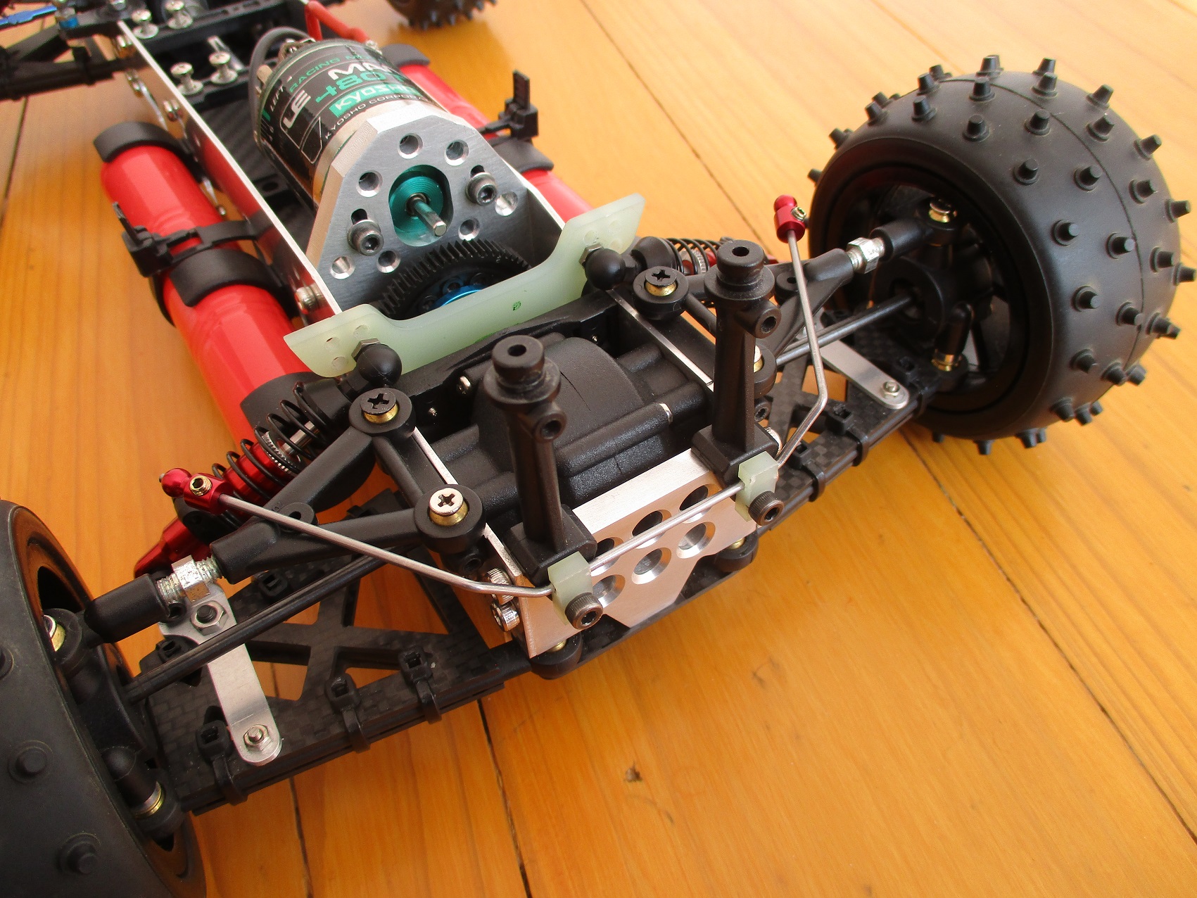

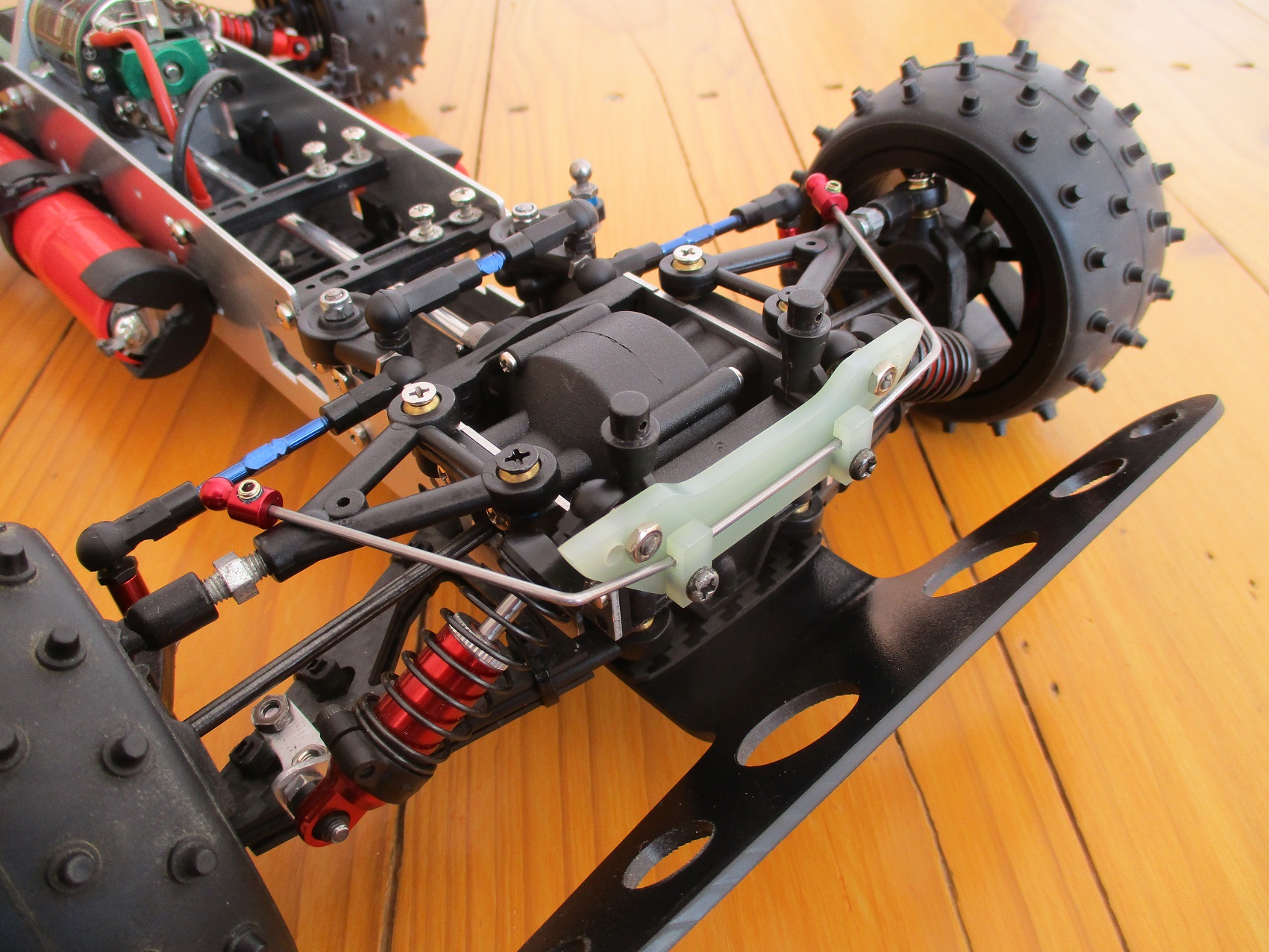

Coyote kits don't come with sway bars nor did SG or TAG or anyone else offer them (I could be wrong though) as options as far as I know. As before, it's a case of make it yourself which in my case has always been one of the main attractions of RC cars. Anyway, here's my sway bars.
The front one made from 1.6mm wire. There's two of the mounts I made recently. I have to attach the bars to the wishbones yet.
The rear bar. 1.6mm wire again. Note the extra battery mounts and zip ties securing the batteries in this shot. very secure.

The sway bars are attached to the wishbones via four small aluminium posts and some spare ballends and ballcups I had sitting around.

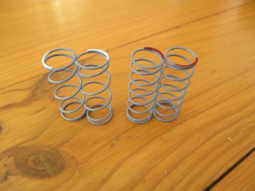

The front. The rear. I currently have the stock Kyosho springs on the Tomahawk shocks. They seem a little soft for this buggy. I've found some stiffer replacements if needed.
They're 10mm Axial springs, part numbers AX30205 and AX30206. The red springs are softer than the white springs. These'll really help with fine tuning. There's one more tuning option that I have to make before the Coyote is complete. After that I can fit the electronics and get it running.

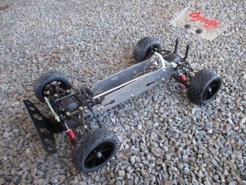

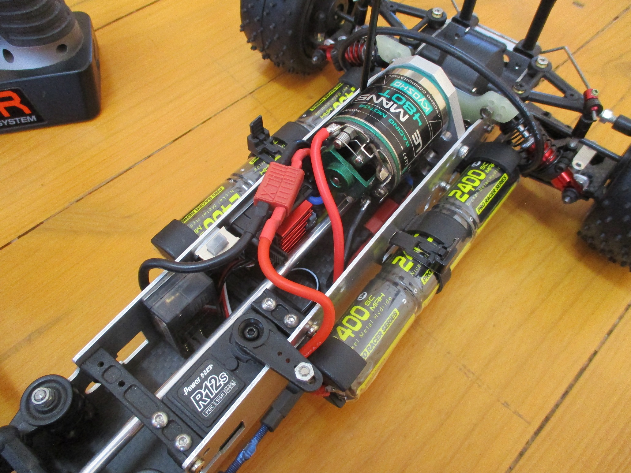

Finally, the electrics are installed as neatly as possible. There's not a lot of room in these chassis'. Everything clears the main driveshaft. I've just got the parts needed in the post for the last tuning option. Hopefully, the Coyote will be finished and running mid-January.

Gotta love a custom Kydex bumper!
