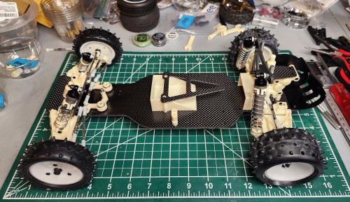

Well, my collection of "extra" parts is getting bigger and bigger, but I am not going to worry about that for now. :D

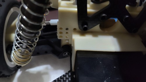

GoMachV wrote: Tue Aug 06, 2024 7:24 pm *Rere world's hole. Same as CE and Team. The real world's car as well as the DS used a hole not on that bulkhead, halfway between the hole your in and the inner hole. Weird AE forgot, and since fan just copies the AE stuff he also left it out. The rere DS doesn't use it either.
At least it's pretty easy to add them in. Still need to clean up the cut areas though.

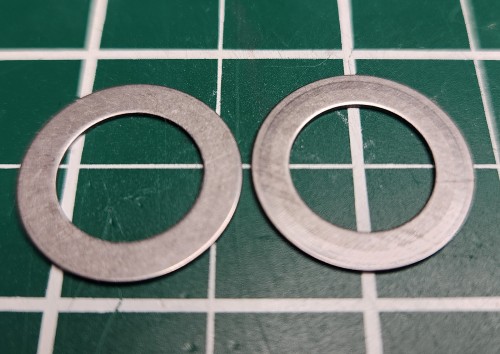

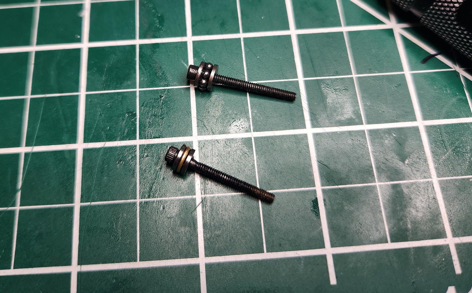

Swapped over to traditional thrust plates / balls, and it made no difference. Going to swap back in the new style, and just start swapping parts individually until some improvement is witnessed. All parts appear fine, and run smooth when rotated up against individual parts, but once you put it together and torque it down, it really does get pretty bad.
EDIT: That didn't take long. Swapped the diff rings and it is night and day. Now the diff has a nice steady drag. Never really looked at the rings earlier, but they are nowhere near as smooth as the polished rings that I normally see.

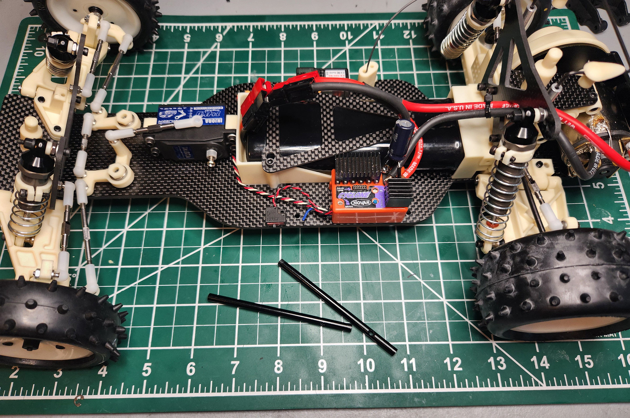

I know this is going to have a simple answer, and I will feel stupid as soon as I see the answer, but, um nose tubes :?:
Posts: 3808
Has thanked: 2604 times
Been thanked: 2977 times
Re: Fan RC FR-01
Nice wheels and tires!
Maybe they pre-package all the same parts for use with a tub chassis?
