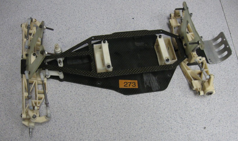

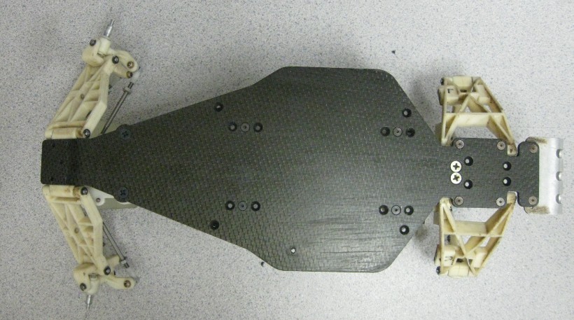

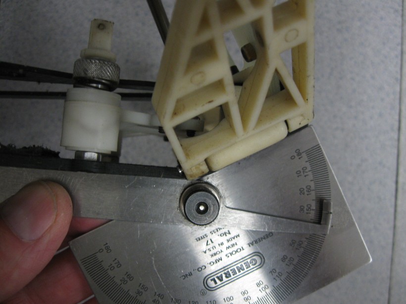

Hi Guys,
I talked with Cliff Lett at work this week about the kick-up angle on the '91 Stealth Car. He reminded me that we should have an extra car around the shop somewhere. I did some digging and found one.
I did some measuring and found that the front kick-up angle is 30 degrees. Here are some pictures of the car and kick-up angle. I'm not sure who's car this was though.
Curtis
Not sure who's car this was.
'91 Stealth Car 30 degree kick-up angle
Good view of the bottom

Niki
Posts: 524
Joined: Wed Nov 02, 2011 7:32 am
Location: Finland
Been thanked: 45 times
Re: 91 Masami Stealth replica COMPLETED!!!!!!
Post by Niki »
Great pictures. Thanks Curtis.
Mystery around this car slowly disappears. One thing I still can not understand... when we first made 30deg mockup version, we couldn't replicate side view picture of '91. Jake tried it with real mockup car and I tried it virtually with CAD software. So we made our version more B4'ish that was actually needed? :)
Is it just the chassis stance difference that fools our eyes with these two Stealth brothers? Maybe Masami still had 25deg? ;) We'll find out when Curtis gets those cars back...
