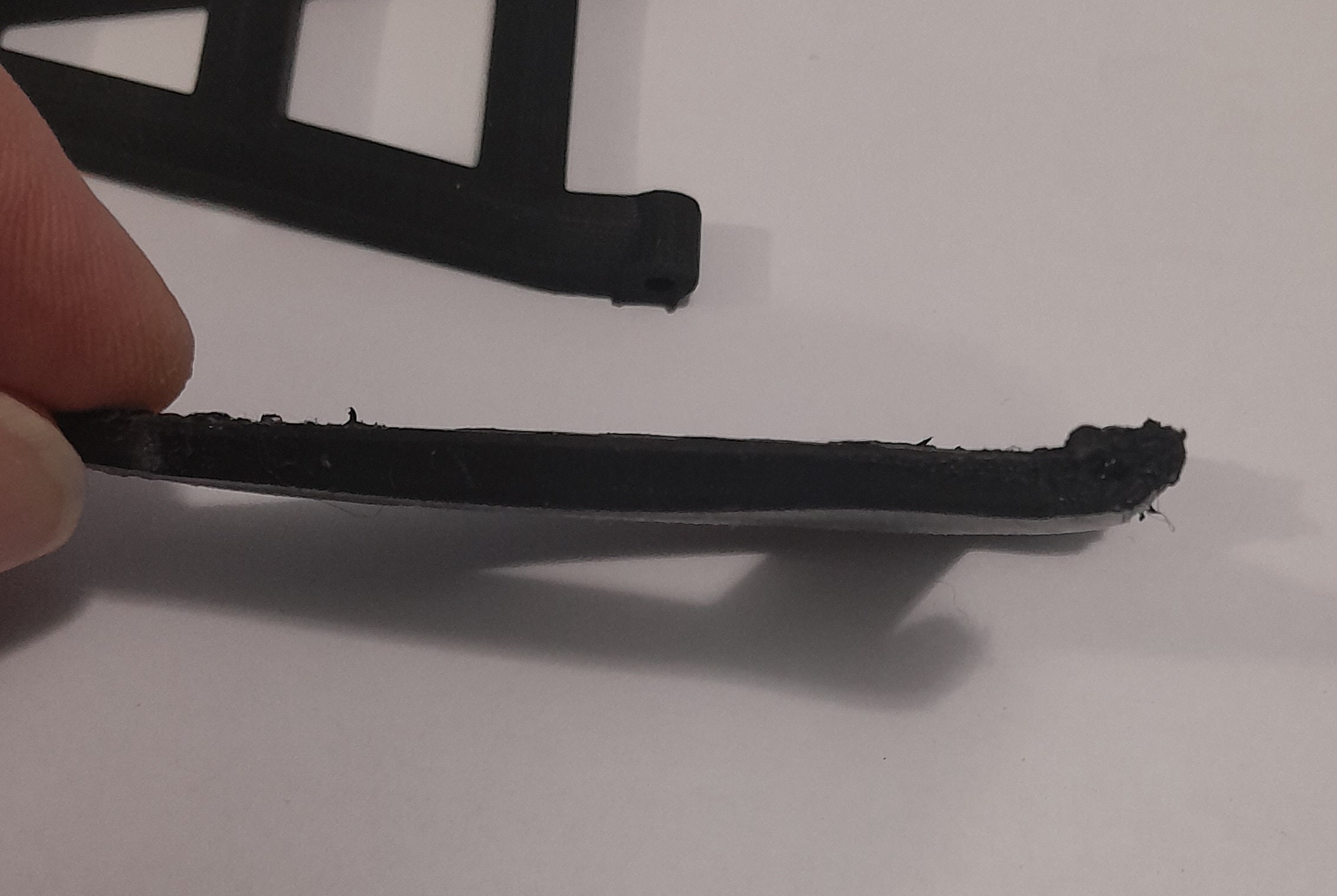

I recently bought some Polypropylene (PP) filament , the type of plastic used for Tuperware food storage containers . Reason being I was pretty sure it's what was used for PB Mini Mustang suspension components , I'm even more sure now .
I'd seen a few YouTube tutorials on printing with it and although it has superb layer bonding , toughness and ductility it's not without its problems to print , in short PP will stick perfectly to PP and nothing else !
There is a quick down and dirty solution though , most regular sticky tape is PP so you just tape up the bed and print on the tape , now I tried this but I used a smooth PEI bed plate that may have been the problem as the filament stuck very well to the tape but the tape peeled off the bed leaving a very warped part .
At this point I could have stripped the PEI coating off the bed so the tape was sticking to the spring steel plate directly but I only had two plates for my P1P and didn't want to ruin one so I ordered a cheap plate with fancy patterns on each side thinking I could strip the coating off the cheap plate , after ordering the new plate I found that Magigoo made a special glue just for PP so I ordered some of that too .
So my next attempt was with the new plate and just adding the Magigoo glue to it , the result is not perfect but way better , may be my own fault as Magigoo recommend a 20mm brim and I only used 5mm .

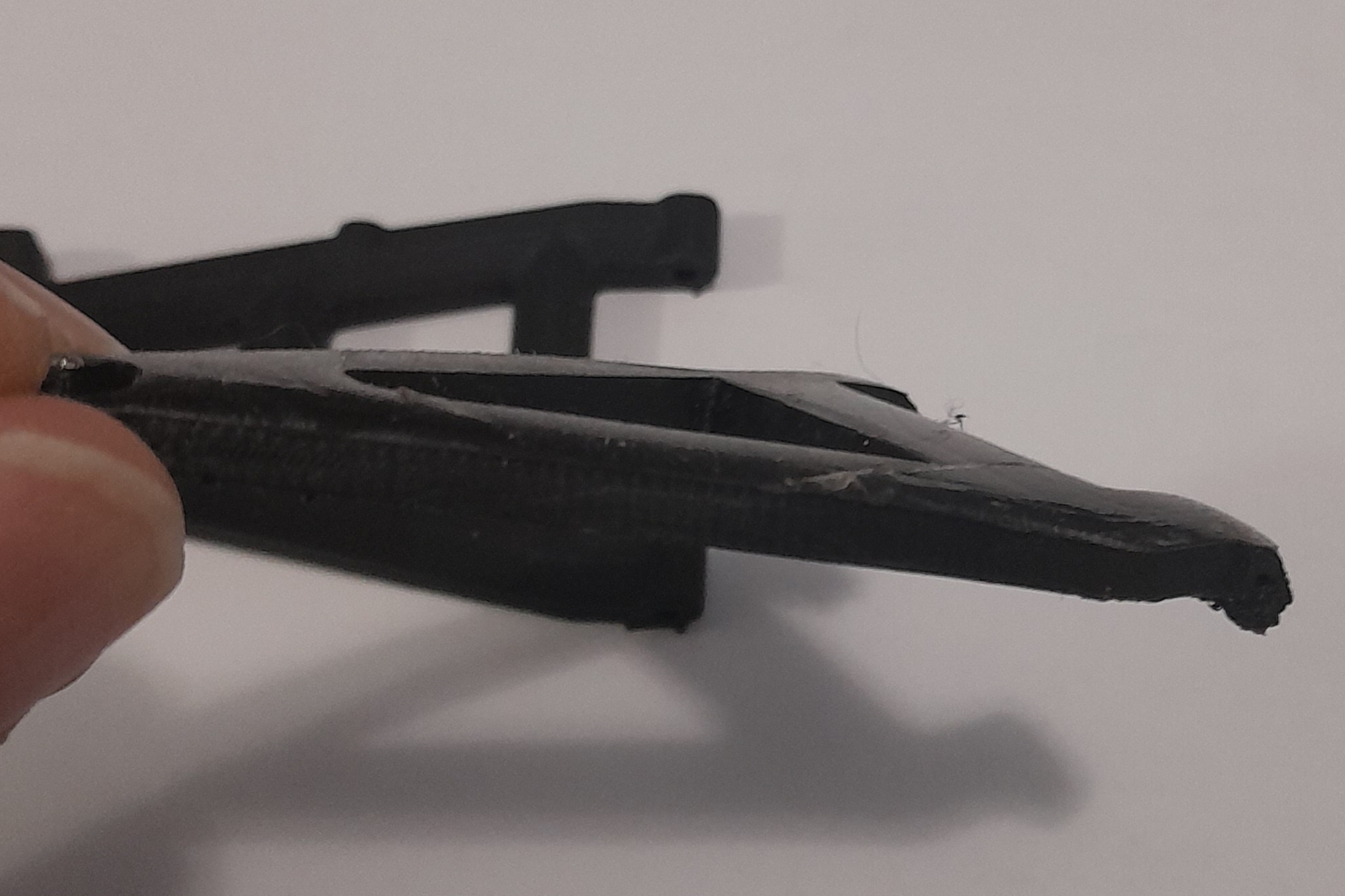

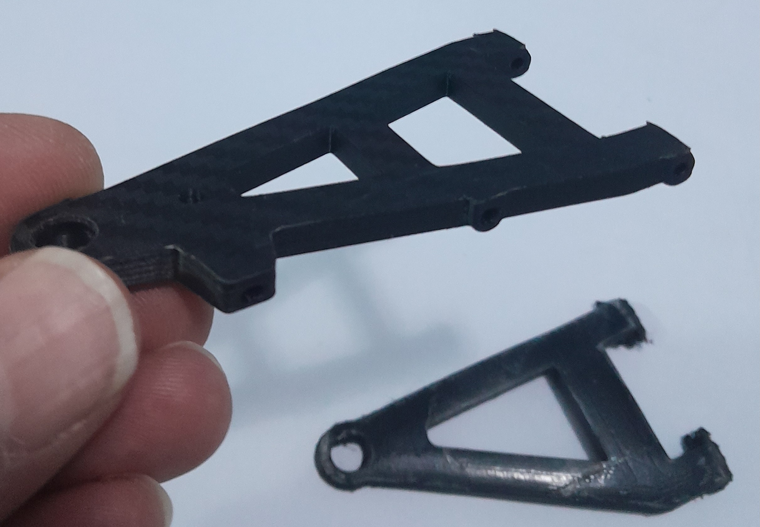

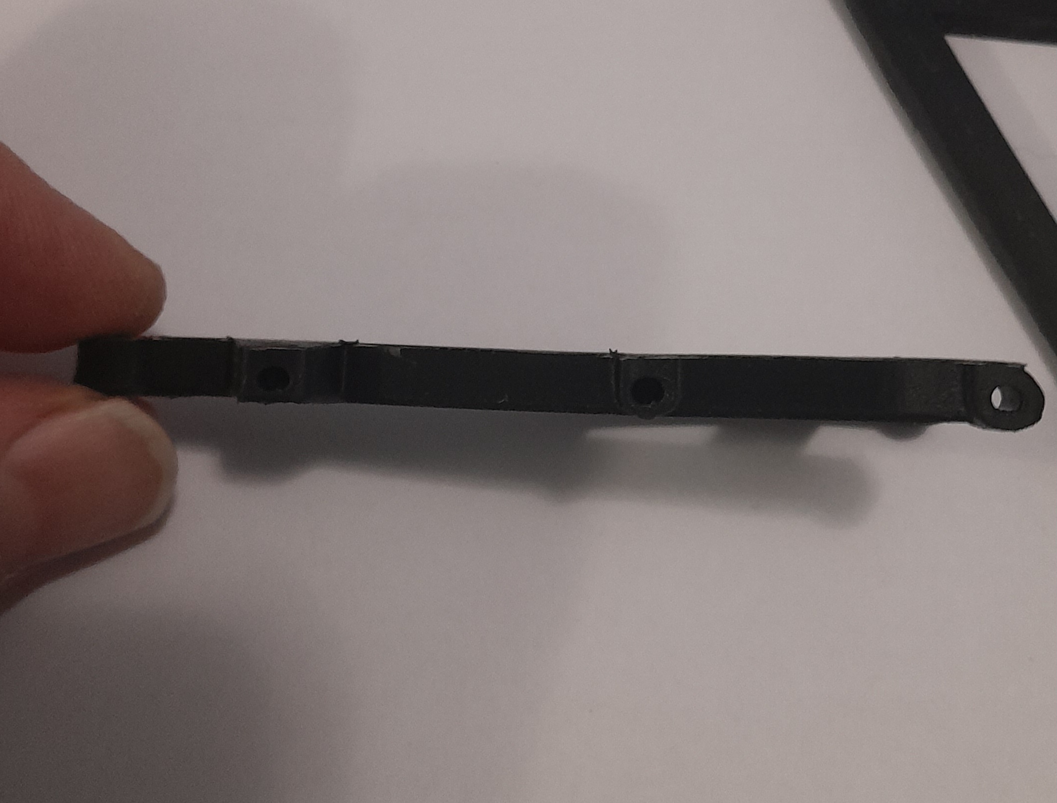

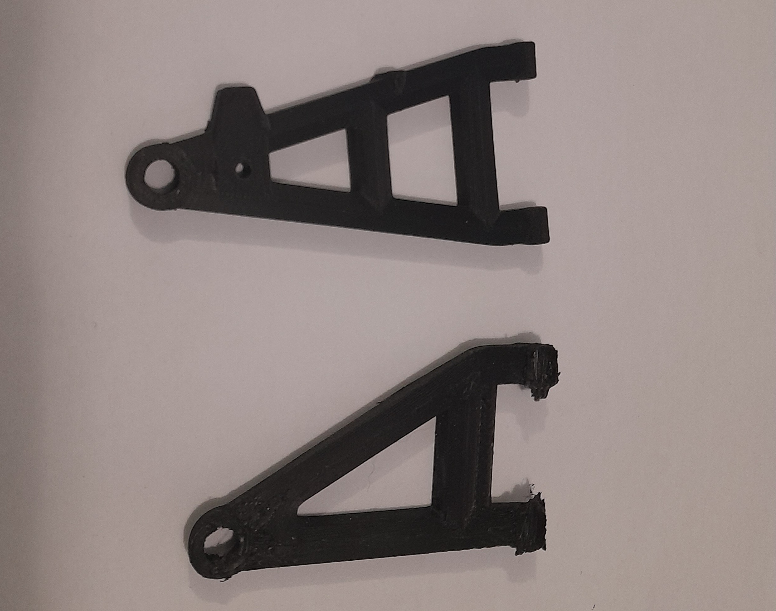

Below are pictures of the first badly warped part and the second usable but just slightly warped part .

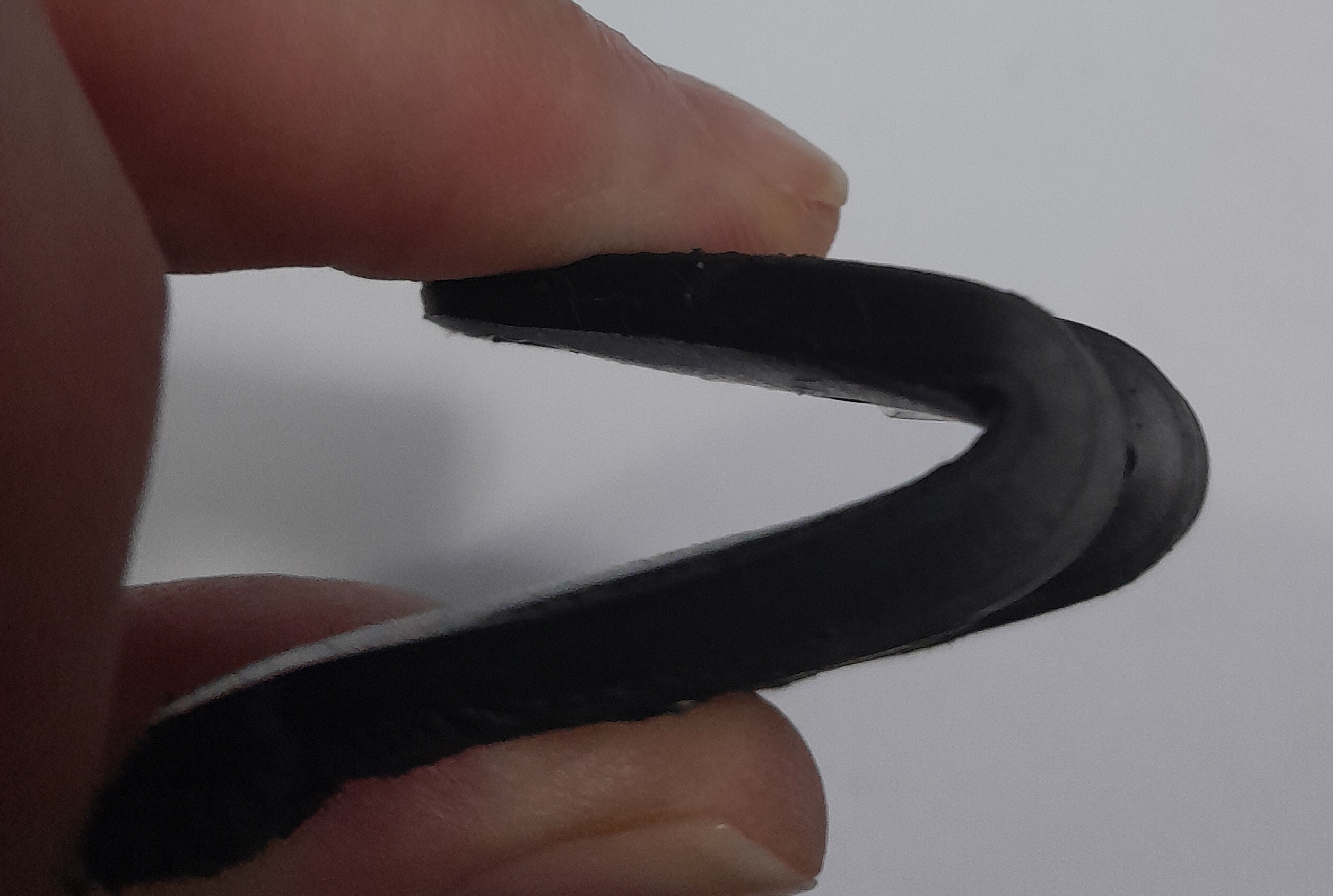

As you can see the overall print quality of the second part is very clean and its just about the same feel as the original PB Mini Mustang arms for flex and strength , I tested the badly printed part and I can bend it double with no sign of breaking :D this stuff might be just right for Yokomo 834B front arms as well .

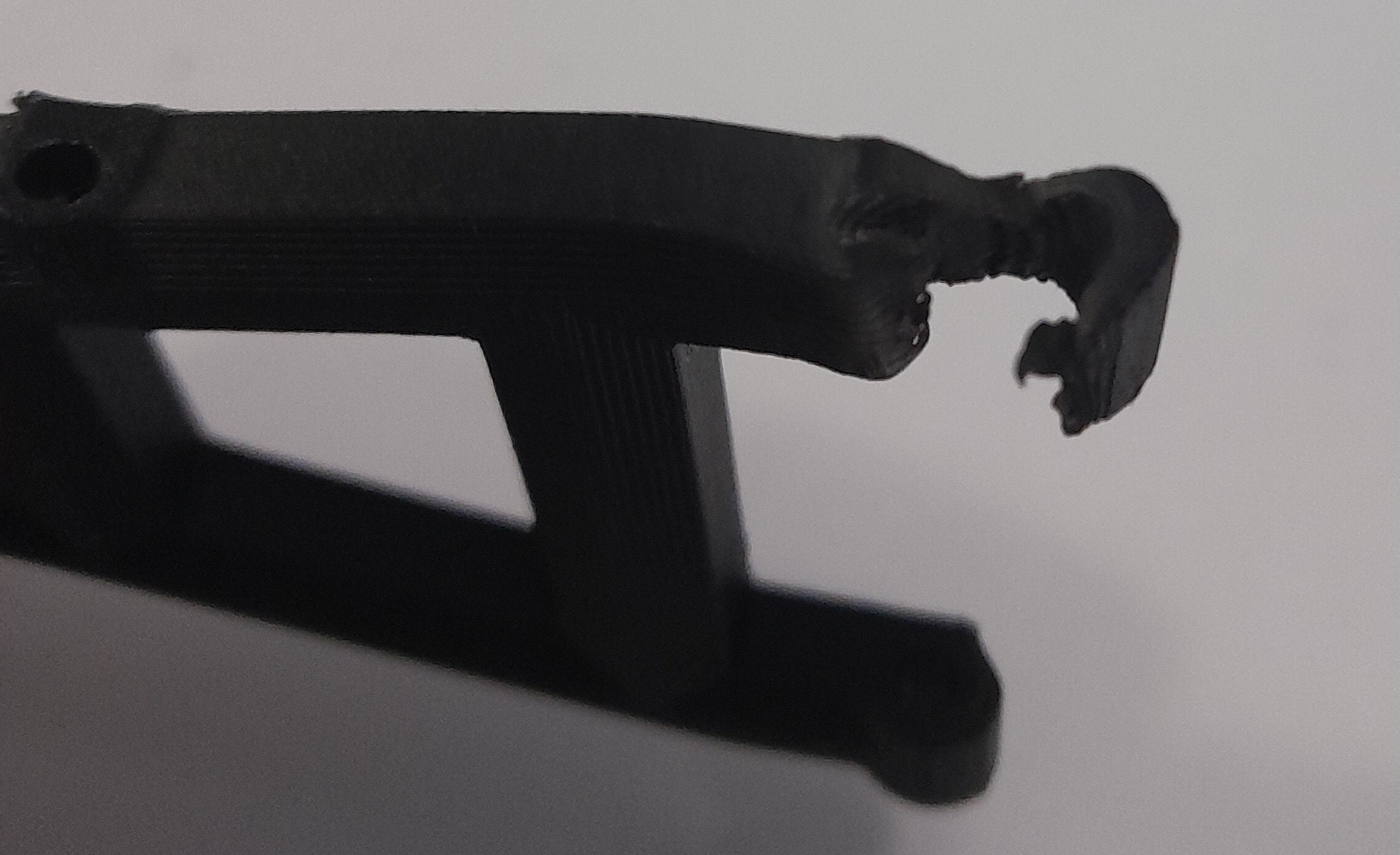

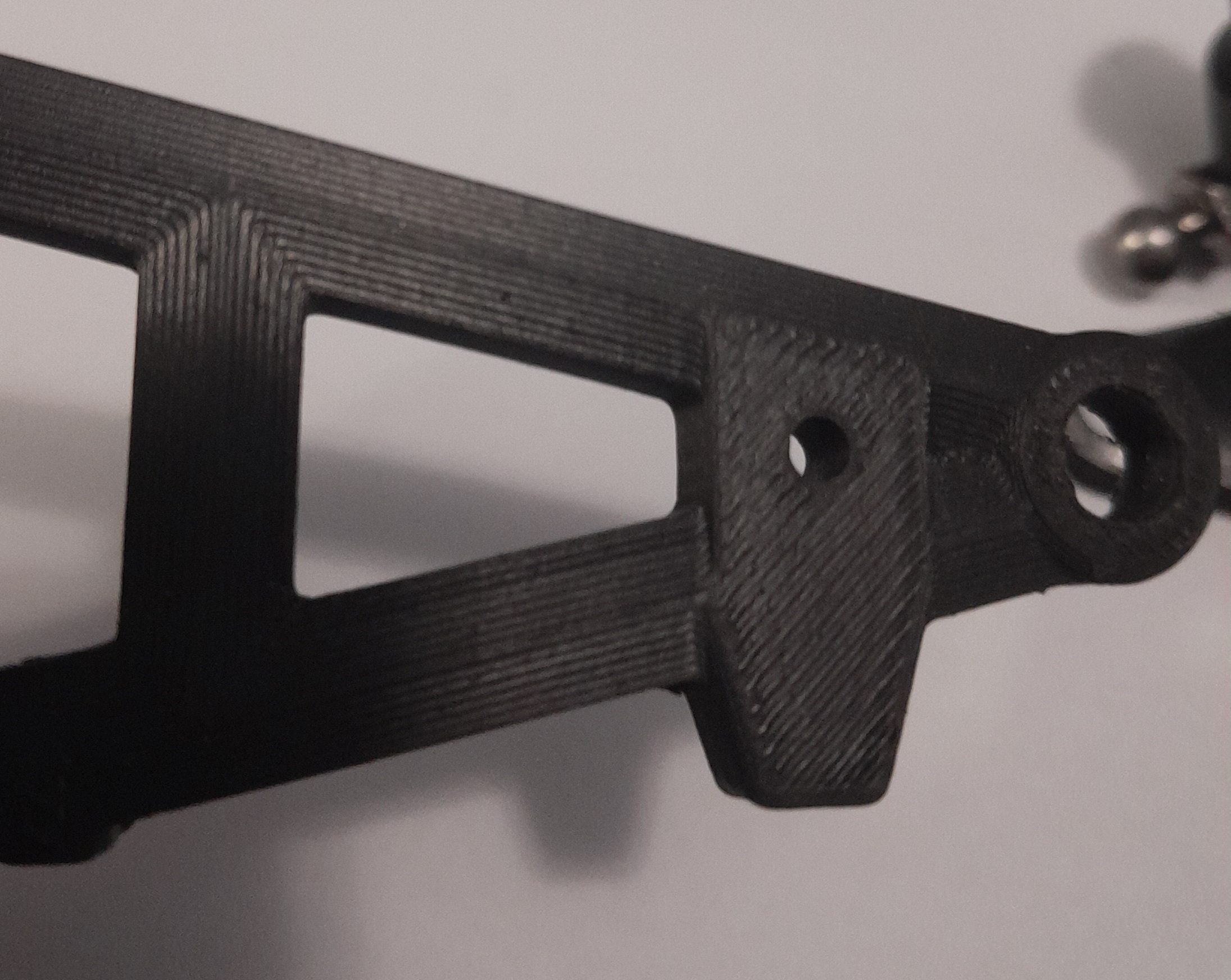

I'm so impressed with this PP filament , I've been doing some destructive testing on a couple of parts , firstly the first warped print I've been repeatedly bending it double then the other way , I've managed to mangle it but I can't break it :shock: then i though what about the suspension pin holes , this is the hardest thing to make strong with 3d printing , i put a pin in one hole and started pulling , it just stretched :shock: I had to twist it 180° before it stretched enough to snap and even then it wasn't at the layer lines , it just stretched thin enough to break , at the point of the pin holes the surface area of the layers is so small that it always breaks with other filaments , this stuff is mad .
I printed a Yokomo 834b front arm and it feels just like a real one in terms of flex and feel .
This is probably the most impressive filament I've used , I want to try a roll cage next as i think its the perfect material , also need to see what happens with supports , I'm thinking supports might be a nightmare to remove with layer bonding this strong .
