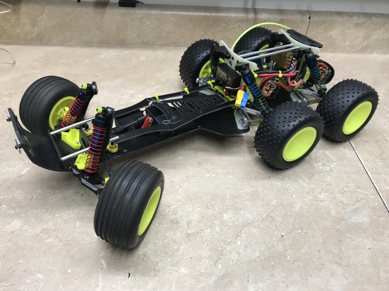

Been chipping away at this.
Got the chassis protection on
Servo savers were cracked and incomplete so put rere worlds bellcranks on it
I have a load of ball cups which fit great. Not sure what they are, schumacher maybe
Its going to be a runner, so ill use them.
The plastics just wouldnt clean up well enough so i dyed the bits that 100% needed it!
And some more stuff turned up
I got jconcepts tyres for the track and have some rere fronts for the garden. I have jconcepts rears coming too but no rere rears available so might fit kyosho tyres. I bought 2 pairs of new wheels and front tyres purely as they were cheap. Might try cutting a pair of fronts like schumacher cut staggers.
The jconcepts tyres, do i still use the plastic inserts? They dont serve any clamping purpose but they do seem to firm the tyres up a little by compressing the foam. The JC tyres are very thin and soft and even with the foams they seem a little squishy.
I also undecided about the rest of the plastics. They are all discoloured, but i have some used caster blocks, steering knuckles and front shocks coming and the parts on those are quite white. It would look best if all the parts are dyed but dyeing parts that arent too bad feels a bit wrong.
