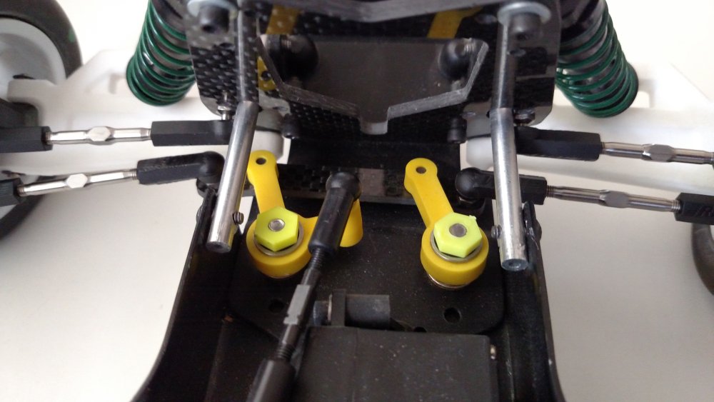

Just wonder if somebody tried to use truck setup on steering (bell cranks) ??
Should work or am I wrong!??

Vale wrote:Just wonder if somebody tried to use truck setup on steering (bell cranks) ??
Truck setup? I"m using the A&L Steering bellcrank. SEems to work fine.

Even using the rear holes (for bell cranks) on the nose plate?
Could you show us please :) ¿

You don't have to Niki, thank you anyway :) my quadra is partialy assembled and just wantex to know if i could use rear holes + truck bell cranks or rpm style bell cranks :)

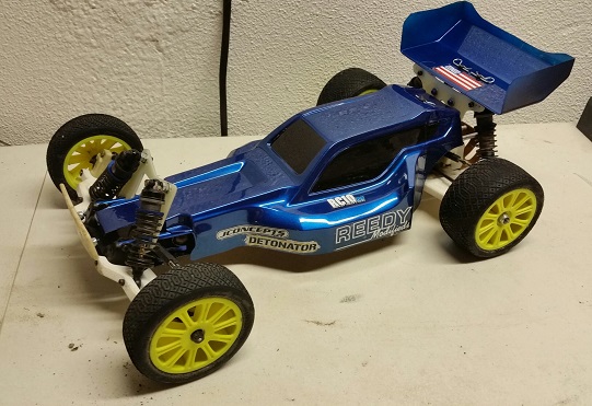

mk-Zero wrote:
Beau S wrote:Niki,
So, this design has the front and rear Track width maxed to 250mm, Roar Limit, using B4 drives, hub, hex, and std rc10 front casters with OG inline axles?
I read thru all 4pgs and saw this kinda scattered through comments. I'm just dbl checking the width, and strict need for the front suspension components.
thanks ;)
Joey's car was outside the limits, might want to check with him...
http://www.rc10talk.com/viewtopic.php?f=35&t=38746&start=15
Check that thread again... Joey is using b4 caster blocks, Niki designed for rc10 caster blocks. On a B4, he wheel is a little 'further out' from the hinge pin. How much... maybe 2mm? But enough to make it too wide. I would love to add trailing axle and front hex to my quadra-mid gold pan racer.
My racer pictured below is an absolute blast to drive. The quadra suspension and longer wheelbase transformed the car. I took 3rd place of the class of 12 stock buggies last night. I am planning to run two local club racing series this winter with this car in 17.5 blinky.

Vale wrote: Could you show us please :) ¿
Here's what my steering setup looks like with the Nix arms. Also, the front is exactly 250 mm wide. I'm using rulux wheels all around.

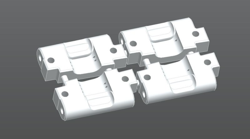

I just made beefier rear arm mounts with 2 degree and 1 degree anti-squat. Both 3 degree toe-in / side.
Do we need 3 degree and 0 degree anti-squat versions also?

New revised picture. I replaced the Klein arms with the Quadra arms.

What drill and tap's would you suggest using to prep the printed parts? Obviously an 8/32 tap for the rear arm mounts. But what else?

Well, you'd use a #29 drill bit for the 8-32 tap. You can use a 4-40 tap/#43 drill bit for the shock screws on the arms.

V2 parts ready. New arms are much stronger around hinge pin areas and rear arm has a new bent shape.
