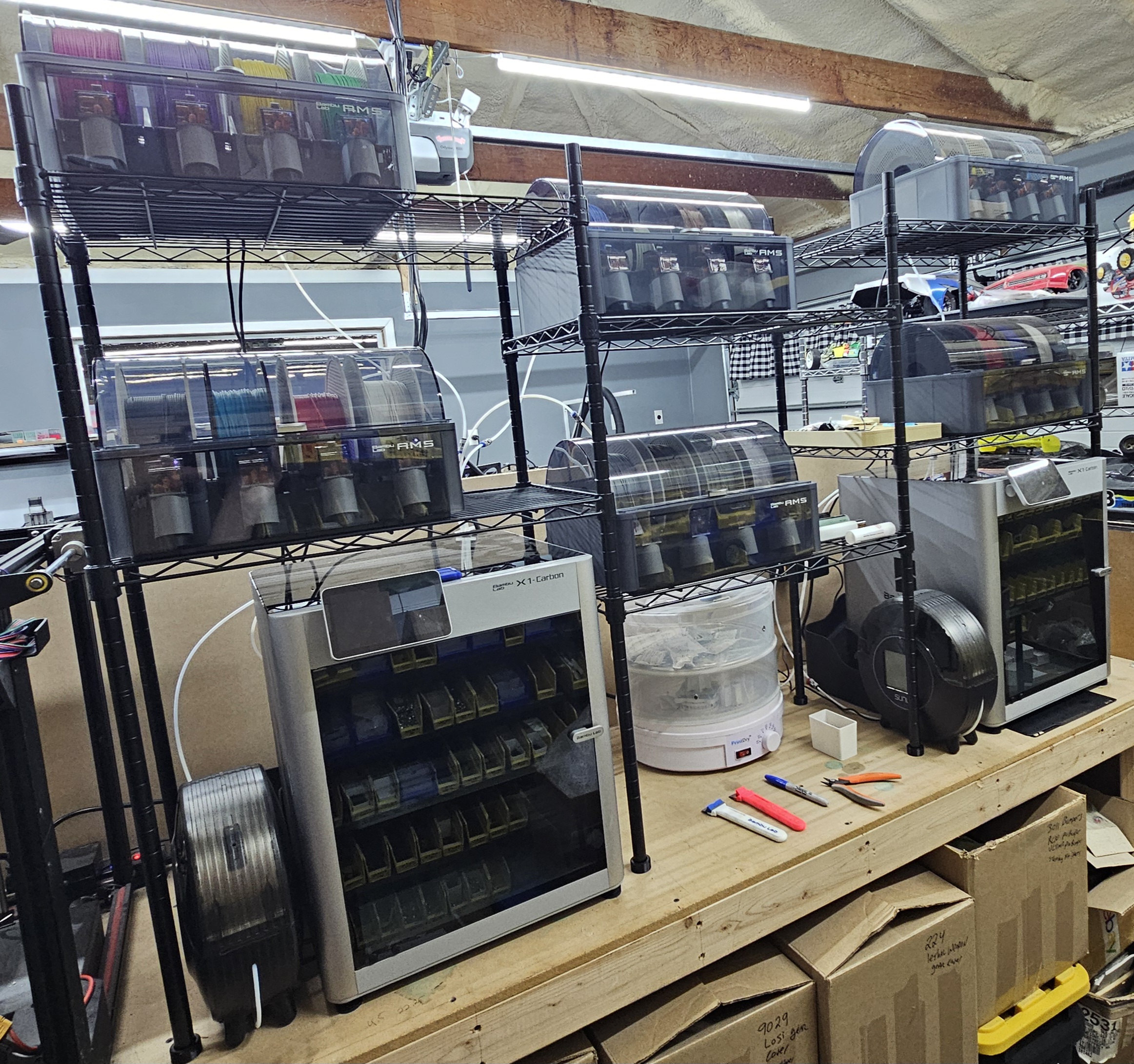

When Bambu has a sale on the AMS you have to take advantage of it
Anyone know how much you need to spend on shoes or purses to counteract something like this?

Re: a thread for BambuLab machines
In your case, AMS must stand for Awesome Manufacturing Setup.
Seriously, that's an impressive array of equipment you got there Jeff.
