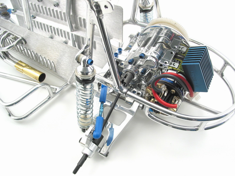

Alex at Inet did that on his sprints here is the link http://www.inetrc.com/Album/RC10_InetSprint/
