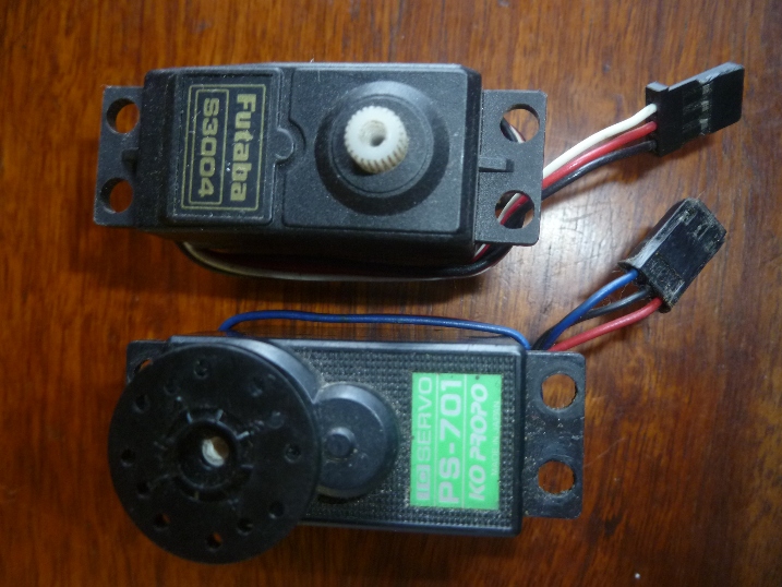

Re: Period Correct ESC
I purchased a new entry level speed controller recommended from Hobby Town; however it did not work. The sales man said that it my vintage KO Pro servos and remote were to slow for it. I then purchased what was advertised and appeared a brand new futaba mc 112b speed controller, but could not get it to power up with my KO Pro controller. I don't know if the speed controller is bad or if it is not compatable with the wiring in the KO servo? Any suggestions?
Ko should use standard pin layout, as opposed to Airtronics. What are the color codes on the ko servo? I want to say they use a blue in there somewhere. On the futaba it should be white, red, black. The servo is channel one, the speed control channel two. Those futaba esc don't have a switch so when you plug in the battery it should make the servo jitter.
Actually.... the older KO stuff had a different pin-out to the regular stuff (Futaba et al). While Futaba would be sig - pos - neg (white - red - black), the KO stuff, like older Sanwa stuff, had a pin-out of sig - neg - pos (blue - black - red).gomachv wrote:Ko should use standard pin layout, as opposed to Airtronics. What are the color codes on the ko servo? I want to say they use a blue in there somewhere. On the futaba it should be white, red, black. The servo is channel one, the speed control channel two. Those futaba esc don't have a switch so when you plug in the battery it should make the servo jitter.
If your receiver is blue - black - red, all you'll need to do is swap the pins around in the lead coming from the Futaba ESC, and everything should power up fine.
I thought I vaguely remembered early ko being different but I couldn't find pics to back it up. All the pics were more like jr/futaba
Just be careful- check colors twice before powering up. You'll never get the smoke back in the receiver
Just for you, mate....gomachv wrote:I thought I vaguely remembered early ko being different but I couldn't find pics to back it up. All the pics were more like jr/futaba
