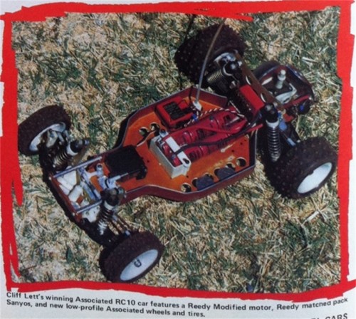

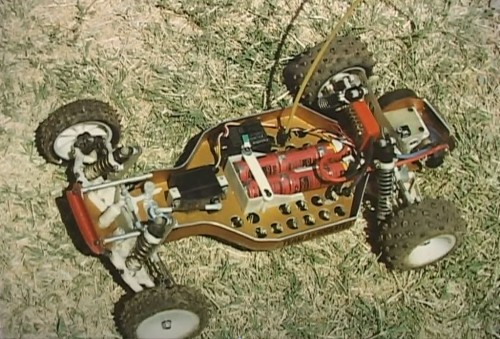

I did some research on his cars before bidding on it and I'm confident this was one of his. Below are screen shots of 2 of Jay Halsey's cars from the RC Off-road VHS, and the other is the RC10 Winning Edge video. Both videos can be found on YouTube. Pay close attention to the milling of the chassis on both cars and compare them to mine. Also notice all of Jay's cars has a black Team Associated decal on the side. I doubt this was someone's attempt to duplicate or make a tribute car because who would be so accurate on these details and then trash it and I doubt anyone was making tribute cars in the 1980's. The body has rare, vintage stickers like the JG Mfg. and the Radio Control Race Center RCRC decals. The guy who had it before me probably used it as a basher, installed a stealth tranny and black motor plate, installed a crappy servo, replaced the wheels with aluminum, changed a few other minor things, and hacked the body a little bit not knowing anything about the car. Also the nose plate may have been changed because the anodizing is more like the Cadillac RC10 era. I doubt it's a 100% Halsey original...more like 60%. That's why I'd like to restore it with period correct parts. If anyone is curious how much I paid, shoot me a personal message. Let's just say you can buy a new brushless motor and a set of brand new tires for what I paid and it was free shipping. :wink:

Yes, the chassis looks similar but I think that was probably the point. The milling off the sides looks good but the swiss-cheesing looks more random and sloppy and less precise and the motor guard hasn't been touched. The nose plate hasn't been modified and the nose brace tubes have not been trimmed. And you really can't go by things like having the right stickers as being an indicator since they could be easily replicated by looking at pics in a magazine or watching a video. Ignoring the obviously newer Stealth transmission and motor plate, too many small details about the car are just wrong, like the very stock hardware, shock towers, threaded rods instead of turnbuckles, Andy's arms, MIP steering, aluminum wheels, etc. So basically only the chassis and body are a loose 'maybe', everything else is a 'no'. That said, ANYTHING on the car could have been changed in the last 30 years so it'll be impossible to verify. The price you paid, which sounds like it was around $100-$120, seems perfectly reasonable if not cheap for a complete RC10 with aluminum wheels and a working Stealth.

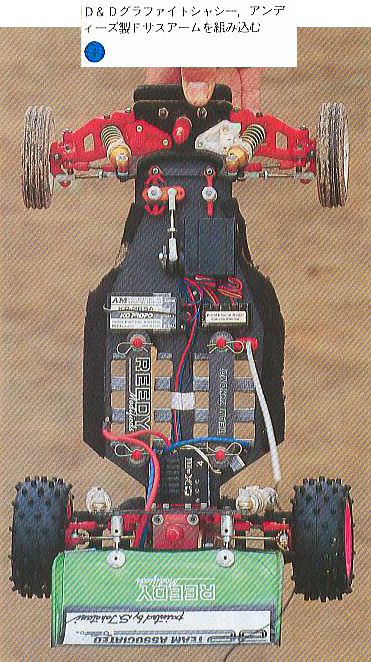

but, most of the ae guys in '88 were using andy's arms..... at least on the front. the ae wide tracks didn't come out until the following year.
masami:
cliff:
even halsey. also note some threaded rods on his car too:
here's the body from the above car. note the hand painted "Jammin Jay" under the window.
i'm not saying it was halsey's car. but just because it has a stealth and aluminum rims doesn't mean it never was...... at least some of it. jay is only an email away. ask him what he thinks. :wink:

I emailed the seller of the car to get more info on the car's history but got an auto response saying he won't be available till July 21st. I'll try to contact Jay through his website's customer support. As far as the car goes, I believe the chassis and the body is original. Everything else is questionable. This of course is my opinion based on the screen shots and photos.
BTW, the motor guard on this screen shot doesn't seem to be touched or trimmed down either. Also, the holes on my rear motor guard are countersunk with the wrong screws used. You guys think Jay used countersunk screws on the screen shot below?

The thing that bugs me on the tub is the lack of planning when drilling the holes. All the pics I've seen the holes are strategic, not touching the smaller 4-40 holes and certainly not Ovaled. It was very common to copy Jays chassis cuts, I've done a few now and I know others around here have cut their fair share. To me the chassis doesn't add up.
The body is the part that I would be looking closely at. While it was very possible to do up a copy back then, the signature looks pretty good.
