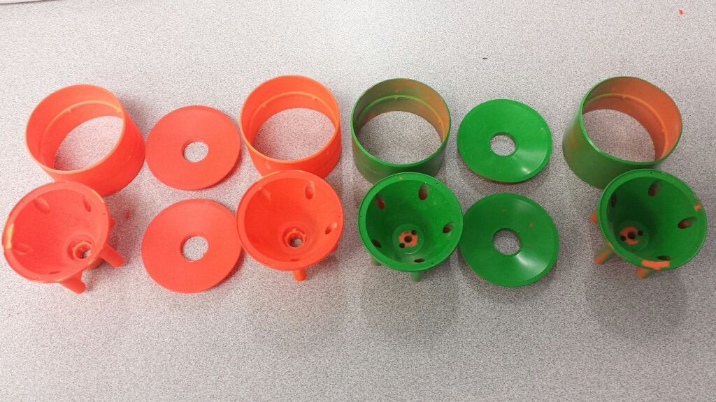

I have some Jrxt wheels that have been painted with Pactra orange and green lexan paint (same as on the body, lol). Any suggestions how I go about removing the paint with out damaging the other wise great condition of the wheels?

The paint already flakes off a bit. The acetone shouldn't effect the shouldn't effect the orange color of the wheel?
