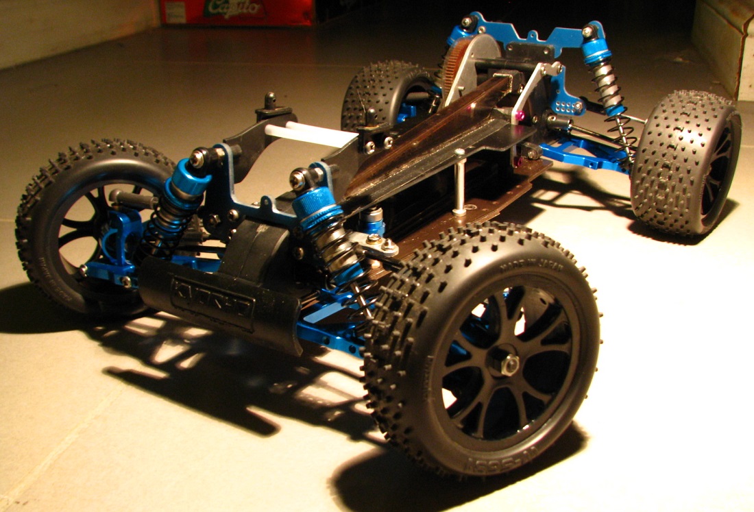

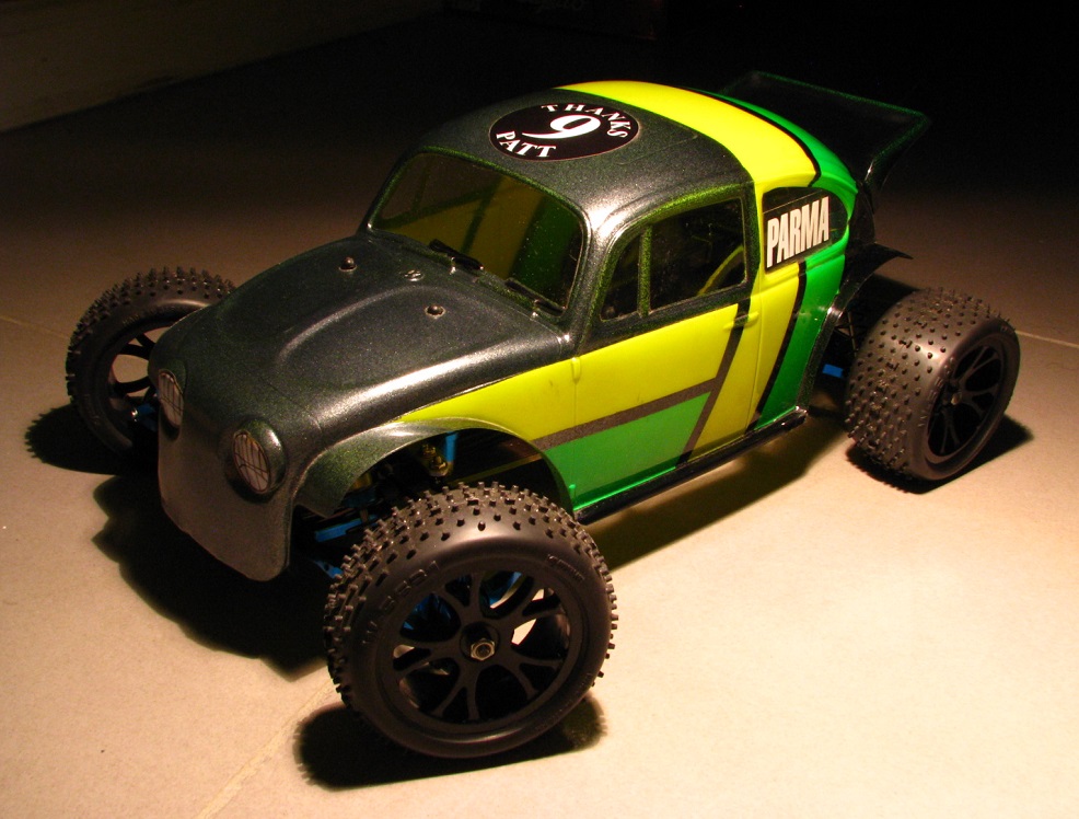

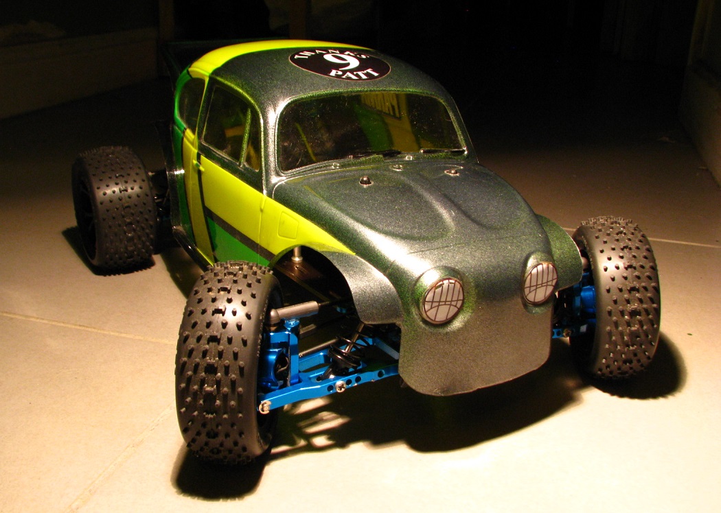

Finished another one for the shelves. The bling stuff is not something I'd go for on a race car, but it's kind of functional on this car.

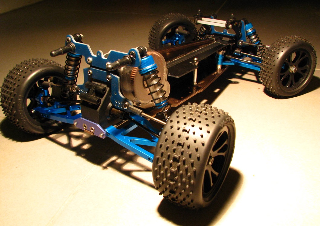

The suspension geometry is improved and now similar to what you'd find on a Lazer. The arms also increased the wheelbase: now about the same as on a LWB optima mid, even though it's just the standard SWB chassis.
Some of the less visible upgrades: no more clamp-on hexes but descent cross-pin hexes, steel idler gear, one-way diff in the front.

Not a huge fan of Bug bodies, BUT, I do love the rest of the car, and especially like blue anodized aluminum. Plus I have a soft spot for Optima Mids, since I had one as a kid.

Bitchin' Bug. Like the tires.

I'm not a Bug fan either, but that's a great paint-job! Of course, I like the blue alloy bits beneath the sheets too.

Thanks. All the blue alu parts in the suspension are a kit for the tamiya df03. Eagle Racing or something similar.HKS_TRD wrote:Looks amazing, any more details on the wishbones?

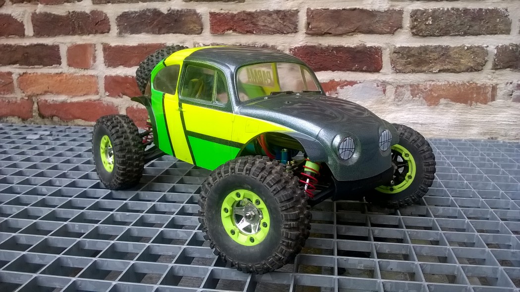

I didn't plan to run this one, but my crawler gave up on me. Got a new one on order, but it's still on its way.
So I salvaged the solid axles, electronics, wheels, tires and battery. Replaced the blue suspension bits with mid originals and mixed it all together.
It still looks somewhat the same, but what a difference when the 790kv and tiny pinion make it crawl up on the enduro hills.

Mr. ED wrote:I didn't plan to run this one, but my crawler gave up on me. Got a new one on order, but it's still on its way.
The crawler set up looks great!
Those wheels really compliment the paint.

The chromed wheels with green beadlock are from wltoys. The black ones... lrp or fastrax perhaps.
The blue arms I bought about 9 years ago in Japan in the local shop.
I used the complete set: axle carriers, c-carriers and steering knuckles. Only using the arms didn't work well amd required lots of spacers, grinding the arms... No good.
I believe I also used 2mm longer driveshafts than with the stock or lazer suspension.
