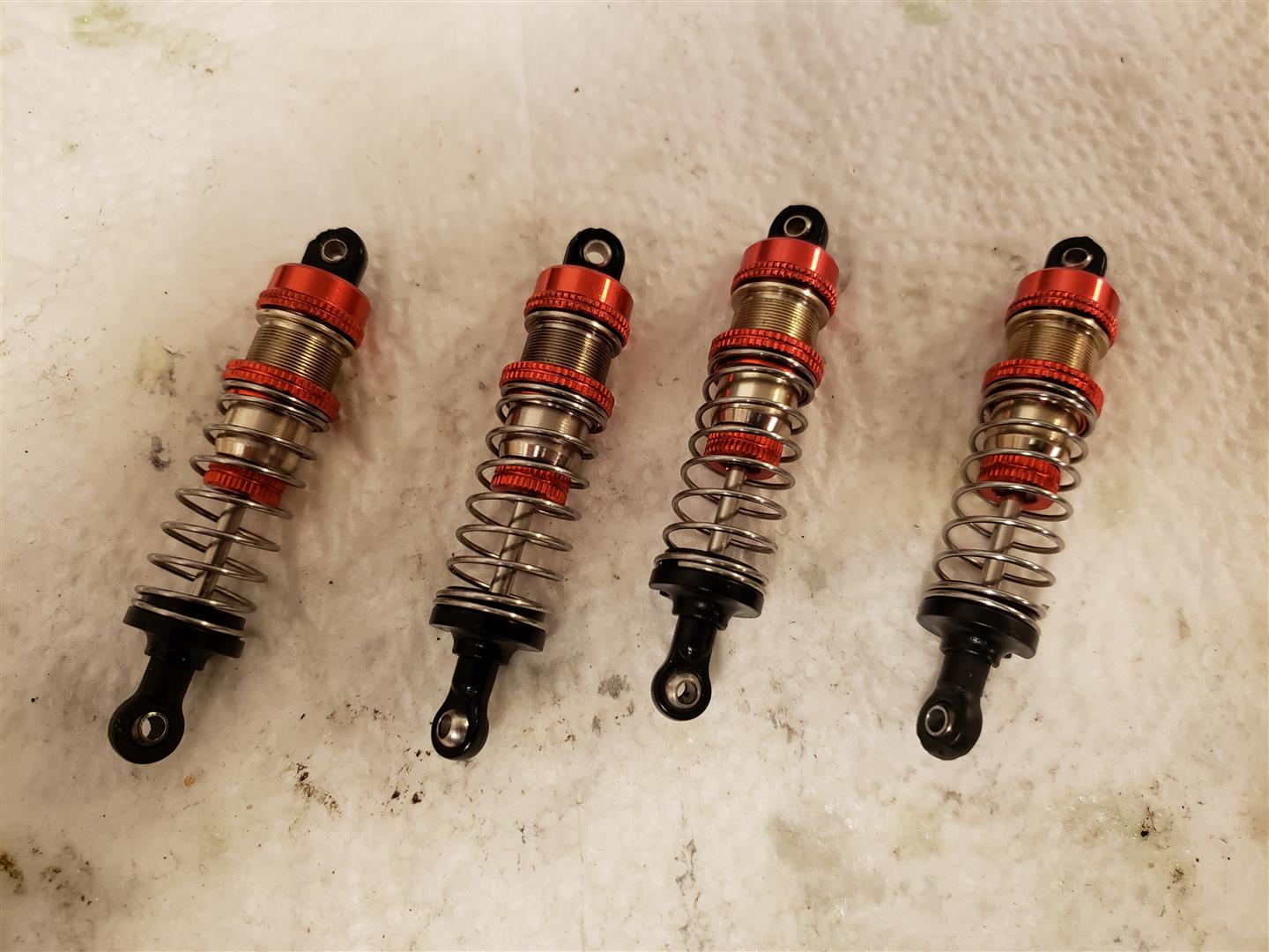

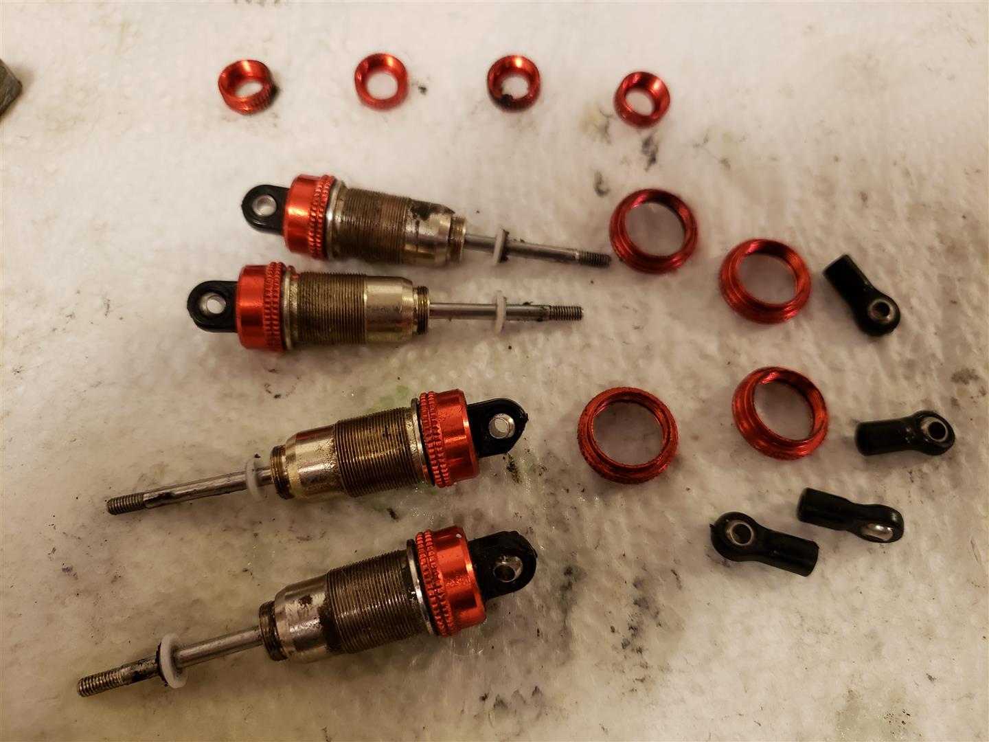

I’m finding the threads on the big bore shocks are very hard to clean. My brushes don’t seem to be fine enough to clean the threads out.
Soak in a degreaser like purple power?
I’ve been wanting a sonic cleaner, anyone use those?
How do you clean em?

Use a small brush and alcohol. Be careful cleaners will strip anodizing and those threads are fairly fragile to begin with. Once you're done cleaning add a couple drops of shock oil.

Toothbrush 'em with a squirt of WD-40, that'll loosen up the gunk, then wipe. With the threads, I've used a cloth pinched onto the top of the threads with thumb & finger and "unscrew" the cloth all the way, that works very well. I did that recently in fact, with the threaded shocks on my F-Bomb WLToys 144001 project.

When ever I clean threaded shock bodies I always remove the springs and thoroughly clean the threads with a toothbrush.
Then lightly oil the shock body and remove the spring collar.
The trapped dirt is very abrasive on the threads.
I've changed from Simple Green to plain old dishwashing liquid and warm to hot water. For me it just works better.
