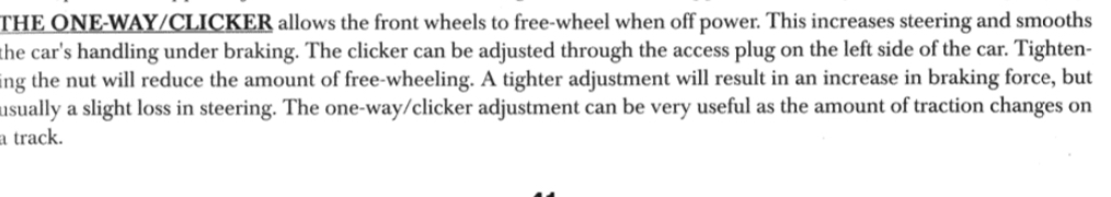

As he said….
And Per the manual…

The clicker nut is the one you show in yellow.
I suppose you could take the spring out and install a spacer to lock up the clicker but it was designed to do exactly what it is doing. Making the noise go away also makes the function of it go away as well.

What Jeff said. That clicker spring is quite weak, so you will likely have that sound even fully tight. There is a small window where braking is either too much or too little, so unless it's really impacting your driving, that's how this car sounds and works. You won't ever get full 4 wheel braking with that in place.
