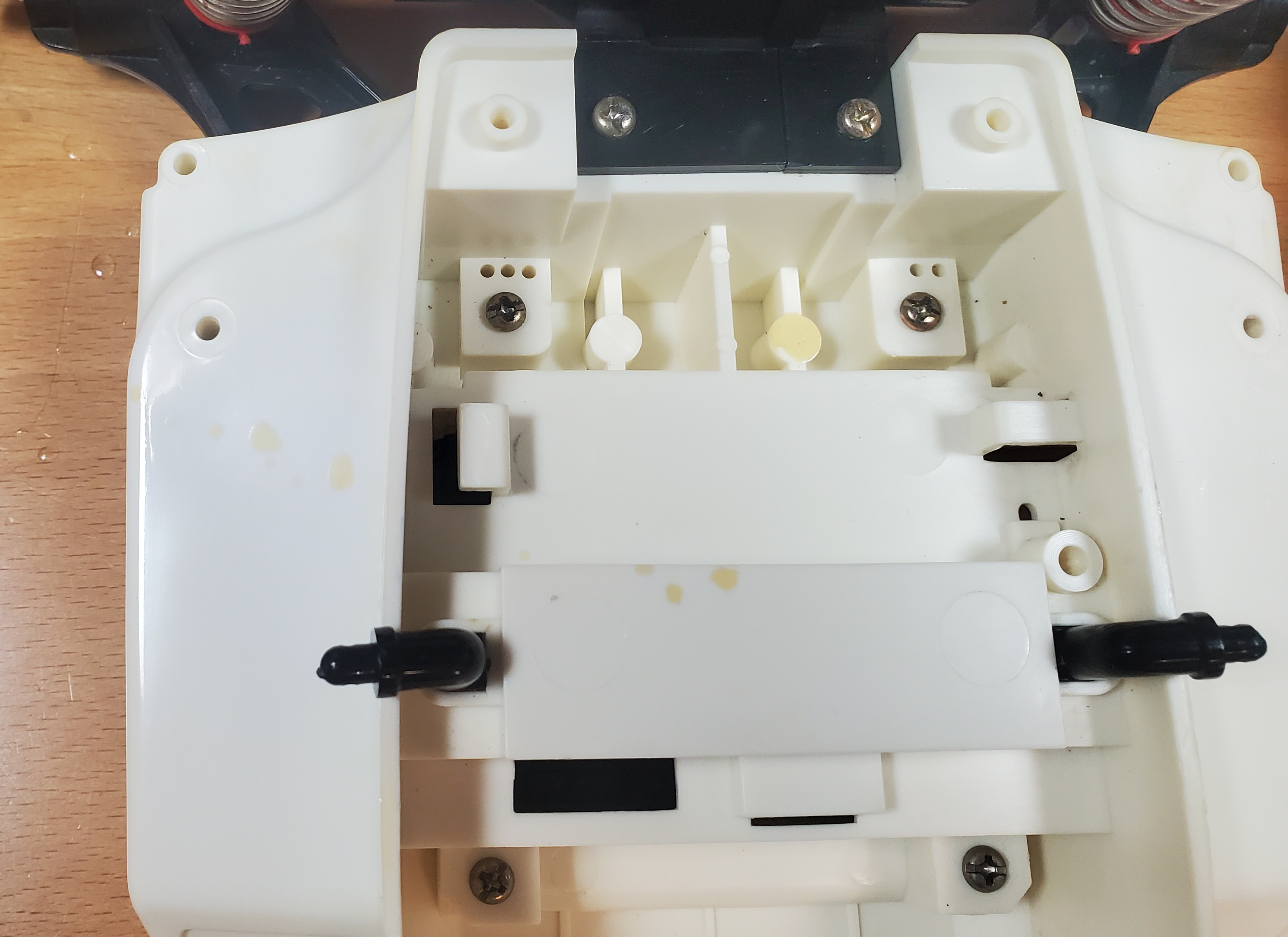

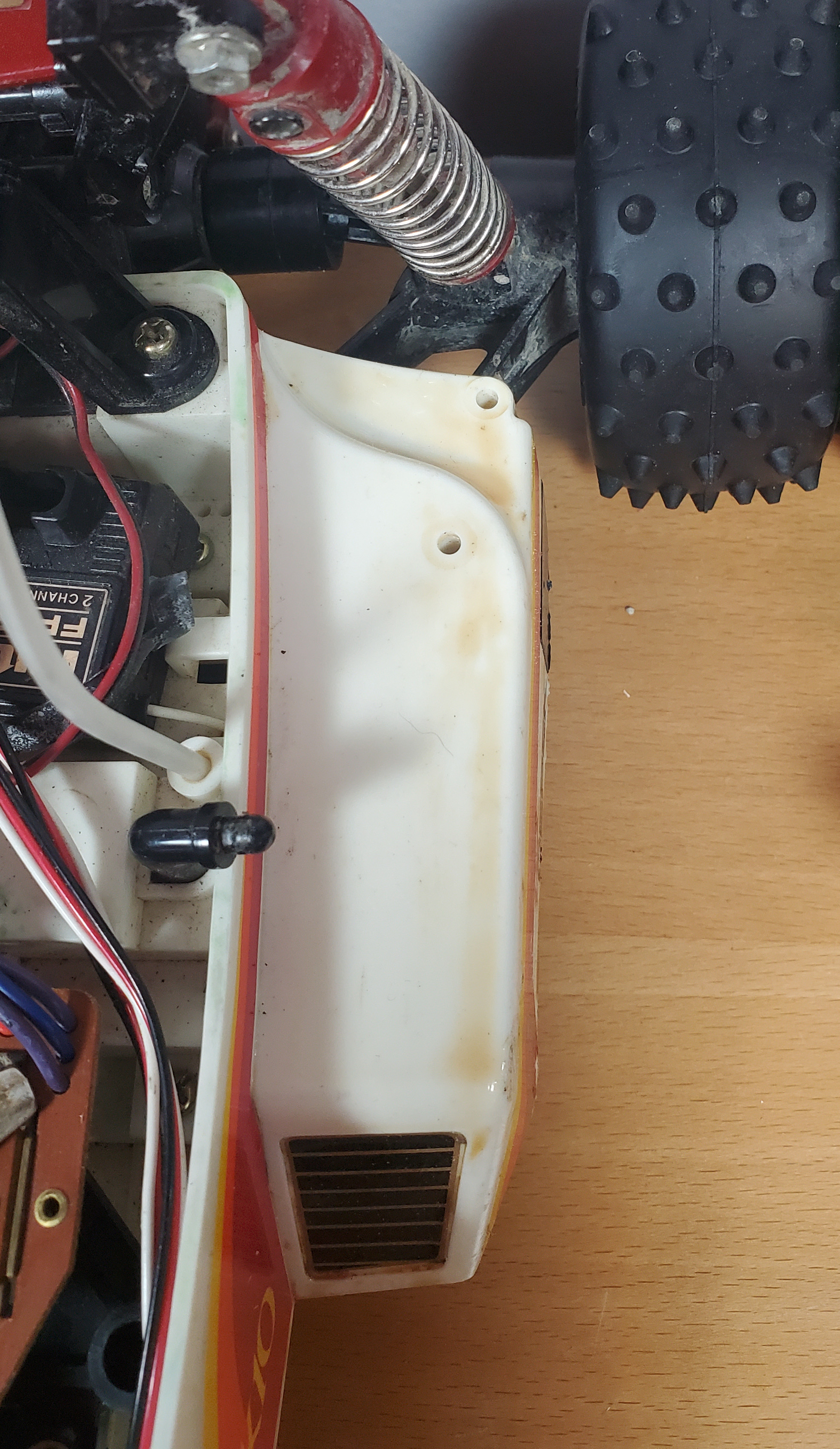

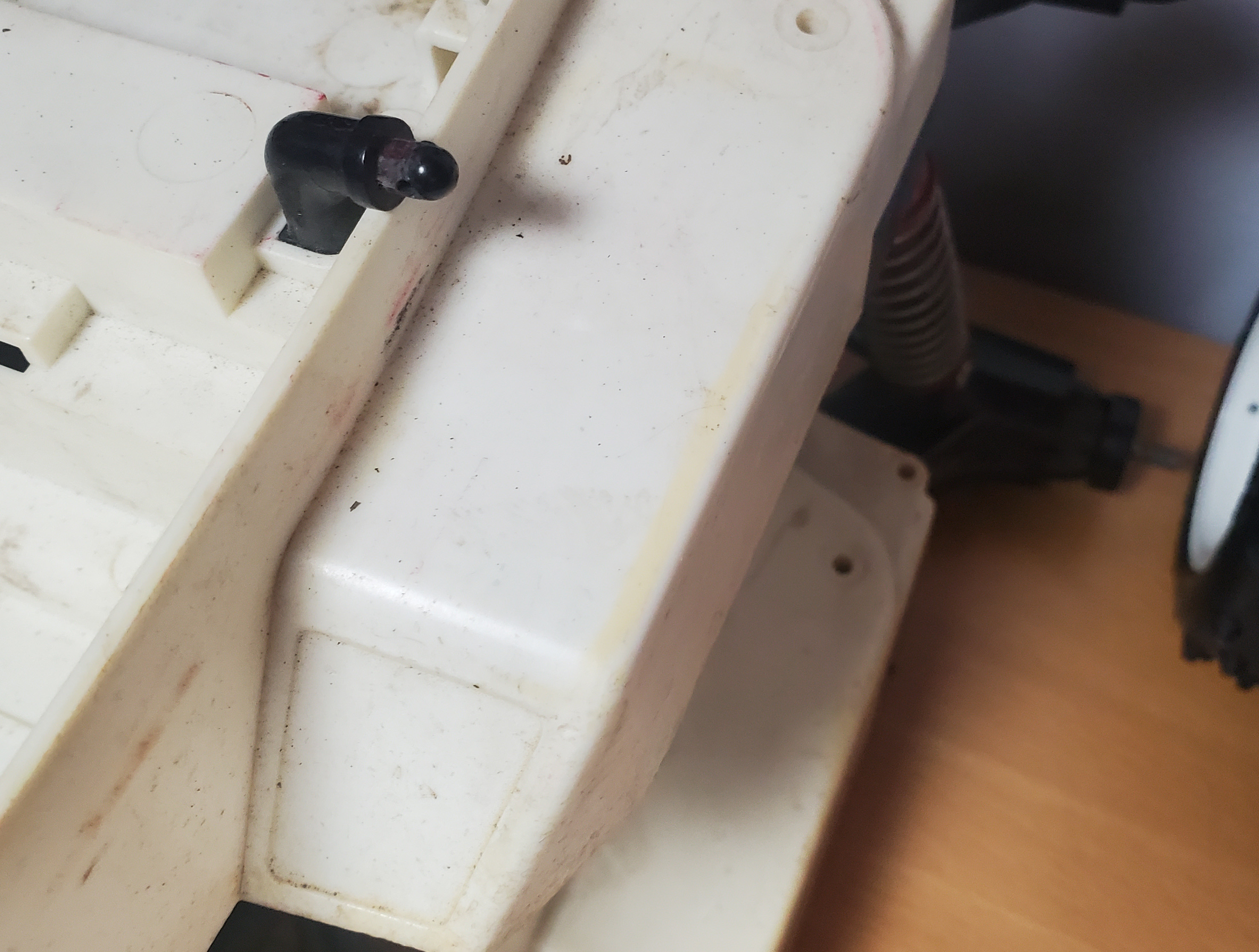

I have an assortment of FX-10 chassis that I am looking to break down into builds. I knew my best [new] chassis was pristine outside of some orange spots on it. Its like some spots of dried up Coke. I looked at some of the other chassis, and noticed this seems to be a theme on them. Probably 4 of the 7 tubs I have have some sort of oranging to them. The spots may be something different because they are spots and not lines, and it feels like I can feel the spots(maybe in my mind), whereas the lines seem imbedded.
Just wondering if anyone has any experience with these, or some advice in regards to removal / cleaning.

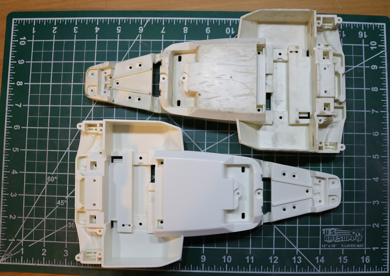

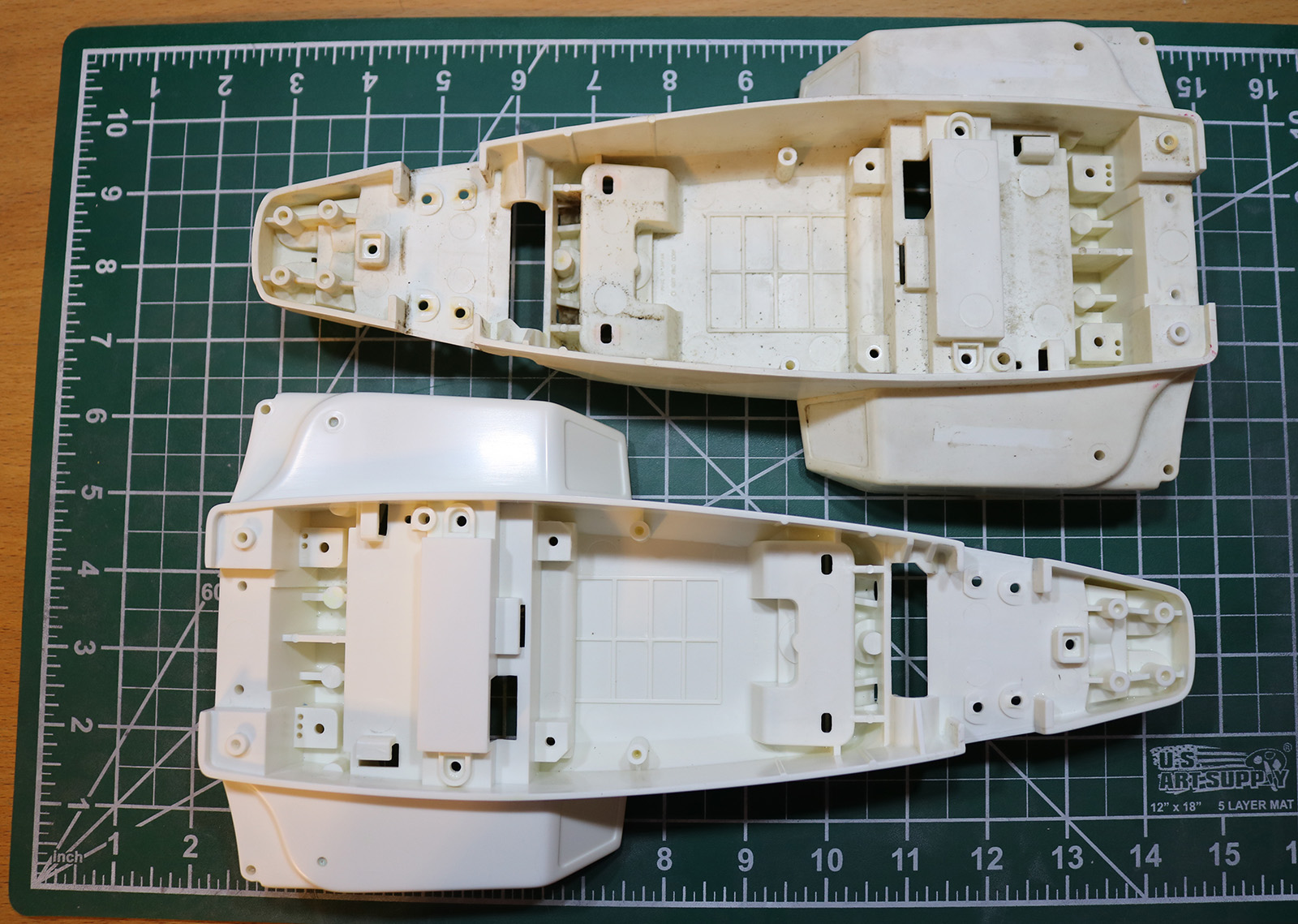

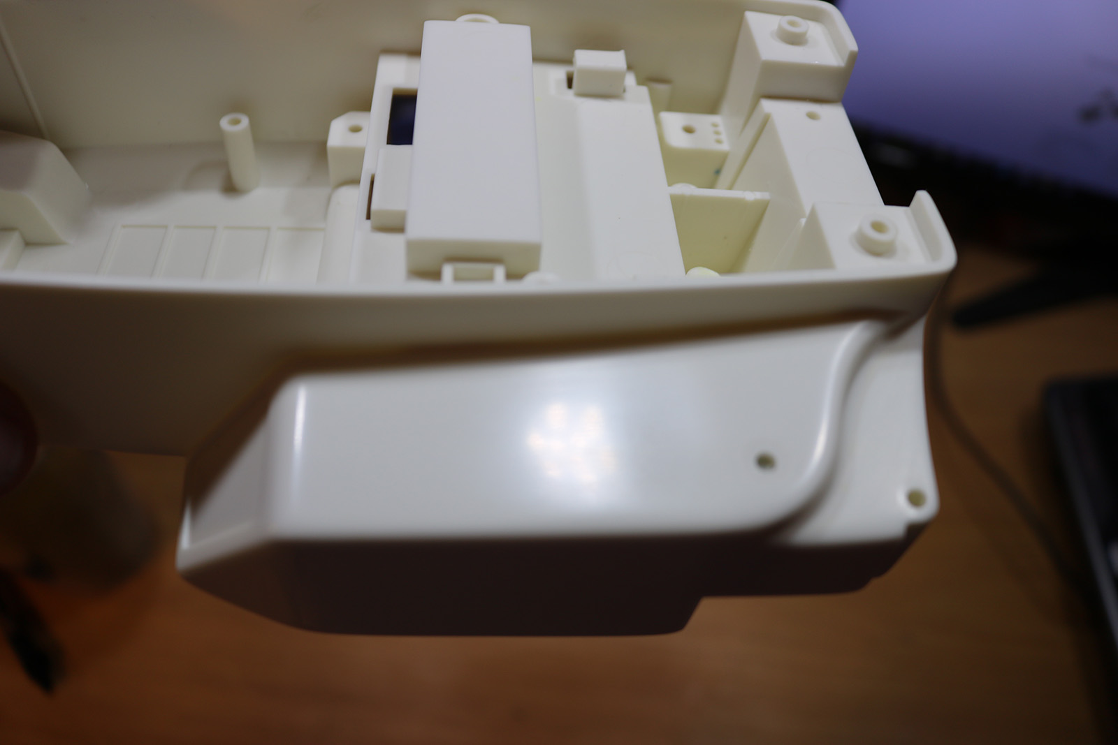

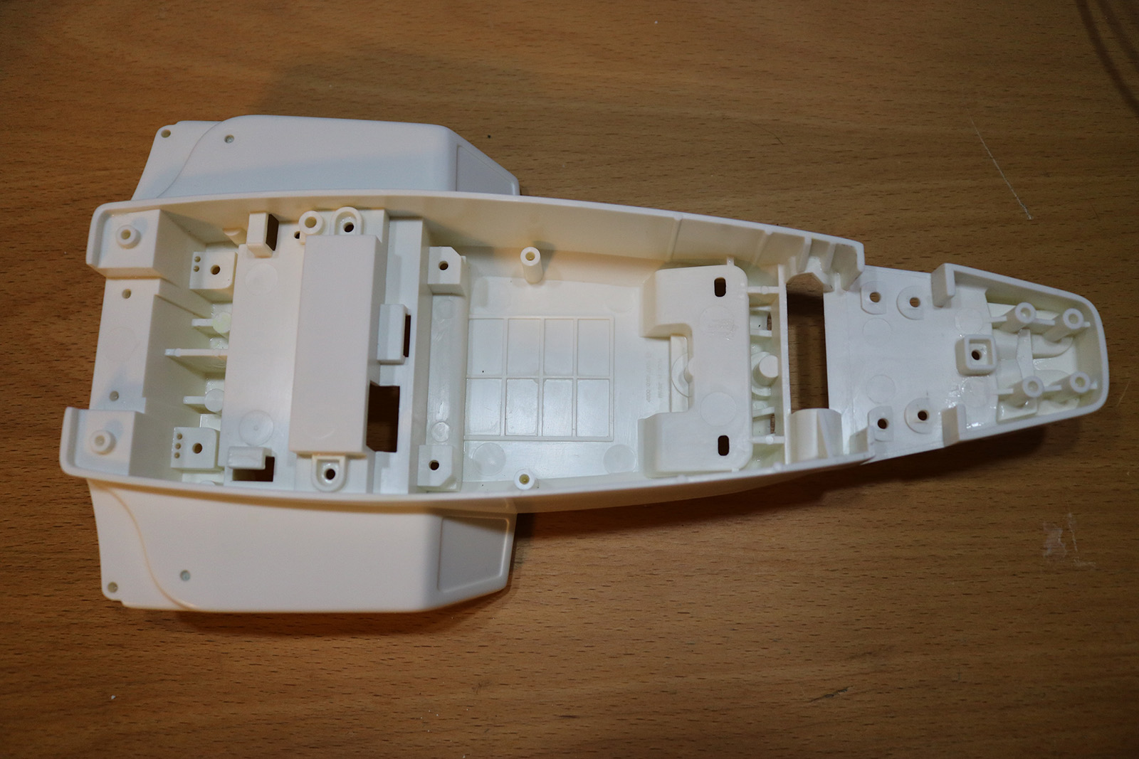

Had a little time to experiment, and this is one of the results.
The left side of the right chassis has been sanded from 500-2000g, all wet and pretty quickly. The left chassis is "new" but obviously aged.
Results are that it took 500g, maybe 600g, to cut through the initial layer of all of the orange / yellow coating. This would include putting in just a little more effort on the severely oranged portions. The results are 90%+ of factory, and completely acceptable from 12" away. It is that last 10% that I need to work on, and that is the part that makes it shine just a bit.
And no, there is no way I am going to sand the inner portions of the tub to lighten them up! That would appear to be complete torture! As far as making 90%+ results, that is only going to end up on the sides that can be seen. I know, call me lazy.....

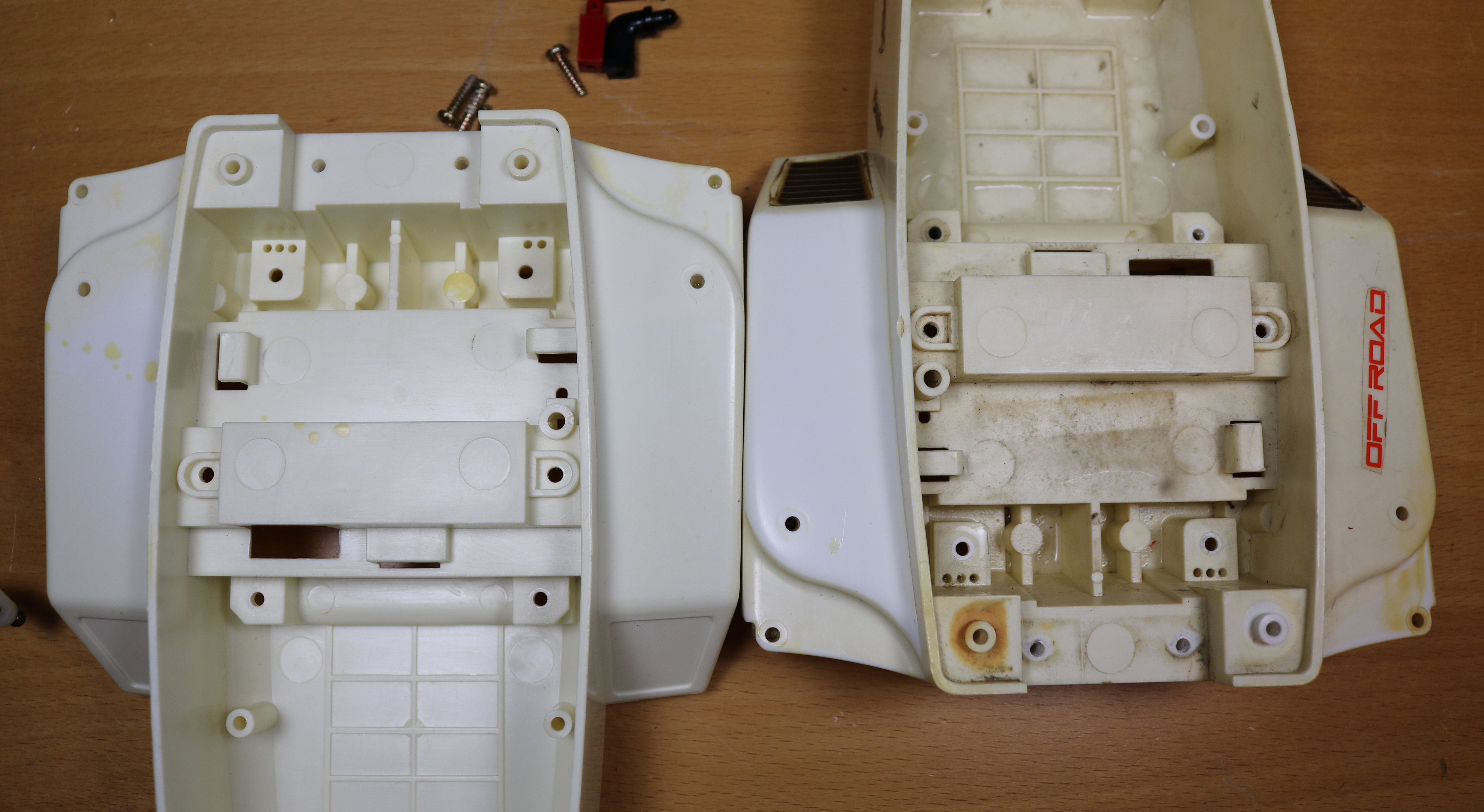

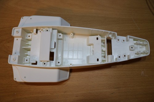

Well, the first chassis turned out better than expected giving that I had to sand out the spots on it that I still don't understand. All of the flat spots were sanded and polished, and all of the low spots got a Salon Care 40 Creme treatment for about 8 hours (4 each side), and I am 90%+ happy with the results. The outer portions of the tub had a bit of a shine to them stock, and I got it pretty close. It actually reflects better than it shows in the pic; my auto-focus just decided other things were more important. The next chassis is going to be more of a challenge. And then the one after that, even more.
