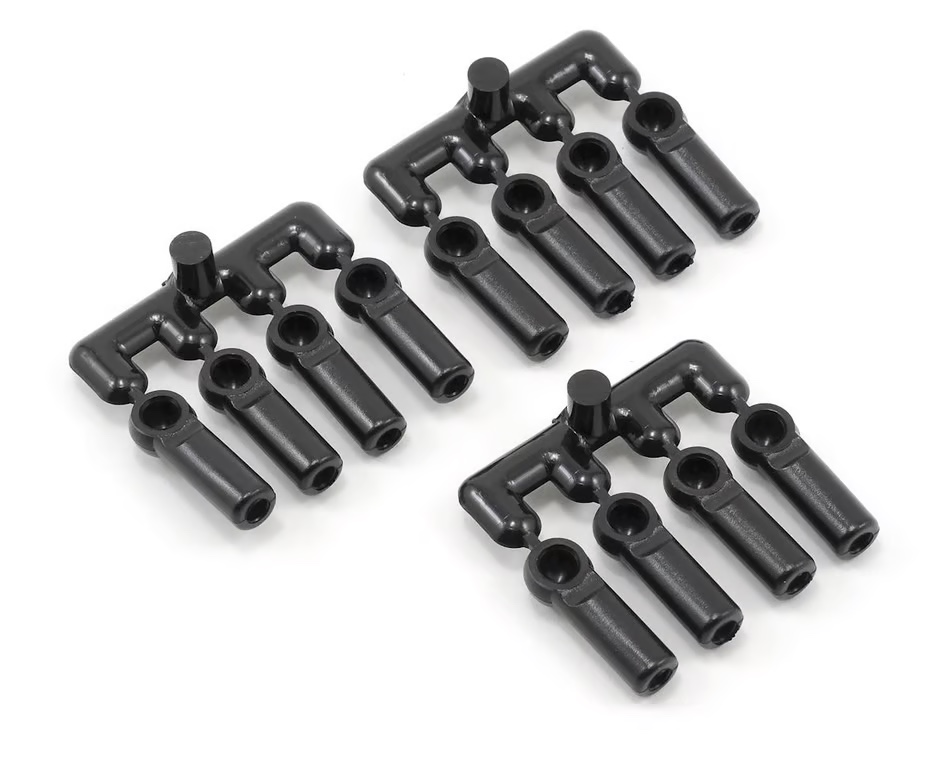

Just about any will work fine on the 4-40 rods. For the larger diameter version I'd use RPM.RichieRich wrote: ↑Sun Jan 29, 2023 8:19 pm Thanks guys! So, a car with a stealth transmission is fine. Funny thing about my Tecnacraft misspelling, in my mind I'm typing it correctly but my hands are throwing in the H.What is the suggested ball end to use with these?

Be careful with RPM ball cups on a RC10 buggy. Clearance between the camber links and steering link gets tight. Thick shock towers and/or bulky ball cups can cause interference. Those thick aluminum bellcranks will do it as well.
Using Schumacher Atom (low profile) ball studs at the shock tower attachment helps a little. The ball is the correct size but they are M3 thread.

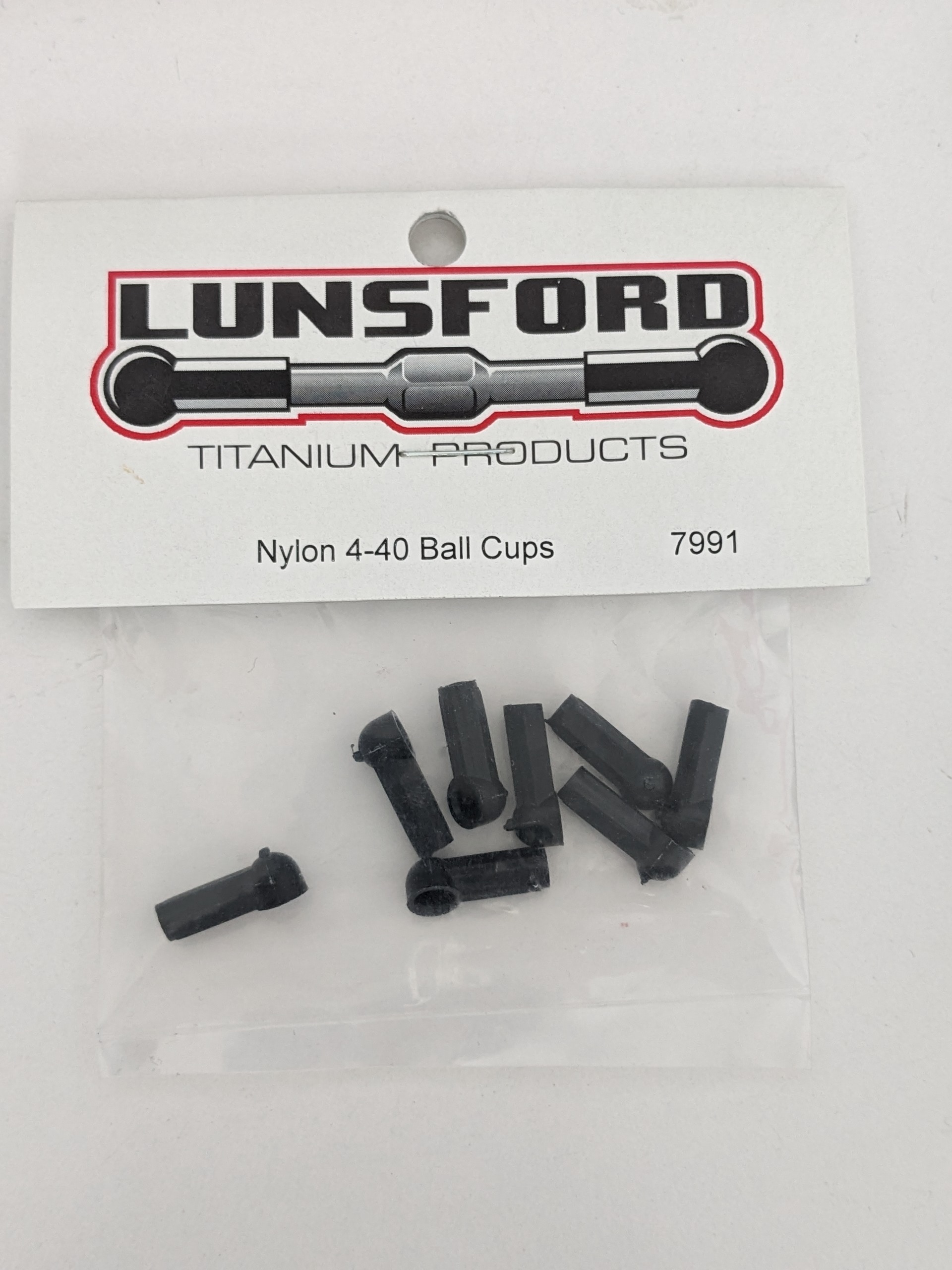

It might be a bit like putting Losi tires on an RC10 and they might be getting scarce since Lunsford closed up, but Lunsford 7991 ball cups are a good option.

Those look like Associated 6274 to my old eyes.Frankentruck wrote: ↑Fri Feb 03, 2023 1:42 pm It might be a bit like putting Losi tires on an RC10 and they might be getting scarce since Lunsford closed up, but Lunsford 7991 ball cups are a good option.

Kelly had his ball ends molded next door. I’d swear they had a different look than those shown though.
Edit- they must have packaged AE for the 7991 before transitioning to the 7995 which he was molding next door.
