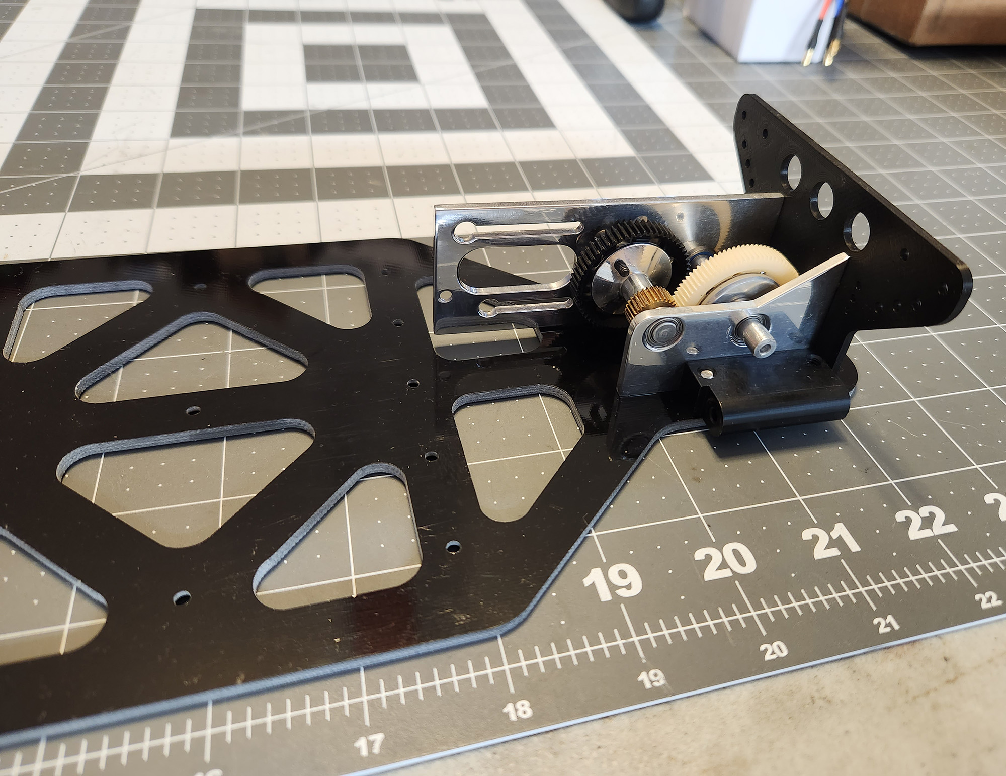

I get my replacement chassis plate from FTW, and go to mount the trans, and it doesn't quite match up. Come to find out the PO had "ovaled" the mounting holes for the trans/ arms mounts to make it fit. Which leads me to where I am this evening. GomachV has suggested shaving some of the arm mounts, which is a great idea but I worry about leaving enough meat on the bone, and this trans (and mounts) are pretty rare, so I don't want to modify anything unless I have to. phin suggested flipping the flanged bearings to narrow the plate width, which again is a great idea, but then there is nothing to keep the bearings from leaving outwards, and it leaves too much play on the shafts internally. The trans plates are 1/8" themselves, and the bearing depth minus the flange is about 3/32", so that is letting the shafts slide.

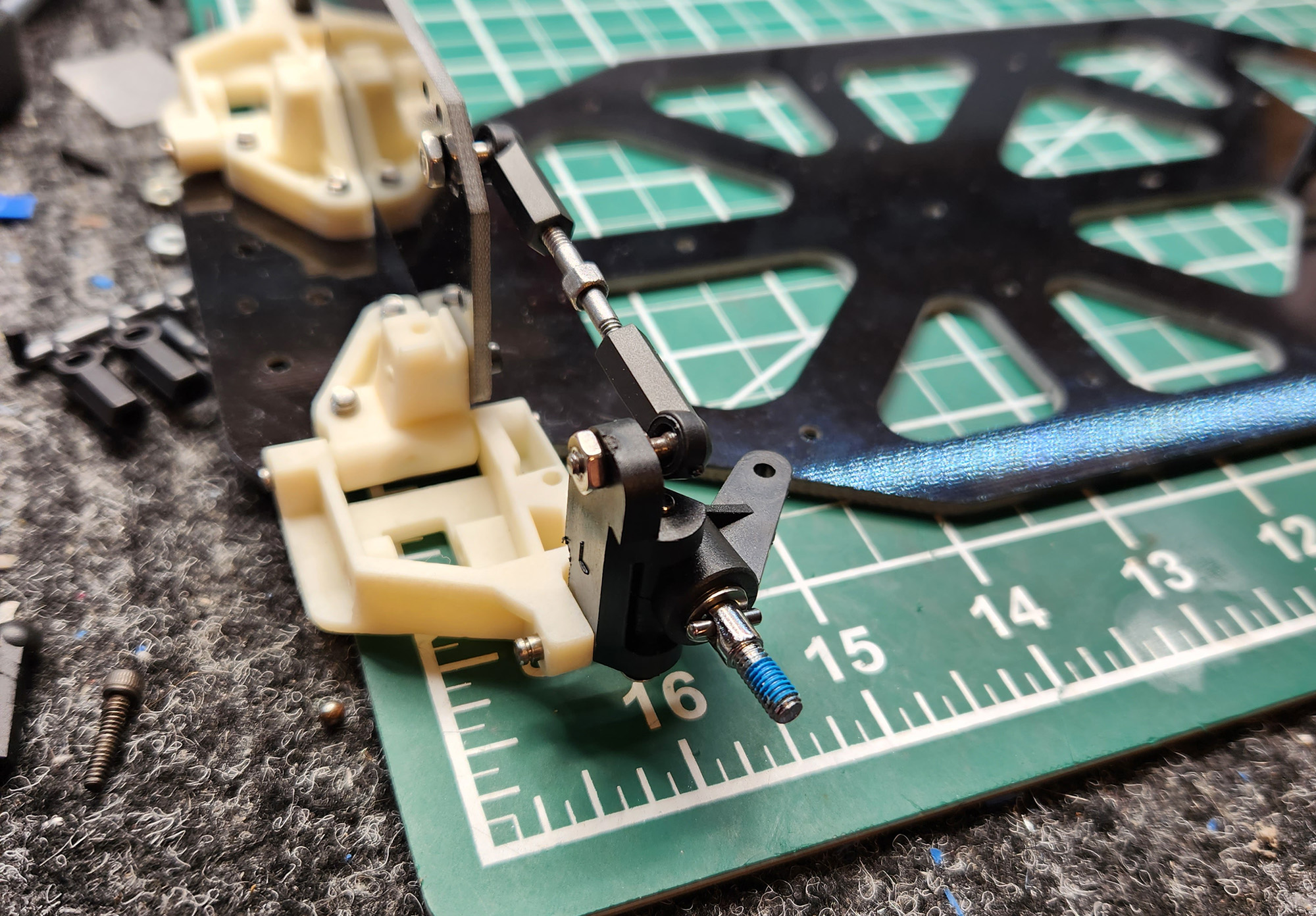

So ultimately, I went with Phin's original suggestion and flipped the bearings around in the trans, and all is going to be fine (for a car that probably isn't going to actually get run). The bearings are a tight fit, and I found some 1/4" shims, so I could take up the side to side movement of the shafts. I ended up getting the rear end mocked up to just about how I think it will end up.
I got to looking at the front end, and ran into an issue real quick that I didn't think about. What do I do about caster blocks without a kickup chassis? Is there a such thing as 0, or close to 0, degree caster block? I threw some Bandit blocks in there, and they are fine in regards to caster, but RC10 knuckles don't really fit in them well, and the Bandit knuckles have internal bearings, so not sure how to attack this one quite yet. EDIT: Through research, what I am looking for is 30* caster blocks.

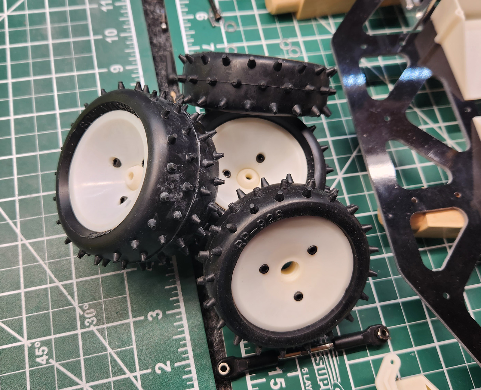

A good chunk of the rest of the rig is coming together kinda as a spare parts build. I have most, if not all, of the nylon I need. I found a set of CE wheels and some NIP spike tires that should do the trick. My hold up right now is waiting on a lowering kit from Shapeways. That may not be here for a couple of weeks.

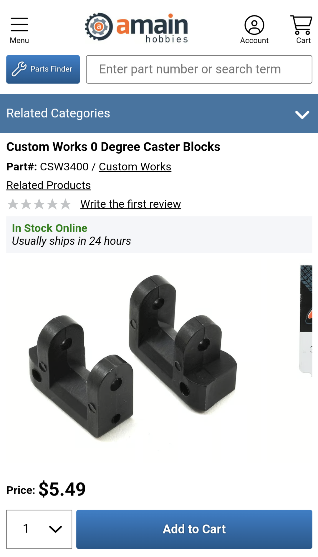

If you were looking for 0 degree, maybe this would have worked.

I saw those earlier, and almost ordered a pair just to see how close they would be. I ended up finding a shop with a new set of 6210 30* black blocks. so I ordered those, and did a bit more digging and found a white pair in all my junk. Just have to wait to hydrate and whiten.Frankentruck wrote: ↑Mon Mar 20, 2023 9:51 pm If you were looking for 0 degree, maybe this would have worked.

You can also flip the blocks left to right. You would need to clearance them for the steering to work correctly but that's how some did it bitd

You could also run some Cheetah castor wedges under the front arm mounts. I believe you can print those on the Shapeways site as well.

Thanks for the tips guys! The 30* blocks I found cleaned up well enough so they will be used.

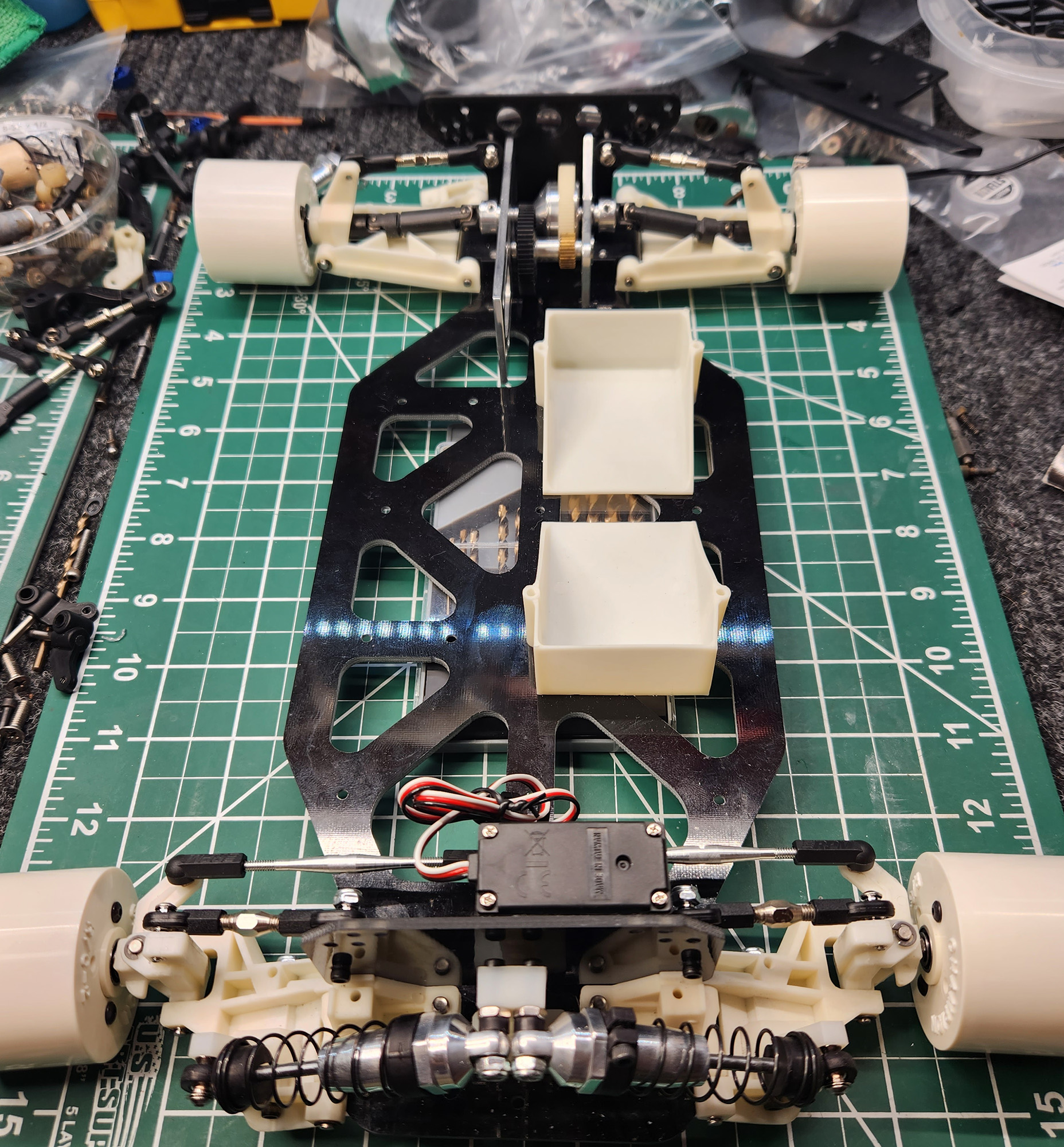

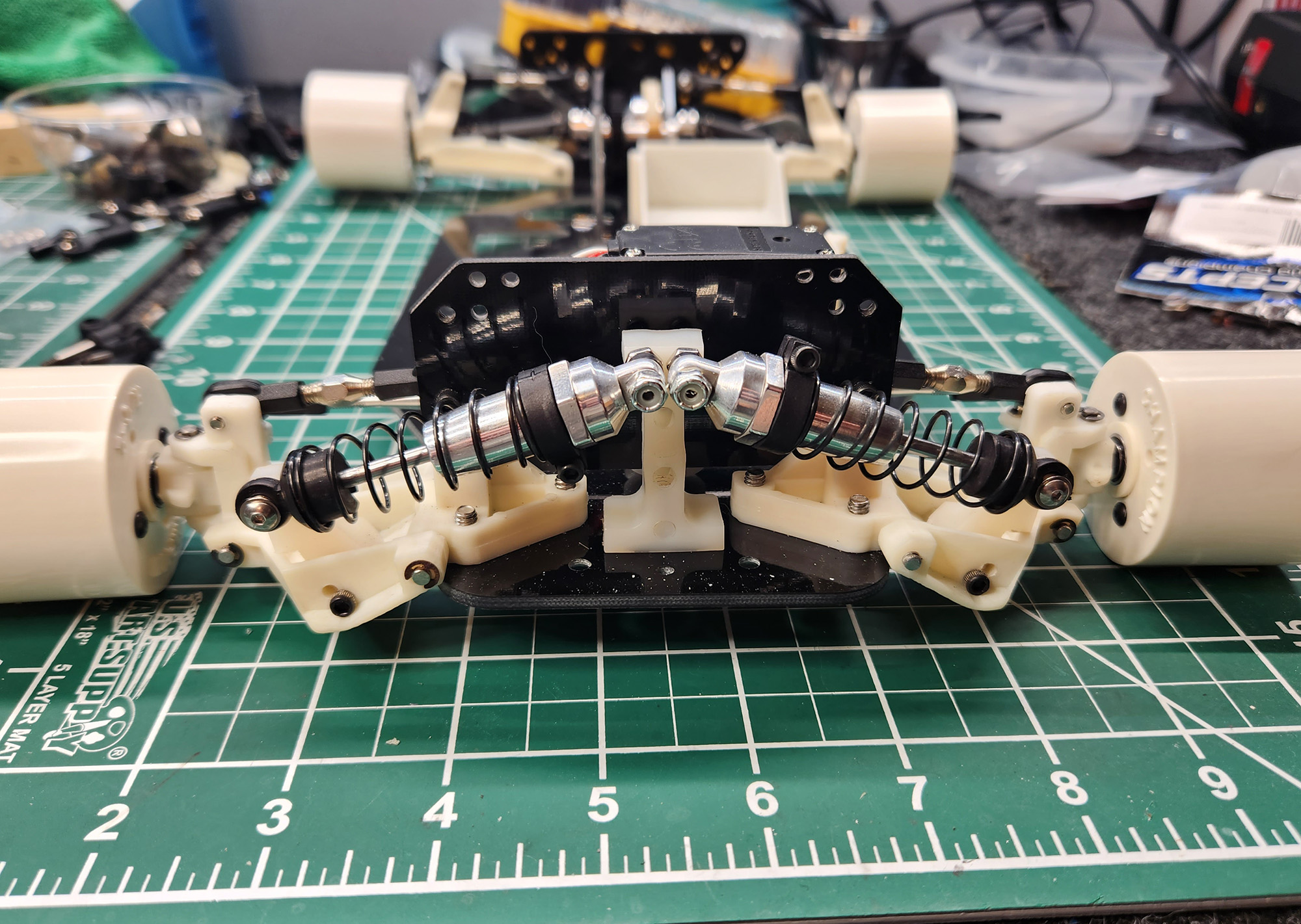

The front end is just about done with the addition of the McAllister lowering kit.
The rear end is waiting for the Badger rear shock tower to show up from FTW, and then final install can take place back there.
I know the whole thing looks almost comically wide at this point. But there is a reason for that season, as long as the body situation works outs.

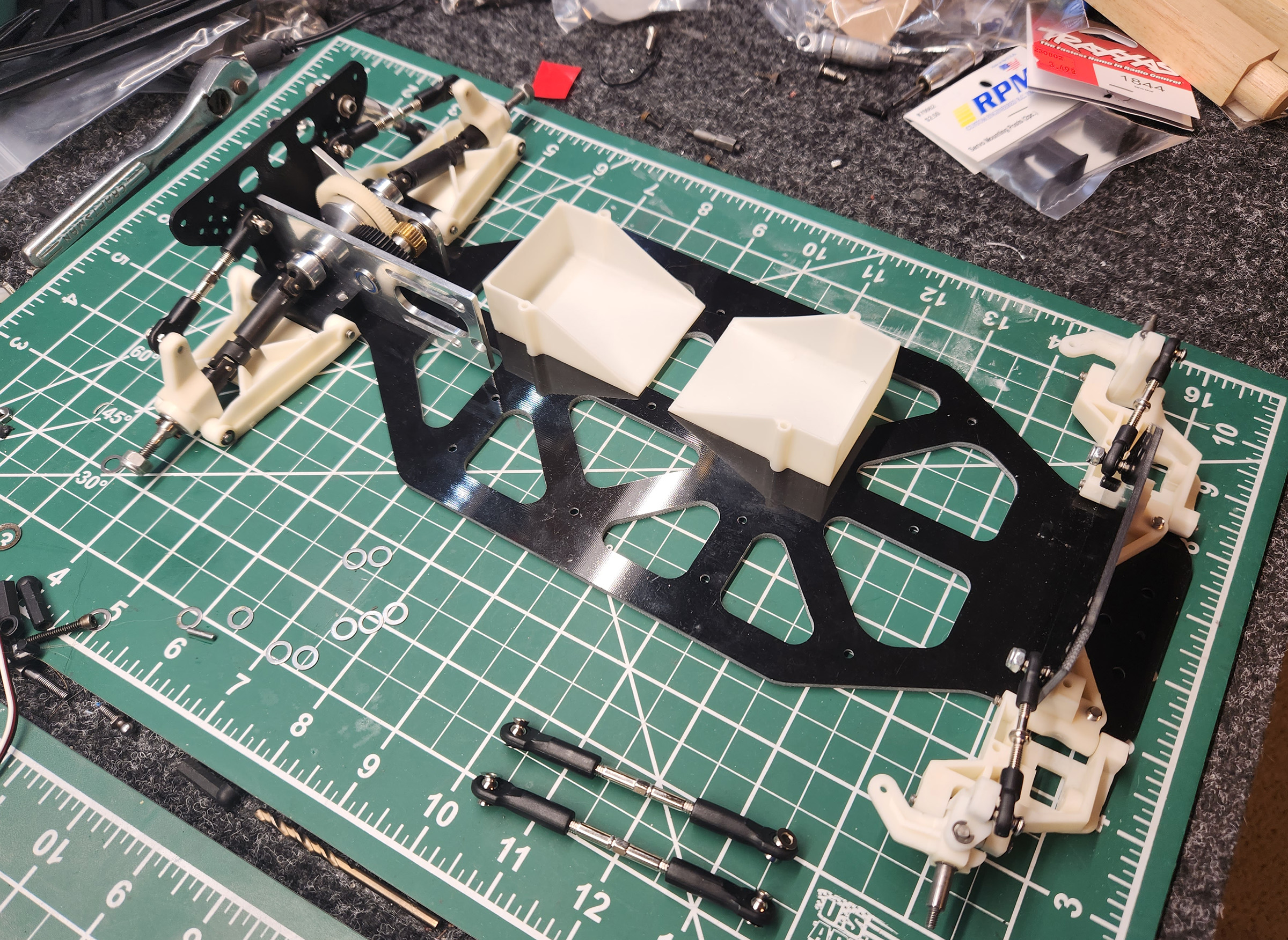

Chassis just about wrapped up. Just need to fab up rear body posts, and then on to the body. Wheel track is just about dead on!
