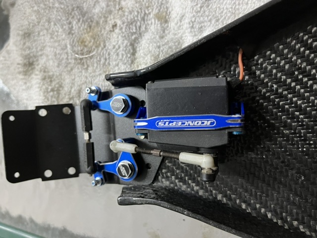

- Posts: 1874
- Has thanked: 1243 times
- Been thanked: 639 times
Re: RC10 DS steering wander - won't return to center, not trim issue
I'm not exactly sure what you are asking about, but here is a picture of the connection. You replace the servo saver with a plastic arm from the servo package. Does the picture help?tripedaler wrote: ↑Tue Aug 15, 2023 5:47 pmNice - I’ll try it. How did you get the upper arm connected t the servo shaft and the lower arm connected to t he bell crank fused? The V isn’t tight for me… Or if you just add washers to the nut ?
