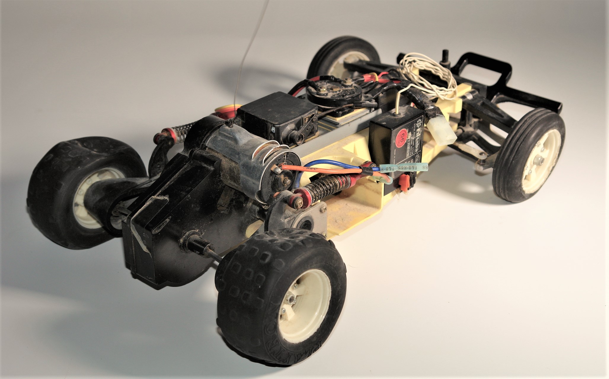

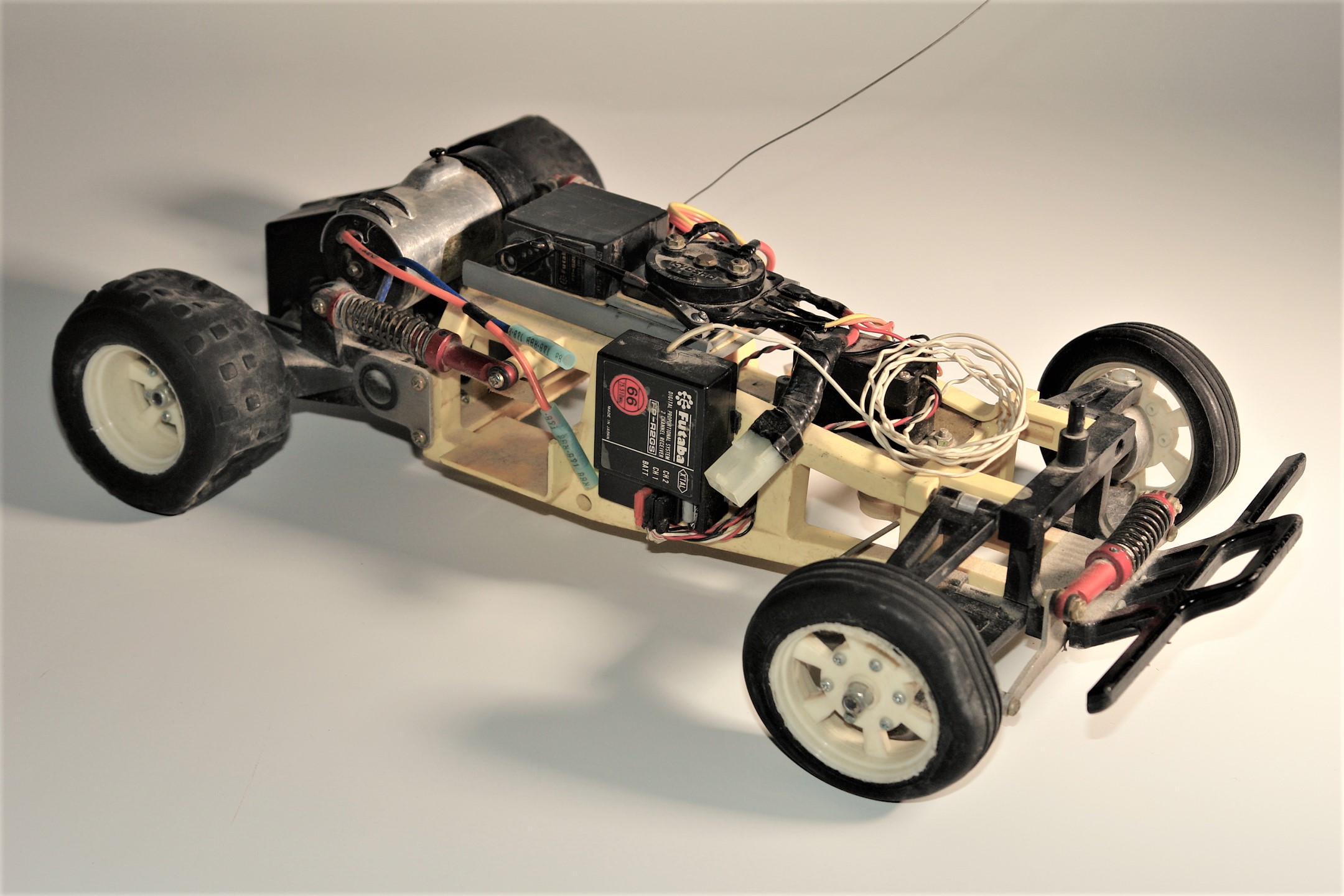

Picked up this Doberman a while ago.
No body, rock hard tires , quite a few scrapes and scratches and poorly repaired servo mounting tabs.
Chuck
Chuck

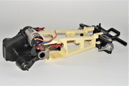

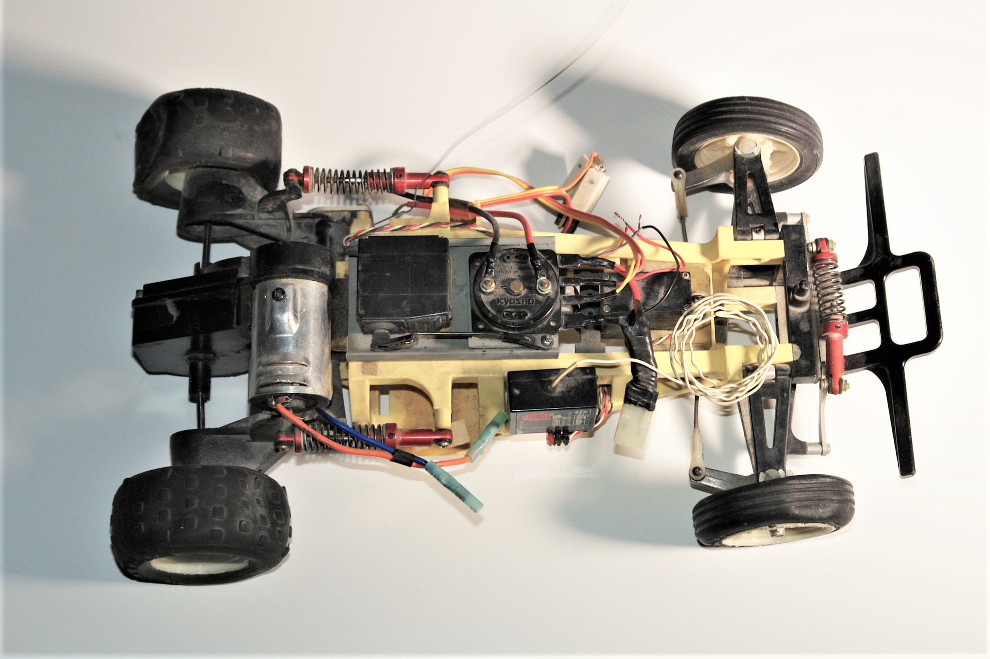

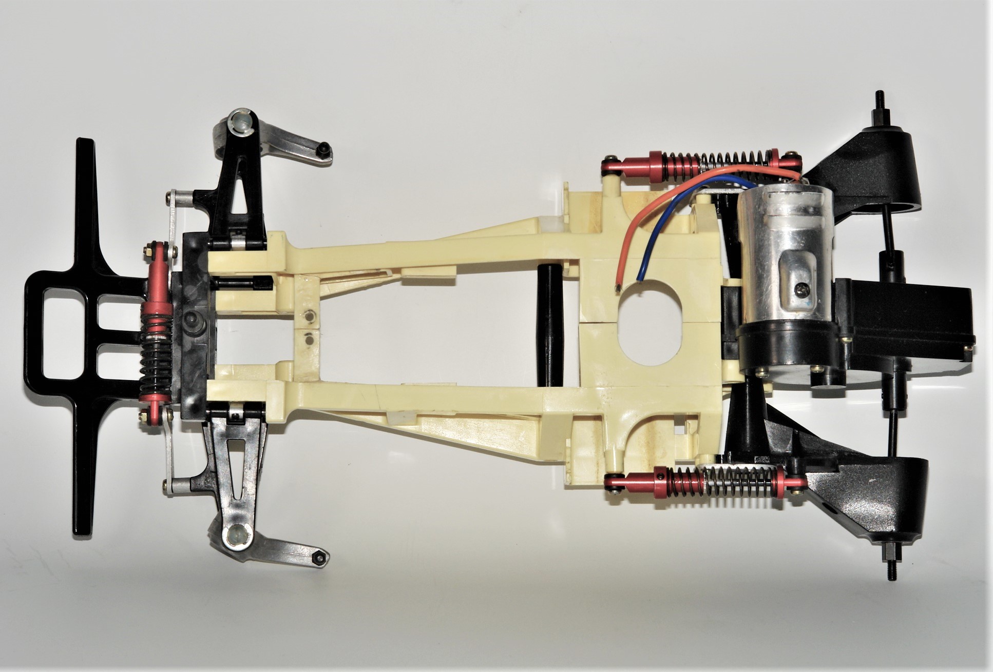

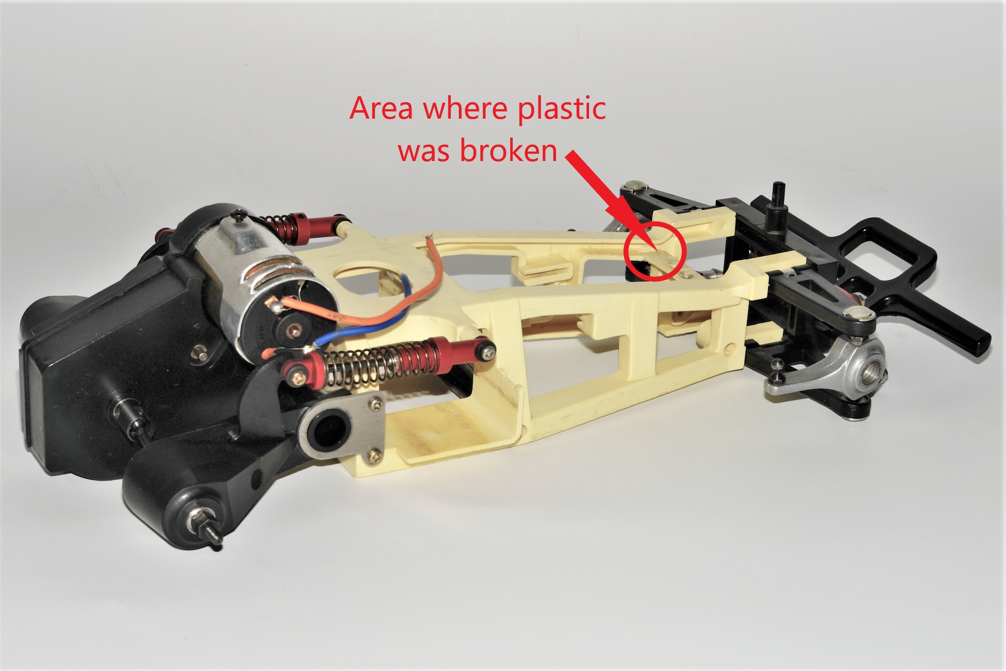

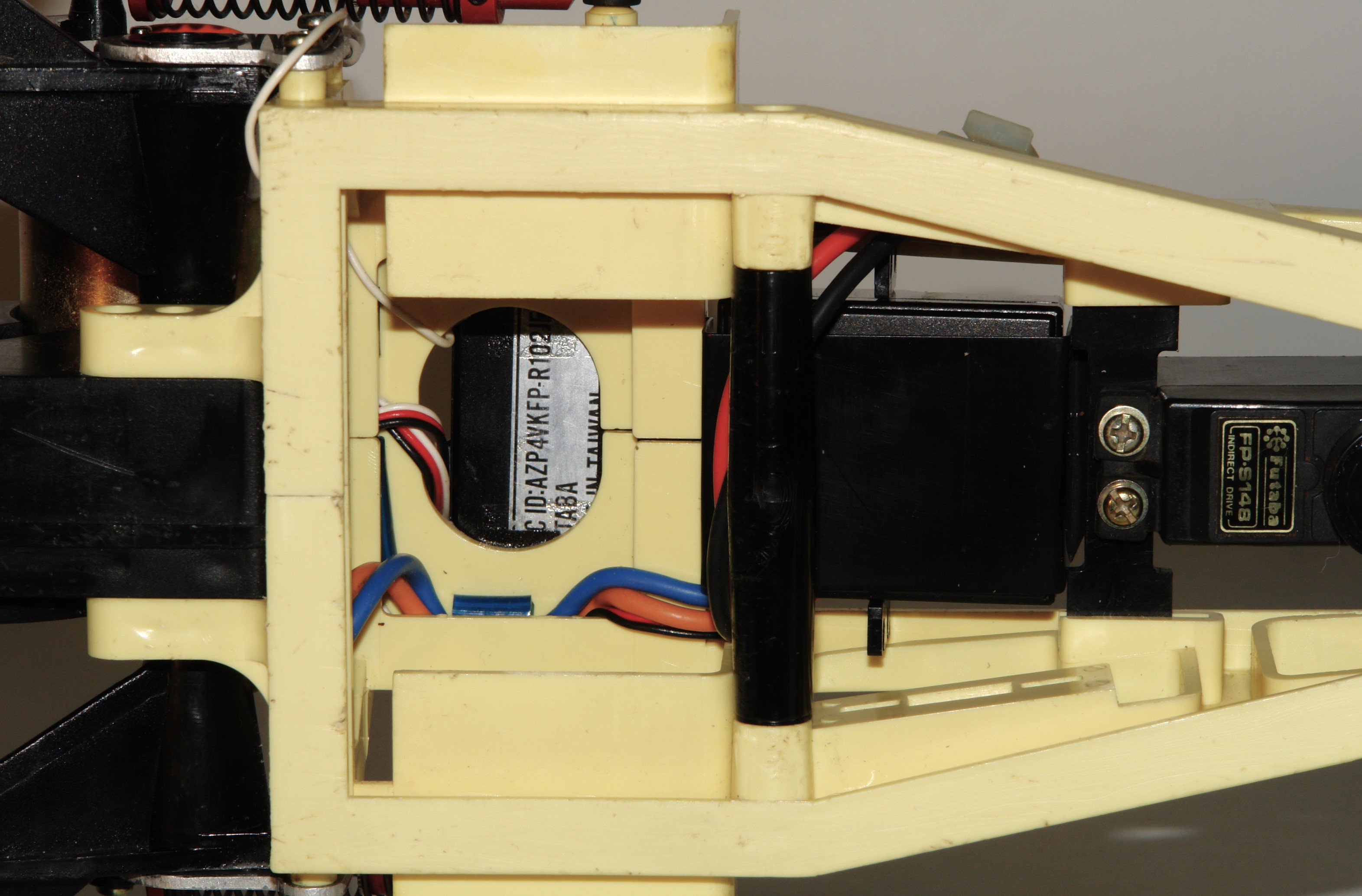

Reassembled after a thorough cleaning.
Repaired broken servo mounts from underside with small strips of lexan and CA.
The mounts were probable broken because a previous owner had frozen the broken servo saver with CA.
Could still need a bit more clean up on the belly and battery area.
Chuck
Chuck

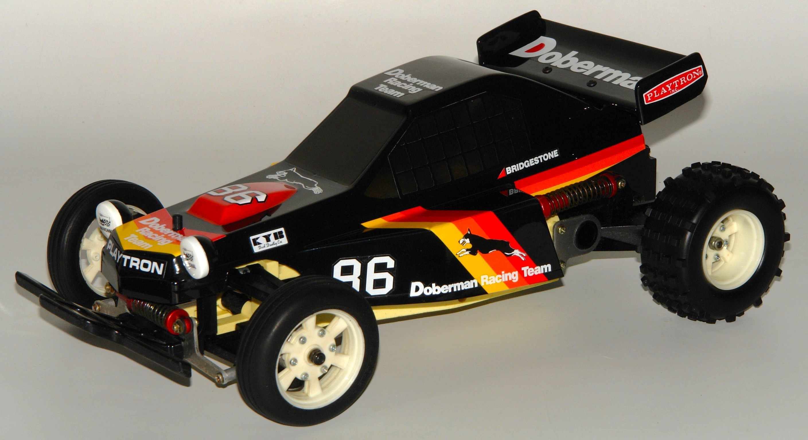

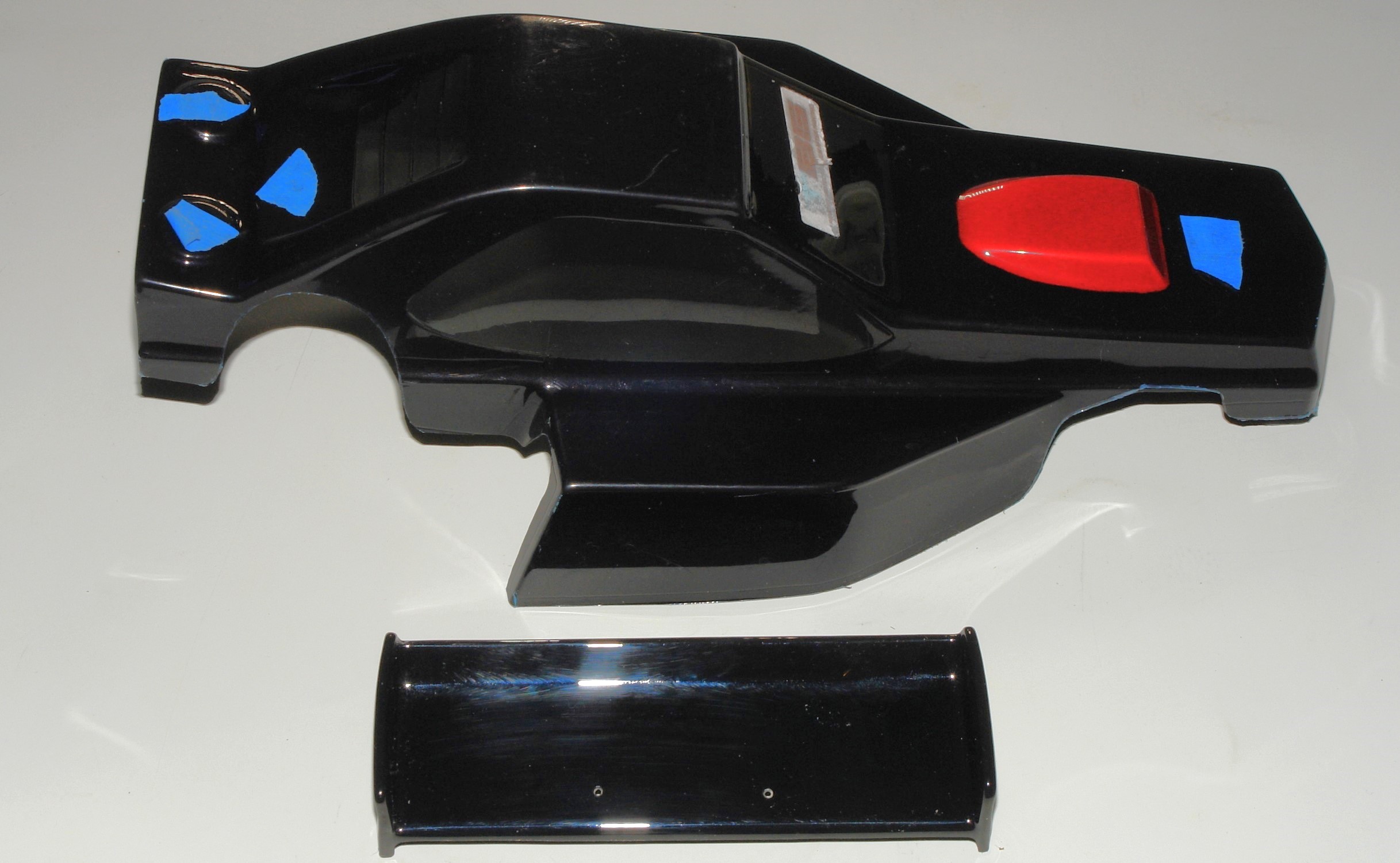

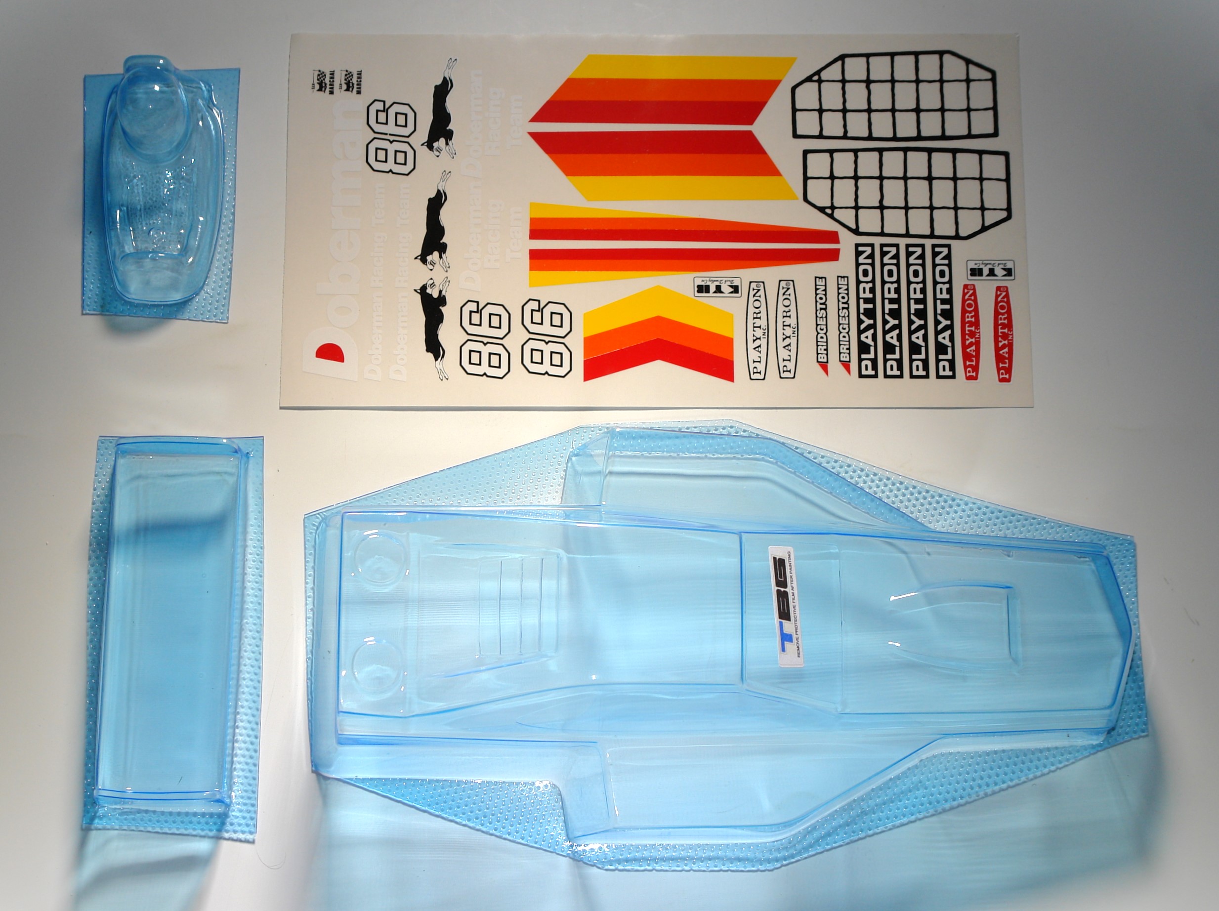

Originally the car came without a body.
Ordered and received a body and decals.
Chuck
Chuck

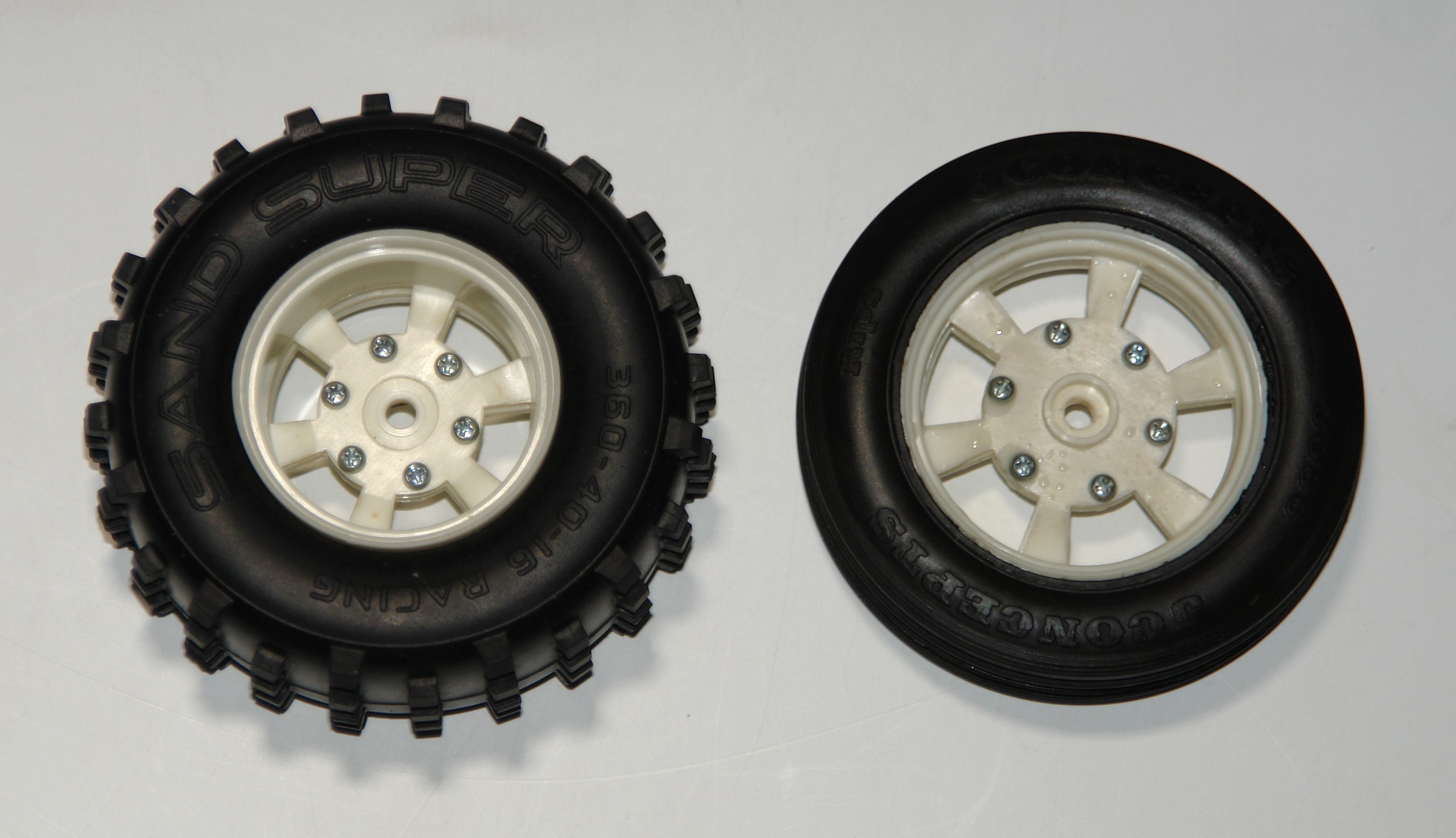

I mocked up some tires to kind of simulate to original tires.
Finding decent original tires is probably out of the question.
All the tires on the playtrons I've seen seem to suffer the same hardened and flat spotted failure my tires showed.
I had to glue the fronts just like the original tires I removed from the car.
Probably going to run the raised lettering on the inside of the rears.
Chuck
Chuck

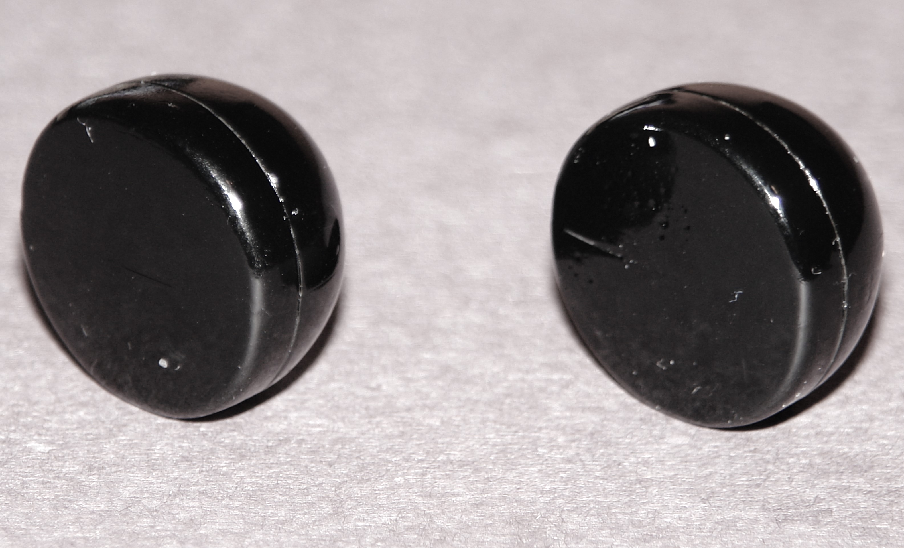

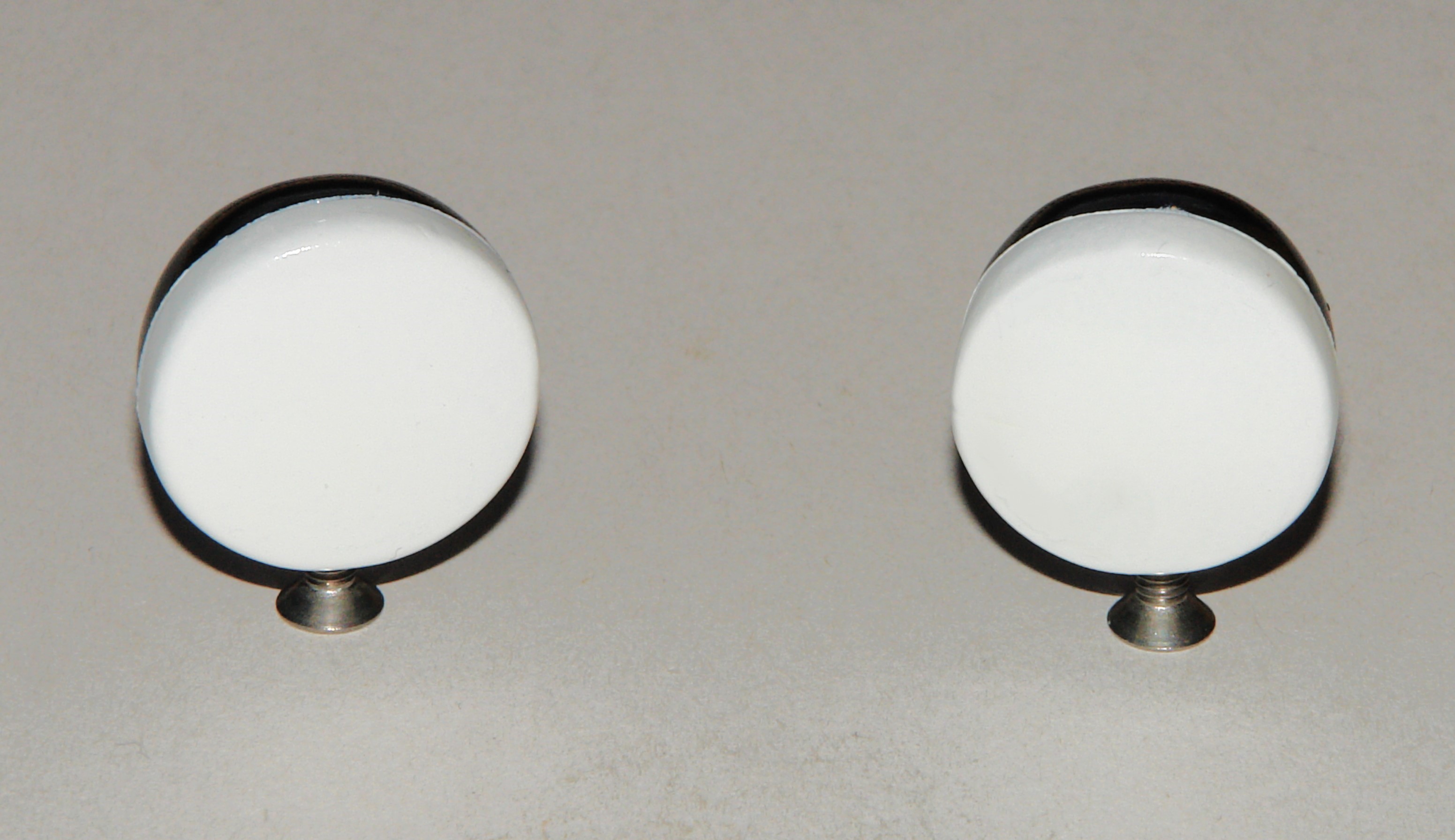

Got a little bit of painting done.

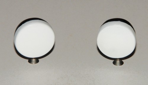

Did not know what these lights were for until I looked at a picture of the original box online.
A bit more cleaning, new servo saver and trying to resurrect the original front tires.

All the decals placed.
Still no esc or receiver but looking pretty good.

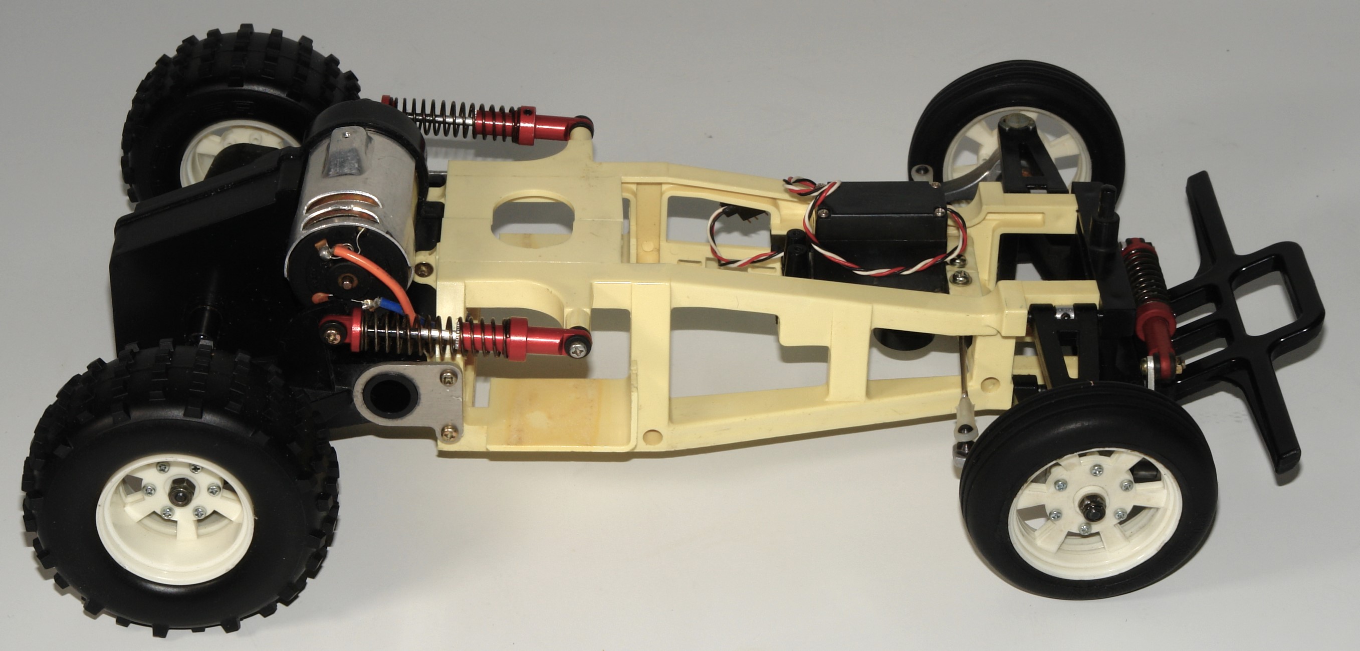

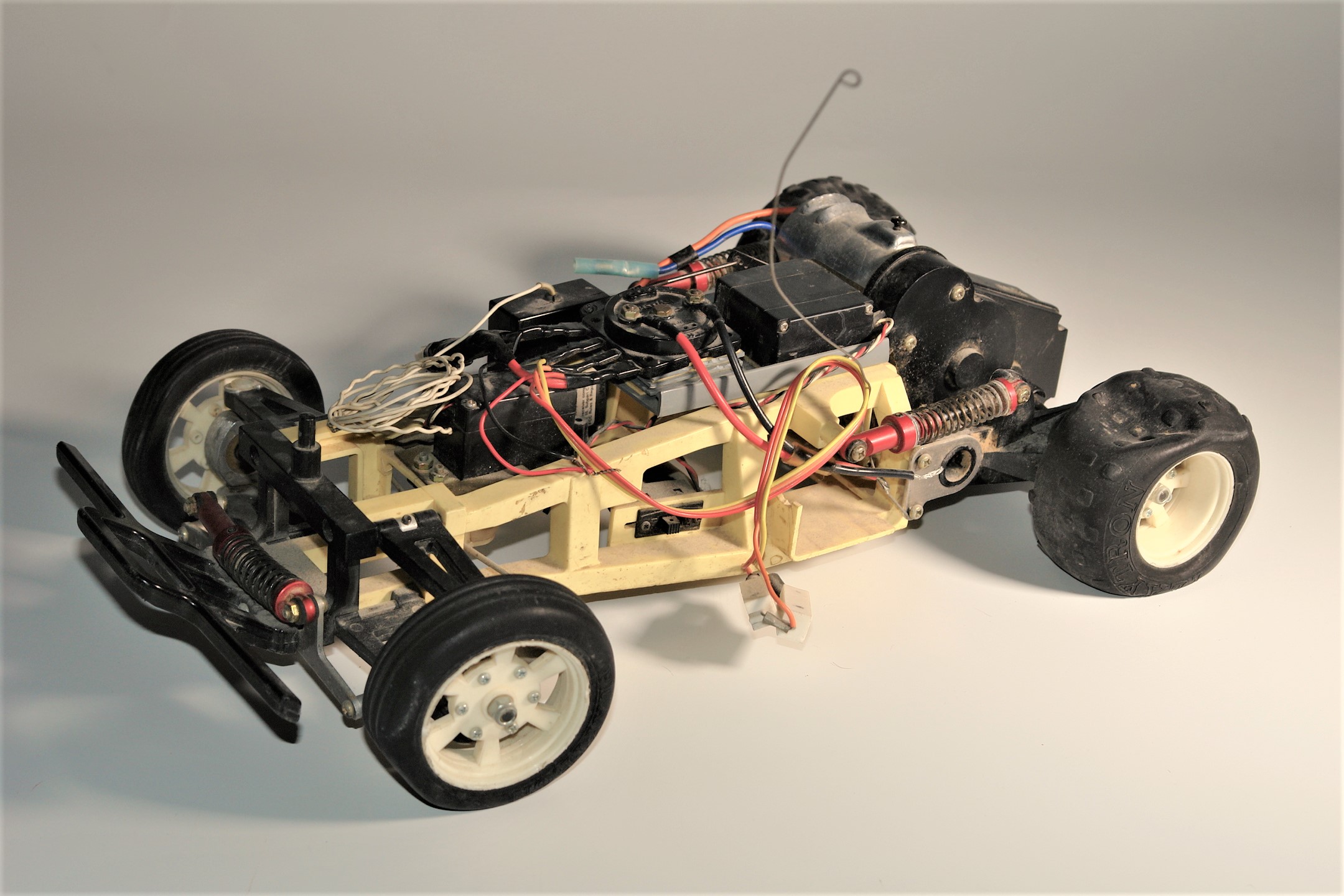

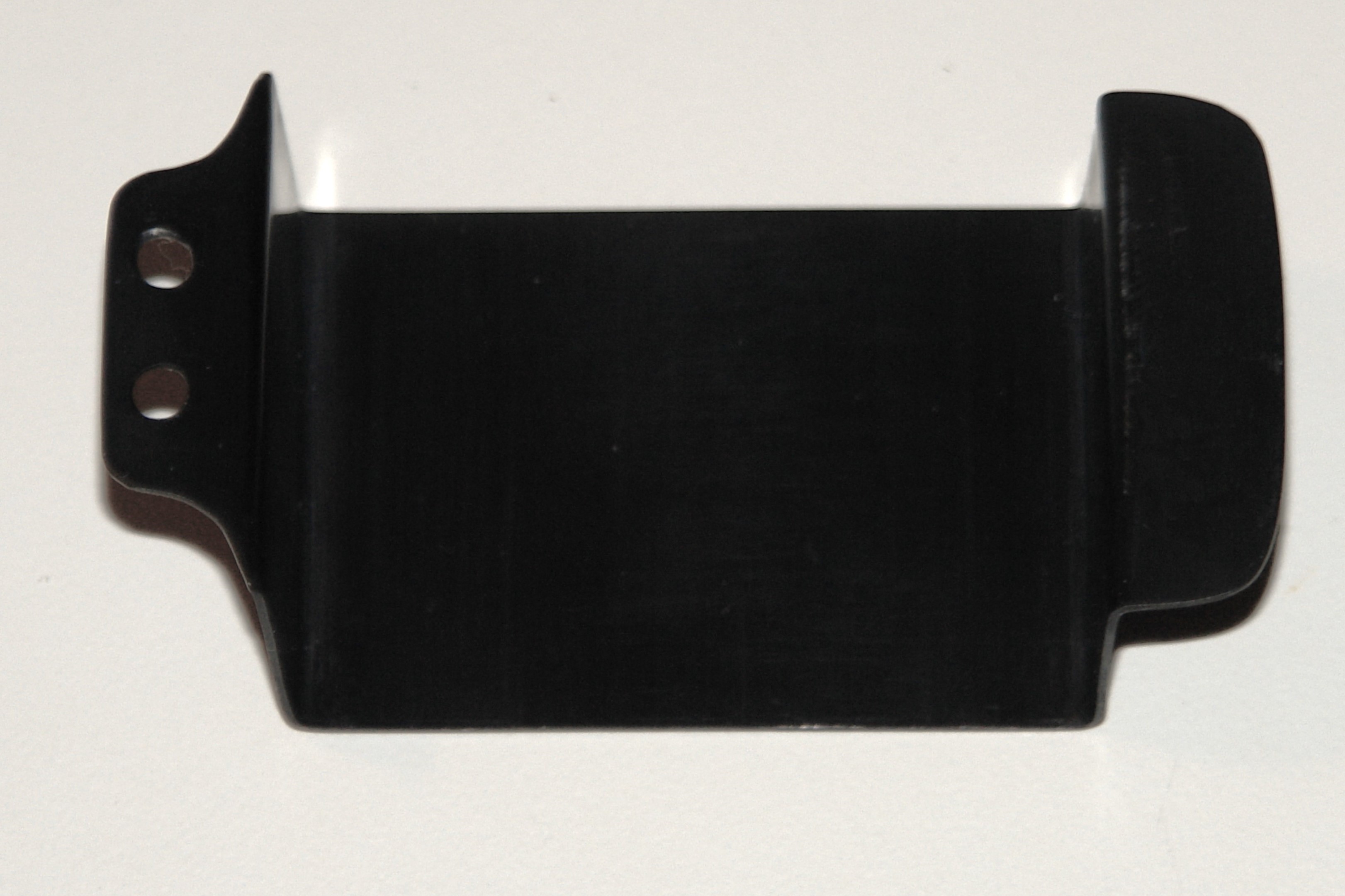

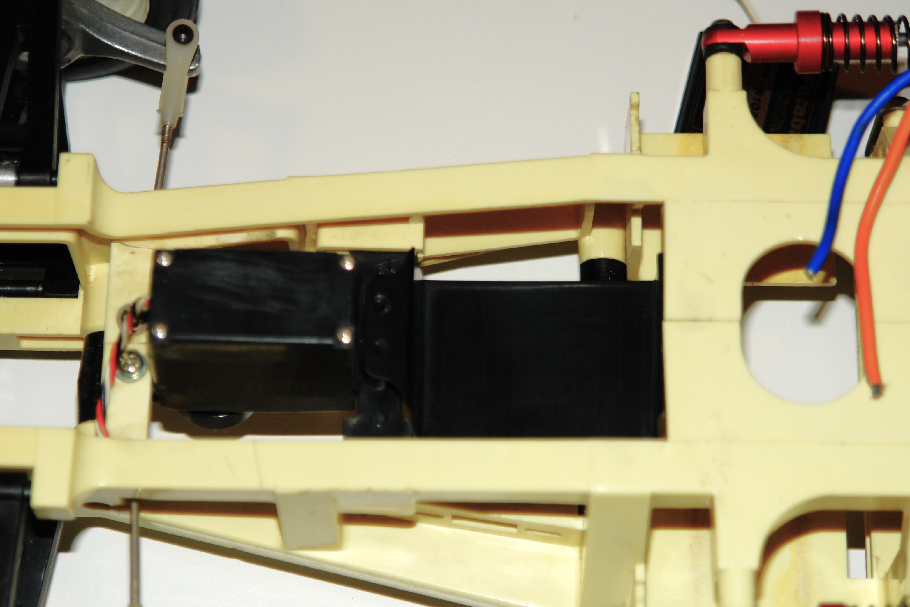

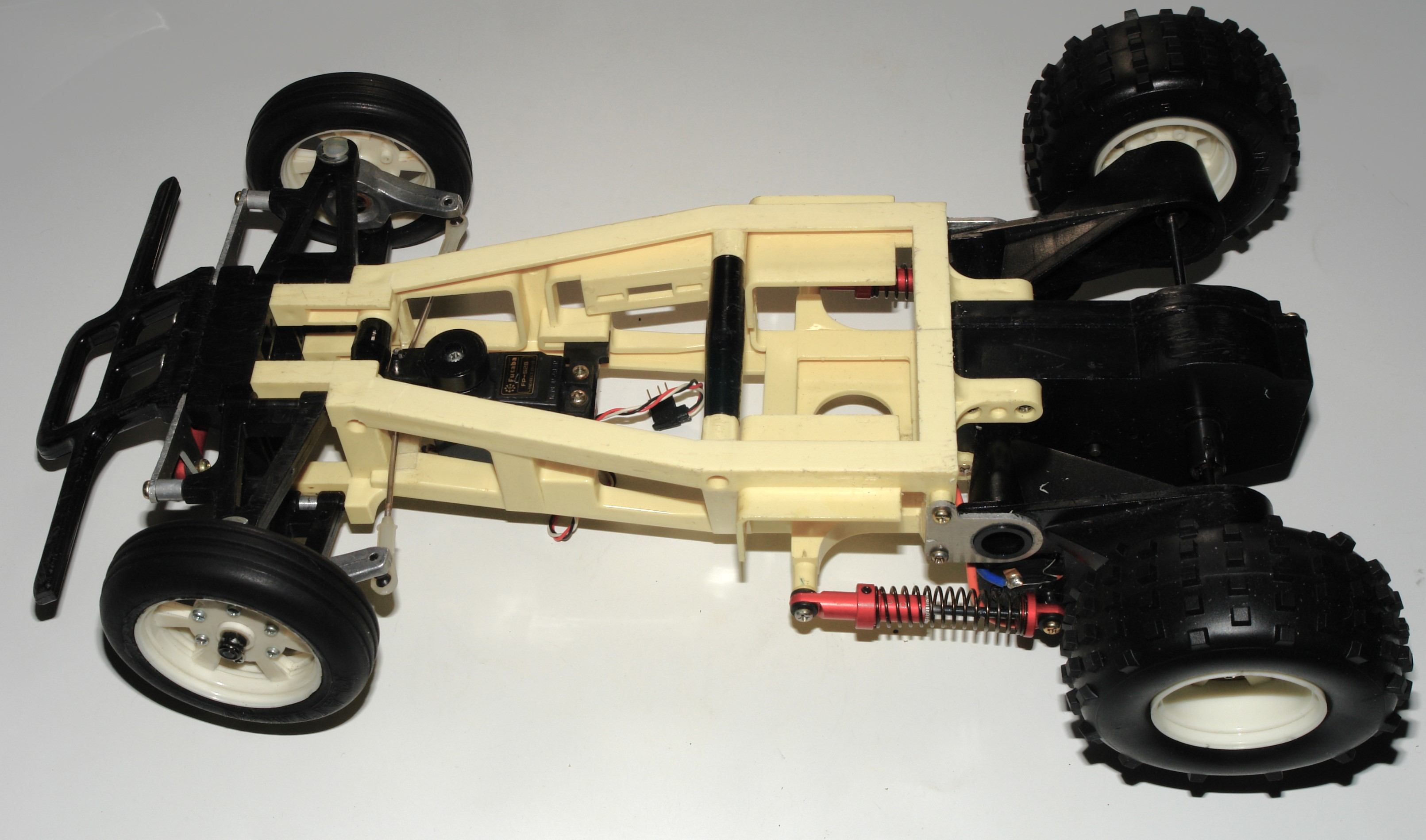

Made a mount for the ESC.
Also helps to secure the servo a little.
Chuck
Chuck

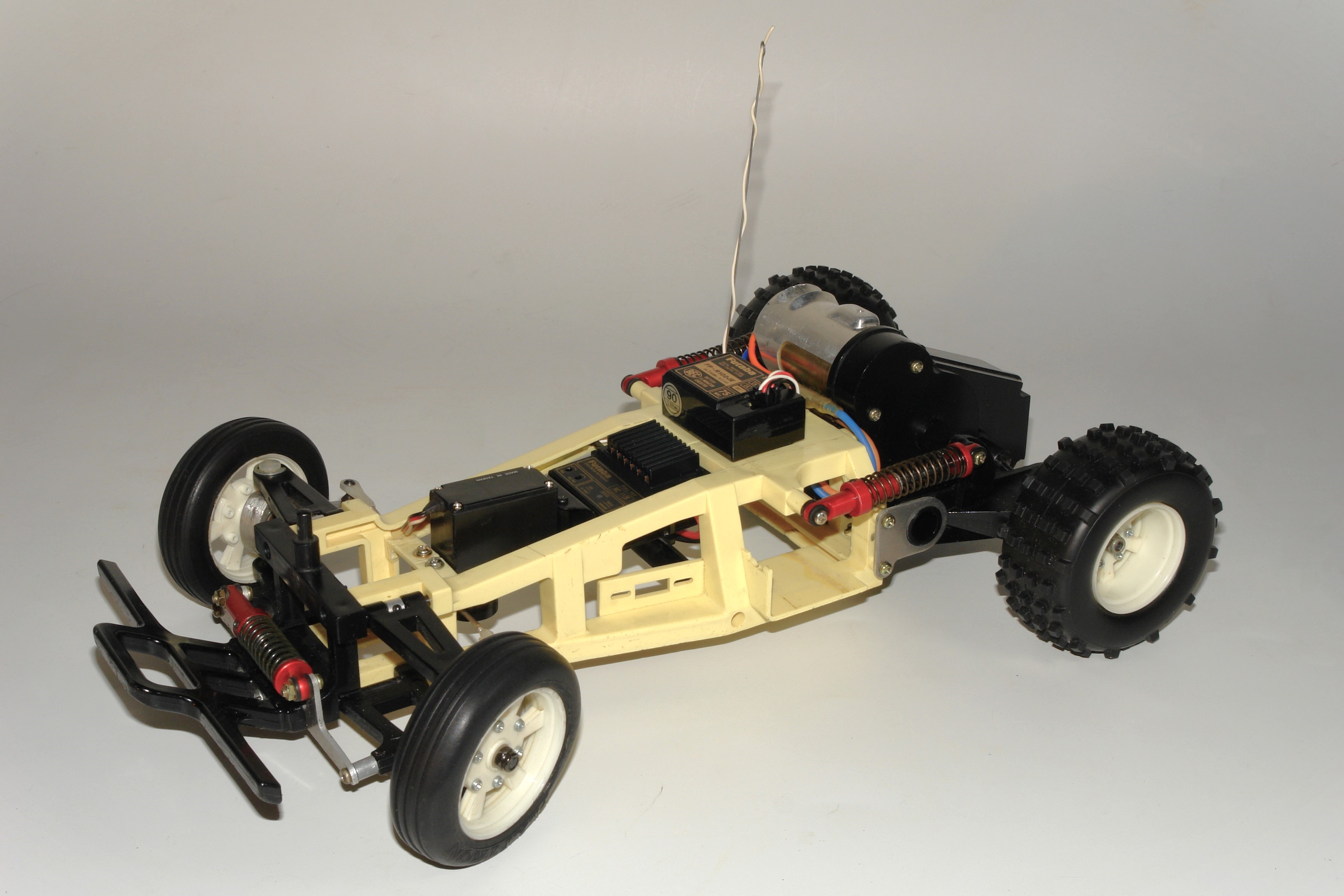

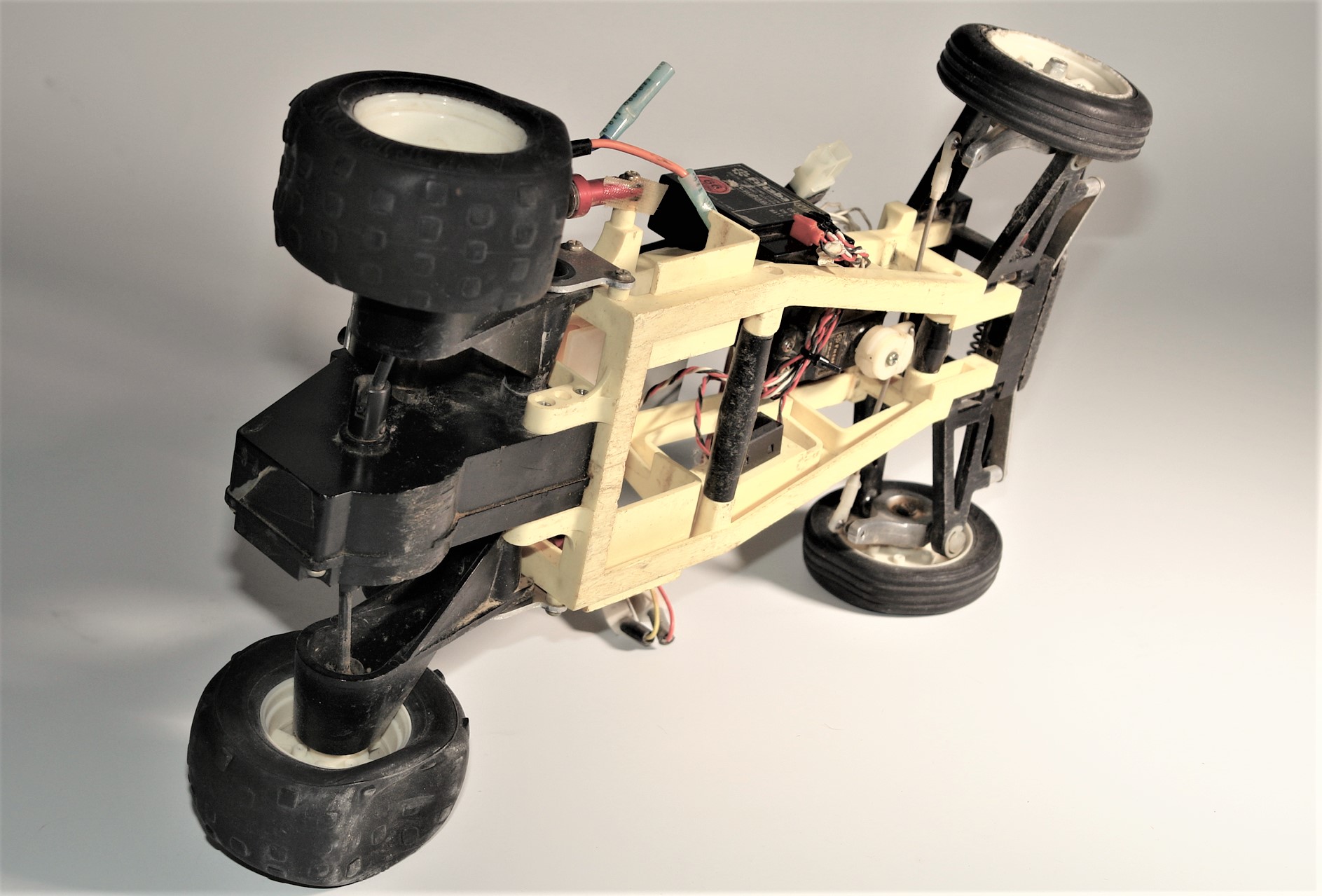

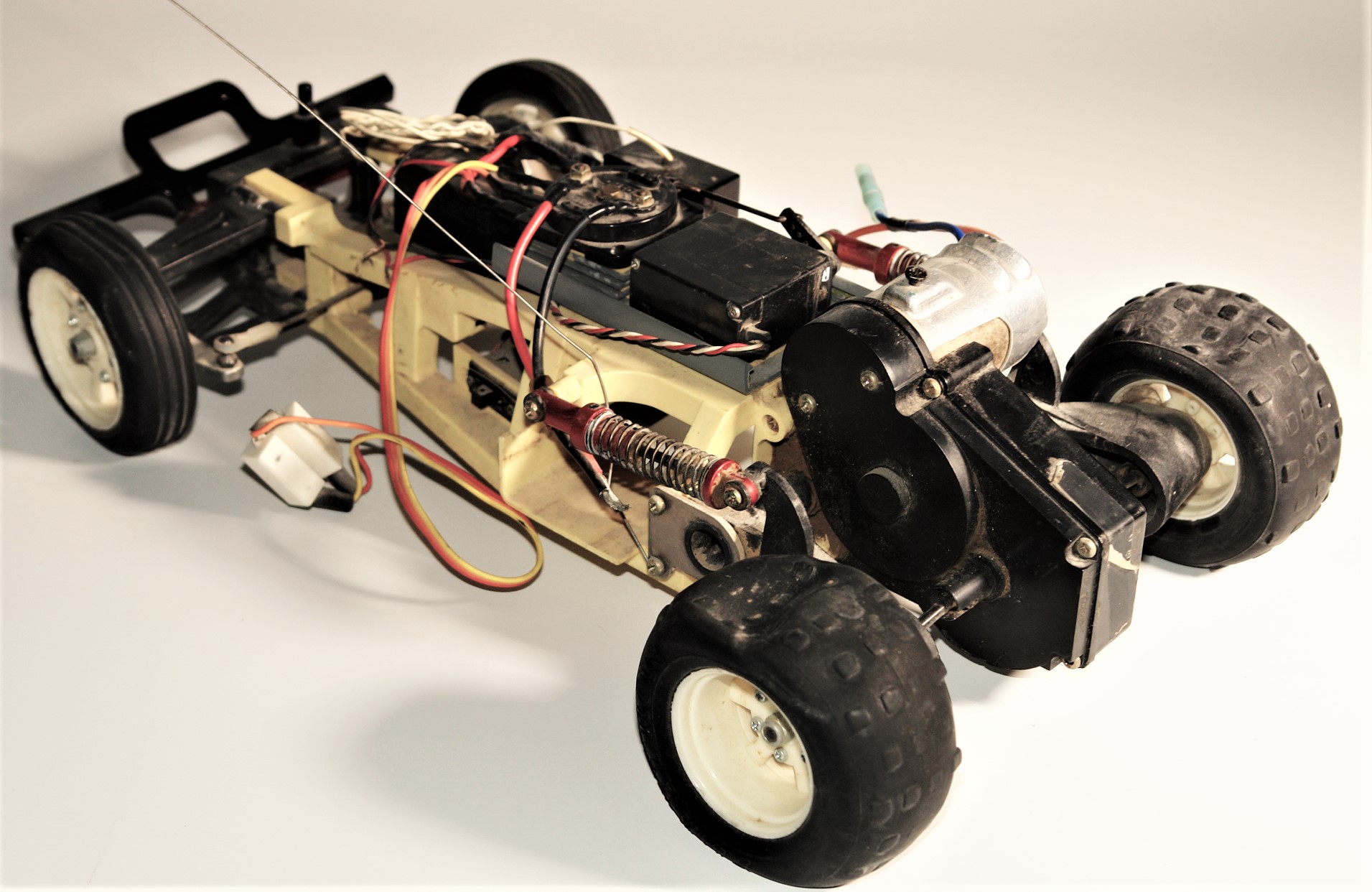

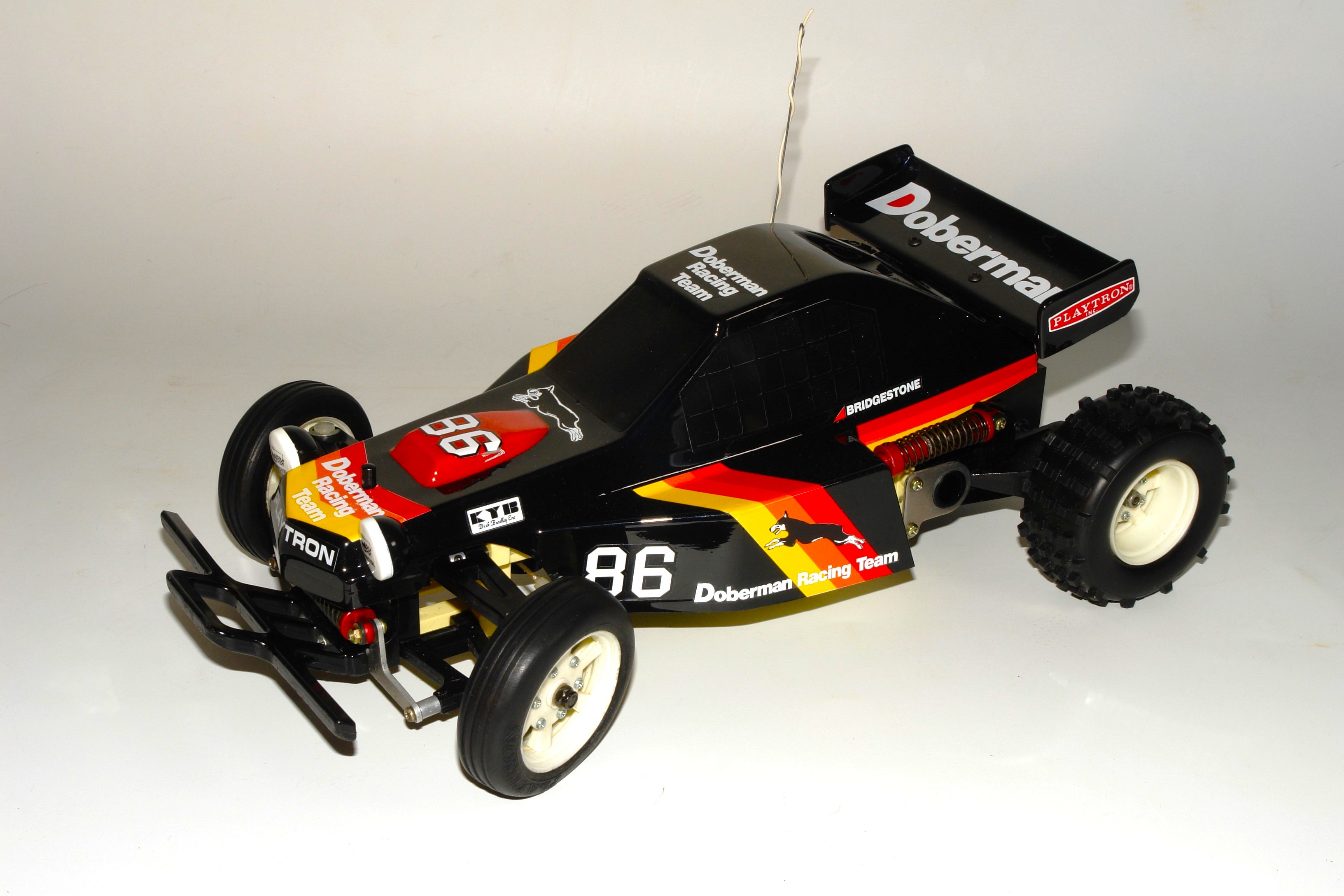

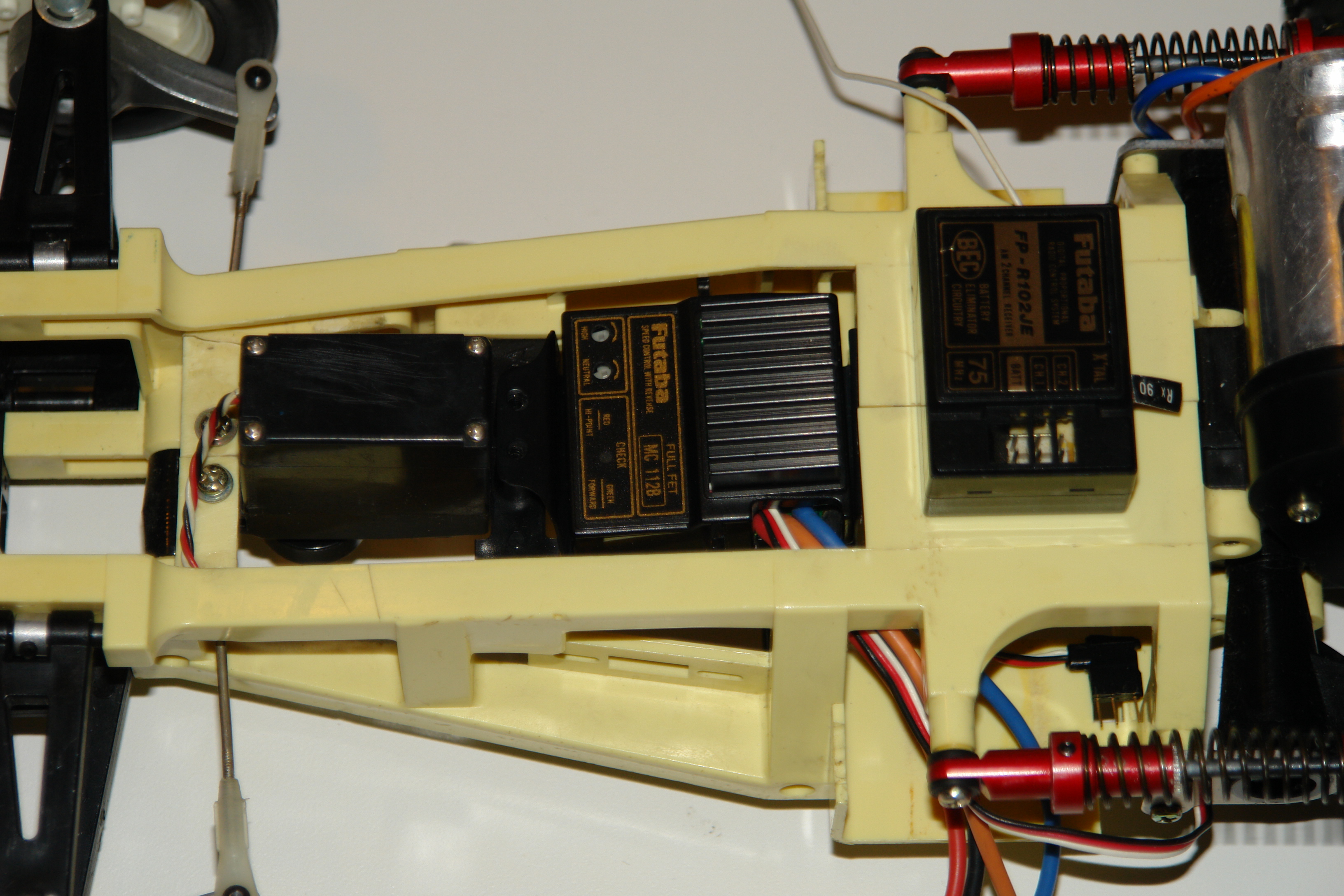

Finished a few of the last tasks on the Doberman.
Esc wired
Changed servo for one with longer lead wiring
Tidied all the wiring
Mounted antenna.

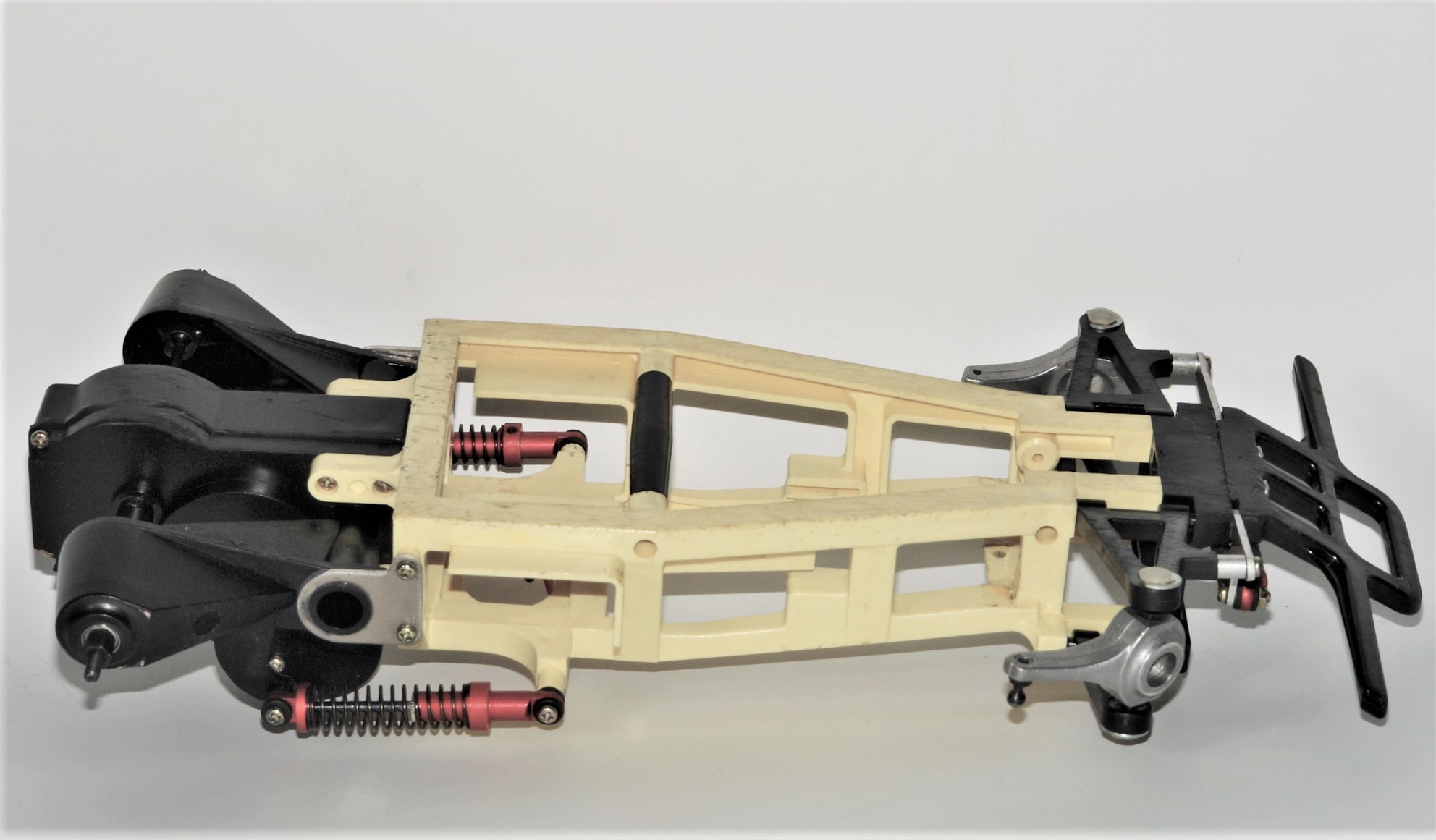

A view from the underside.
Wires tucked in the "C' channel of the frame and held in place with small sections of silicone hose.
All wiring easily clears the battery area.
As few wires as possible exposed.
Ready for the shelf
Chuck
Esc wired
Mounted antenna.
Ready for the shelf
Chuck
