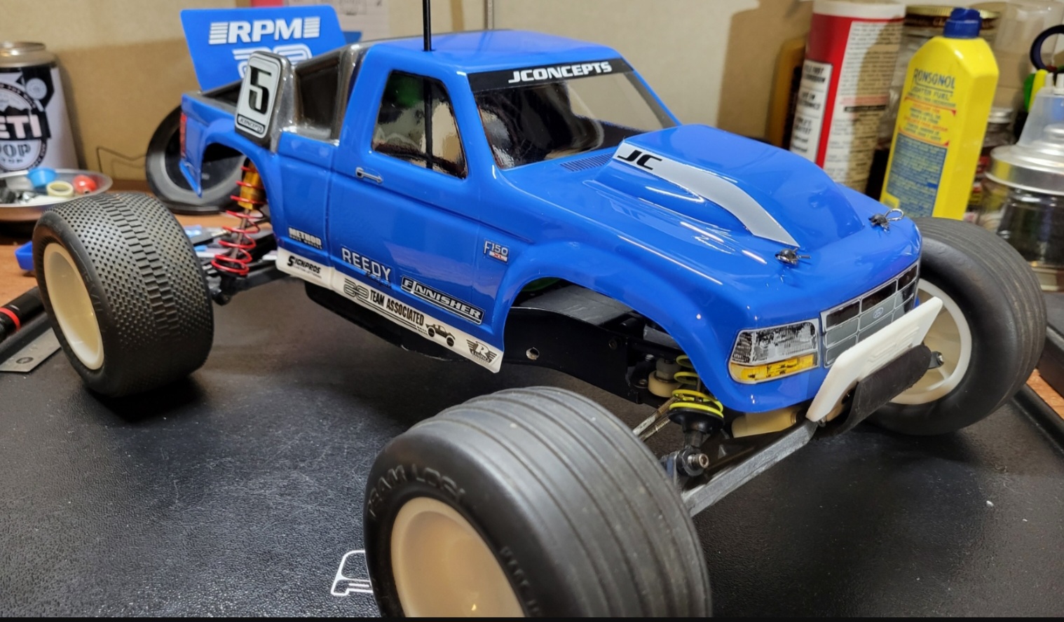

Re: Can a single tamiya spray paint cover the whole body?
Buggies shouldn't be a problem, but you will likely need a backing color.
All of the blue on this truck was a single Tamiya can, but it was backed in another color.
