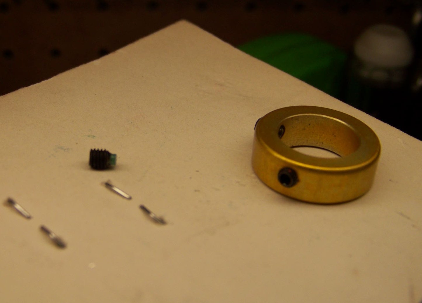

Dug this thread to thank Giles, and I found something really cool to add to it:
These set screws have soft tips, and they actually grip really well. For my old builds that use the aluminum collars on anodized shocks, these are perfect for eliminating those little zits all over your vintage shocks (the ones that sit on the shelf and are supposed to look pretty).
http://www.mcmaster.com/#catalog/118/3084/=hlufa2
The M-3 fits my CRP collars : 94095A020 Metric Nylon Tip Alloy Steel Socket Set Screw, packs of 5
$7.44 for a pack of 5 ain't cheep, but neither are vintage shocks.
