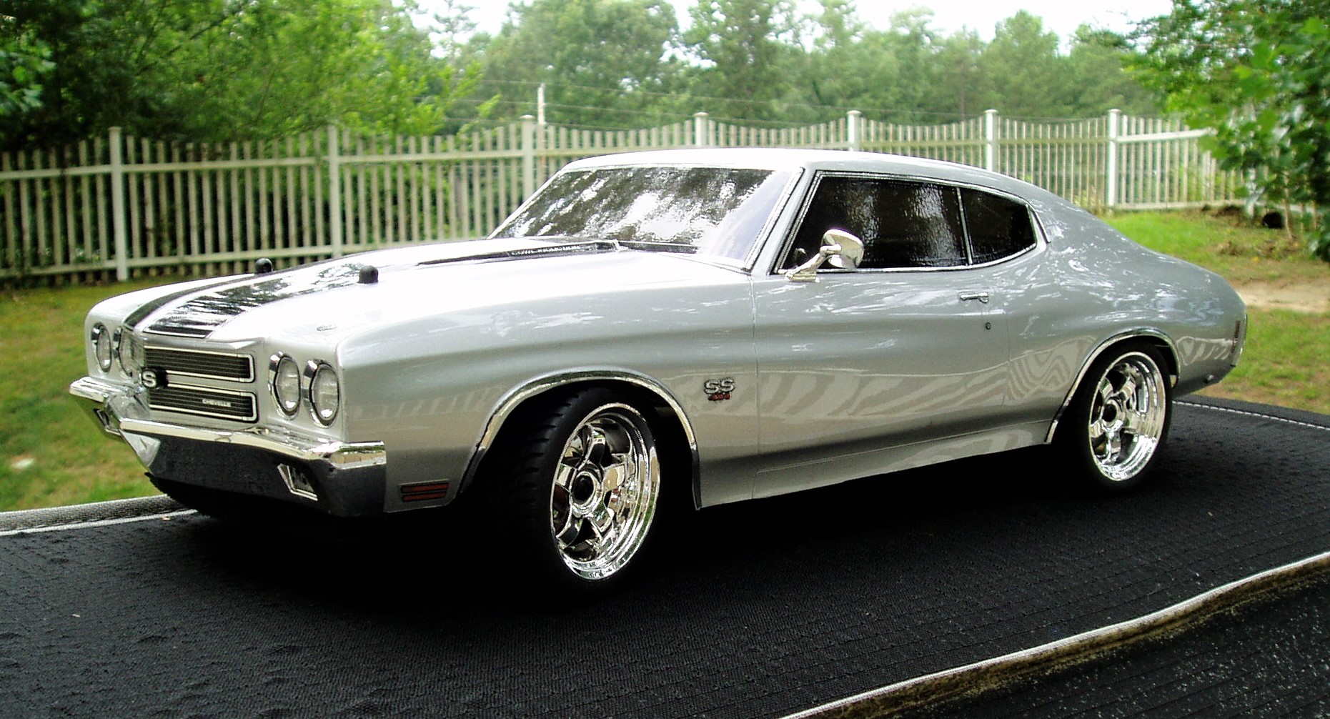

FWIW, here's what I'm rocking:
Shelf duty
wheels: Apex RC https://www.ebay.com/itm/221524930854 ('cause I'm an old guy who still prefers chrome wheels )
tires: https://www.ebay.com/itm/RC-T6085-Grip-Tires-Insert-sponge-4PCS-For-HSP-HPI-1-10-On-Road-Speed-Car/324198892163?hash=item4b7bc28283:g:aMoAAOSwPNBdAxB8
Track days
wheels: Kyosho Hellcat https://www.kyoshoamerica.com/FAH701BK-Wheel-FZ02-Mesh-7Black-2pcs_p_25693.html
tires: Nitro Hobbies V-Grip https://nitrohobbies.com/nhxt1205/

Thanks, I really like the chrome wheels as well.Coelacanth wrote: ↑Wed Jun 24, 2020 11:07 am Those look good, Doug, I also dig a little chrome. The first set of wheels fit your body quite nicely and look great.
When I look at those Kyosho muscle car models, the stock wheels and tires all look too skinny to my liking. When I see those chassis' with no body mounted, the rears especially don't look right to me. I suppose that look is close to how the cars looked when they rolled off the production line, with the more mainstream performance options (i.e. not the Hemi R/T's, 440 6-Packs, 396 SS's, etc.), but I just feel the wheels & tires should be wider.
I want to be careful here as I don't want to hijack this thread and steer it off-topic. Maybe this is a good place to discuss availability of wheels and tires for these cars -- or maybe not. LoboNYC, please tell us to to take this discussion elsewhere and we will. No worries, I promise!
