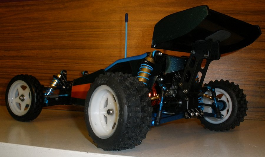

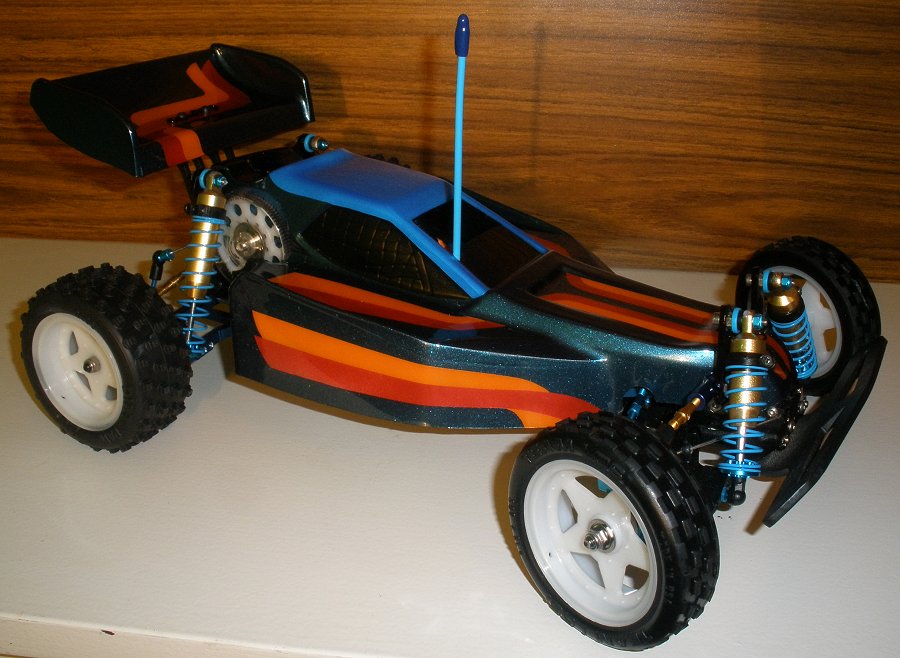

After receiving some Tamiya adapters, I was able to mount a set of new Proline wheels that'll be perfect for a runner (thanks, Don!). I can't quite call this project finished until jwscab is able to do some custom machining on a few sets of rear aluminum wheels I was eyeing for this car from the very beginning. I'll save the money shots for when those wheels are finished. 8)

j0pp3 wrote:Wow! Creative solutions as always, Coelacanth. Your builds are always inspiring. For a 2WD it looks like a heavy tank. It would completely mangle any other 2WD in a battle 8)
I just thought I'd update this, as I've weighed the car, with body & wing painted & mounted, electronics installed, with the Proline nylon wheels & tires shown...without battery, it weighs 1326 grams. And that includes running 8 bearings (instead of 4) in the front hubs & axles to be able to mount either 12mm hex or wheels with bearings inside them as the need arises. I'm not sure if that's considered heavy for a RWD offroad buggy. Anybody have similar cars (offroad RWD) lying around for comparison?

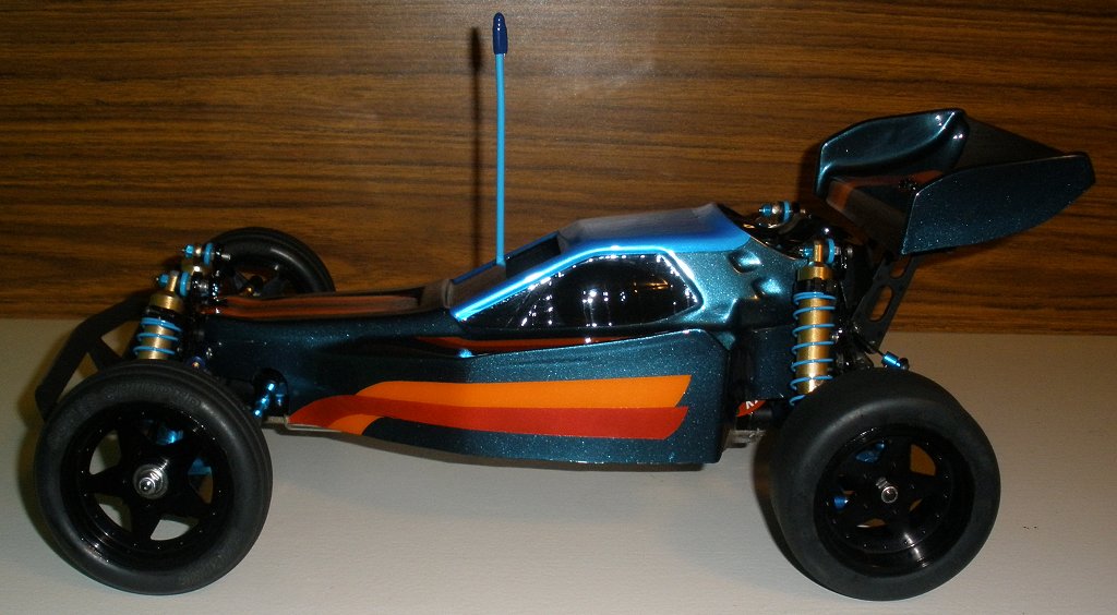

Just a minor update: Dyed a second set of Prolines and cemented on some tires better-suited for on-road driving. Now I think it's ready for it's maiden road-test. 8)

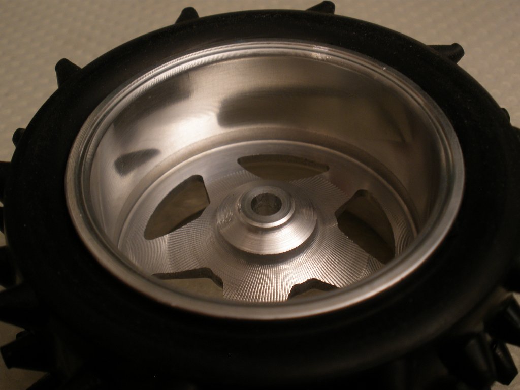

Update: Wheels custom-machined & mounted
Post by Coelacanth »
Before I began this project, I had a set of wheels that I envisioned mounting on one of my cars. The problem was, the wheels were from the 80's and had the annoying taper-fit hubs that would only fit on 80's-era Kyosho tapered axles. Since I've modernized all of my Optimas except for the Zebra gold chassis car, these wheels wouldn't fit onto the modern 5mm straight axles with either crosspins & hexes or slots. The wheels were just collecting dust and seemed like a lost cause until I started doing some careful measurements and got some ideas. I ran the ideas by jwscab, who has machined some spacers and such for me in the past, and shipped him the wheels after sending him some pictures, diagrams & we came up with an idea that worked.
Joe machined off the inner cone-shaped section of the wheels so that the inners would be flat, then machined crosspin slots into the flats. He did this after confirming some careful measurements of backspacing and decided to drill out the wheel axle holes to 5mm.
After having these wheels for a year or two now and not being able to use them, with Joe's machine work, I am now able to mount them on OptiMutt and the car I envisioned a long time ago is just about finished!
I'd like to also thank RedScampi, who sold me the matching front wheels...he had a set of the fronts, I had a set of the rears, and neither of us could do anything with them, so I eventually made a trade offer for some stuff he needed, and was able to finally make a matching set.
