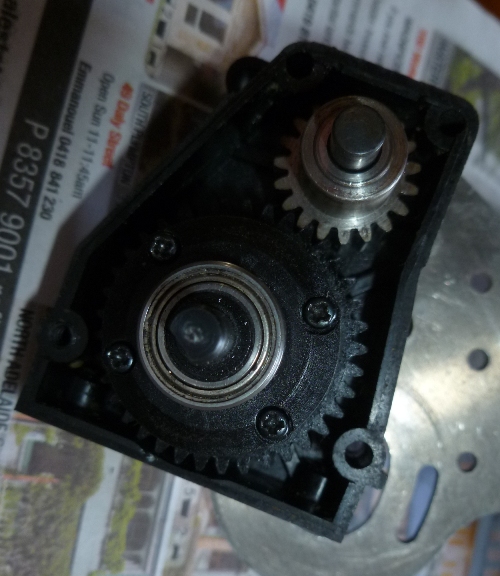

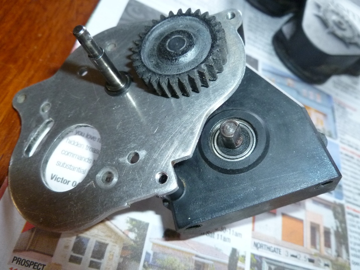

Rebuilding my Ultima, which has previously been identified on here as having a Pro XL chassis... however I popped the gearbox open, and found a number of interesting things.....
- The final pinion is alloy, which I believe is a Pro item...
- The counter gear is press-fit on the counter gear shaft, rather than the usual pin locating method, and
- The other end of the counter gear shaft does not have a notch for the E-ring, like every other Ultima I've seen.
Some pictures..... Left Side: Right Side: So, the question is..... is this an Ultima that I can't find a manual for (Ultima Pro XL maybe?), or is it an aftermarket part???
Would really appreciate any input....

Looks like an optima top shaft, lacking the needed e clip groove. Optima bearing installs from inside not outside like ultima

Well, that is interesting..... not quite what I wanted to see I guess, if it is in fact only an Optima part.....
Might have to just build it and see what happens....

You won't have anything to keep the bearing in
otherwise it would be fine
Not that it really matters but your lacking the ball diff as well. The gear diffs are tough so I'd leave it anyway but it does take away from the "pro"ness

The layshaft is an early version. Originally they were co-molded, later the gear became removable. -j
