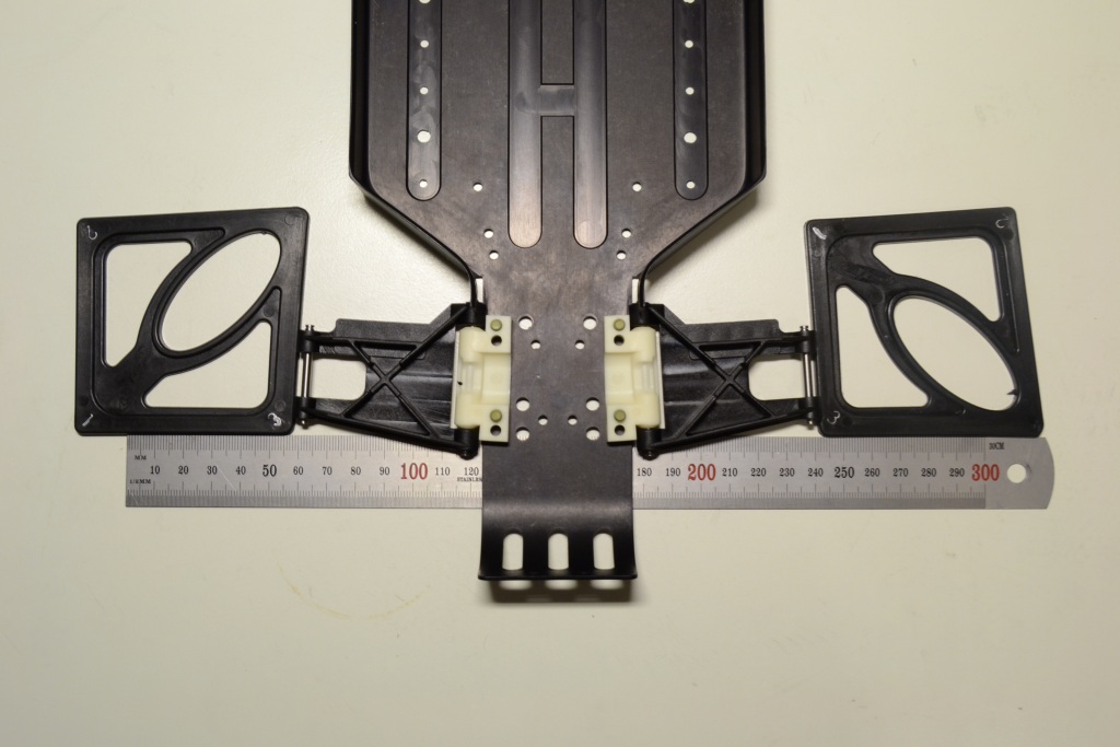

- Niki
- Posts: 524
- Location: Finland
- Has thanked: 3 times
- Been thanked: 45 times
Re: 3 versions of the 3 degree arm mounts?
This is how my #6002 kit looks like... 3 degrees both sides !
- Posts: 16816
- Has thanked: 36 times
- Been thanked: 1318 times
If you move the mounts to the swb position do you get less? Visually, they look like they'd be less using those holes.
The old andy's mounts looked like that too, but I never checked them.
- Niki
- Posts: 524
- Location: Finland
Mounts just move forward - no angle change. Still 3 degrees both sides.
- Phin
- Posts: 2818
- Location: NY²
- Has thanked: 87 times
- Been thanked: 248 times
Screw an original arm mount on top of a re-re and insert some hinge pins. Might need a couple of washers in between to space them out. That will clearly show if there's a difference in the toe angles between the old and new mounts.
Could always be more bad QC and the holes in the chassis add toe like a Sassy Chassis.

- RC10th
- Posts: 4761
- Location: Australia
- Has thanked: 52 times
- Been thanked: 1548 times
Is the spacing on the drilled chassis hole the same?
