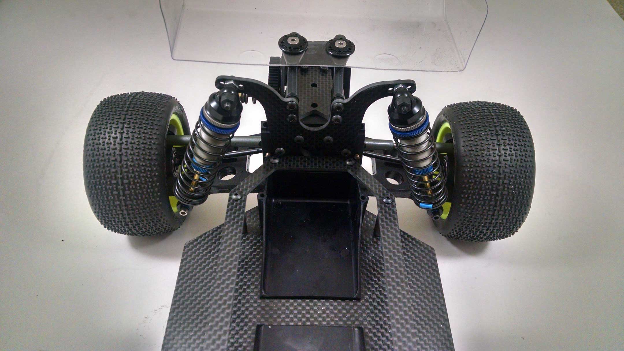

Ok guys, I finally took the time to put my plans into action. My goal was to use the Nix91 platform as a foundation but retrofit some of the newer hardware from the B5. As much as I wanted to keep the Nix91 arms, they interfered too much with the wheelbase since the B5 hex wheels have a different offset that threw off the width of the car too much. The main reason for doing this was due to the fact I already maintain a healthy supply of wheels and tires in different treads and compounds for my B5 and B5M.

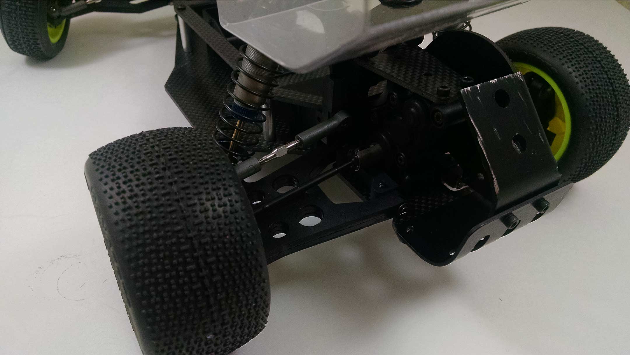

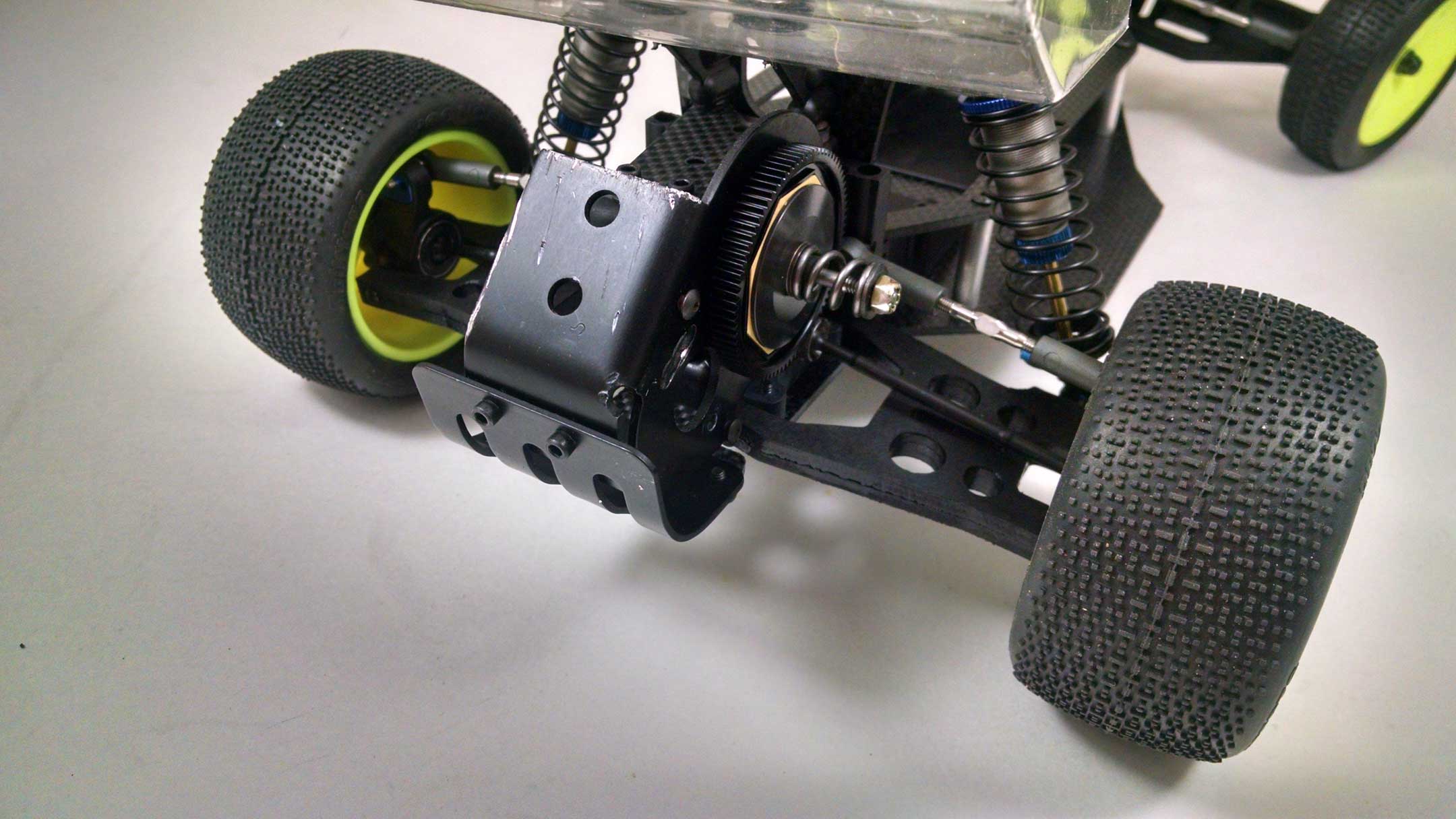

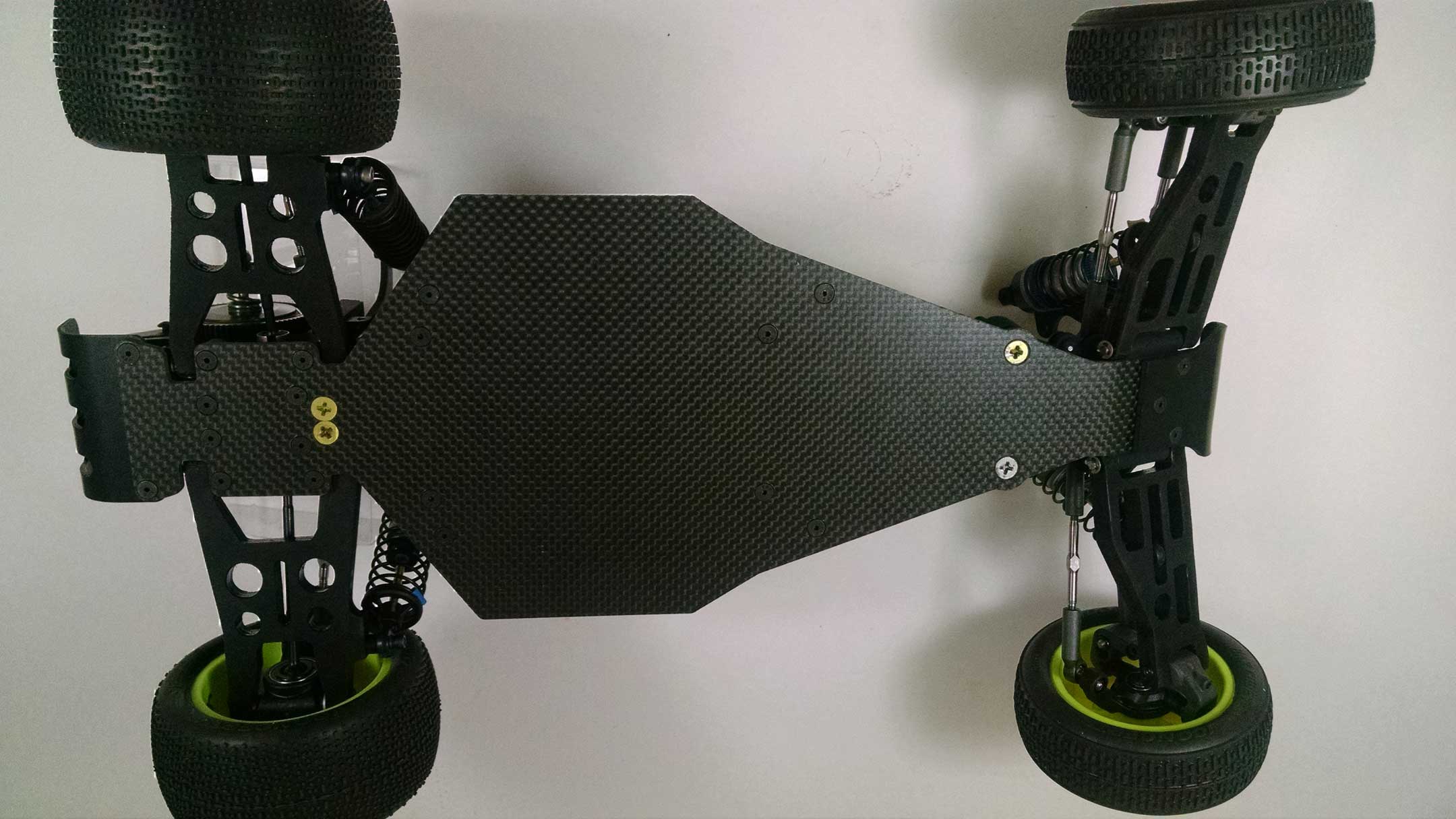

I ended up machining a new set of arms for the car from nylon 6/6. These are not glass filled arms like Kyosho uses so they will probably be an inferior product..... :lol:.

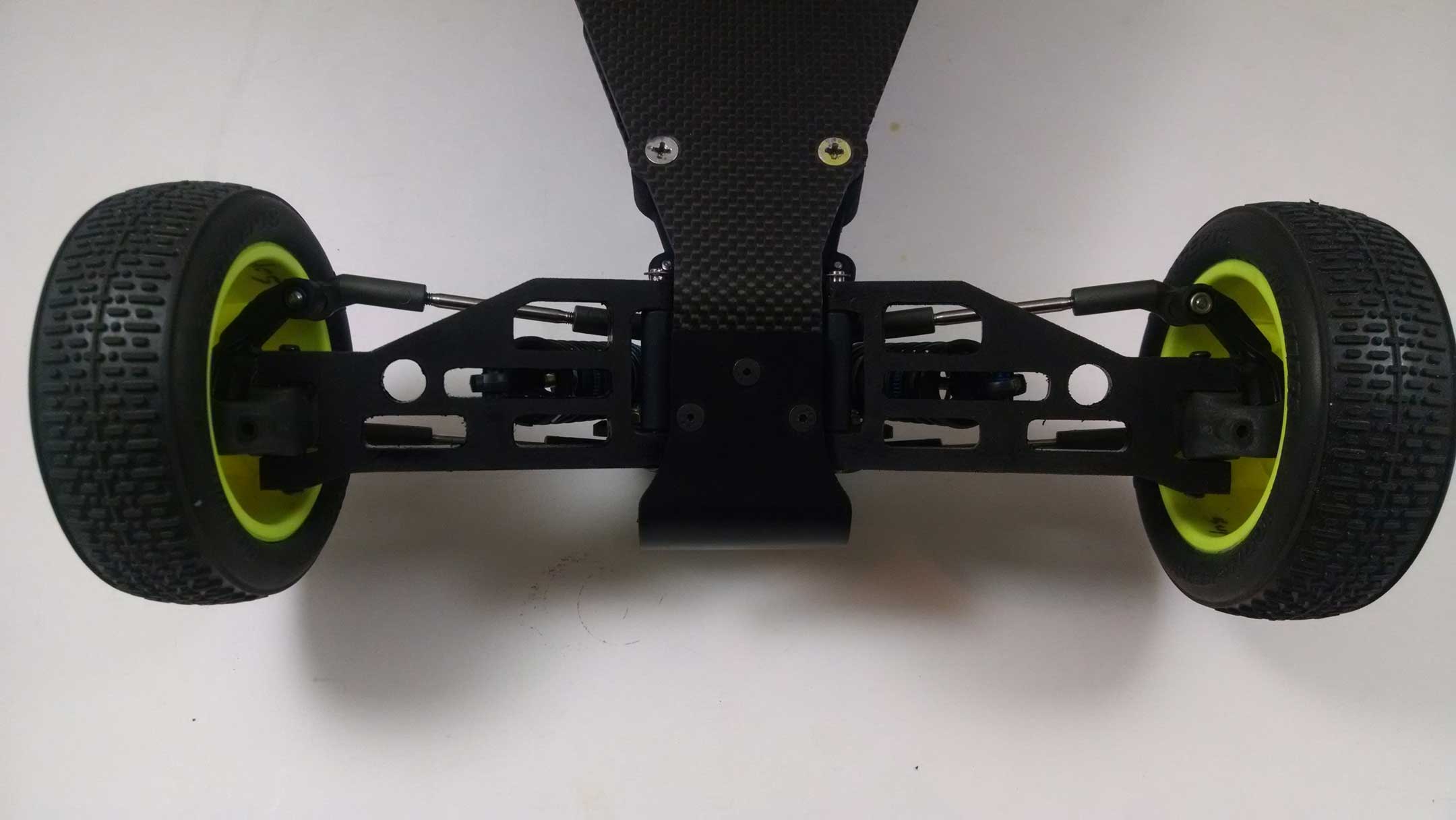

The front arms were lengthened 2.18mm per side and the rear arms were lengthened 4.88mm per side. While I was machining new arms I also had to modify the arms to accept the B5 hubs and carriers. Not much was needed and it ended up being straight forward.
Both shock towers were modified significantly and actually reduced in height a good amount. The front shock tower alone was shortened 14mm. Mounting the big bore shocks was a breeze and was actually easier to do on this car vs trying to install big bores on a standard RC10.
I also used the turnbuckles from the B5 kit which worked perfect.
The car shares the exact wheelbase and width as the B5. Using some of Slotcarrod's measurements, I was able to get rid of the bump steer, which required a bit more work since I had changed a few things with the front end.
I hope to get the car on the track tomorrow for some testing. Time to heat up the solder iron so I can get my electronics installed.

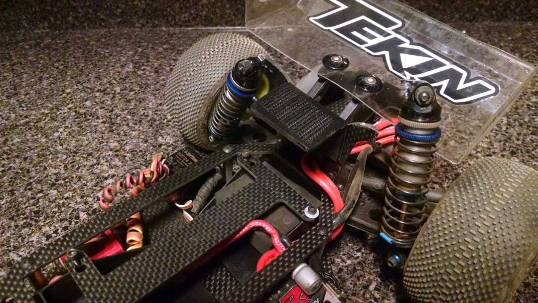

I just got my electronics mounted and it took a while to get the servo in where I got full throw left to right. The area to mount a servo is super tight for a full size servo and it requires a bit of thought to get it mounted just right.
I need to do some testing with the car to make sure the parts hold up as well as not make the car difficult to drive. Sometimes drastic changes can really change the behavior of a car. I am hoping that the car drives similar to the B5 but I doubt it. The rigidity of the chassis with the upper deck may make the car super twitchy on our high bite track. I plan on running a pack without the top deck as well to see how it changes the characteristics of the car.
