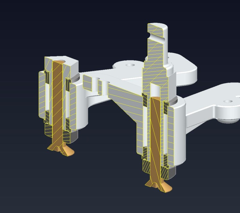

What do you guys think we should do to make these Race steering mounting nuts better (NIX91-025 and NIX91-026) ?
Check out the picture... this is the current design. Should we use shorter screws and make holes shorter? That would help the case when body post want to snap off. Maybe #6281 screws are unnecessary long.

My steering rack is great. Except the aluminum 8/32 screws, they flex under load and will be replaced with hex steel versions.
The plastic parts are great. I prepped mine by using a Du-bro 8/32 tap and cutting the threads. Then I cut the head off an extra 8/32 screw, threaded it into the plastic steering rack nut, put the screw in a drill and spun it up, then carefully sanded the surface where the bearing goes while the cut off screw was threaded inside it. This method allowed me to get the steering bearings to fit correctly after the screw was threaded inside and slightly expanded the plastic part.

if those parts are really made as you have shown, there is a definite weak point right above that top bearing. Either a longer screw is necessary, or a shorter one with the material filled in,so that the void is below that top bearing.
If it was me, I'd use steel screws long enough to support both bearings (longer on the servo drive side) and tap the plastic parts prior to install.

I don't see breaking the plastic part while running the car happening. But if you try to cut the threads with the 8/32 aluminum screw, your going to strip the screw or break the head off the plastic part, and it expands the plastic making it very tight for the bearings. Measure the depth of the hole, tape off the depth on a 8/32 tap, tap the hole, turn down the bearing surface with a nail file so the bearing fits and everything will be mint. That extra space above the screw let the pointed tap work great.

Can you indicate on the CAD where the failure is occurring?

What kinda length are we talking to get a longer screw in? Just so i can get an order in? Thinks thats a better option?

I know it would be harder but I think alloy would be a better option than the 3d printed parts. Just for the parts that screw down.
It would be great if someone could to the whole thing in alloy.

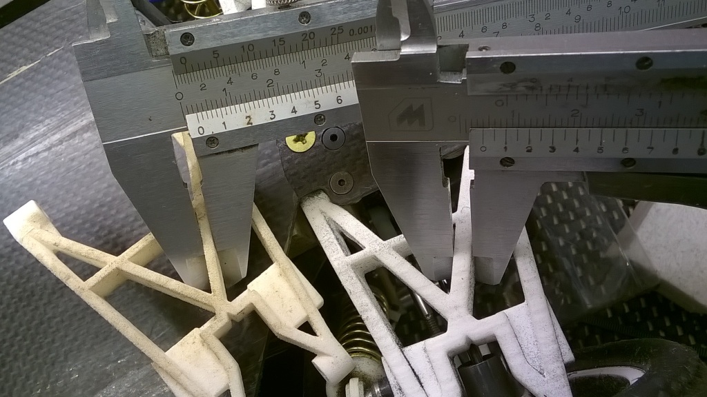

slotcarrod wrote:Shapeways just messed up my race parts order and sent me standard rear arms instead of the race version. :roll: I thought I made the error, but checked and nope, my order was correct! :(
I emailed photos of the barcode and the parts!
They emailed me back and said I was wrong and that I was sent the correct parts! :roll: What a crap show!

You can send this picture to Shapeways and ask which one they think they printed.
Standard replica arm is 2.5mm and Race is 4.0mm. Shouldn't be so hard to identify :)
