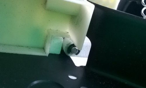

Alright, I got my parts yesterday. I've never dealt with printed parts before and what a weird texture. :lol:
Anyways, it appears the rear bulkhead needs a little notch for the rear arm mounts to fit. Is that correct? Or am I doing something wildly wrong?
Niki
Posts: 524
Joined: Wed Nov 02, 2011 7:32 am
Location: Finland
Been thanked: 45 times
Re: Quadra-symmetric RC10
Post by Niki »
Yes, you need to cut bulkhead corner away.

I only had to trim a very little bit on my re-re bulkhead to clear the arm.

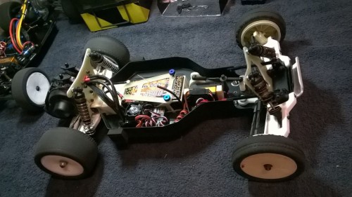

You guys are killing me with all the cool stuff that's out right now!! Question - is the Klein arm setup not quite as long in front as this Quadra arm setup?

If Klein front arm shares lenght with RPM Worlds Conversion front arm - I would call difference to Quadra front arm... huge!

right, the quadra front arms push a B4 wheel out to ROAR max with the standard length buggy front axles(not the truck axles), using a truck nose.
likewise in the rear with B4 wheels and bones, but b2/10t carriers. then the rear arm and arm mounts are tweaked such that they are the same center to center as the front arms.

Yeah, the quadra arms are significantly longer than the Klein arms. I could do a side-by-side pic if you want...after some minor disassembly. :lol:
